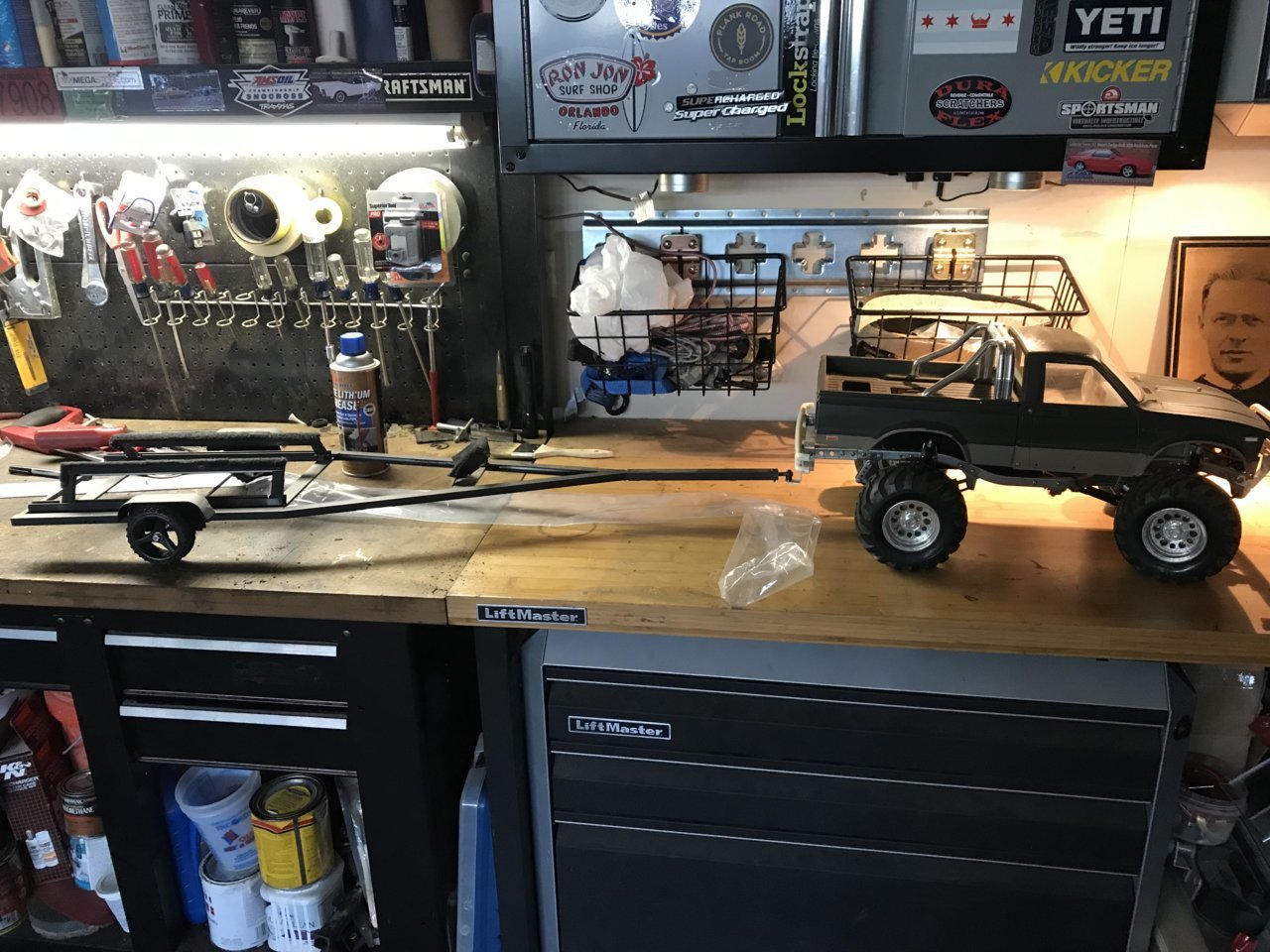

    Awesome. Here’s mine. Not Tacoma but a hilux. Mountaineer model I’ve had since the mid 90s. Three speed trans, solid axles, leaf springs and winch.
    With my boat trailer but boats at a buddies.

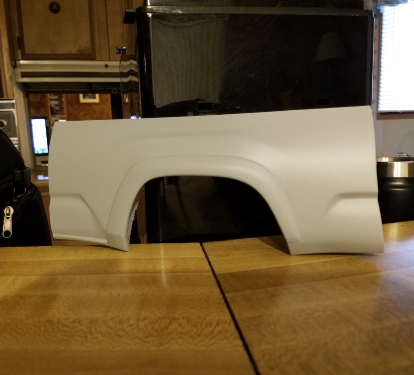

    Finding out that getting these panels completely smooth is just gonna take quite some time. Good thing I'm not in a hurry.
    NastyBogging[OP] likes this.

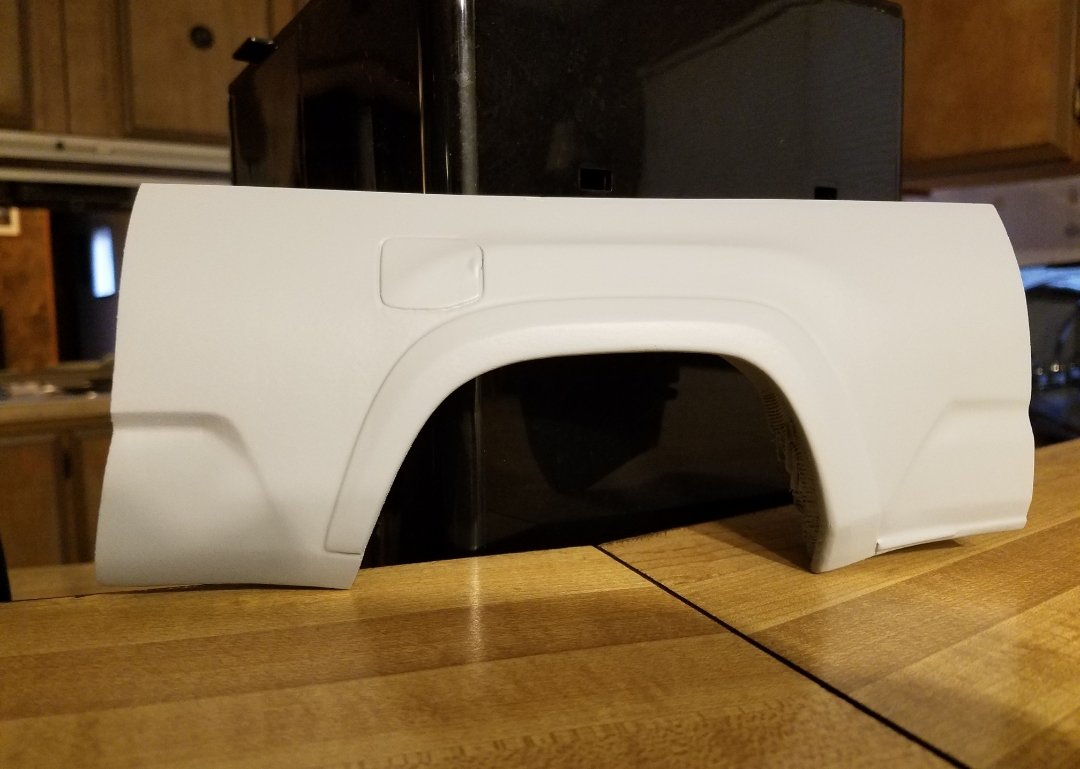

  8. Sep 23, 2019 at 6:08 PM
    #108
    20tacoma17
    20tacoma17 Well-Known Member
    Nov 8, 2016
    #201910
    7,079
    2017 DCLB Sport AT
    Kings, 275/70/17, a few custom items, lots of Meso mods.
    Got 2 rear fender printer lines smoothed out enough before assembly. Doing the bed first to get used to the process before the more complicated cab. Only about 50 more parts that need the printer lines removed. :goingcrazy:

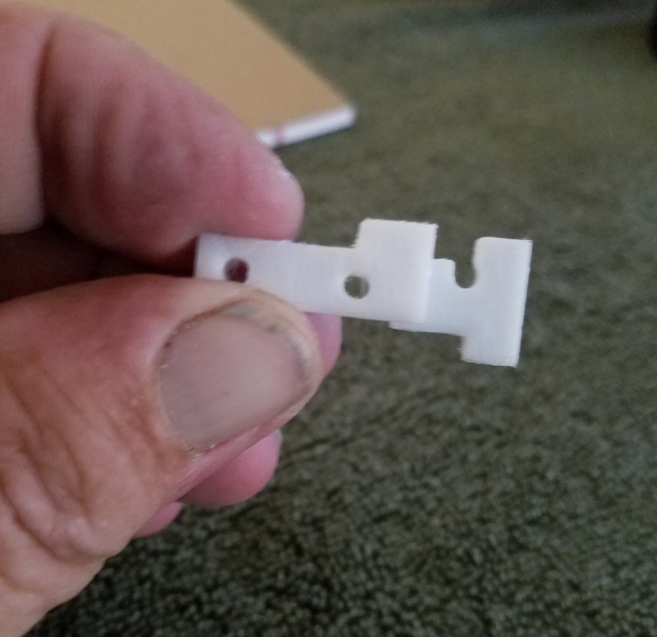

    Getting this little guy to fit perfectly is a PIA. :rant:...:rofl:
    Glad I found them before I put bed together.
    Any other little pieces I need to look out for?
    Thanks :hattip:

    It took a little bit to get it to fit right, but I think it's worth it for the tailgate to open and close. You could always just glue the tailgate closed if you wanted to.
    I don't think there were any other small parts like that.

    Thanks, what are you using to hide the seams? Using Filler Primer but it seems to stay tacky even after a week. Bigger seams was going to use the gap filler glue?

    I've been using Bondo but I think gap filler glue would work. Make sure your not filling in the smaller details like upper door seams or gas cap. They can easily be sanded and filled.

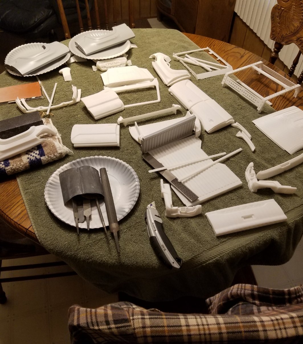

    Is this ABS?
    If it is, Peter Sripol on YouTube uses acetone to weld the parts together and uses an ABS slurry to fill in the printer lines. Then he sands it down. Figured I would throw that out there for another idea.
