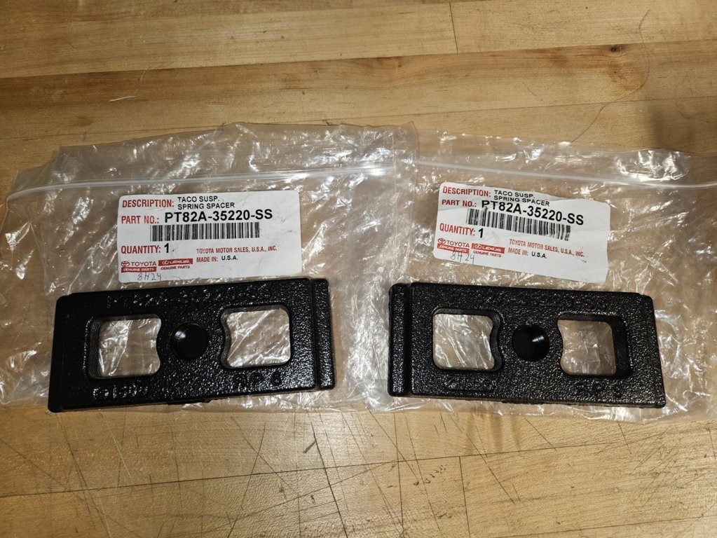

    Anyone had any luck ordering the 0.5” rear blocks (PT82A-35220-SS)? I have tried a few websites but keep getting notified that they are back ordered until further notice…another option would be the deaver j66 spring pack. I haul a dirt bike on my hitch for work and currently have Firestone airbags. Would the j66 and airbags work ok for hauling my bike? This setup works fine with my stock leafs. I was just wanting 0.5-1” of lift. I have 6112 set at 1.5” in the front. I guess I could lower the 6112’s to the 1” setting if I can’t find the 0.5” blocks. I use the truck 50% of the time with my dirt bike on the hitch and 50% with no load. I don’t want a heavy spring for when I’m not hauling my dirt bike. Any help is appreciated!

    Never mind, I finally found a dealer that had them in stock.

    I have a set just chilling in my tool chest. They are getting a bit harder to find as I had to place a few orders till I found someone that had a set in stock.

    I finally got mine in today. What I found out they are on national back order. In fact one dealer in my area told me they are discontinued. I find that very hard to believe since it's a factory Pro part and Toyota will supply it for at least 10 years. The guy behind the counter didn't know his arse from a hole in the wall.
    Anyhow from what I see the only way to get them now is if an actual dealer has them in stock or the local Toyota parts warehouse has them in stock. Even the big parts wholesaler BAM could not get the spring spacers. BAM told me they were on back order with no ETA at all.

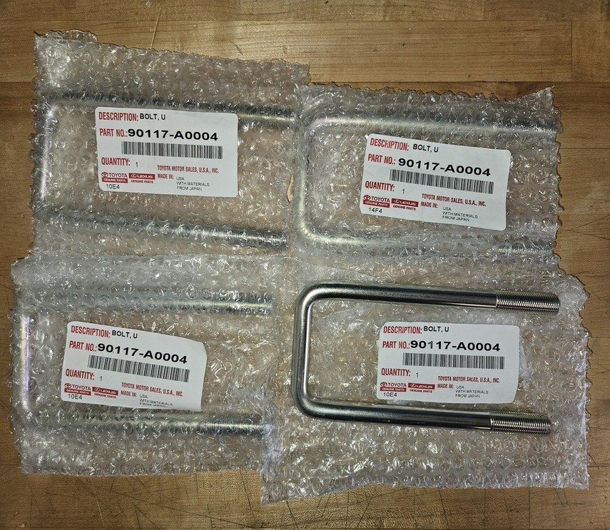

    I have Finally found the Toyota Part #'s for the TRD Pro U Bolts for these 1/2in. spacers. Yes they are slightly longer to accommodate that 1/2in. spacer. My set finally arrived today.

    How much for the u bolts ?

    They were $35 each from Olathe Toyota. If you shop around you can find them a little cheaper on line. Just use that part#.

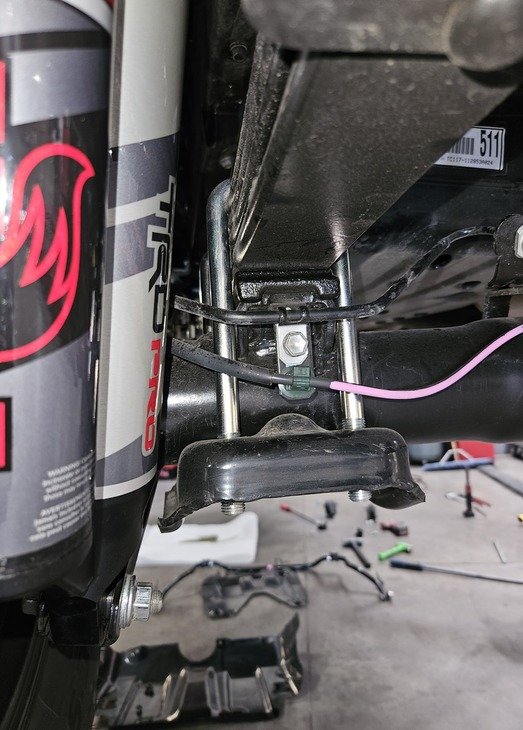

    Finally got the 1/2in. spacers and correct length U bolts installed for my Pro suspension.

    Does anyone know the difference between this and PT82A-35210? My local toyota dealers system directs me to this one when I search for PT82A-35220 and it sounds like the same part. Maybe they consolidated the part numbers which is why one is listed as discontinued? Or is there a difference?

    I ordered mine off toyotapartsdeal a while ago PT82A-35220-SS

    Think I found an answer to my question. Sounds like PT82A-35210 is a 1" block from the TRD lift kit and maybe on certain years and trims and PT82A-35220 is the 1/2" block.
