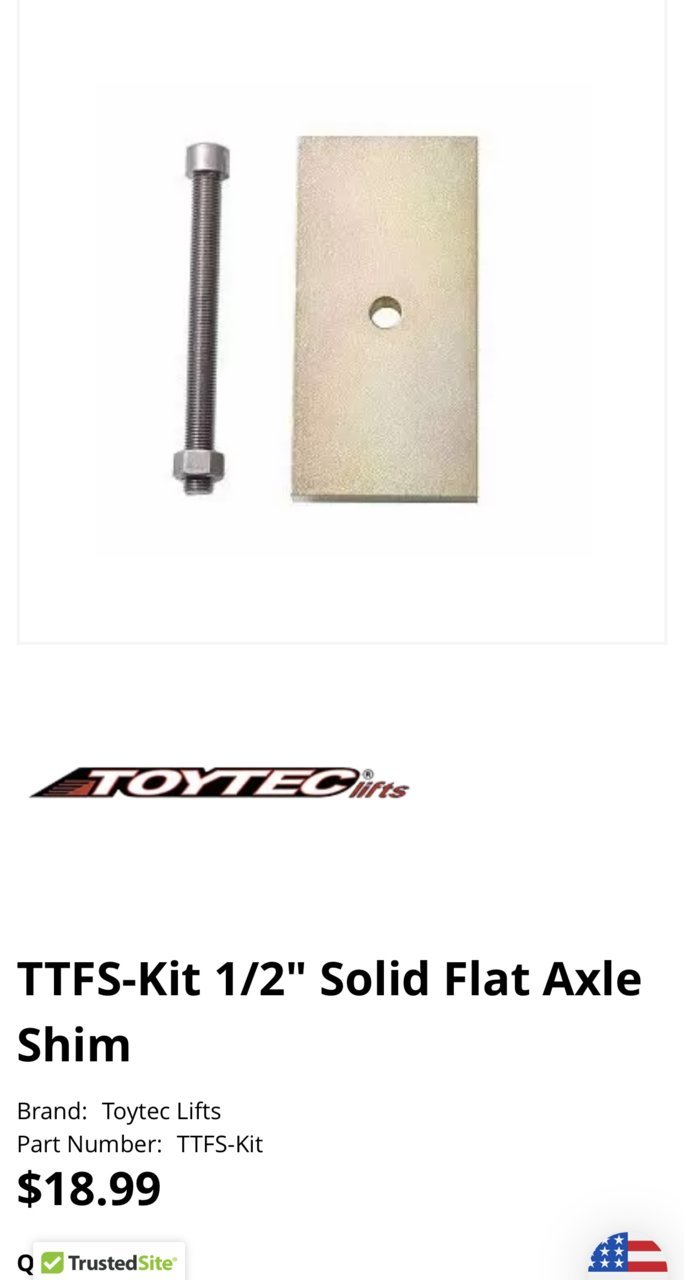

    Anyone running toytec 1/2 inch rear axle shims? I have 5100’s and installed OME 884 coils hoping to get leveled out, got more lift than expected and now I have around 1/2 inch rear sag. If anyone is running the 1/2 inch shims any problems or complaints?

    Is it a normal block between the axle and leafs or a shim added to the leaf pack like the one in the picture?

    is it a toytec block?

    The trail edition and pro comes with a 1/2 inch lift block from factory for 2023. Part number should be (PT82A-35220-SS)

    Thanks! Does it just slip under the whole leaf pack like the 1 inch blocks or do you have to take the leaf pack apart and insert it in the leaf pack? And also right now I have 5100’s but I’m thinking about switching to the 4600’s in the rear hoping for a softer ride. Ik the 4600’s are Mede for stock ride height, do you know if they would work with the 1/2 inch block?

    They’ll install the same as the 1 inch block. I think you’ll be fine with the 4600’s but not sure it’ll help the ride. If you’re trying to get a smoother ride out back I’d recommend looking into hammer hangers from archive garage. It’s a night and day difference.
