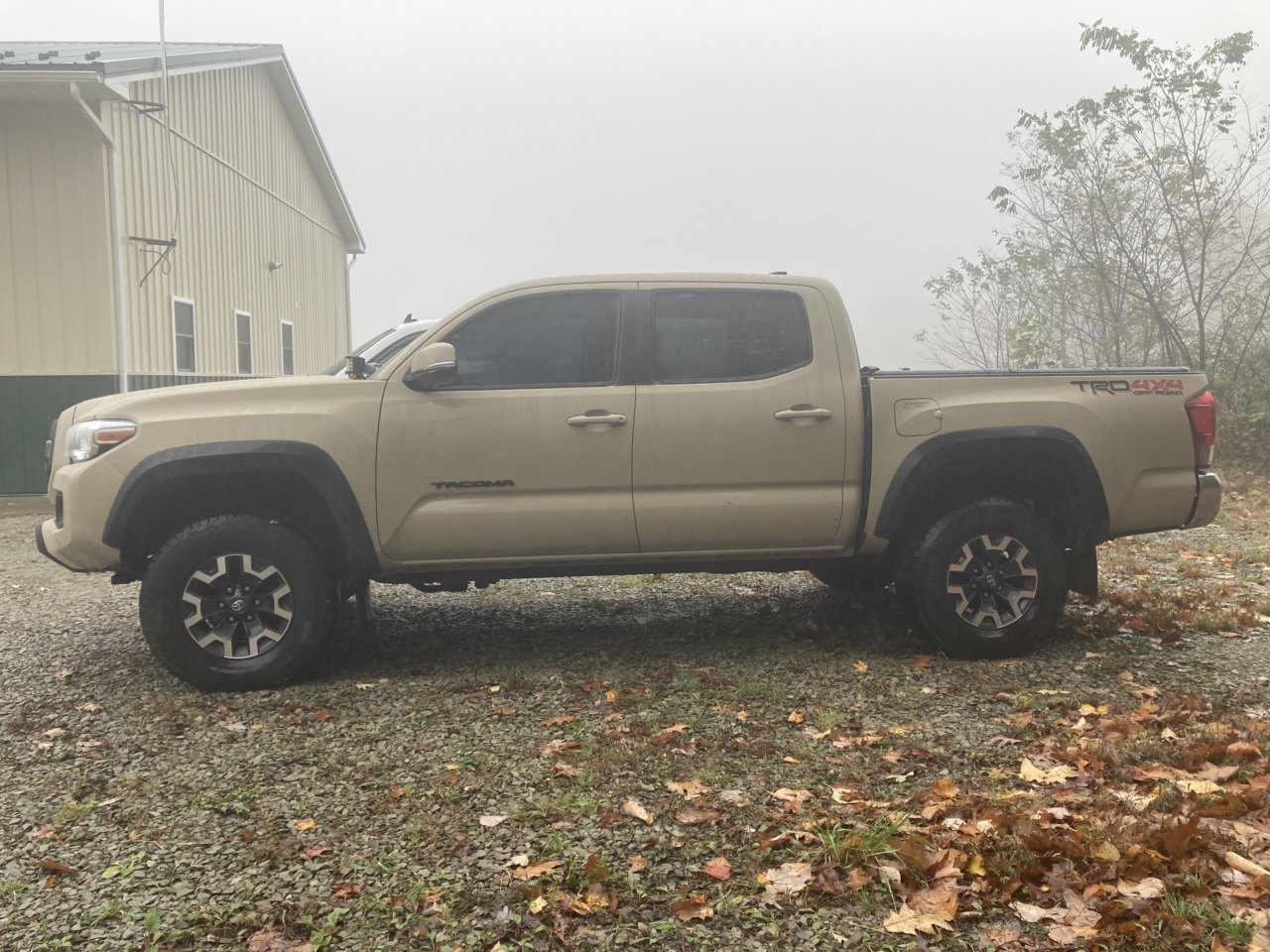

    I went with street rays and 1in rear block. Gave exactly the look I wanted and an easy install.
    Now Im just waiting for my tires to wear so I can go up a tire size. :playball:

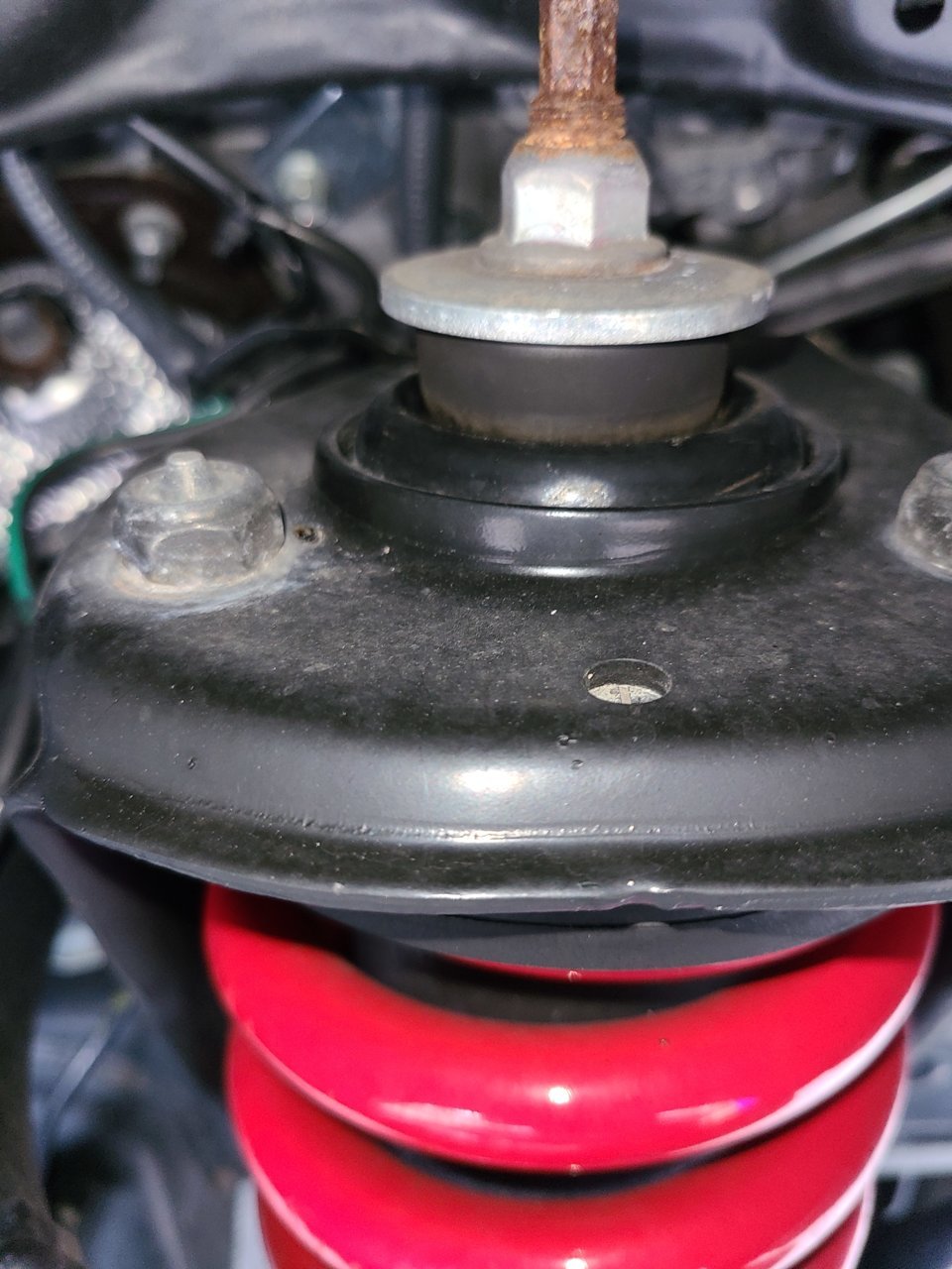

    This is actually exactly the info needed. I don't want to disassemble the coil over to replace studs. Do you have a picture of the stud/nut engagement?

    And that’s a 1/2” in front? Wow.

    Yes, 1/2” spacer which equals a 1in lift

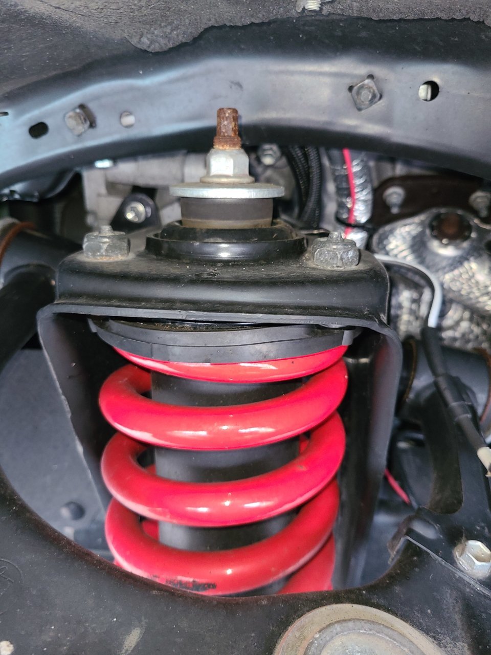

    Remove one of the oem nuts and measure the length of the stud to double check. You'll see the oem nut has a spacer added to it, this is where you'll gain the length you need. I've had these in for about 18 months without issue.

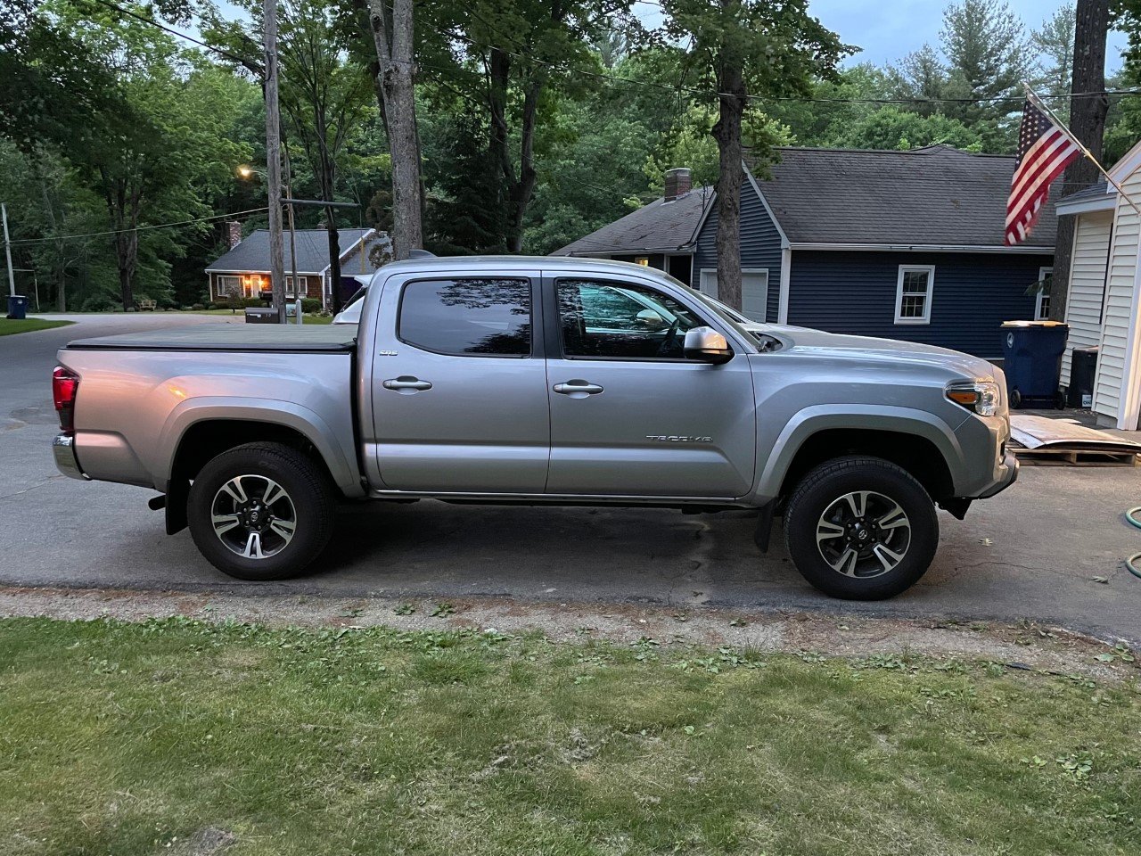

    Contrary to what was said above a spacer lift does not "squish" your shocks and springs. It actually "pushes" the lower control arm further from its stock position thus providing lift. It doesn't change the length of your strut so no "squishing". Also, if anything, it stretches the shock out a little further. So much bad info here - people are just winging answers without knowing facts. A small spacer lift is fine if that is what you are looking for. I am not knocking the Bilsteins - they are great - but again there is NOTHING wrong with using a small spacer lift if that is what you are after (plus its WAY cheaper). I wanted to level my truck (I like the level look, not the raked look with a 4WD - just my preference). I bought a 1" spacer lift, which if you research you will find that the size of the spacer will double the lift (so my lift was obviously advertised as a 2" lift). I ended up milling one spacer down to .875" (7/8) and the other spacer down to .625" (5/8). I located the thicker spacer on the drivers side. What this did was give me the lift I was after and because I'm so goddamn anal it took care of the .500" (1/2) "Taco lean" you've read so much about. I just did this, this weekend and still playing with it but may mill down the 1" rear spacers down to 1/2" or 3/8" to
    get the rear up ever so slightly. When measured from the wheel centers vertically to the fender the dimension is the same at all 4 corners.

    I installed the toytec 1/2” spacer and studs. Studs came out of the stock cap easily with a hammer and a socket underneath it. Toytec studs went back in the same way and were snug. No issues tightening down the nuts.
    best part was we Took off the lower spindle bolts, loosened the lower control arm bolts, unbolted the top strut nut then lowered the whole coil out of the truck. No need for a spring compressor. It worked out perfectly.....
    raised the front of a trdor nearly perfectly level(maybe 1/8-1/4 lower in front). I’m very happy. I didn’t have any taco lean prior to this btw.
