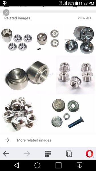

    Those help, if they don't have the bit, just makes it harder. But most likely thiefs will have tools such as these. They are easily had anywhere. The way to go is something with a special tool/key/bit to really prevent it from being stolen. Ideally something custom with a key/bit that only you have. I've heard of machine shops that can make custom bolts/keys. Rigid industries sells anti theft bolts/nuts iirc. Not sure if every one is different tho. But the harder you can make it for thiefs the better. Something like these would be good:

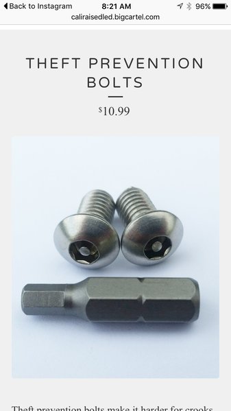

    @CaliRaisedLed
    Here

    You need a special Allen with a hole in it.

    And if you can't find a tamper proof bolt to your liking with enough security(again I would not go with the torx type bolts with the hole, they're all the same and the bits can easily be bought by thiefs) you could always get a threaded stud that has no head. Thread that in, and use a security nut instead. The nuts are more various than bolts. And lots to choose from in eBay/Amazon for cheap.

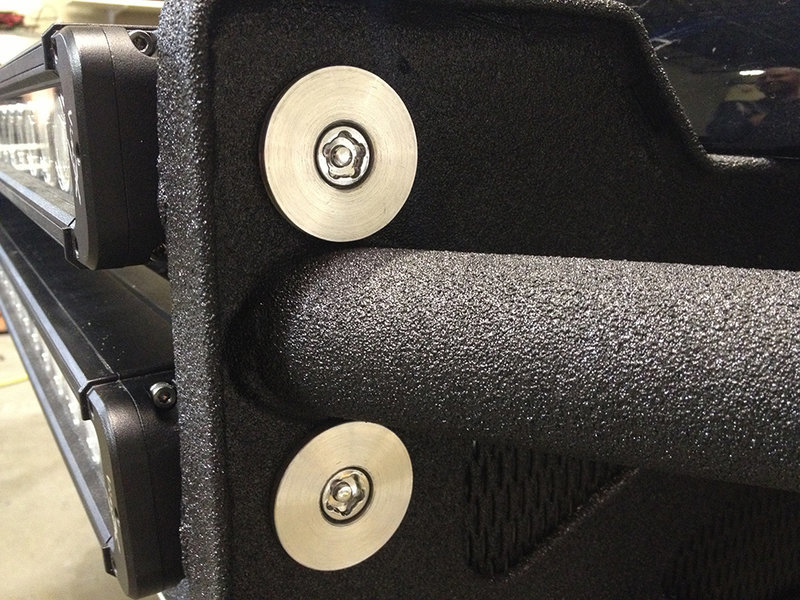

    I too was gonna say something along these lines. I had to use a 1/4 threaded rod through my bar for mounting, with nuts on the end. I then did a couple tac welds on the nuts to the threads. If I ever need to remove it I'll just grind off the weld to remove the nut. I've also heard of people fabricating and welding small caps over the nut/bolt. I'm thinking of doing something similar next time I redo my setup. That way if they happen to have a grinder, I'll for damn sure hear that. Ha.

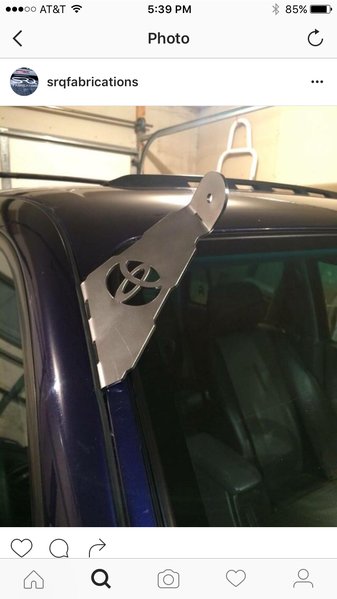

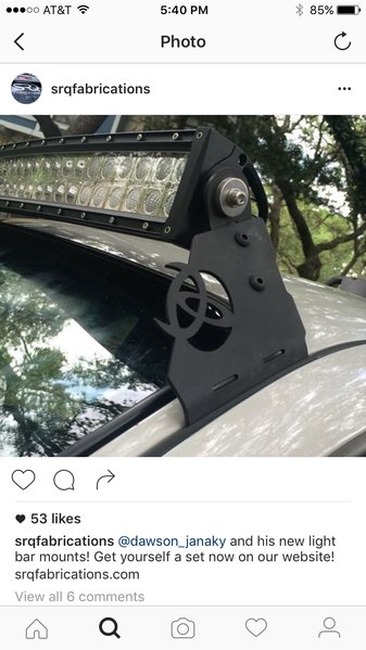

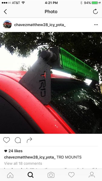

    @eazycompany on IG. Those are the kind I have. But there are some other mounts made by SRQ fabrication on either IG or E bay. Only difference is SRQ's mounts can be adjusted to handle curved or straight bars. But I don't know for sure since I have eazycompany mounts. The bottom picture is the only one I have of the light bar mounts on my truck. Here are a few more pictures of SRQ's mounts.
