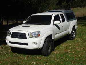

    08 RC Prerunner SR5
    Here's my 05 prerunner ac with 3 leaf crap pack plus 5100s & Toytec 1.5 AAL and 1/2" driver side spacer up front to fix lean with 5100s set at 2.5". No vibes, had to use LR UCAs to get caster back, has 1.25" rake higher in back. Rides great, drives great, well worth it.........
