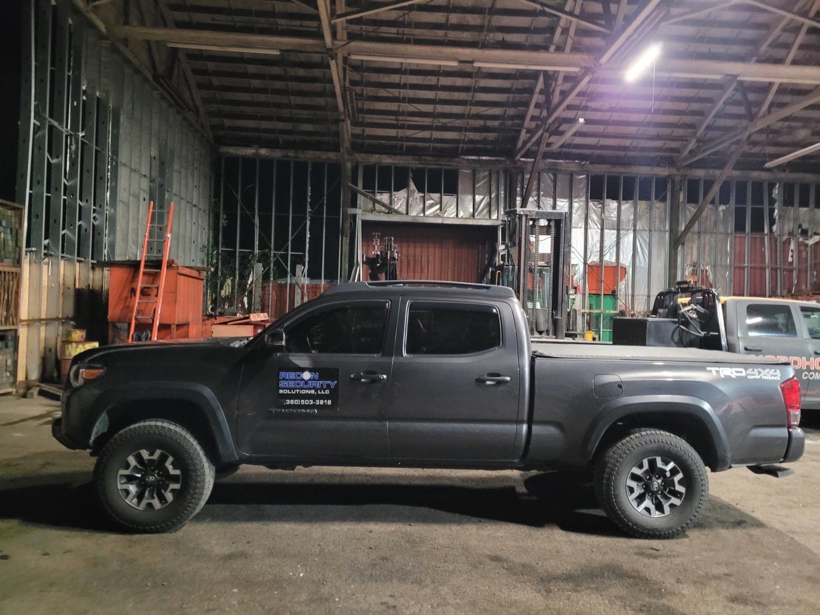

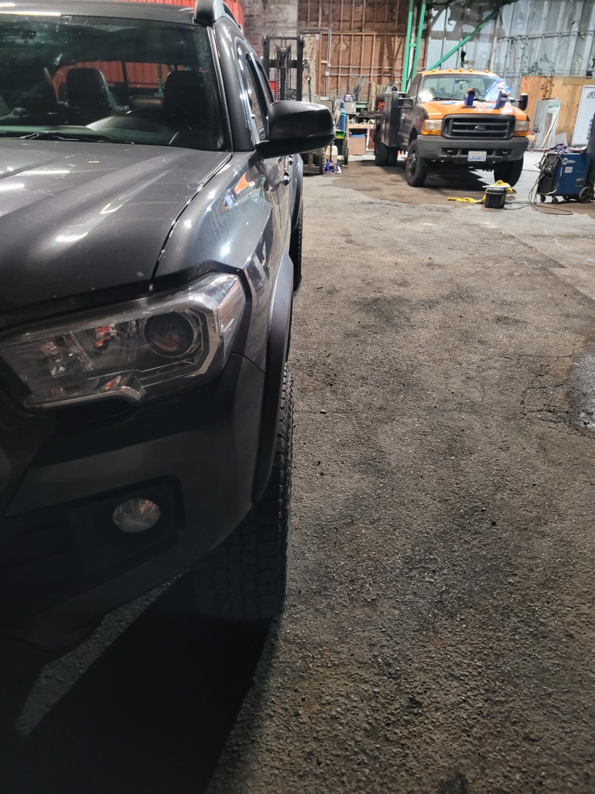

    This is my 2017 with 1.5" strut spacer leveling kit for like $35 on Amazon. I was actually impressed. It also has 1.25" wheel spacers and I really like the stance. Both of these also helped the ride quality. The front was too soft before and now the tires ride toward the outside of the road groves so it handles a little better too.
