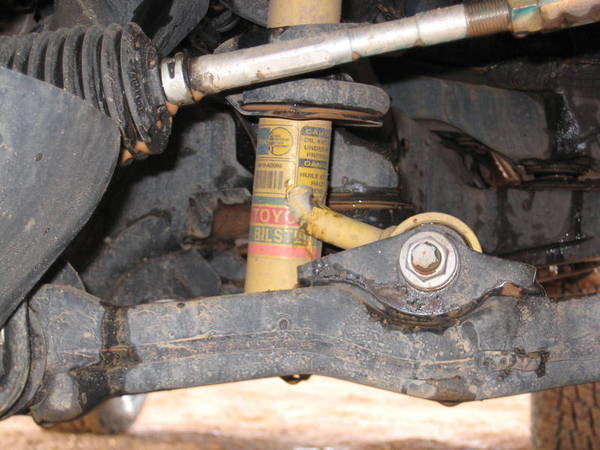

    ONLY if you go more than 2.5 inches.
    I see this picture all the time and laugh about it. There is a member on this forum that cut away the boot on the front shock and fully compressed the shock till it hit the bump stop. exactly 2.5 inches of extra shock travel. This was on a 3rd gen Tacoma.
    Id say 2" max is safe for a top plate spacer.

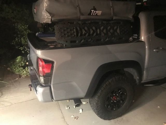

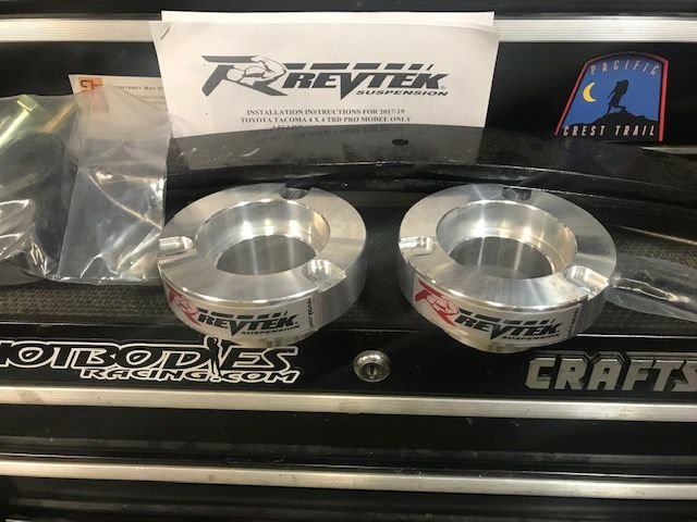

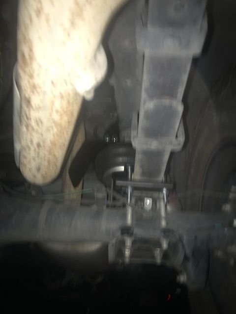

    I was torn from day one because of all the gear I carry ...much sagging..weak leaf springs in Tacoma
    I did not want to replace the great Fox Suspension and thought RevTek kit AAL might be best option, well after much thought I have some paper weights for sale (Craigslist Central Calif)
    I decided to go with the Firestone Ride Rite Air bag system...perfect choice for my application !!
    ride quality stays the same and can load all the crap in my bed that I don't need
    Cheers
