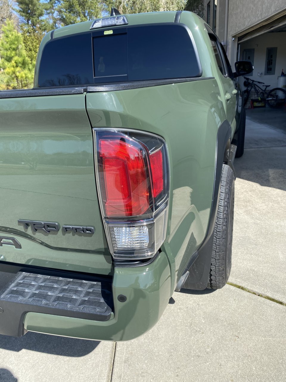

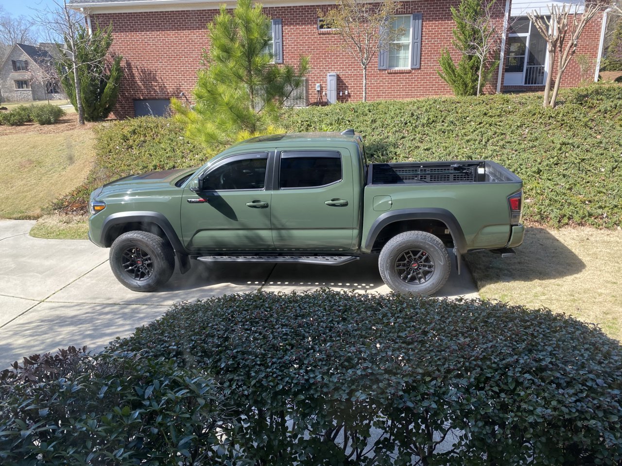

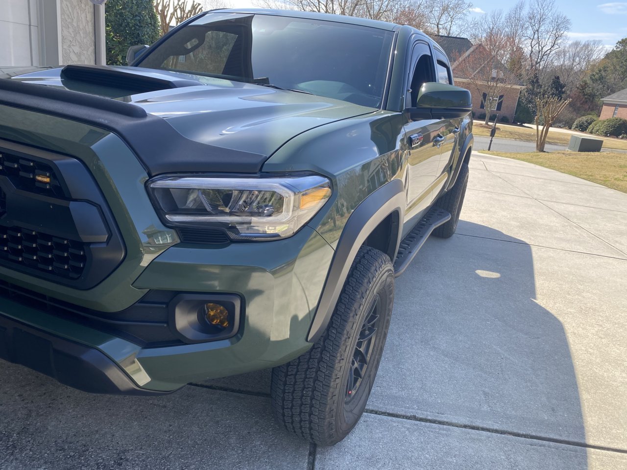

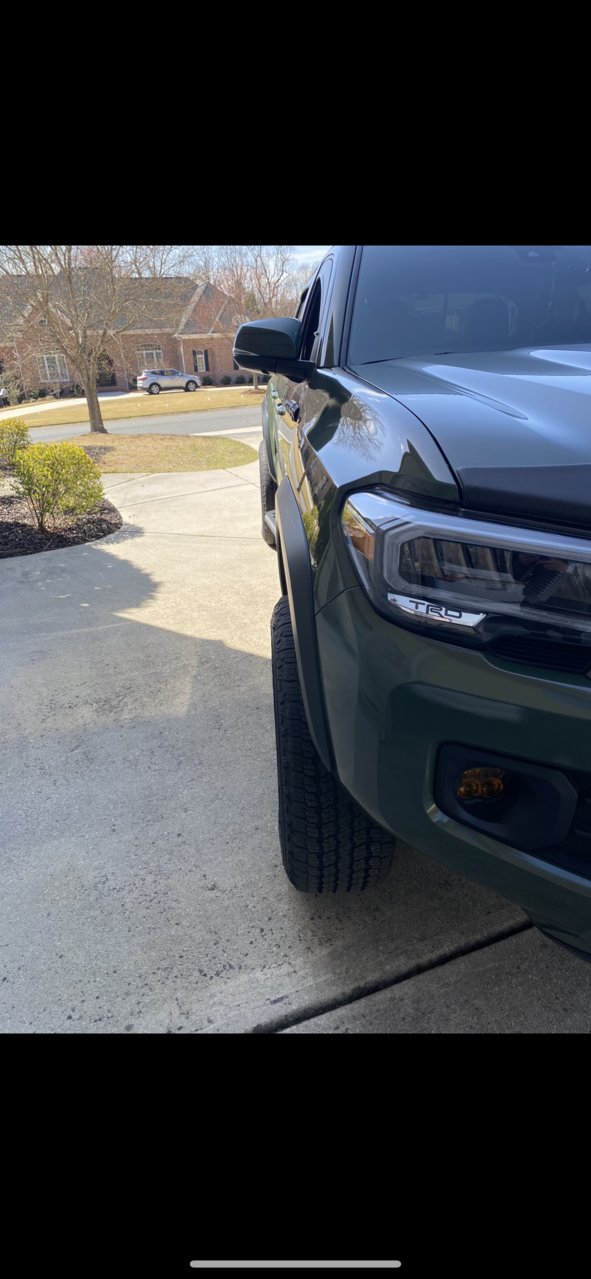

    1.5 inch spacers, torqued to 90lbs - torque again after 2-500miles. NO Thread locks. Stock Trd pro 2020, No rub, kept mudflap on. This is for anyone looking for this info, for some reason I was struggling finding it. 9F513C27-A996-46F2-8353-E5E908D3EF46.jpg8ABF9FD8-AD04-437A-9DDF-CB50E5823699.jpg1ABB289D-2B47-47E3-8CE1-5A7502F3B0B8.jpgAE92E145-7B77-43AF-8702-D7DC64702E14.jpg
