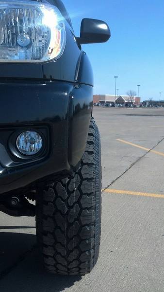

    With just this much sticking out I get the occasional loud ping of a rock high up on the door, let alone what hits the rocker panel. And I have custom flaps from Reno also
    For what it's worth.
    16x8 with 4.5 I believe. . .

    that looks perfect to me. Love it. Thanks for the pm too I will look into that
