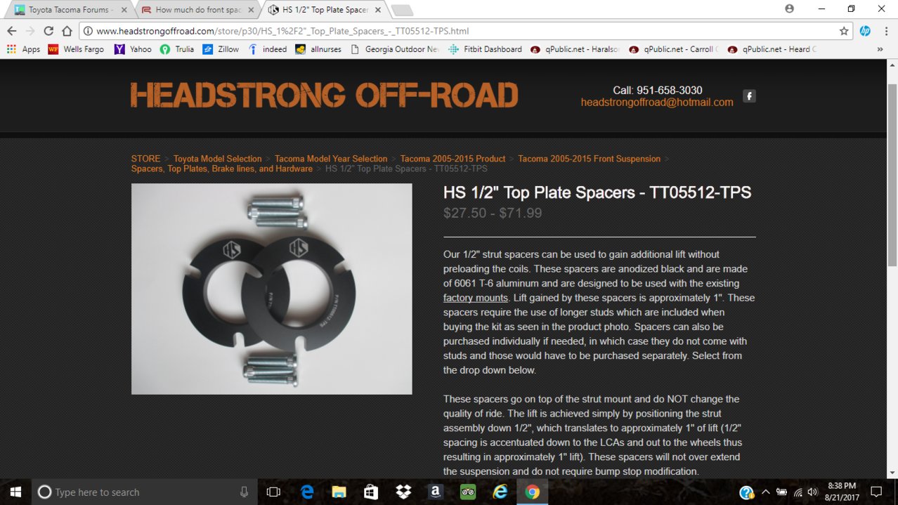

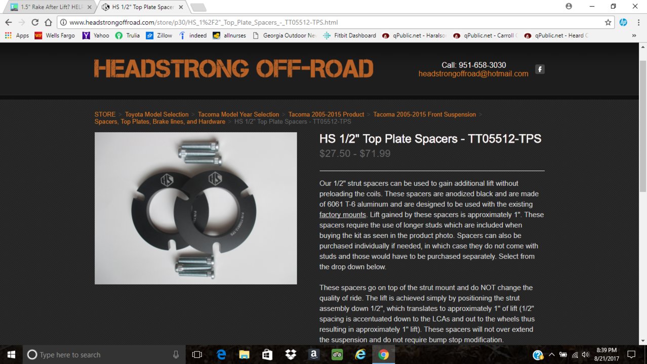

    Could I use these along with the stock coils and Billy's set at 2.5"?

    You could run the TOP1-T (http://toyteclifts.3dcartstores.com/TOP1-T--Front-Top-Plate-Spacer-Kit-_p_333.html) front 1/2'' top plate spacers to help get that front end up to where you need it or we do offer a 3'' coil spring replacement that will yield the 3'' of front end lift you are looking for, then that way you can set your coil perch down to the lowest setting and get your full lift from the springs and will increase your ride quality!!
