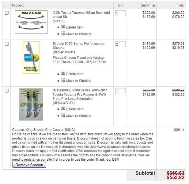

    Thats why I was confused. The Icon AAL kit ($179.00) says it lifts 1.5" but the guy I spoke with said 2.5" and I don't need it if I am only lifting 1.5".
    This is what I am going to order:
    Also need stem adapters for the 5150's (according to the guy I spoke with).
    (1.5"-2.0" is my goal, 2.5" is ok as long as I dont have to replace anything else).
    Is the valving and shock length ok?

    Hi Matt,
    You talked to me on the phone. I think were mis-communicating a bit...
    You mentioned not really wanting more than 2" of lift over all, but wanted it to be level. On a 2011, if you just set the front shocks to 1.75"...the truck will be pretty much level. No need for the rear AAL in this case. That's what I was trying explain...
    Also, if you're not doing a bunch of wheeling, you don't really need 5150s in the rear. The 5100s would be fine.
    We're getting more 5100s tomorrow, so you can place your order online, or over the phone anytime. Feel free to call us or PM me, if you still have any questions...

    It was my confusion, sorry Marco. Thanks I'll skip the AAL and just do the shocks at 1.75. in FR.
