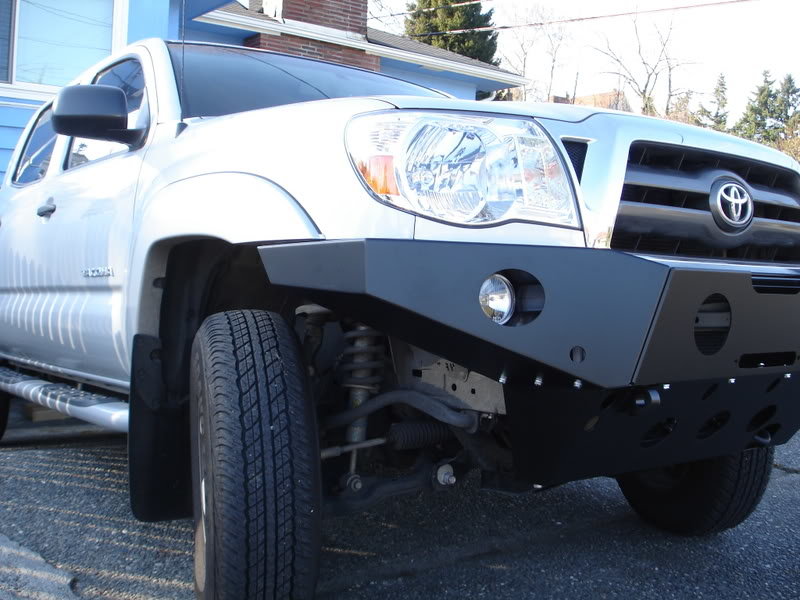

    All Pro front plate bumper, 5100 1.75" Bilstein up front, 1" block and TSB in rear, UWS lowpro tool box, Toyota Side Steps
    Hello,
    First I'd like to say I've tried searching but as much as we all own the same truck, there are so many differences, so I thought I'd ask the question.
    On a 2009 Prerunner with an All Pro front bumper, I have the Bilsteins up front at 1.75" and will be getting the TSB in the rear. I'd like to see what the biggest size tire I can fit on the stock rims, I don't mind using spacers but would rather get rims than UCA's if possible. Would getting wider rims matter for the tire size? I fit 285's on my Land Cruiser stock alloys when I used to wheel. If I get the tires this week I can get Toyota to do the alignment for free when the TSB happens and these days, free is good! Thanks in advance.

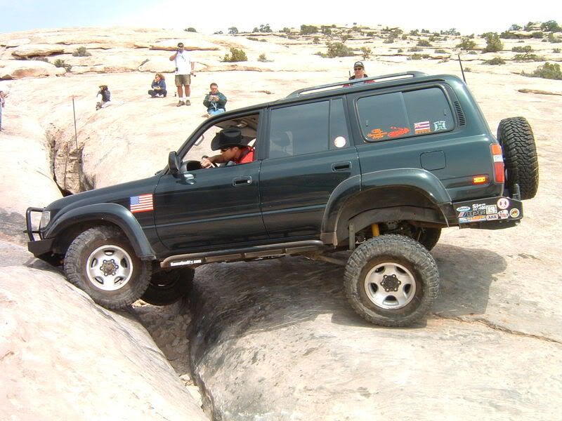

    For fun, I thought I'd throw in a pic or two -
    The LC has 285/75R16 MT/R's on stock rims. 3" OME lift all around, no UCA's, spacers or trimming. I miss her...
