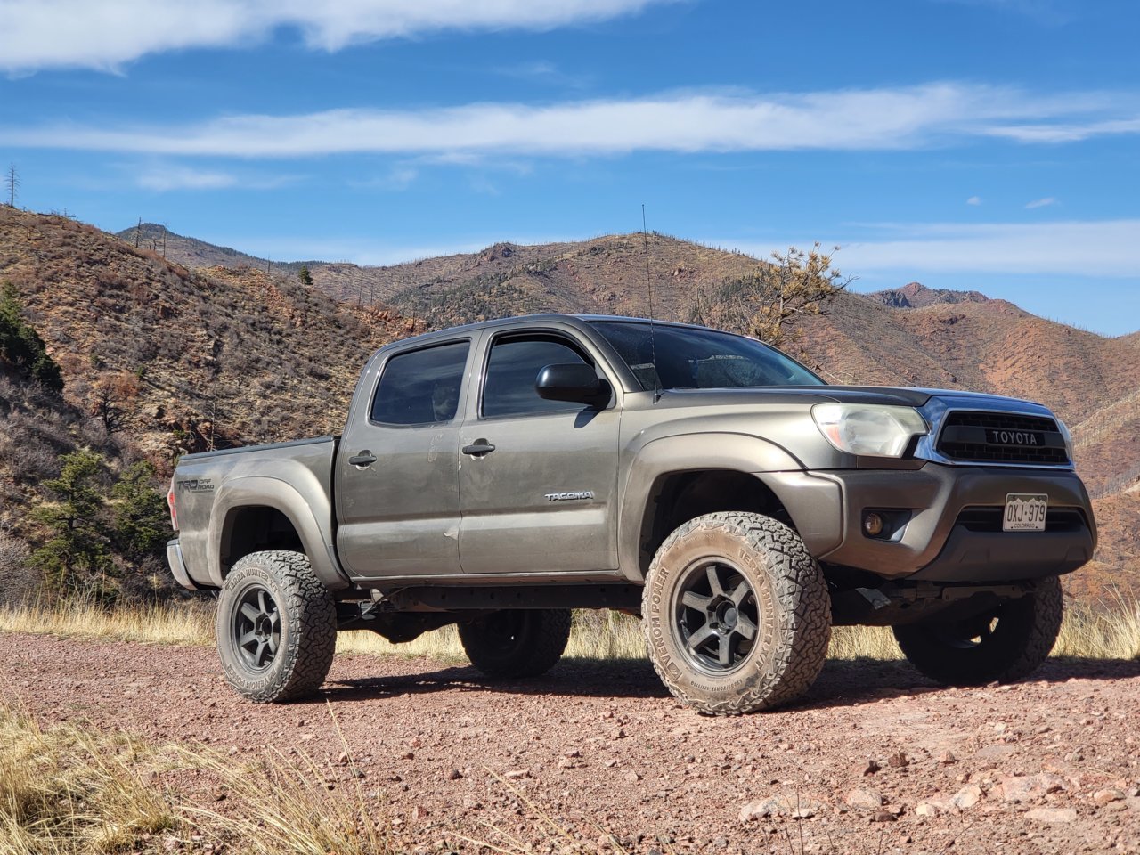

    Body lifts definitely have a place and I run one on my 4runner and wife's truck. Helps clear obstacles, larger tires and does not raise center of gravity like a suspension lift. Wife's rig, 2" front suspension, 4" rear leafs, 1" body lift.

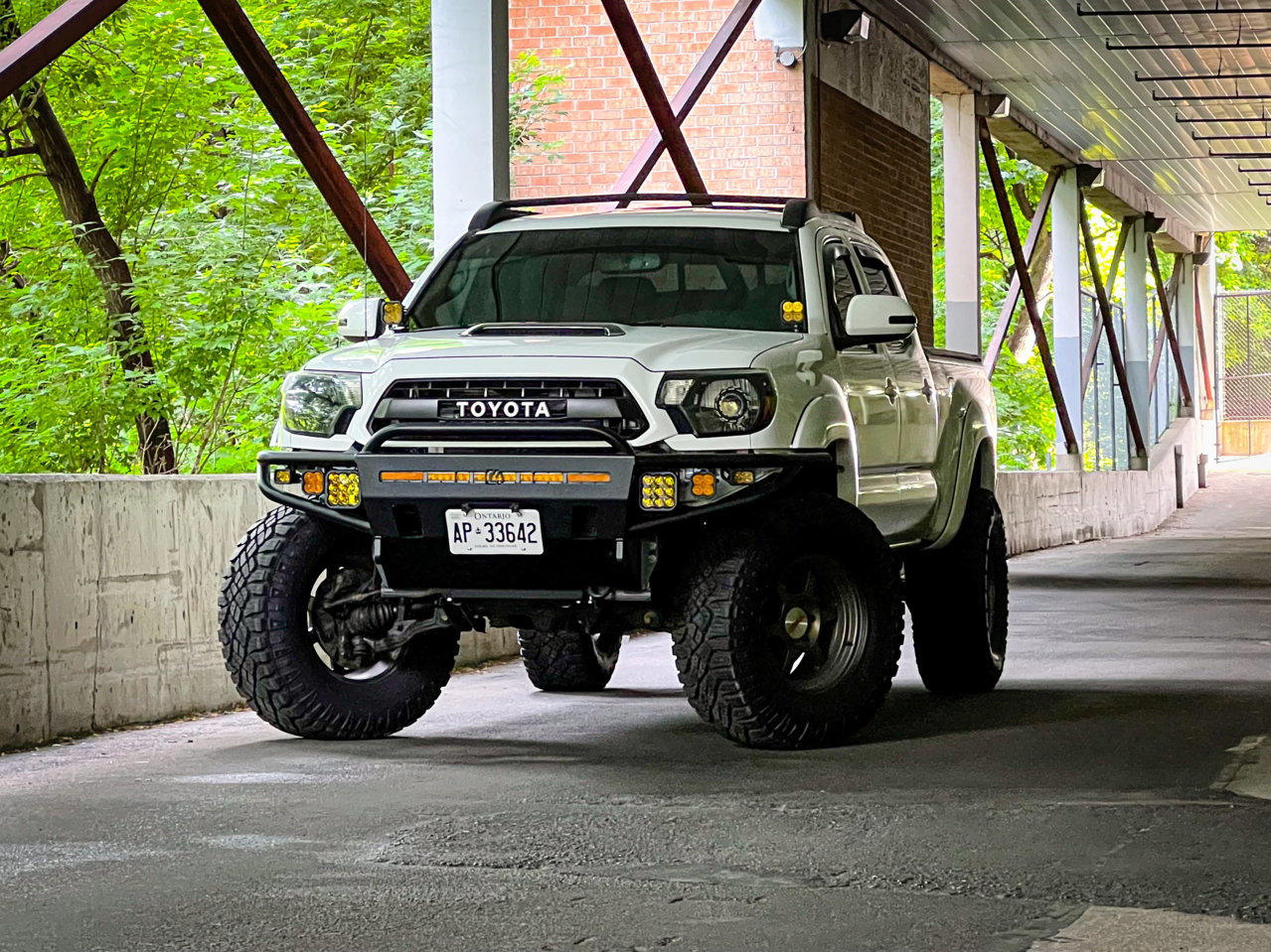

    3” lift with 1” body lift and 35” tires. Also a cab mount relocation kit installed.
