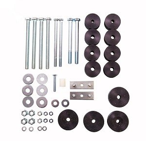

    Planning on a BOSS 2.5 lift and possibly adding one of these. Anyone done one of these? Don't want to do a drop bracket lift and wondering how invasive/irreversible this kit is? Hows the install? Can't find any instructions to look at and see whats involved. Pics would be greatly appreciated.
    Photo from TOYTEC's website (Thanks guys!)

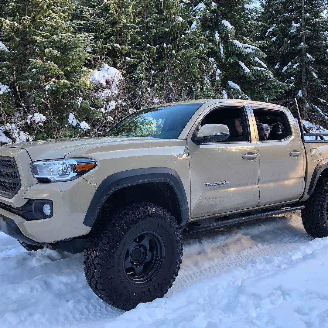

    24302376_10159664078870113_7920470973386_41d389477f23ce9f47cb7fc235c1ae4139d775fb.jpg
  14. Jan 16, 2018 at 9:26 AM
    irishrye
    irishrye [OP] Well-Known Member
    May 2, 2016
    #185931
    175
    315/75r16 duratracs of SCS f5's with 3.5 bs

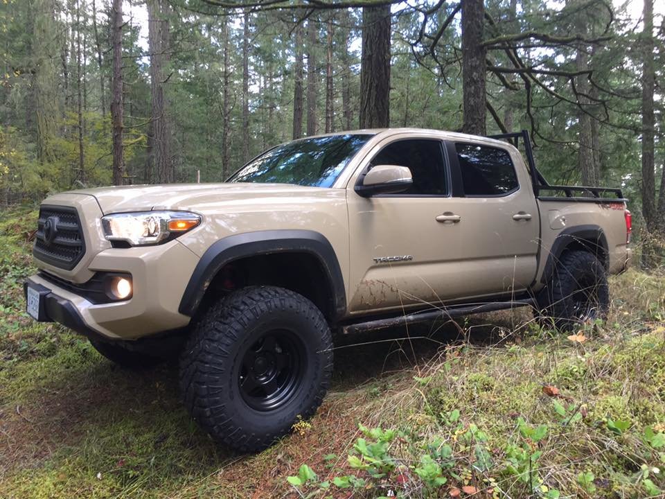

    175
    22730601_10159496748055113_1833882733568_e8a816baa4b310664ee6c7eb537c893560cf8e3f.jpg
    Mckeiff17 likes this.
  16. Jan 16, 2018 at 9:29 AM
    #16
    Juforrest
    Juforrest Dumb!
    Nov 23, 2015
    #170434
    5,942
    Justin
    Seattle
    Reformed Taco driver in a GX460
    What about the body mount? Did you chop? Looks killer by the way.
  17. Jan 16, 2018 at 9:32 AM
    #17
    Mckeiff17
    Mckeiff17 Well-Known Member
    Dec 7, 2017
    #237891
    116
    2017 Silver Tacoma SR
    Yeah do anything to fit them? Trimming or cmc?
  18. Jan 16, 2018 at 11:04 AM
    #18
    wedgefry
    wedgefry Active Member
    May 6, 2017
    #218387
    43
    Jordon
    Vancouver, Canada
    2017 Tacoma TRD Off Road DCSB
    Did you have to add steering spacers, extend brake lines or anything along those lines? And just to clarify, you did a 2.5" suspension lift and a 1" body lift. Did the rear bumper have a gap at all?
  19. Jan 16, 2018 at 1:16 PM
    #19
    irishrye
    May 2, 2016
    #185931
    175
    No steering spacer needed for the 1 inch lift. no brake line extensions either. Rear bumper did have a gap but not that bad at all. i was easily able to cut the bumper gap in half with no bumper modifications other than some washers to raise it up. and yes a 2.5/3 inch suspension lift and 1 inch body lift. CMC and some inner fender plastic trimming. If i could do it again i would get a wheel with a 4 inch BS my 3.5 BS are bit aggressive
