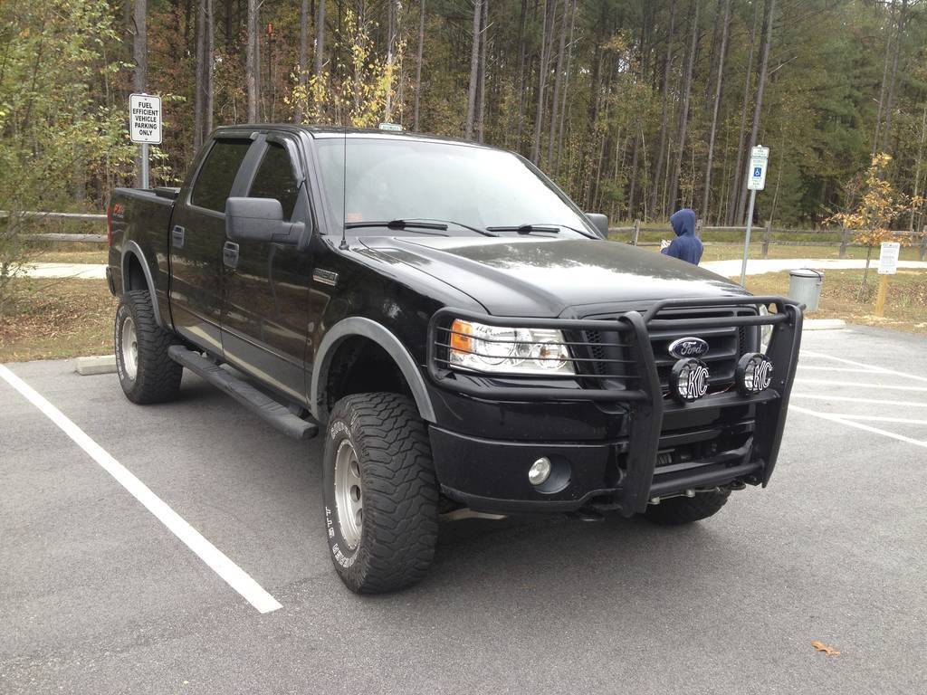

    My .02 is that on my last truck - F150 FX4 - I had a performance accessories 3" body lift in addition to a fat bob's 3" level kit and Pro Comp 2" AALs. I ran 315/70R17 BFGs, then 35x1250R17 Cooper STTs... Never had a single issue. I offroaded the mess out of that truck, but always wanted a tacoma because stock my new tacoma was within an inch of my lifted f150.... I never tore a CV boot until I got in an accident and I'm pretty sure the shop tore it. They replaced it with a different brand and that tore, and a few months later that one tore again... The stock CVs with the sharp edged boots never tore until the accident, but the replacement boots that had rounded, soft edges tore - poor quality.
    Here is my old truck playing around:
    http://youtu.be/LwDDdjcJURU
    and some backwoods drifting :)
    http://youtu.be/i06fZkZfik4
    And some pics:
    Note the "Fuel Efficient Vehicle Parking Only" Sign.... Hey, I had a 5.4 that took straight up E-85, so technically I could travel in the HOV Lanes with just me in the truck since they allow alt fuel vehicles in there too... and frankly, the sign just pissed me off

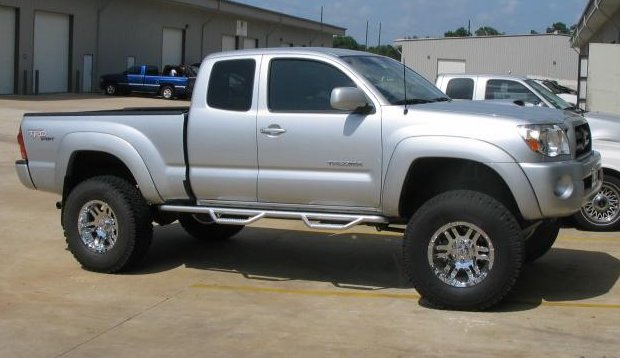

    A 1" to 1.5" BL seems like it might be worth it to me. When I ran my f150 with a 3" BL too much frame showed. I loved not having the running boards on there but with the BL it hid the frame realt well and it looked terrible without them on. I found a couple photos on google images of some tacos with what looks like 3" BLs, and I think you'd need to have a running board to hide the frame. I love the height but I can't stand to see the frame. I would love to see more photos of a 1" or 1.5". To me a 3" suspension lft is not enough, and 6" makes it look like a tonka truck, but every time I see a truck and I say "that's what I want!" It's ALWAYS a 4" lift (usually spindle lifts too since nobody seems to make a 4" drop bracket 4x4 suspension lift that's affordable)

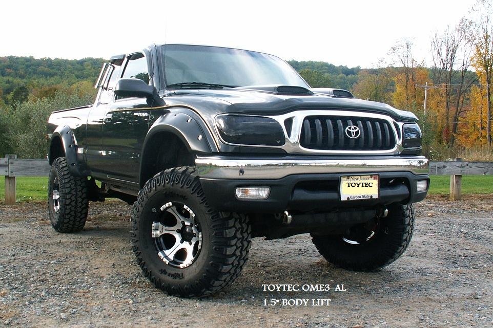

    I had a 1.5" body lift with a Toytec 3", the body lift was awesome and a very simple install. I just bought a 2014 access cab and I am going to do the same thing... not spending about $2K for a 4"-5" lift!
    Here is a pic of my 2003 w/1.5" BL & 3" Toytec

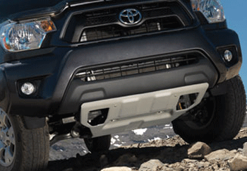

    I think the factory skid plate in the front would help hide the gap in the front:
