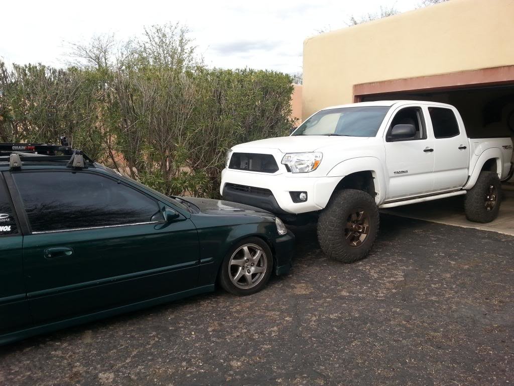

    I got a 1.5" Bl with 3.25" Suspension on my 13 tacoma

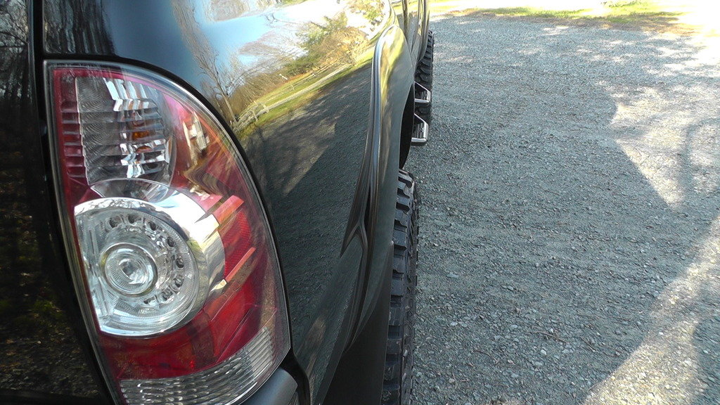

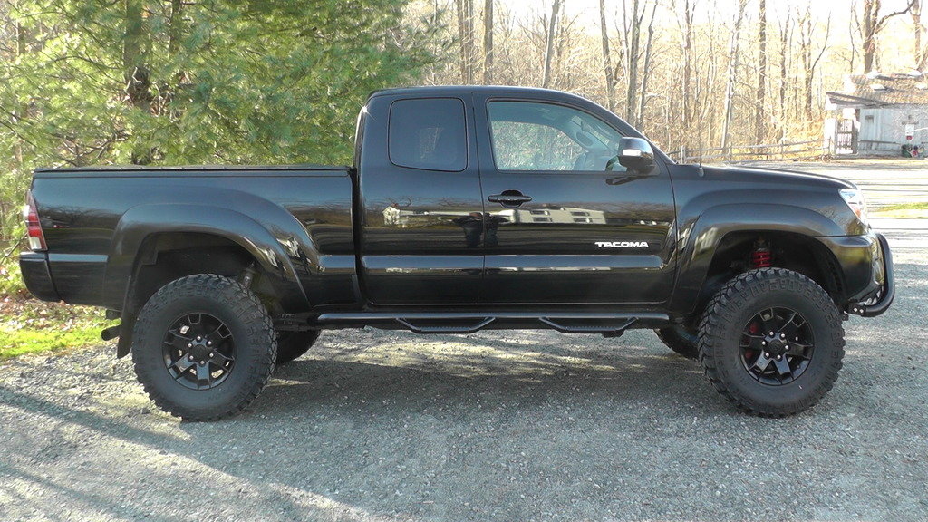

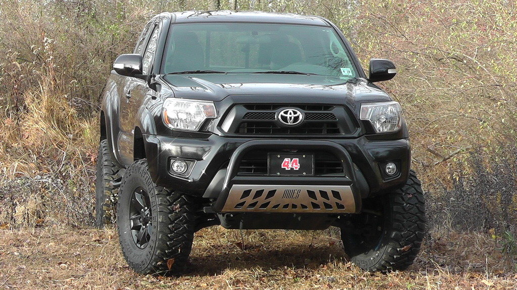

    I went with a 2" body lift... with 3" suspension. 305-70R16 tires
