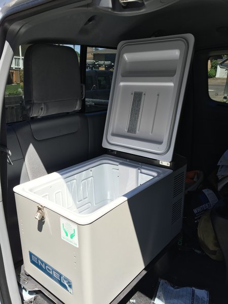

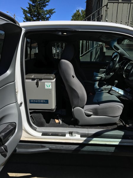

    I desperately wanted to be done with coolers forever. Dealing with ice sucks...there are ways to make it a little more bearable but I'm just not into it anymore. So, that means fridge! My wife and I decided that a small fridge is plenty for us so I picked up an Engel MT 35. Another key to this size is that you can fully open the lid in our intended mounting location in the truck. We decided we wanted it on the 'camp' side of the truck and not in the bed. So, behind the front passenger seat is where it will live!

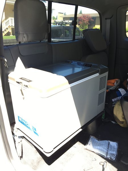

    This shall do nicely! You have a lot of room left for the front passenger unless that person like to recline a lot when traveling (neither of us do).
    Tons of room. An MT 45 might work here too but it's a few inches taller so I'm not positive it would be as user friendly to accessing the contents and using the included basket that comes in the fridge.
    Full lid swing. No sweat!
    Let's get to building something!

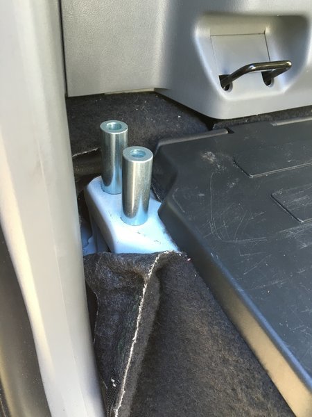

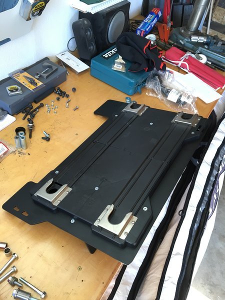

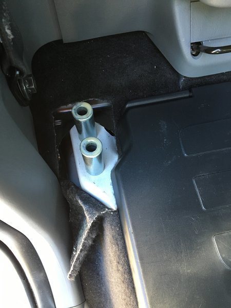

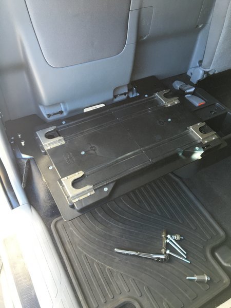

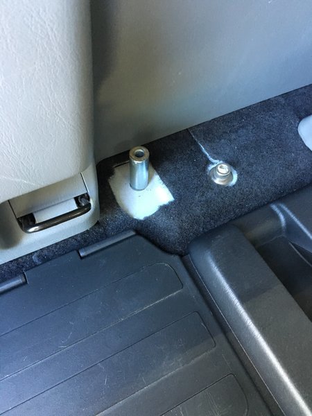

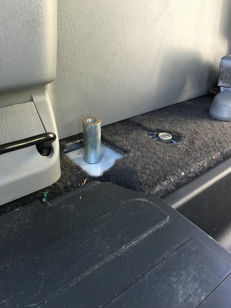

    Without the seat cushion, you have three nice mounting points. I used these heavy steel spacers to get the mounting surface high enough to clear the center console between the back seats.

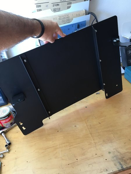

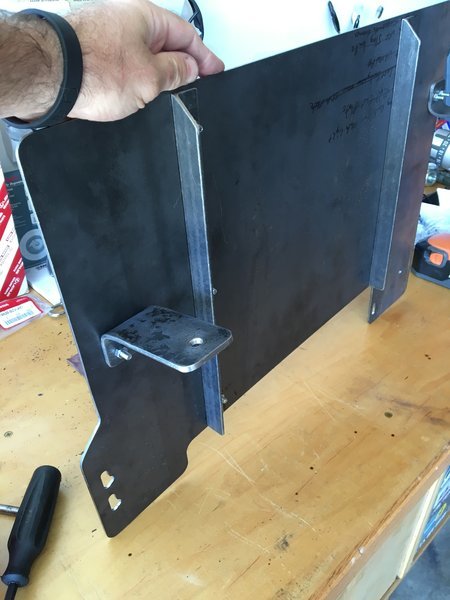

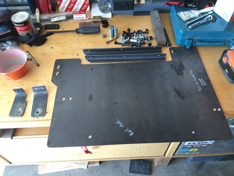

    After a little tape measure and template work, I had a plate laser cut. I had to immediately modify it to clear the rear door plastic and tweak the location of the rear mounting points. Hard to measure that stuff accurately when you don't have a direct line between them. This is a picture of all the parts of the mount, FYI.

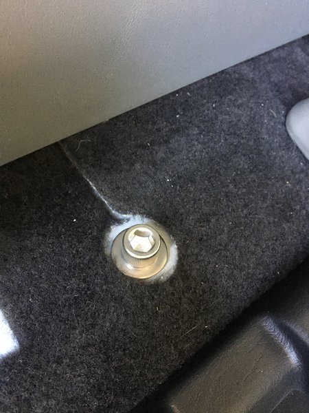

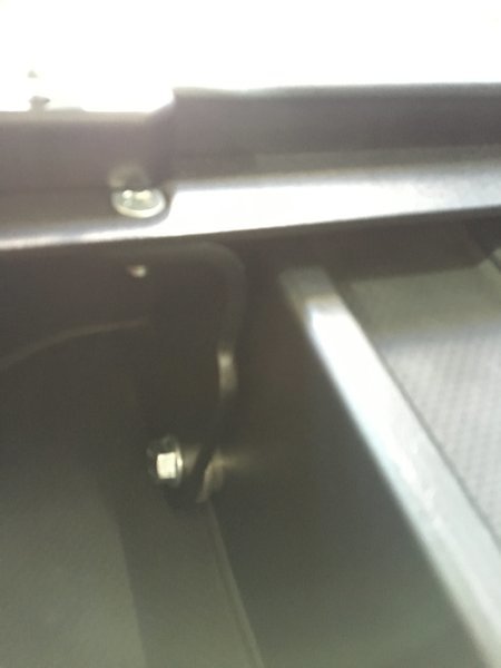

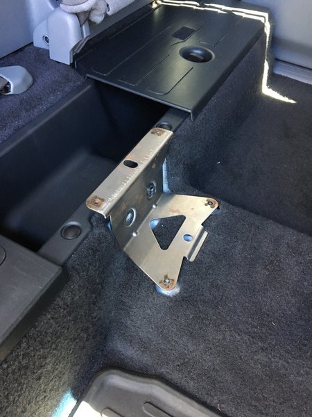

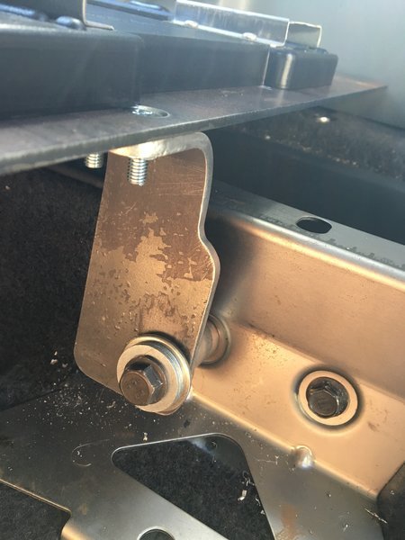

    Handily, there is a nut welded to the support sheet metal behind the carpet in the location of this front passenger side mount. Sweet!

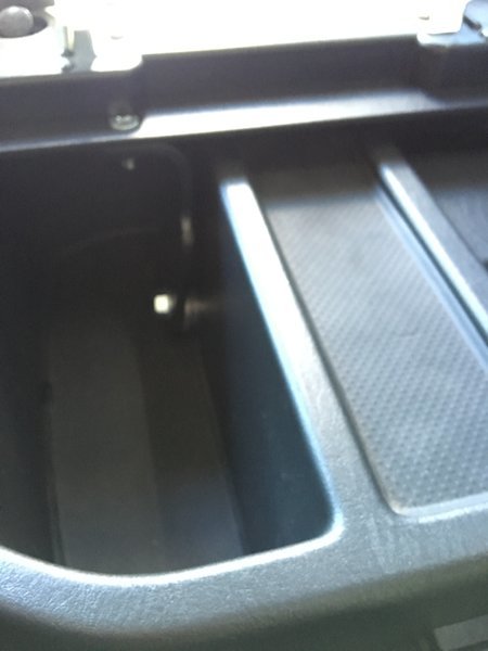

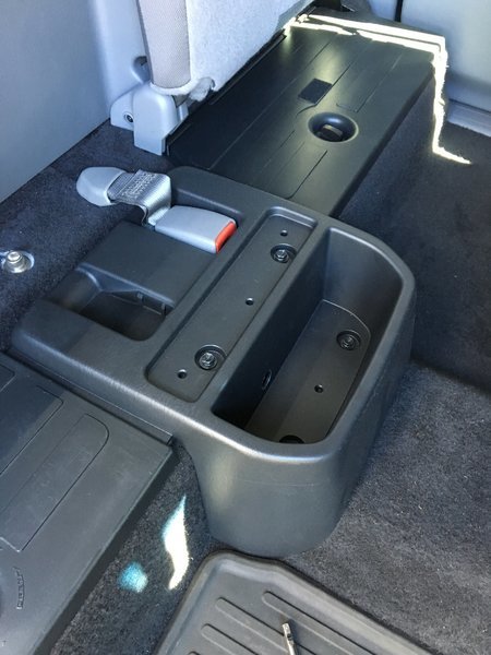

    The driver side front mount uses a mount for the substructure of the rear center console. I drilled a hole in the center console and have a spacer that will make everything line up and be pretty. You'll see!

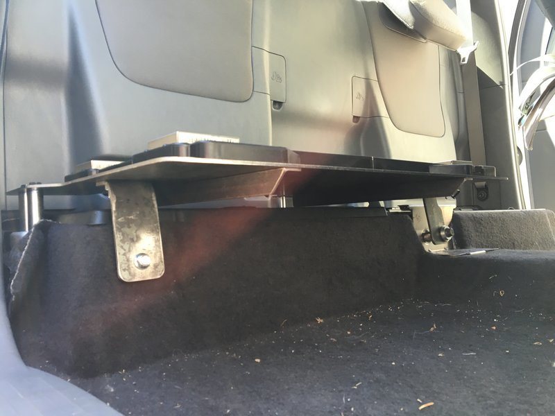

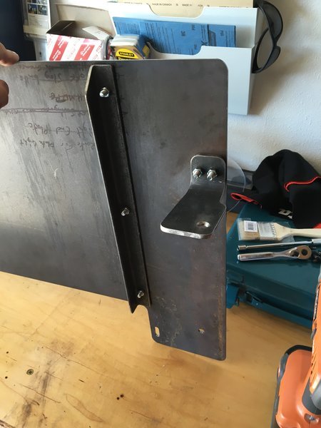

    This view shows the additional bracing I used to stiffen everything up. Probably not necessary but I feel good about it. The long angle braces use the same fasteners as the Transit Slide Lok.
    Another view of other stuff.

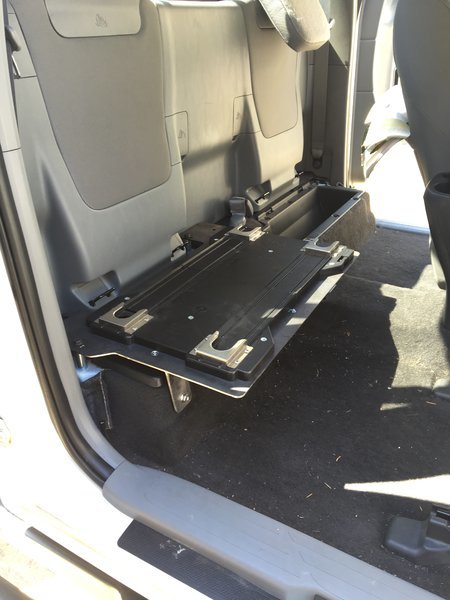

    Here's everything bolted in place. You'll notice I still have all of the floor space under the front edge of the mount. This makes me very happy...more room to store crap I'll forget I have!
    At this point, I mounted the fridge and drove around to see if anything seemed off or rattly or anything else. Seemed really solid and secure so I took it all apart and sent it out for powdercoating on Monday. I imagine I'll have it all back this Friday or early next week. I also took the opportunity to vacuum the heck out of the carpet and clean all the plastic back there. I'll update as soon as I get my parts back!

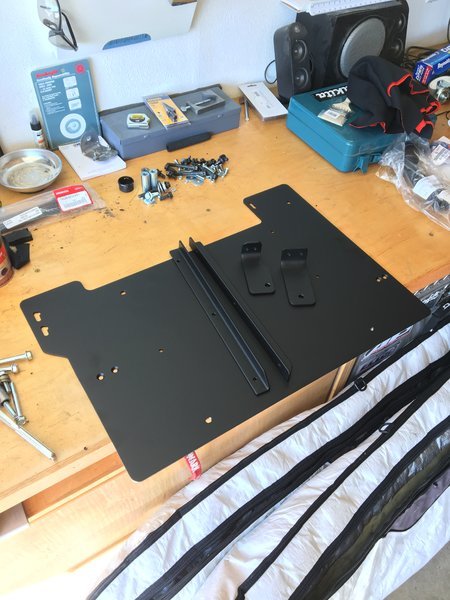

    Well, powdercoating ran long and I was out of town for a three day weekend. I'm back and so I got to work ASAP!
    Parts...powdercoated.

    Since I don't have a passenger rear seat, I don't need a passenger rear seat belt. This is an English fastener...and kind of odd. 7/16" (can't remember the thread pitch). I now have this fastener as an option for any future needs.
    Bolt the substructure for the rear center console back in. Just the drivers side bolt though. You'll use the second bolt hole later.
    Bolt the console back in place. If you look close, you can see the through hole I'll use for the fridge mount in the lower back of the big pocket in the console.
    Set the spacers in place.

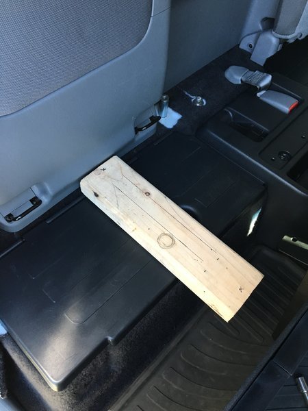

    Place this 2x4 here to hold the mount up while you bolt the mount in place.

    Carrying on...bolt it all in.
    Here's some really terrible photos of the front driver side mount. You can barely see the spacer I used. It looks good...just trust me. You can also see that I've put the rubber mats back into the recesses in the console.

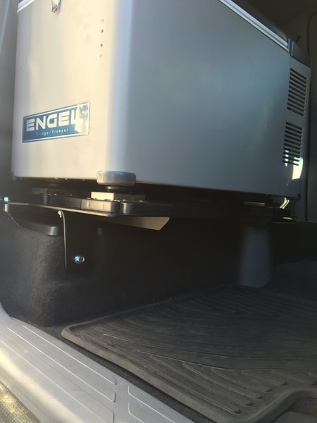

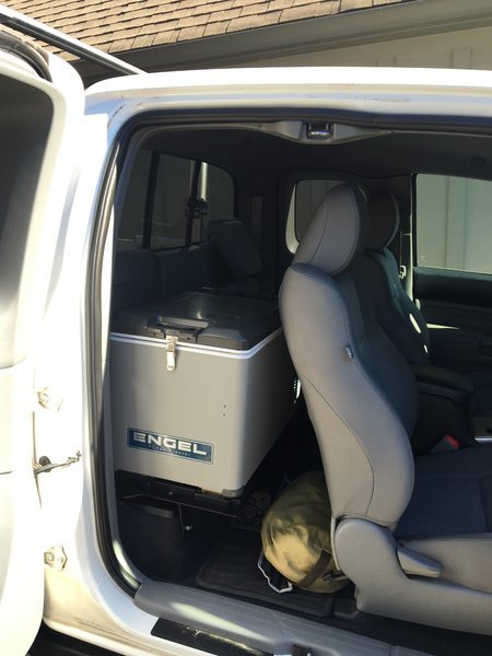

    All bolted in...solid! Also notice how much height the slide lok and feet add. Keep that in mind.

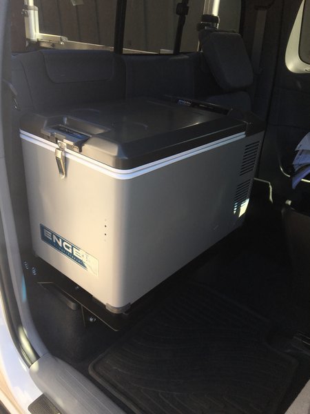

    Home at last!

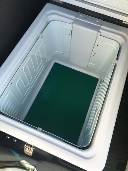

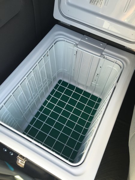

    Put this green non slip pad in.
    Drop in the basket.

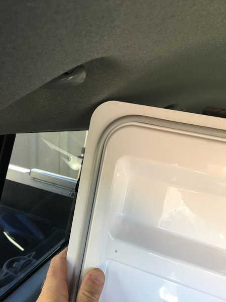

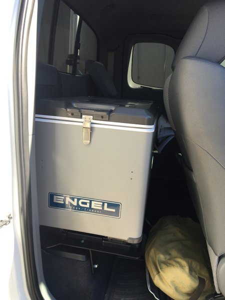

    Lid clearance when opening. CLOSE but clears! An MT45 wouldn't fit without ditching the slide Lok and lowering the mount in general...as much as you can. Or just live with the lid not opening all the way.
    Seat in a normal/comfortable position for our 5'11" ish bodies.
    Plenty of clearance! And the lid opens fully without touching the seat at all. If you're taller, you can move the seat back more but then you'd have to pitch it forward to access the fridge. Not the end of the world in camp but we're happy to not need to.

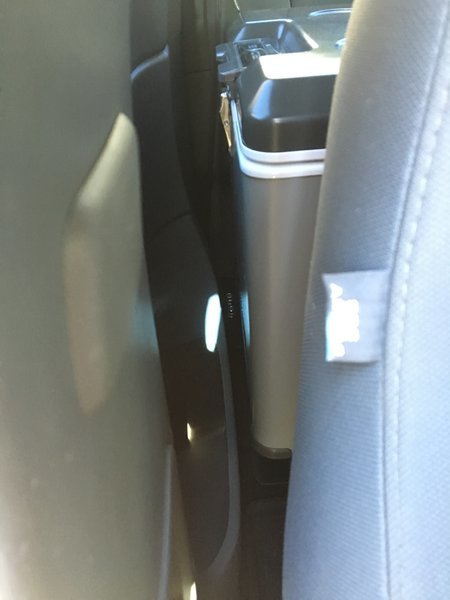

    Back door closed looking back from the front seat. You're looking at the clearance between the door and the fridge. Again, close (to maximize rear drivers side passenger room and easier access to the inside of the fridge).
