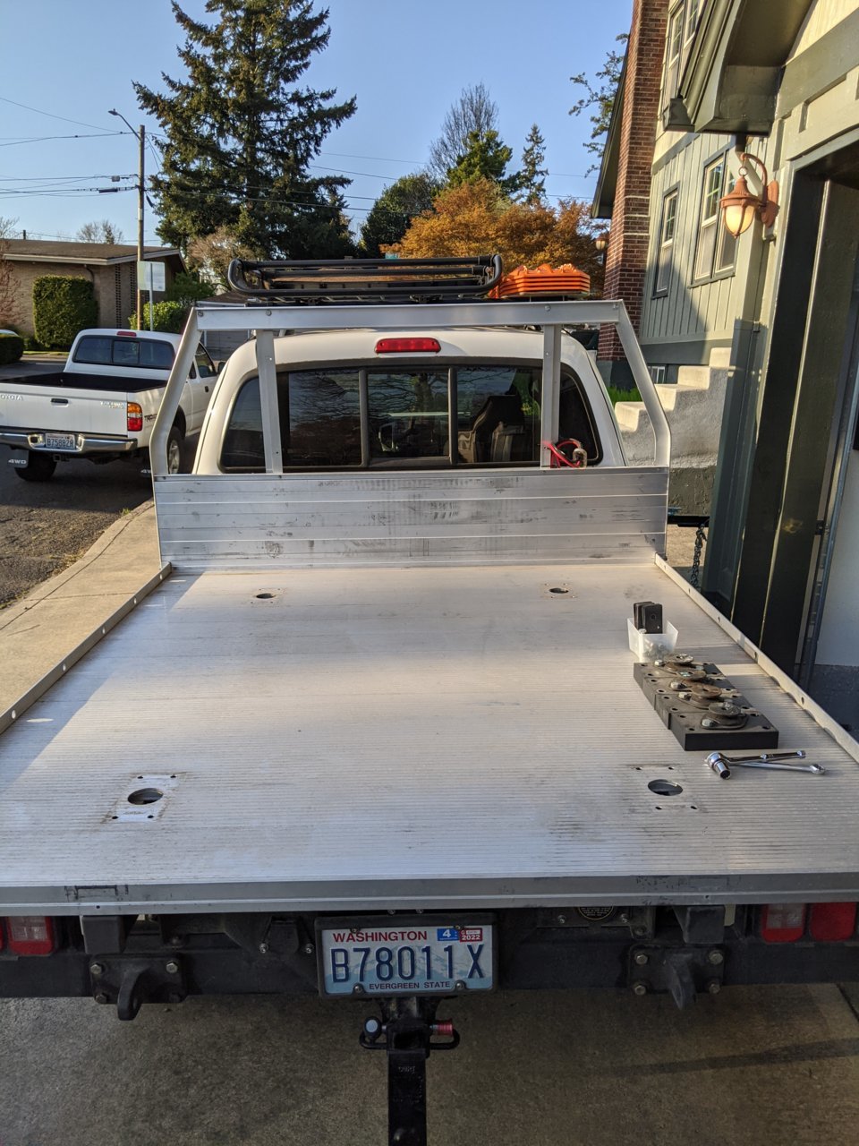

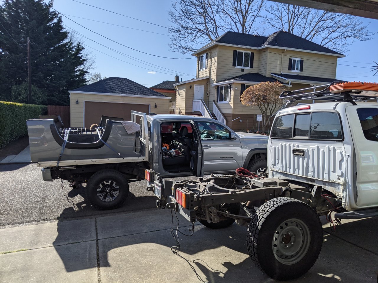

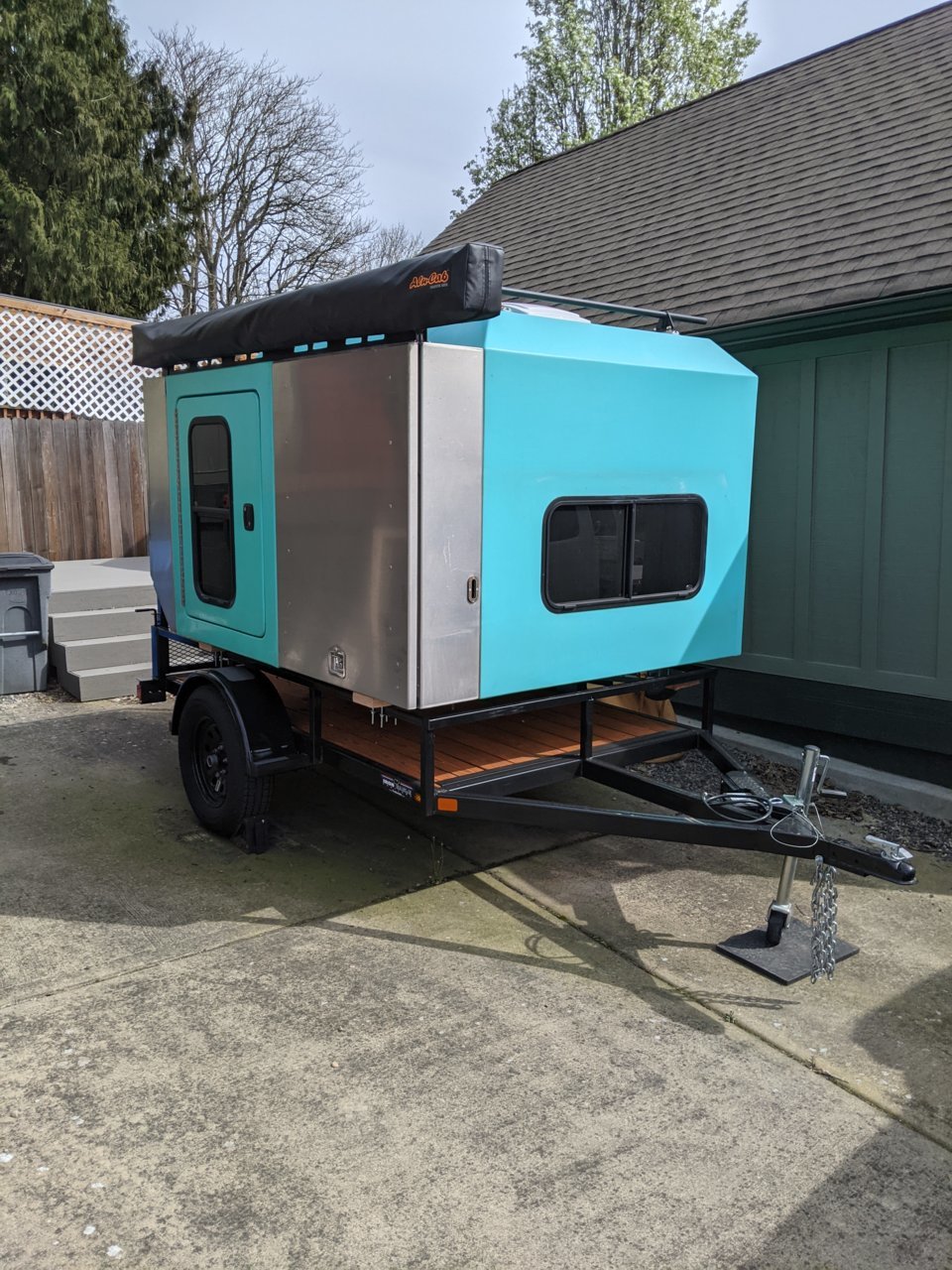

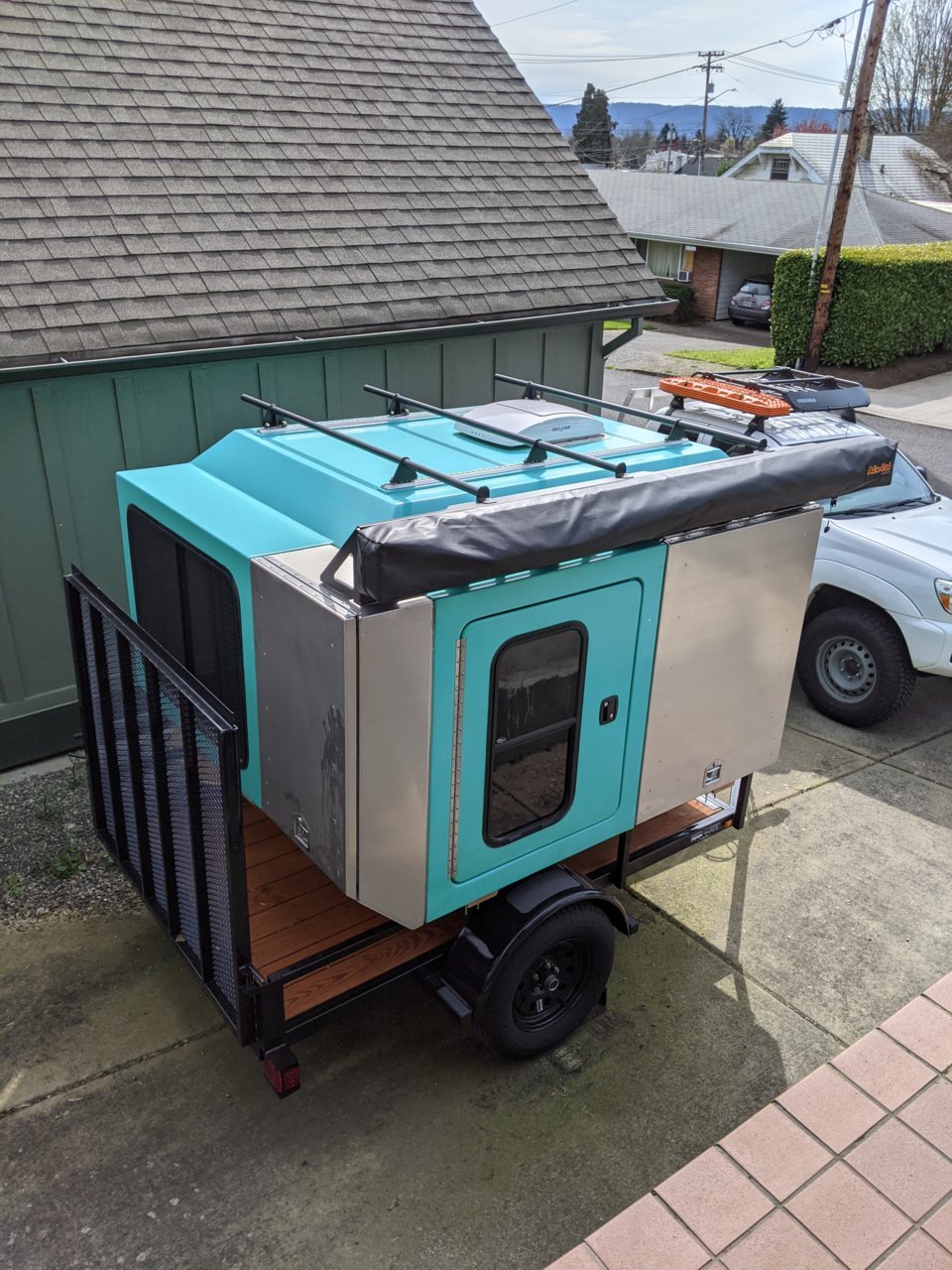

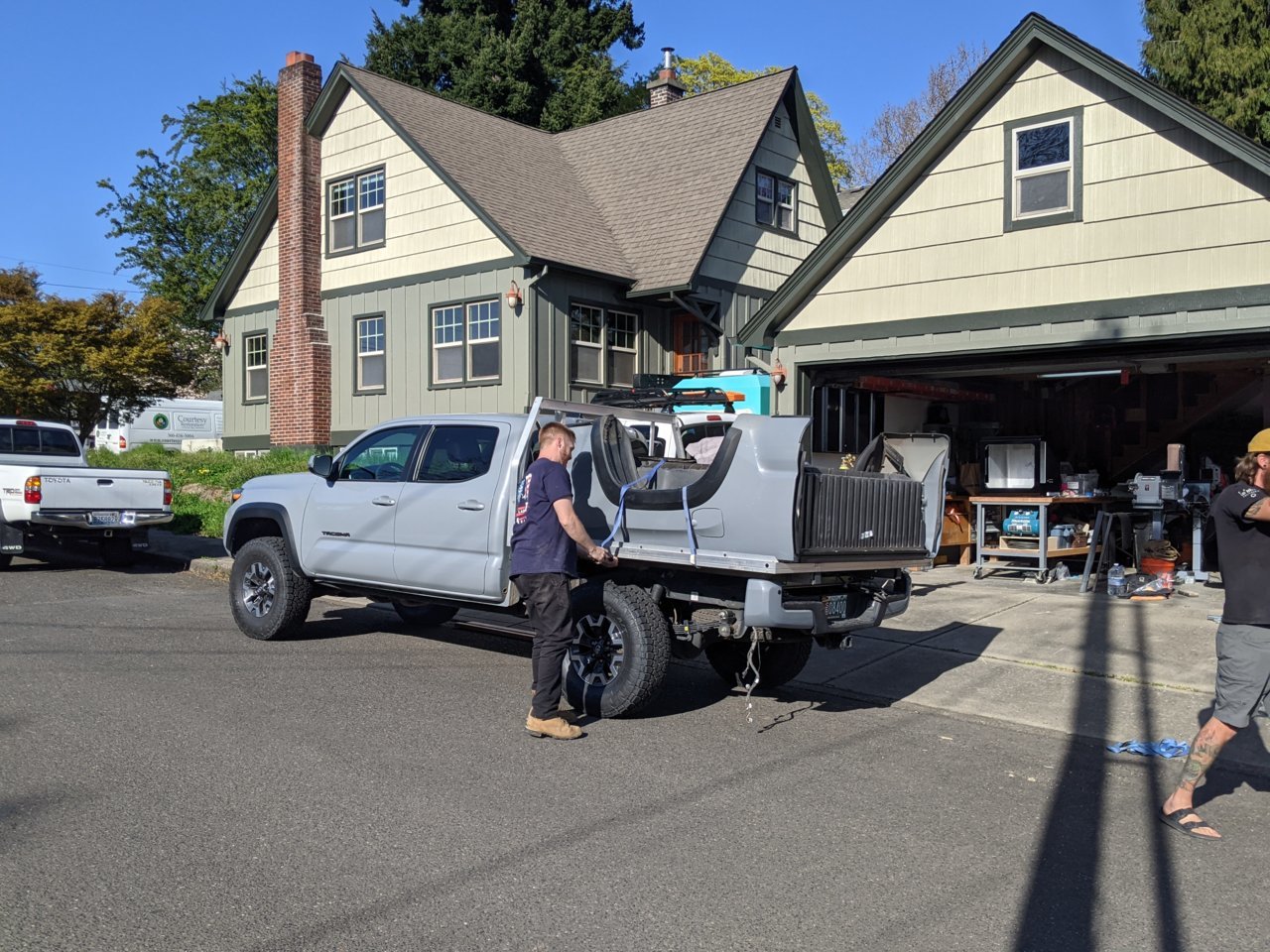

    Pretty big day today!
    Pulled the camper off the flatbed and mounted it on the trailer. Temporarily of course. But now I can really dive into all the mods I want to do!
    The truck looks totally badass like this. Flatbed, grey steelies and roof rack. I haven't driven it yet without the camper but it's going to be a rocket ship by comparison!
    HomerTaco, Slashaar, Spintly and 6 others like this.

    How did you move the camper to the trailer?
    Forklift? Engine hoist? Drunk friends?...

    Good question. I borrowed my friends very long and very flat driveway and rented a pair of those janky looking tripod, hand crank camper jacks. They look super sketchy but worked very well. I didn't take any photos because it's kind of a precarious operation and we just wanted to wrap it up so I could return the jacks that same day. I'll try to capture the process better when I put the camper back on the truck

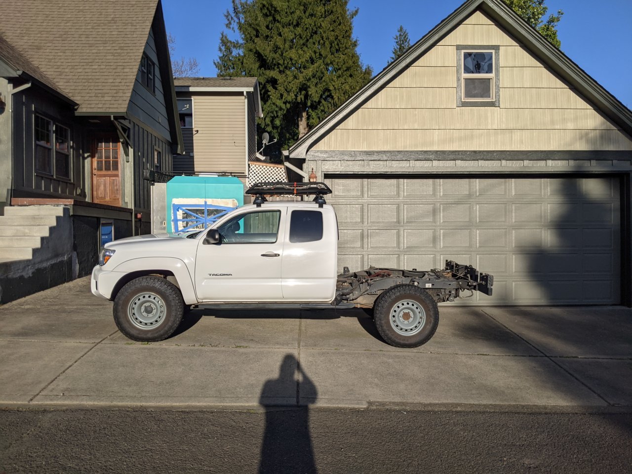

    And just like that...
    No camper mounts! Now I need to get this thing to a quarter car wash and give it the cleaning of it's life. It's grimy.

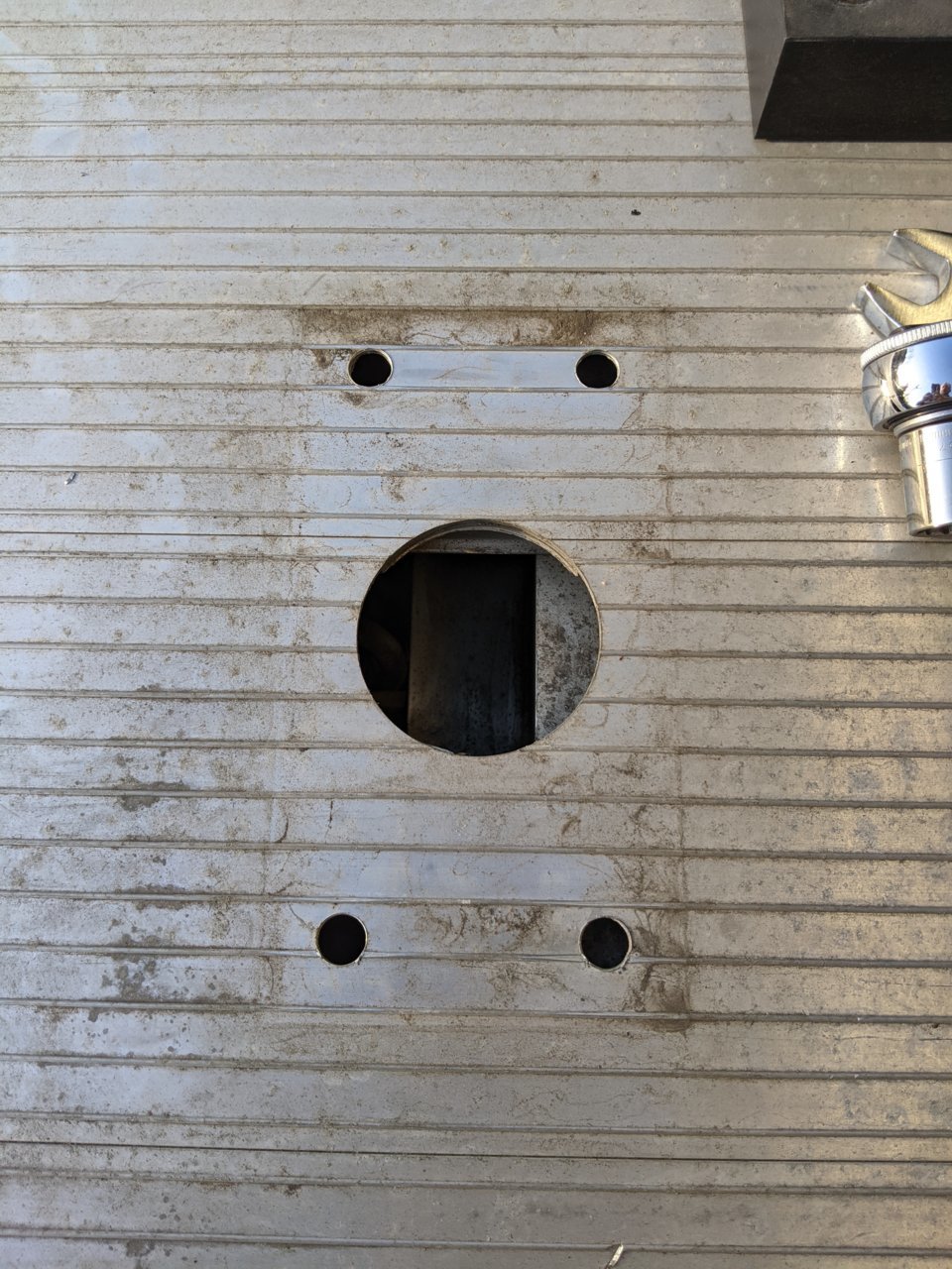

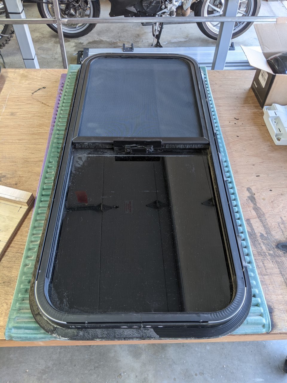

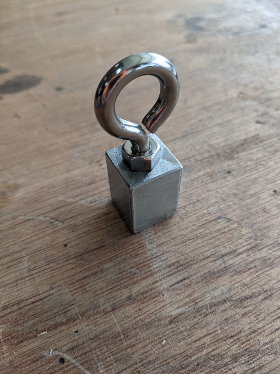

    I didn't like the way the AluCab awning strap mounted so I made this little number. This should slide into the end of the last awning arm. Then I'll through drill and put a bolt through to capture it all. This gives me a nice place to use a strap and caribiner to hold the awning open. At least in theory. I haven't test fit it yet.

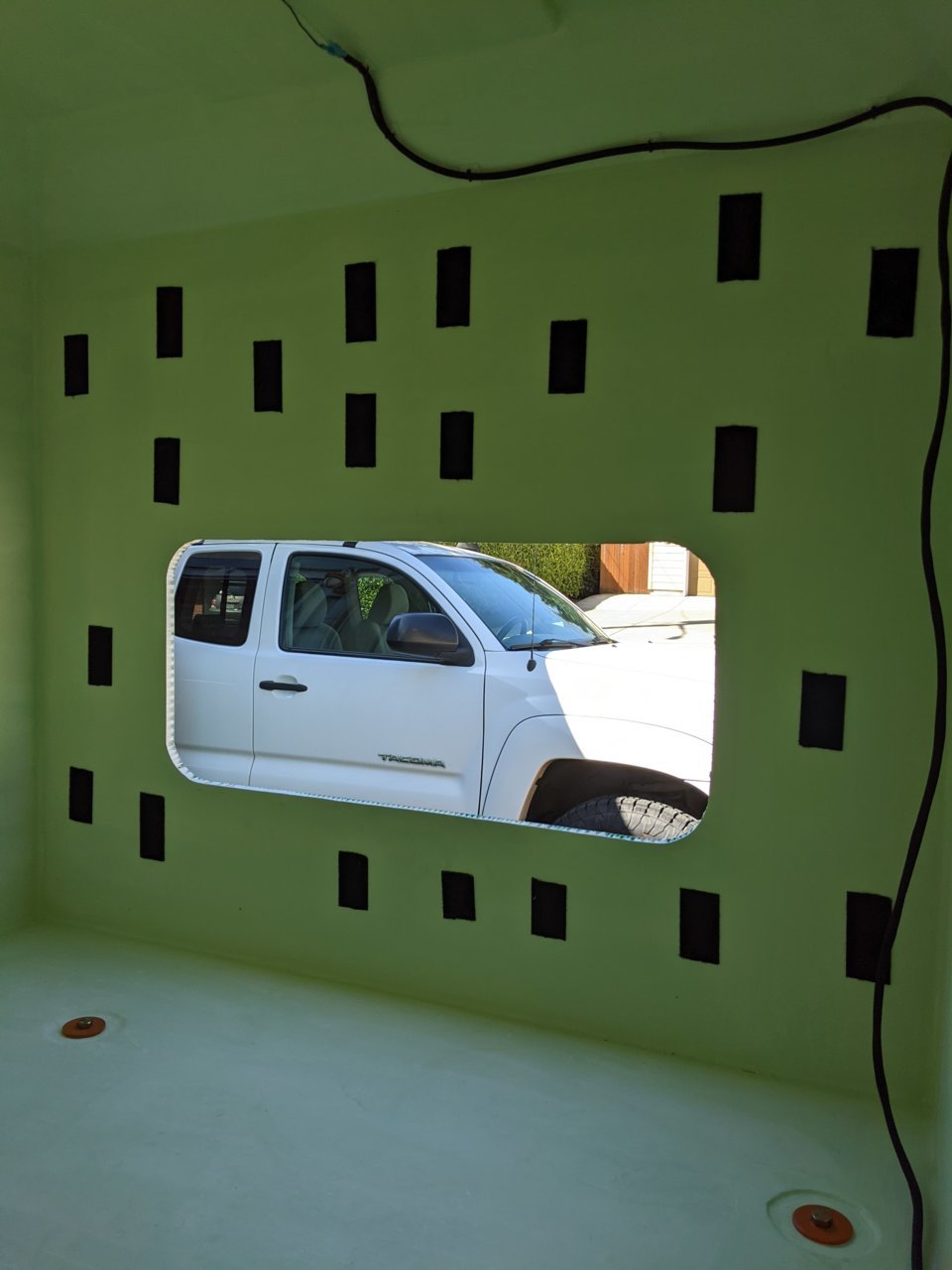

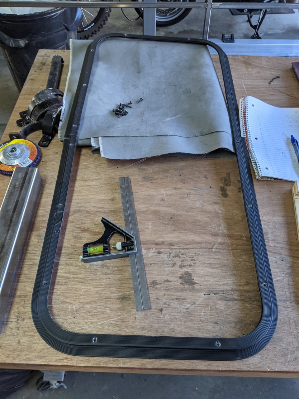

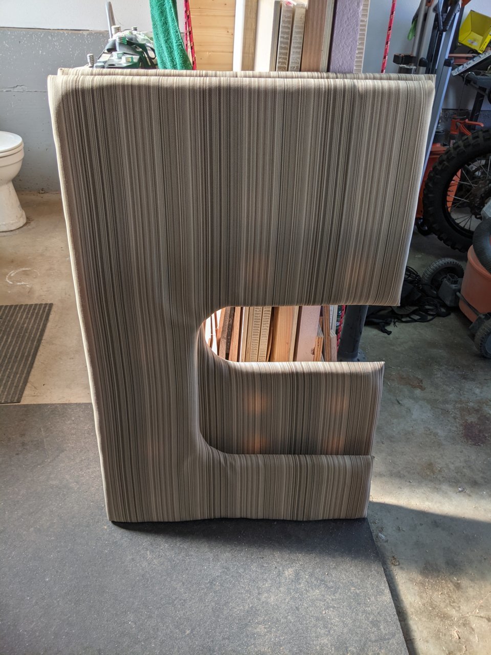

    I pulled out the padded walls from the front wall of the camper.

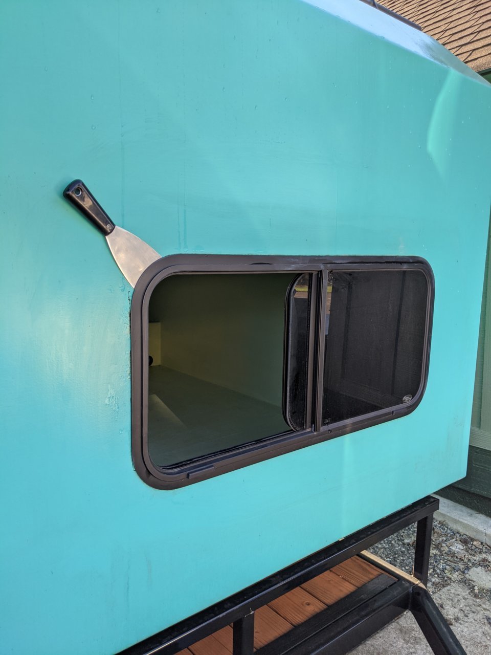

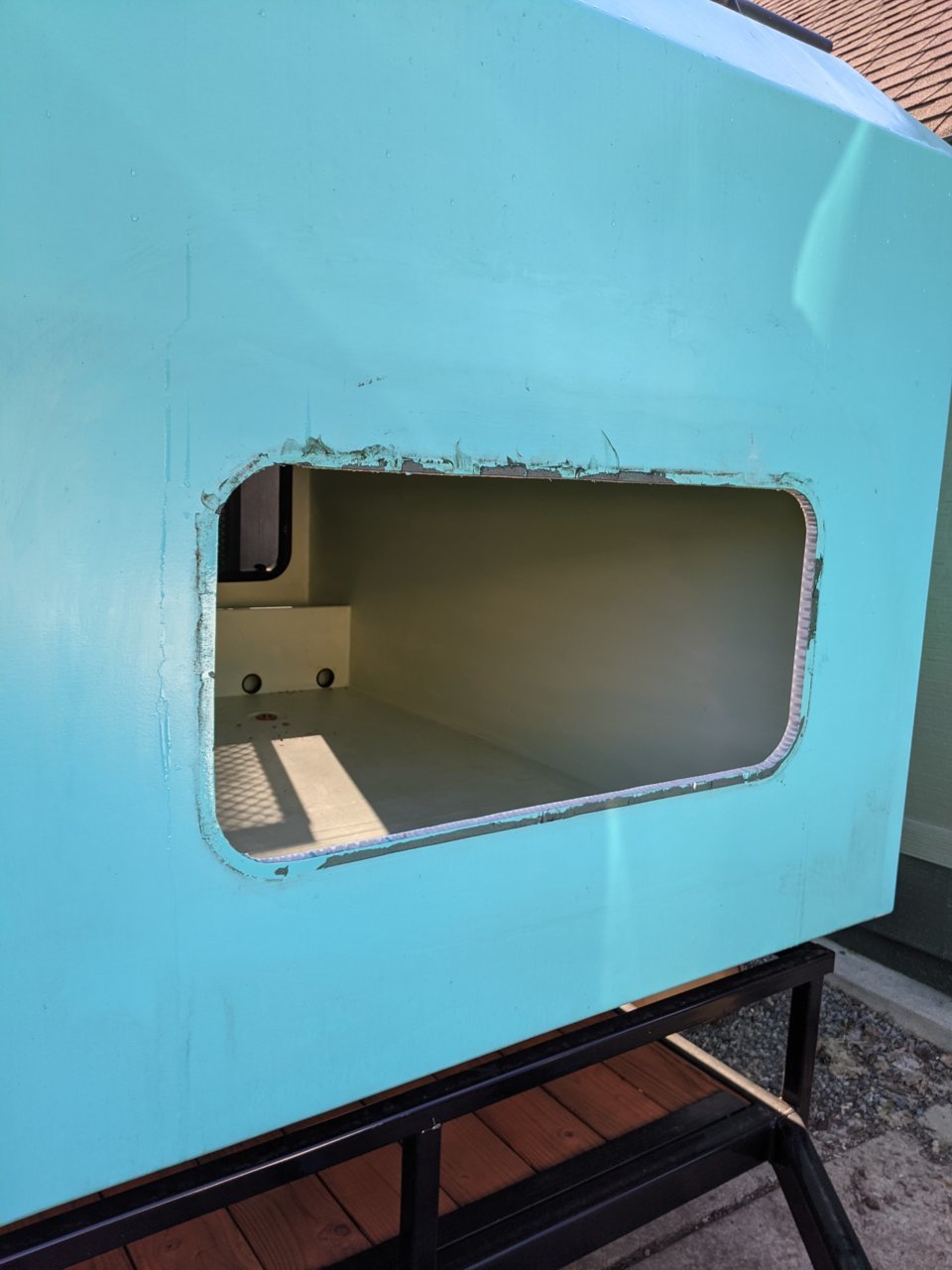

    Began the process of pulling the front window. The inner trim ring is already removed. Then you work your way around the outside with a putty knife to separate the foam seal tape.
    Then pop the window out!
    And clean all of the adhesive residue off with your favorite adhesive remover. It's 3M for me.

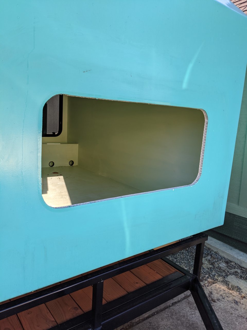

    I'll clean up this window and get it on craigslist. I have several other things to list as well.
    Next step is to sand the paint off and get down to bare fiberglass around the window opening, cut a filler panel, epoxy in place and glass over it all. That's my goal for today. I don't expect to get any farther. Depending on the time, I may wait to glass over it all until a later date. I don't like glassing just before dark when it gets this cold at night and has as much condensation as I've been seeing. Off to go spend money on epoxy!

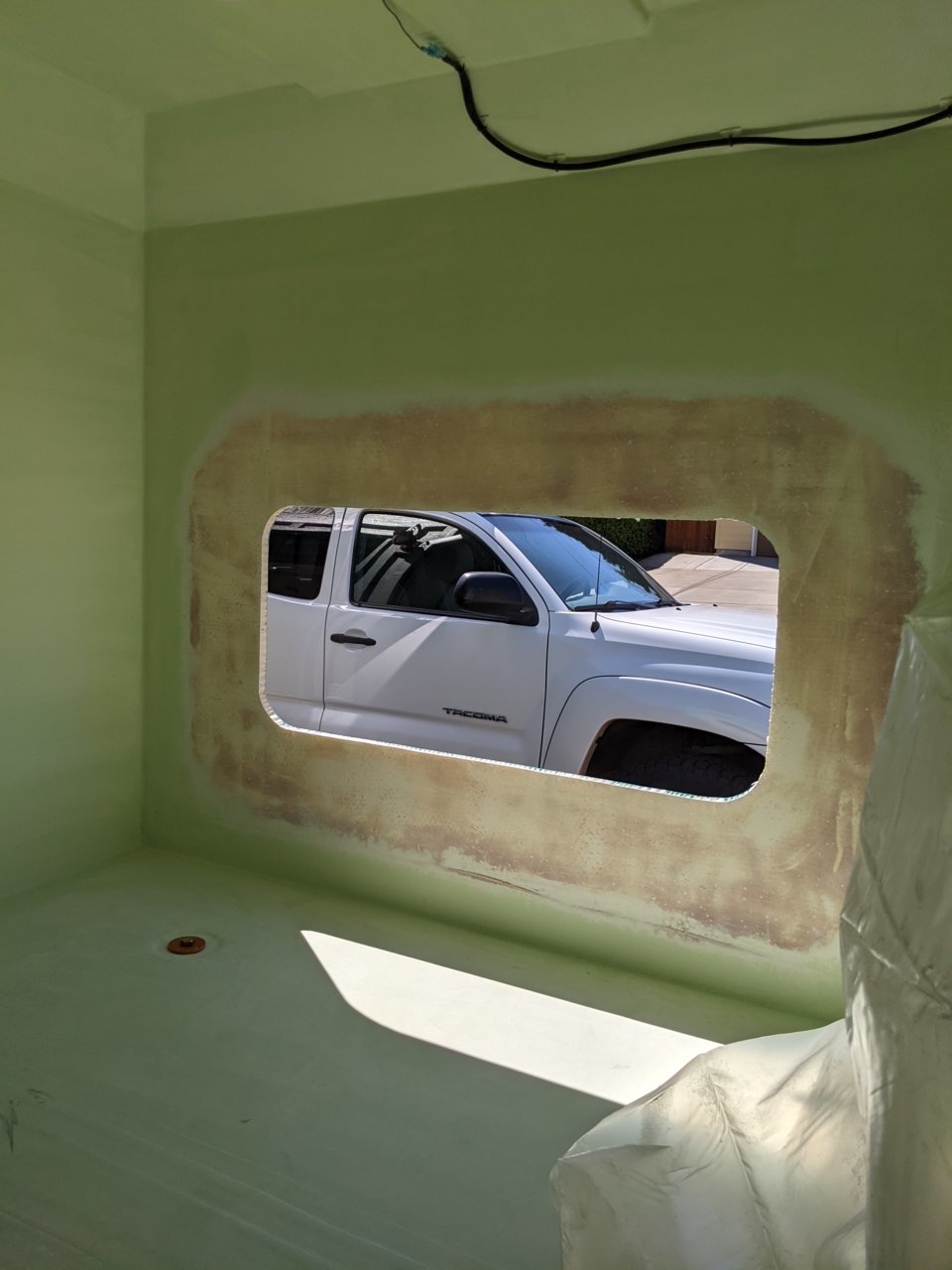

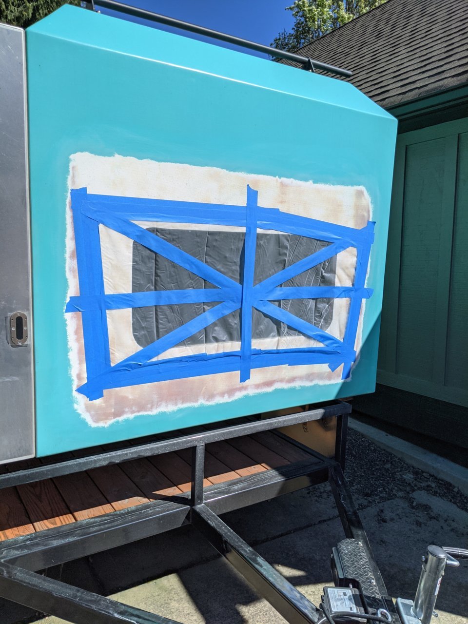

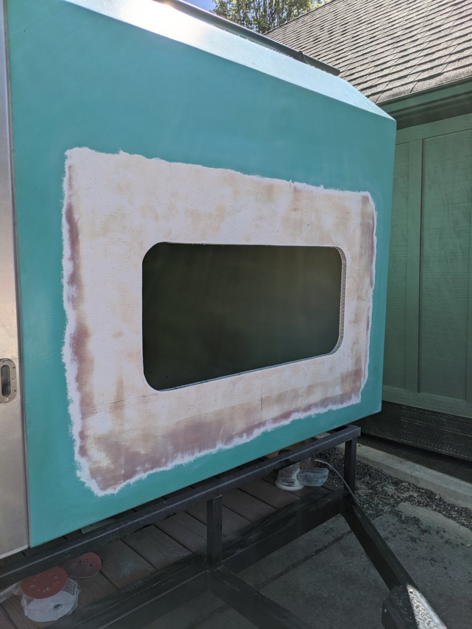

    Exterior sanded. That marine paint with the "performance enhancer" additive is pretty tough! This took a lot longer than I thought it would.
    I don't know what dufus thought this much industrial grade adhesive backed velcro was necessary to hole up two lightweight panels. This was the stickiest, messiest, craptastic adhesive removal job I've ever done. I will be using much less of this for the new panels.
    And there it is. All sanded up and ready for a patch panel. But, I'm pretty over the whole thing for the day so I'm not going to do the patch panel for a few days. I've got a project for work that I'm building in my garage for a couple of days so I need to keep my space clean and focused on that.
    We'll see how long this holds. Where I live gets pretty windy...I don't have high hopes. I'll be lucky if this isn't the neighborhood litter box or a raccoon birthing suite by morning.
