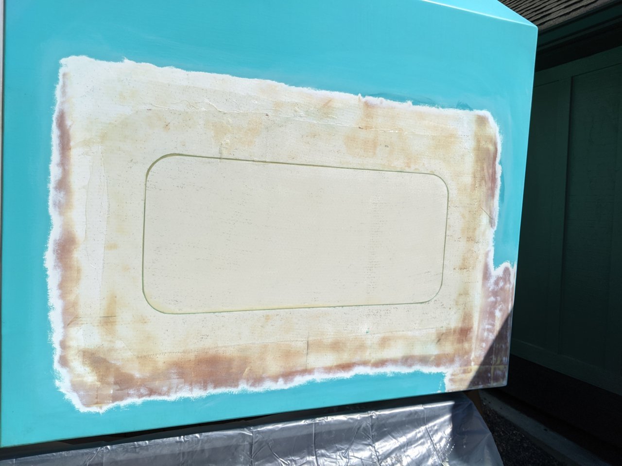

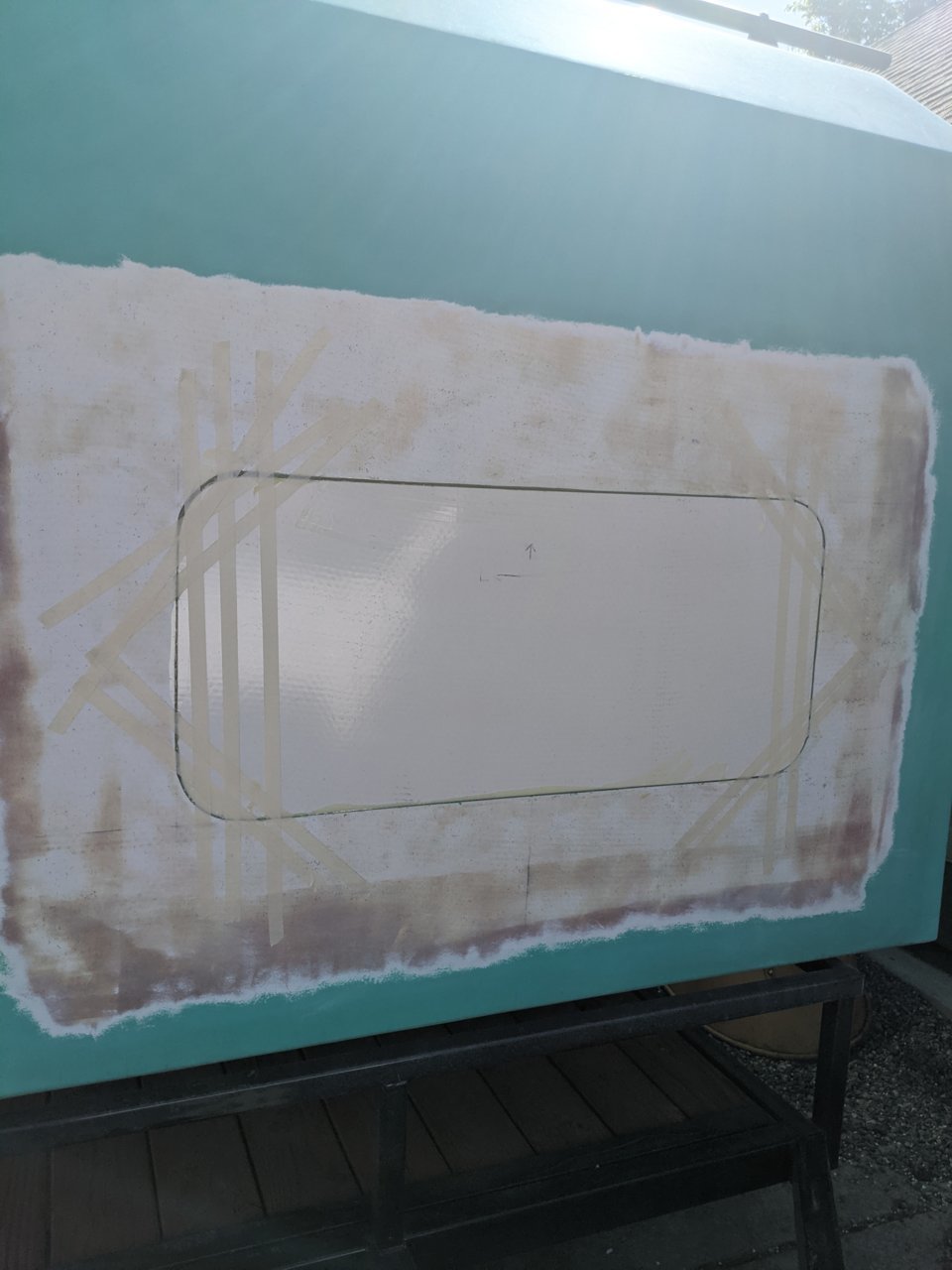

    Patch panel roughed in.
    Now I wait... Wait for the epoxy to cure then sand it all down. Then the process to glass and fair it all in.

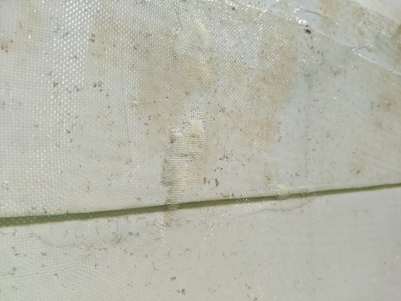

    First layer of glass on the outside. I sanded down the epoxy used to fix the panel in place then wiped with acetone then epoxy, glass and more epoxy. A bit of squeegee action and here's where I am. I don't have enough glass to do the second layer right now so I'll have to go buy more. No biggie because...
    With all of the folds in this glass fiber sheet I had, I missed that a portion of it had been affected by a drop of epoxy in the past (probably). So it is a bubble that can't be fixed. I'll wait until this cures then sand that out, epoxy fill the void and glass over it again. No big deal...it happens. Especially when you're as scattered and sloppy as I am sometimes! :D

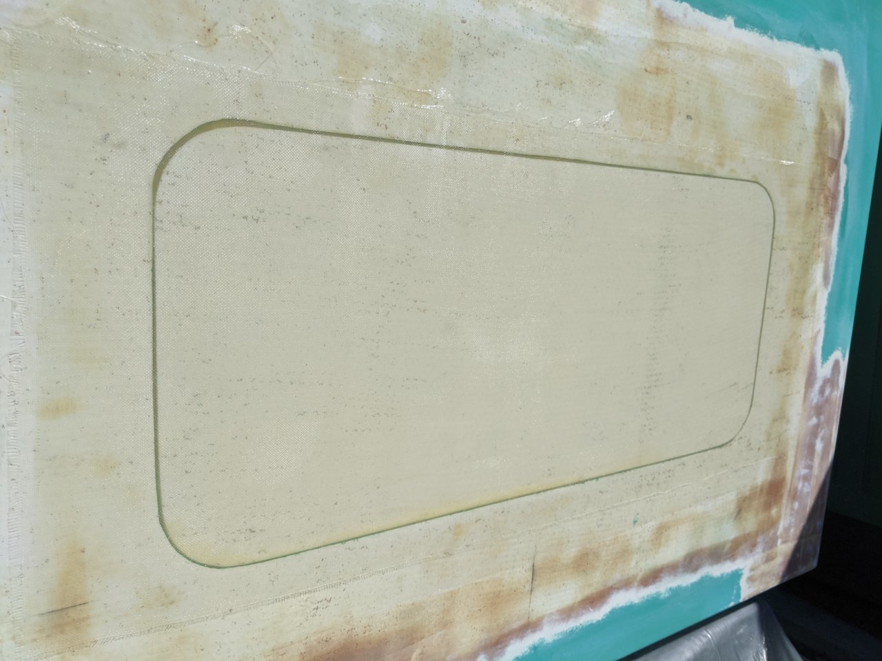

    Rough sand layer one, clean with acetone and epoxy layer two in place. This will cure then I'll move to the interior tomorrow. I just don't feel like doing more than 15 minutes of work at a time, I guess. :rolleyes:

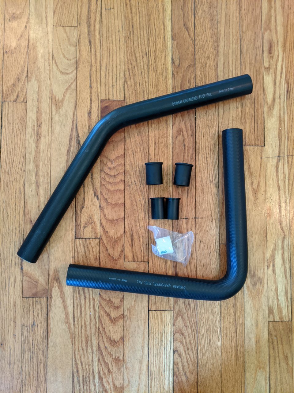

    I also received my order for the backflow valve system. There is a small, easily replaceable backflow valve, some reducers and a couple of pieces of tubing. I didn't know exactly how I wanted to arrange this on the truck so I just ordered enough stuff to do it several ways. :thumbsup:

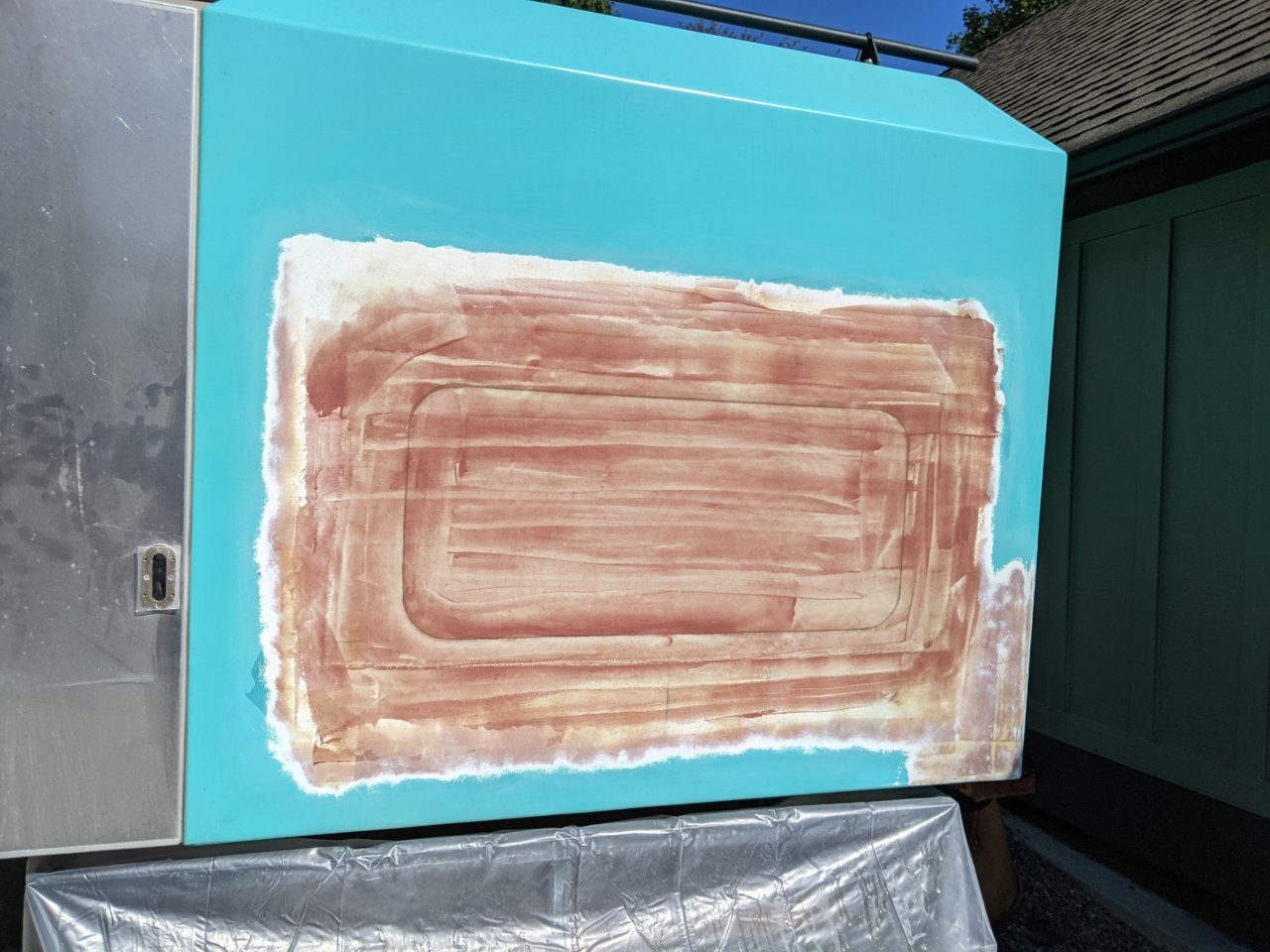

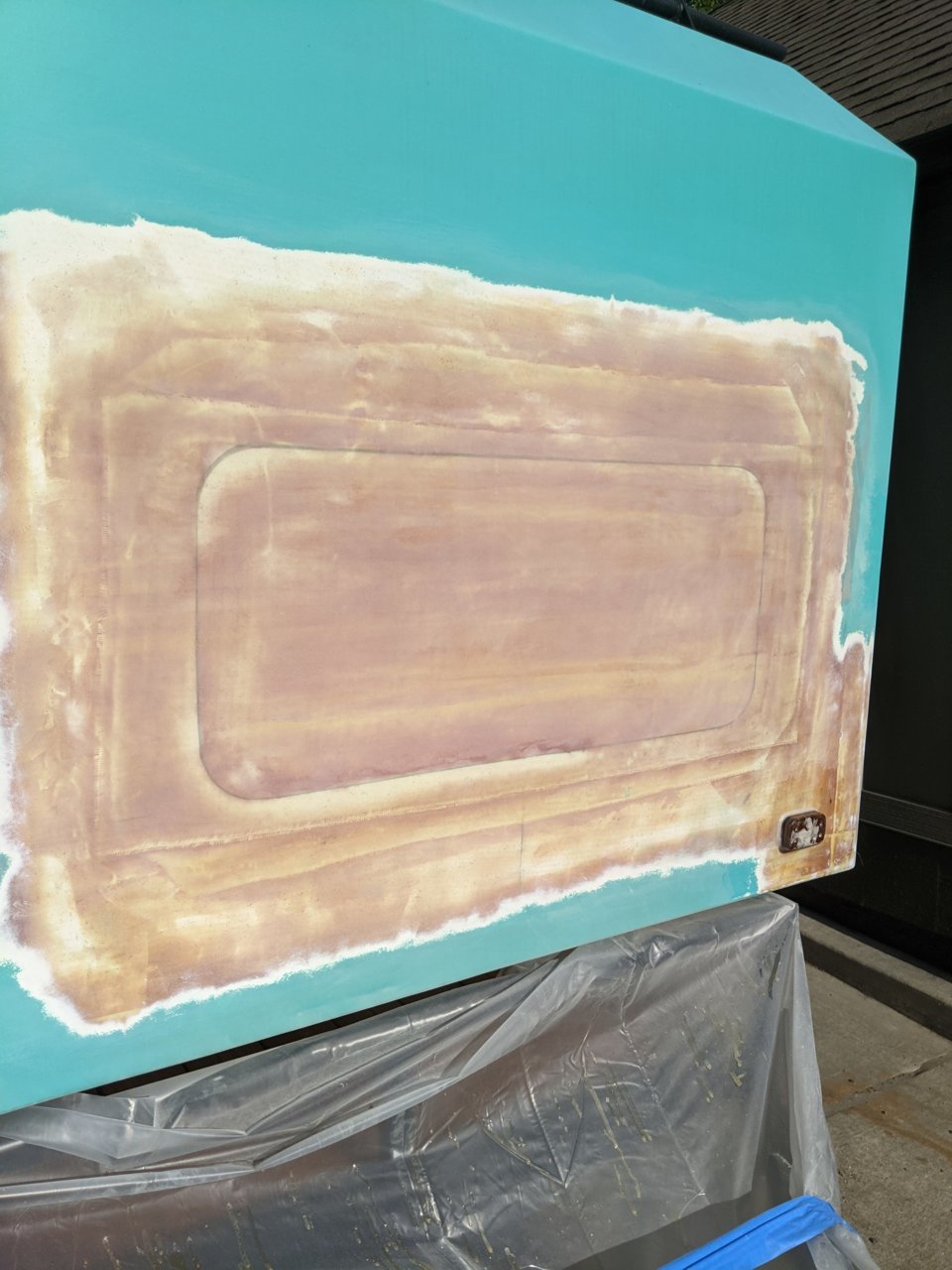

    Took a little time just now to work on the camper. Rough sanded the exterior glass, wiped with acetone then added a layer of fairing compound. I'll sand this down tomorrow after it has cured.
    I also sanded the first epoxy bead sealing the patch panel on the interior. Then I wiped it with acetone and hit it with another layer of thickened epoxy and used a spreader to fair out the difference between the patch and the wall. I'll sand that smooth tomorrow and add both layers of glass at the same time for efficiency's sake.
    Then I'll brace for rain for the next 7+ days. Which is fine. I'll get my subframe designed and out for cut/bend during that time.

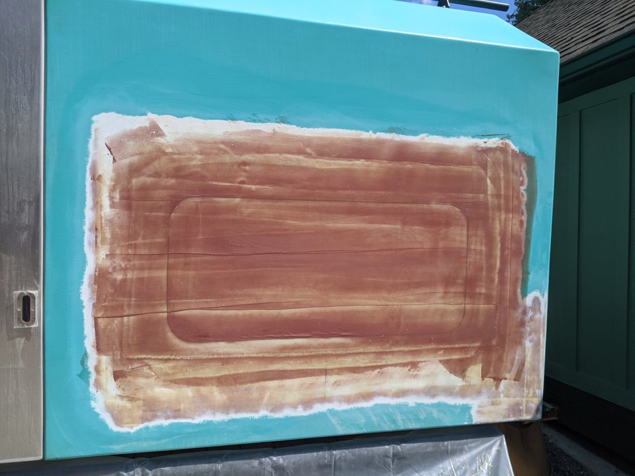

    Sanded down the exterior and decided to go with another coat of fairing compound. It may take several rounds to get it where I want it. No biggie as long as we don't get rain.

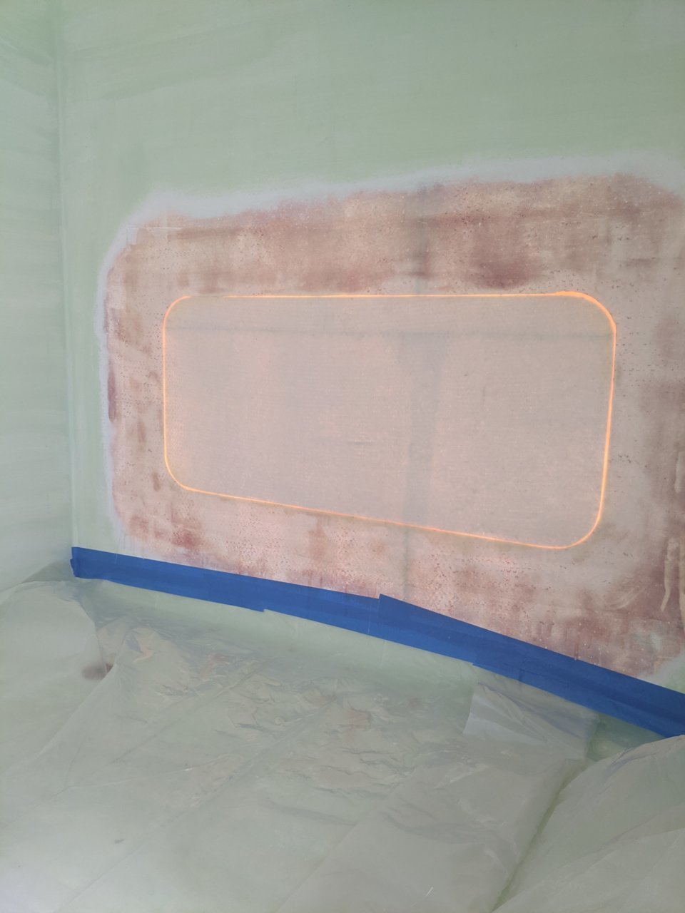

    I also got two layers of glass over the interior patch area. I sanded any epoxy runs and glass edges down already too. I'm not going to do much here as it will be covered with padded panels. I'll give the interior a good cleaning then prime and paint. I'll do that the same time I paint the exterior and use the same seafoam paint color.

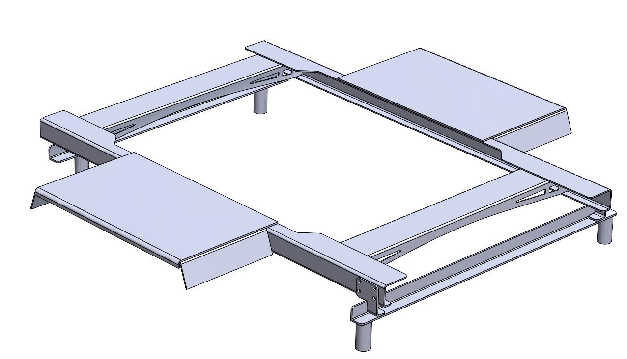

    I got all of my files out for cut/bend for my sub frame yesterday. Got the quote back and gave it the green light. 2.5 weeks or so lead time.
    This doesn't show everything but it's close. It will mostly be aluminum except for the angle steel crossbars and four brackets. The parts that bolt directly to the frame will be steel. Everything from there up is aluminum. Not unlike the flatbed this replaces.
    I still need to buy some lengths of angle steel and aluminum for brackets that I can easily cut to length in the garage. No need for custom parts or their cost. And there will be a decent number of fasteners needed as this is most entirely a bolt together system. I went that route for speed and flexibility during initial fitup.

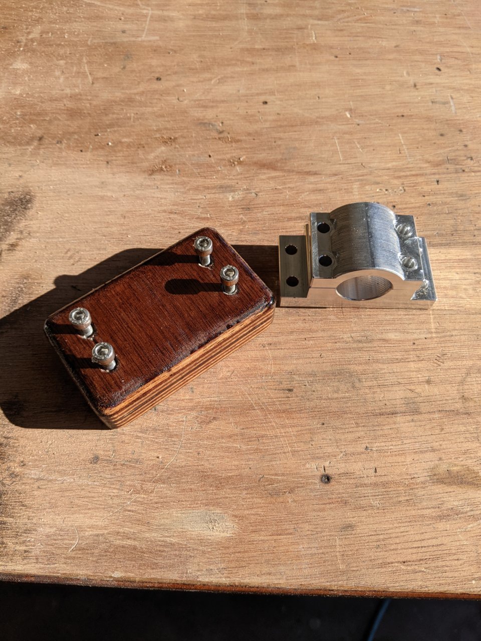

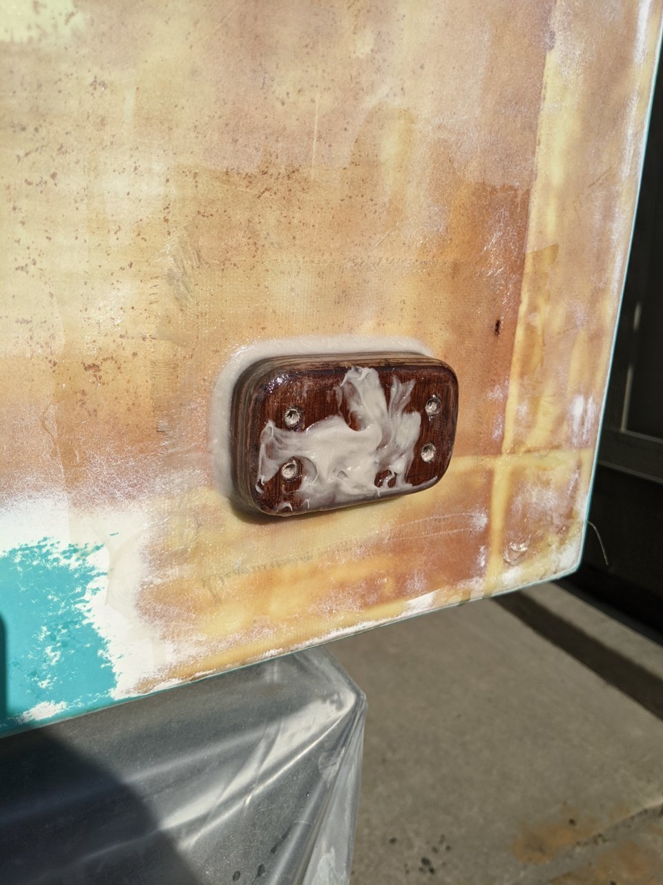

    I got a new fuel filler mount machined. And I started making the mounting lug that will epoxy and glass to the front of the camper. I should be able to wrap this up this week. Once that's on the camper, I can do any finish sanding necessary then prime and paint. I need to get on it so I'm ready when my subframe is ready.

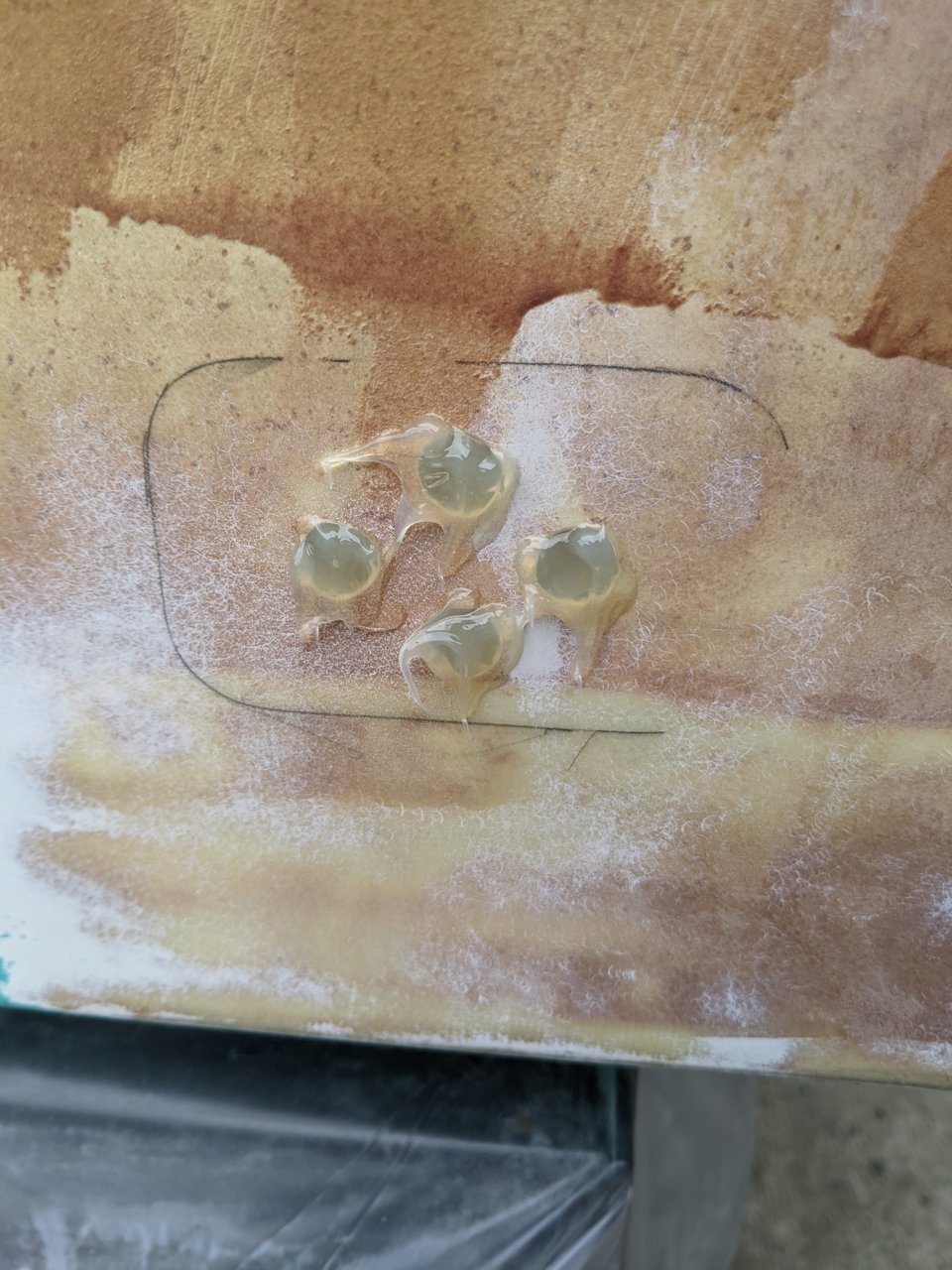

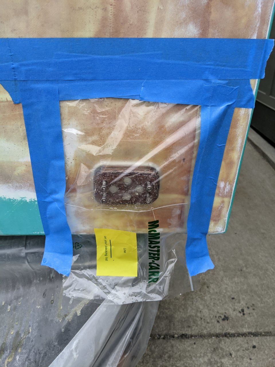

    Get the placement and orientation where I want it and drill some pilot holes. Drill those out, clean out the plastic honeycomb then fill with epoxy. This will give me a good plug to drill into, dill with epoxy then screw in stainless steel screws.
    Then lay two layers of fiberglass, epoxy and screw the mount base to the camper and epoxy fill the screw heads. The epoxy is such a mess because I put a fresh layer of laminating epoxy on before the thickened epoxy so the thick stuff only had the way more slippery laminating epoxy to hold onto...which it doesn't very well. This general method is the same way I attached all of the L Track to the side, top and back of the camper.
    Oh, I also sanded the last application of fairing compound. Once the fuel filler mount is finished, I can paint this.
    Put a good epoxy fillet around the base then placed a strip of fiberglass over the top of the fuel filler mount in each direction. It started to rain so I sealed it up to cure. When it's dry again on Friday, I'll sand this smooth, apply an epoxy coat and another layer or two of glass over the whole mount. Them a little sanding, fairing compound and more sanding. THEN it'll be ready for paint. Hoping to get primer on this on Sunday. That reminds me, I need to go buy primer and paint. Hopefully it's in stock!
    My subframe parts should be ready to pick up tomorrow. Fingers crossed they're done as it seems to be a good day to take a break from work to pick them up. In reality, picking them up anytime before this weekend would be fine.

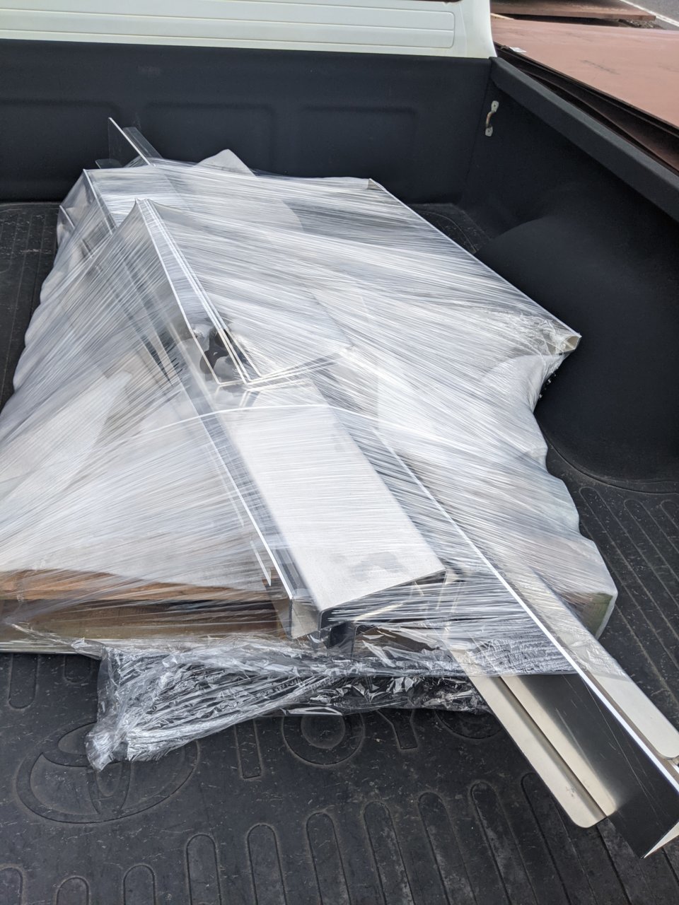

    Picked up all of my subframe parts this morning. Got something I didn't expect so I had to check my paperwork. I did a typo...instead of .125" I typed .25" on my fender tops. So those are now ridiculously over done for what they are. They are aluminum so that's good but still. I'll mock those up into place and see if it's good or just too much then decide what to do if anything.
