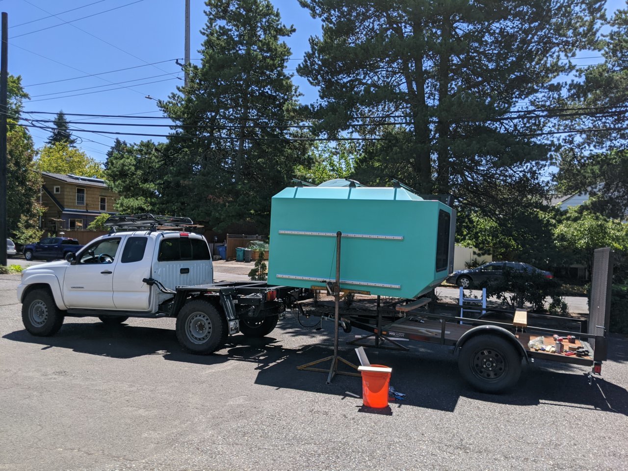

    The crux of the camper transfer. I hustled all day to get this done. Camper is on the truck and everything is hooked up. My aux battery is dead though so I'm trying to charge that now. We'll see how that goes.

    How long did the actual transfer take minus hook ups? Was it as precarious as it looks?

    Those camper jacks seem terribly unstable but they work pretty darn well. I had to do it twice. Once to locate the camper on the subframe and transfer the mounting holes. Then remove to drill all the holes and mount the body mounts. Then put the camper back on to bolt it down. It took several hours just to be careful, make sure everything is stable and positioned exactly where I wanted it and just generally try to be precise. If I were to pull the camper off and put it back on now that all of the mounts are in place, it'd take about an hour. That would be to remove and reinstall.

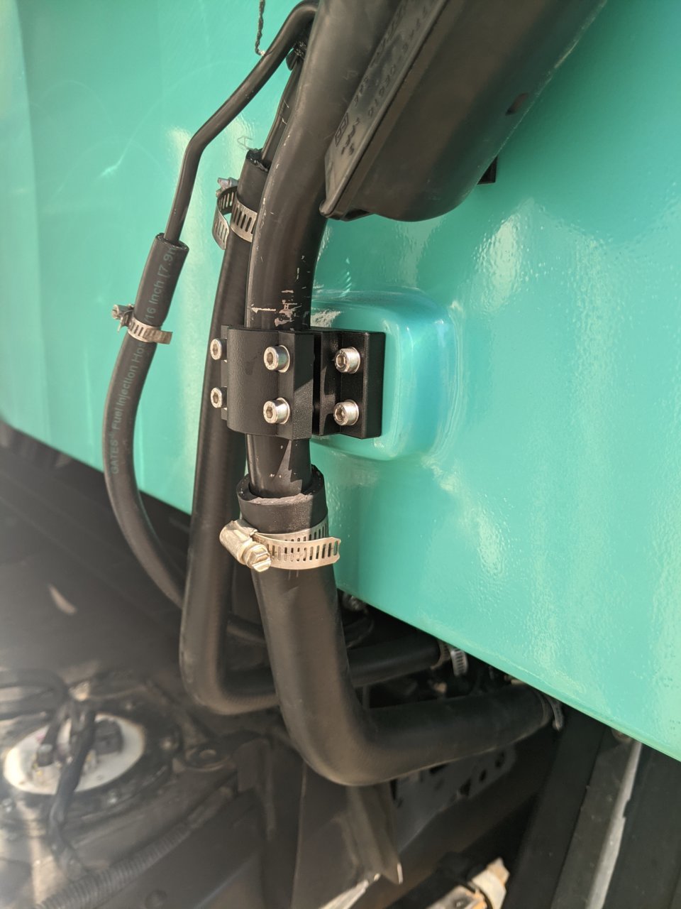

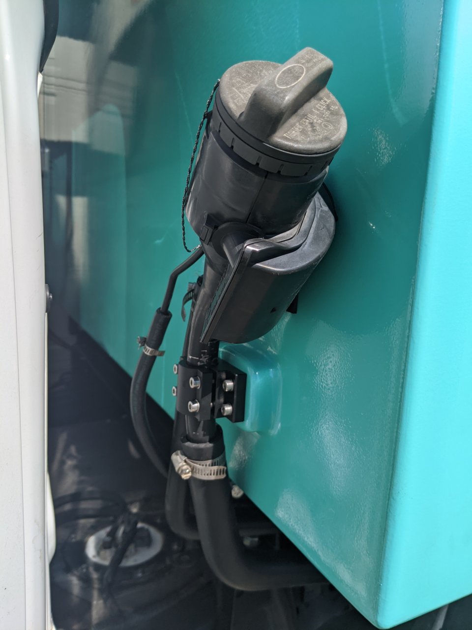

    I never posted anything about my fuel filler.
    Mount seems to work pretty well. Though I haven't filled up since the camper was mounted. It looks like it'll work well. Haha!
    And a shot of the preformed 90 degree bend hoses I bought. So much cleaner than it used to be. The new backflow valve has been working perfectly so far. And it's easily serviceable without removing the camper or fuel pump or dropping the tank. I hope my issues with overfilling are behind me for good.

    Wow! I appreciate the amount of work that went into that! My filler is still zip tied. Amazing how something so little and simple can be such a pain.

    The mount system I had on my ute was great. But it was a spendy bit to have machined. It was the same as the one I have now but this new one is just twice as wide.

    I am trying to have a way for the nozzle to be covered from getting covered in mud while also not affecting the ability to fill up. My previous Jeep gas cap thing worked well for the mud but I couldn’t fill up without the nozzle clicking all the time.
    I have to spend some time on it but it’s hard as it works essentially lol.

    - Do you think a foam can cozy will cover the filler nozzle? With just a tab of opposing velcro to keep it on there when trucking down the road? (I'm guessing as I don't know the diameter of the nozzle.)

    I've not had any issues with mud on my fuel filler. But my tires are relatively tucked in and my rock rails stick out a bit (new ones will stick out even further). And I don't typically find myself in massive amounts of mud. But, yeah, I think a can koozie is a great way to go. I bet it's fit pretty well.
