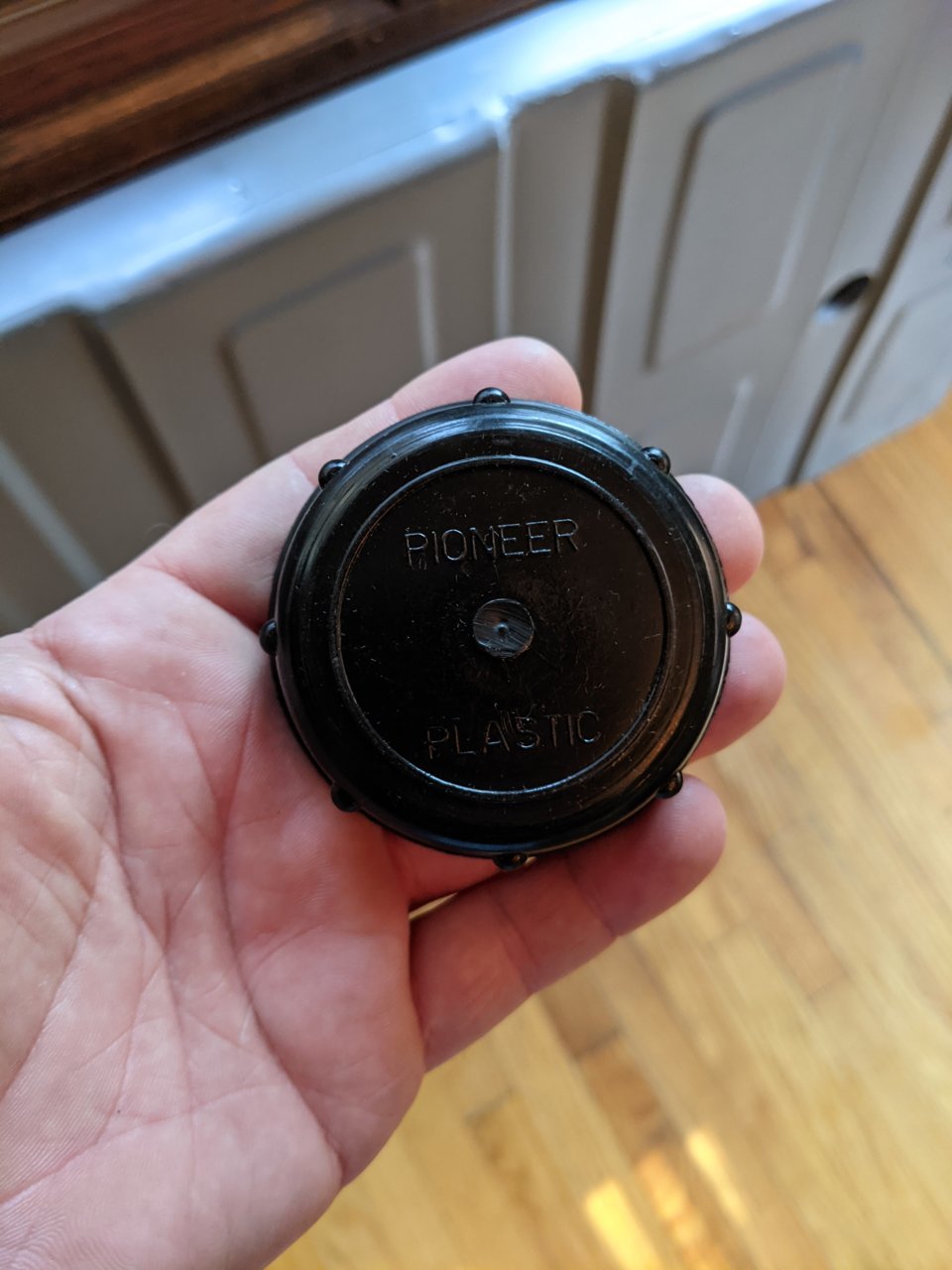

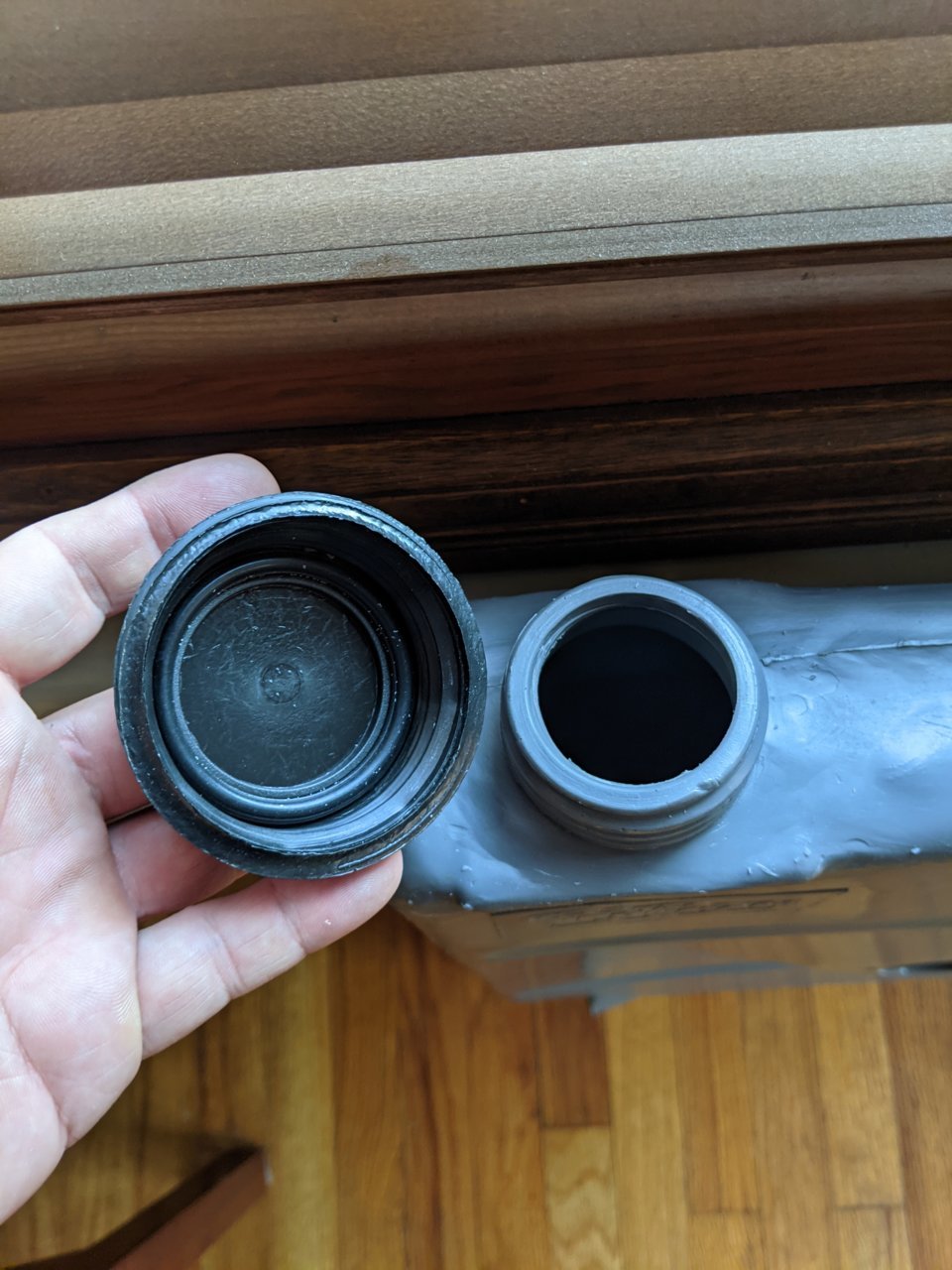

    Seems well made enough. The molding and finish is a little rough but not terrible. I did not expect the extra bulge at the outlet barb. It seems a little extra wide around the fill nozzle too. It won't affect me too much but I'd prefer if it were actually flat. This could be a deal breaker depending on where you were planning to install it.
    I also bought a second cap to experiment with. I may put a one way bleeder valve on it so it let's air pressure out when climbing altitude. I'm sure I can deal with sucking itself closed when going down in altitude but swelling may be stressful to the mount system I plan to design and employ.
    Next step is to cap the barb and fill it with water for an extended leak test.

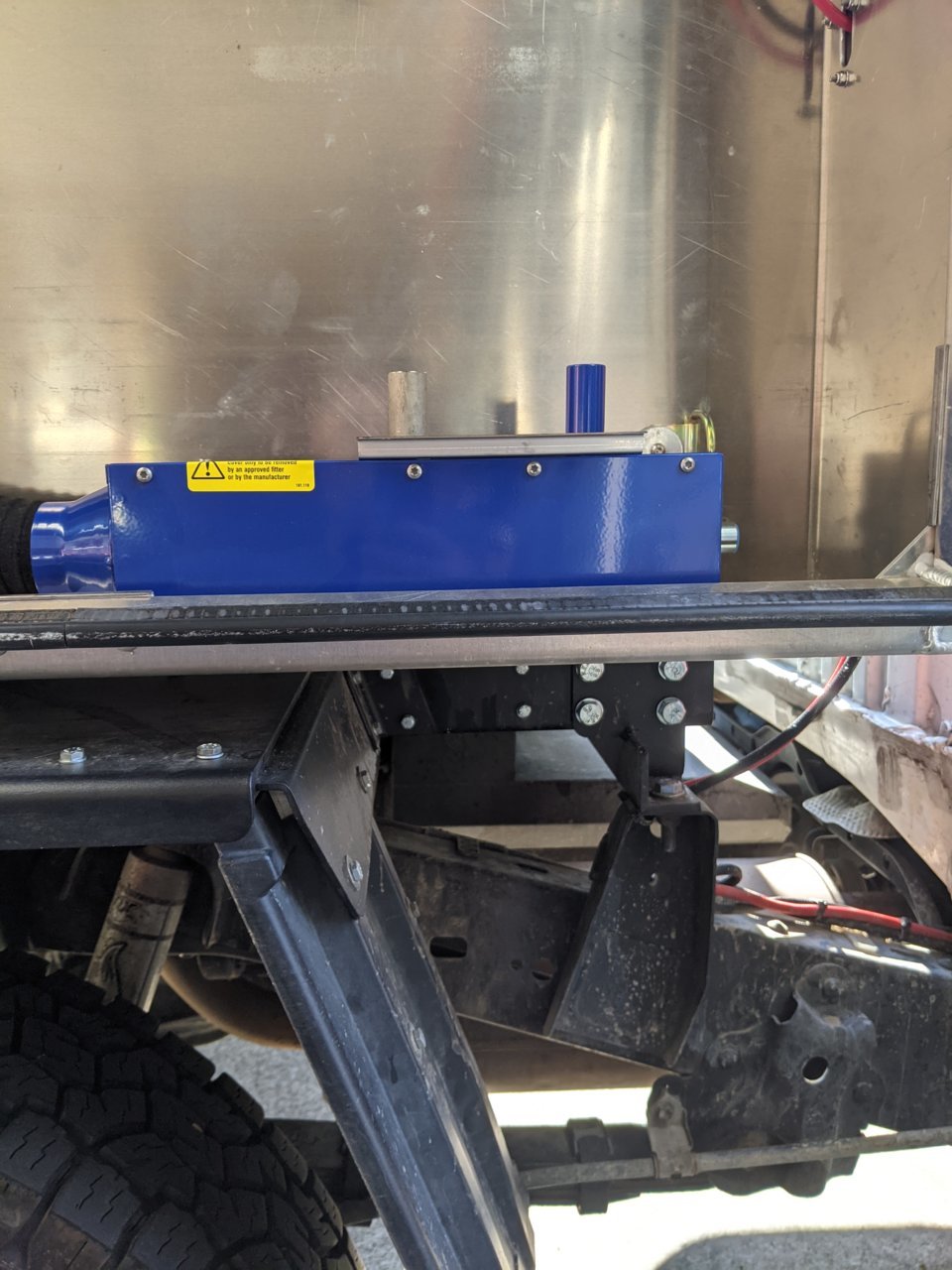

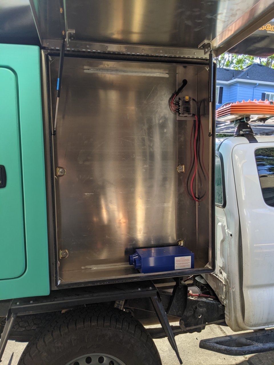

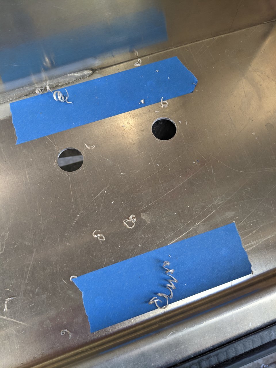

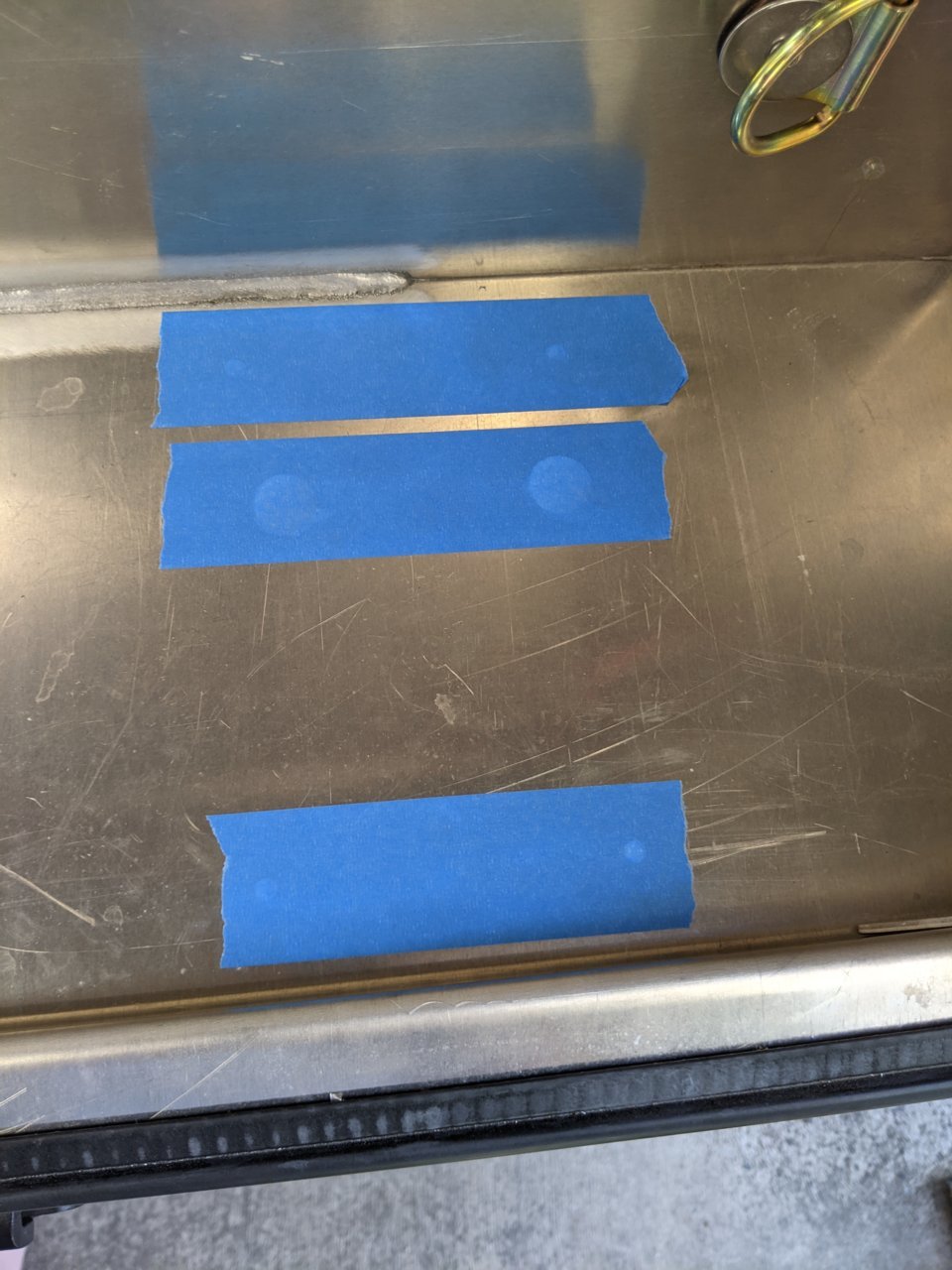

    Broke through a procrastination wall tonight.
    Started the install process for my ProPex HS2000 heater! Trimmed the template and positioned it.
    The side to side placement is easy. Center it on the box. The front to back requires slightly more thought. The heater is upside down in this image so those stubs will stick down through the box. These are the intake and exhaust for the combustion side of the heater.
    Made sure there was enough clearance, taped the template down, marked the holes with a punch and started drilling.
    And there it is in position. And this is where you find out the template supplied with the heater is trash. Well, it's not terrible but it will require fender washers on the underside. :facepalm:
    PXL_20210810_014058362.jpgTape over the holes until I can get a 1" uni bit to finish the larger holes.

    Why I usually take my own measurements and forgo using templates unless they are of my own making.

    They checked out on all the dimensions I could reasonably make. But the one dimension I couldn't accurately measure was the one that was off. Of course.

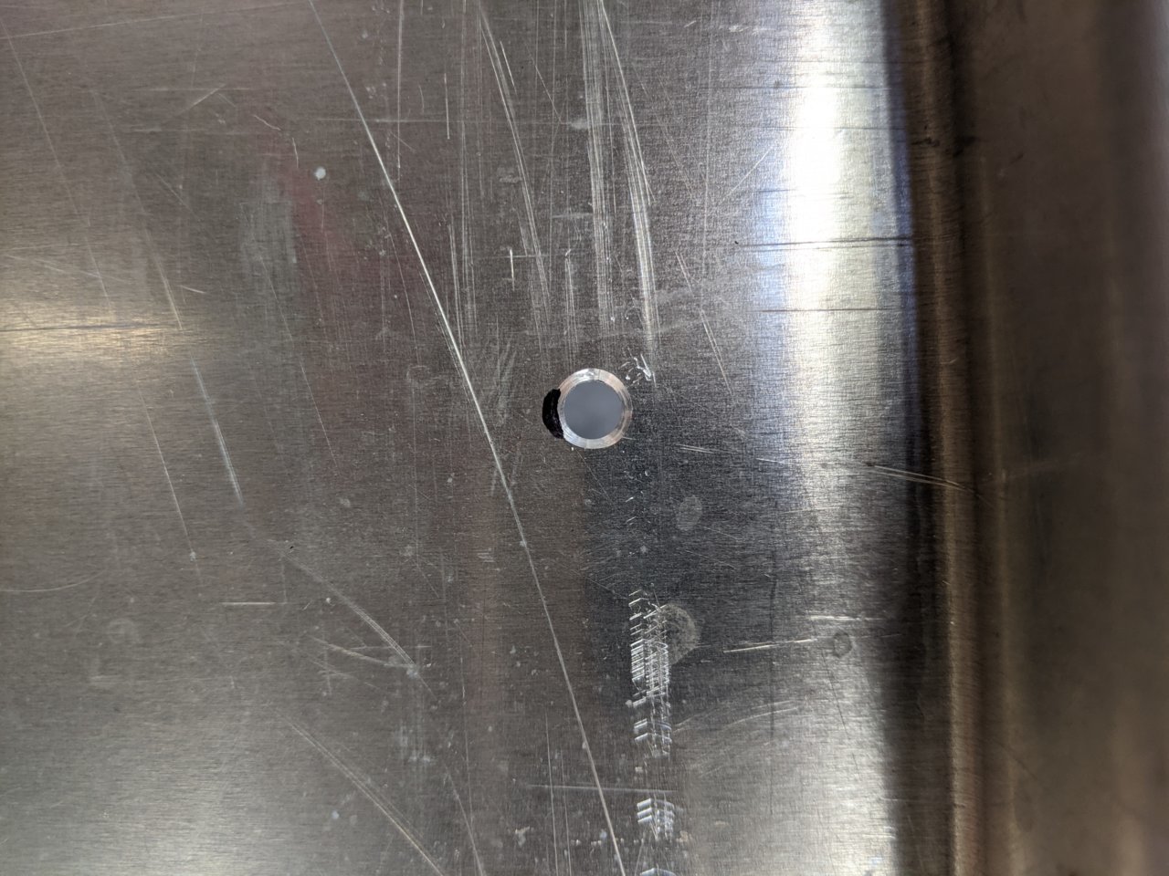

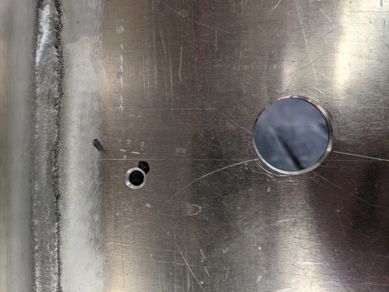

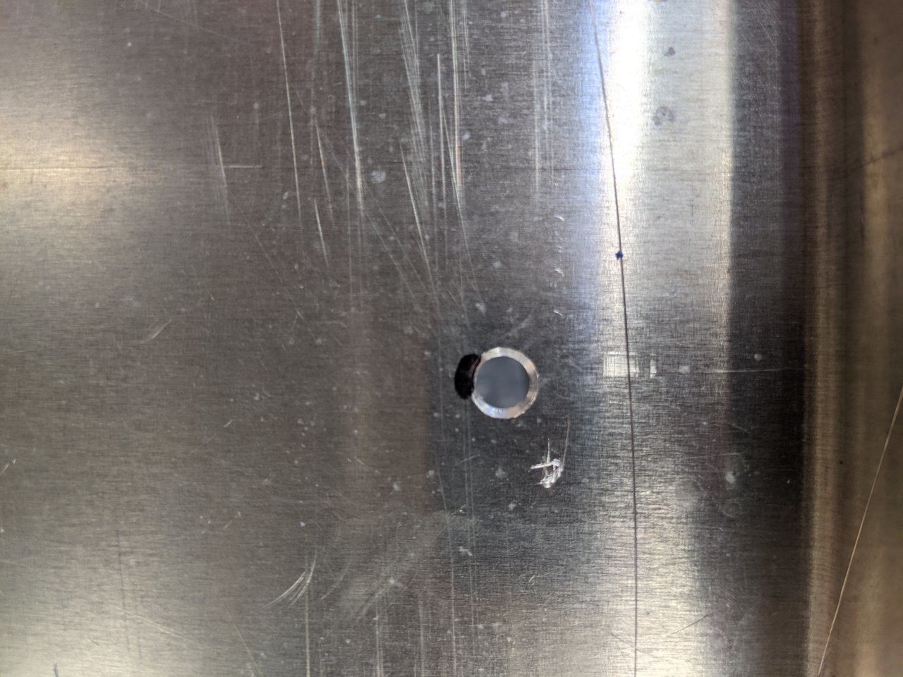

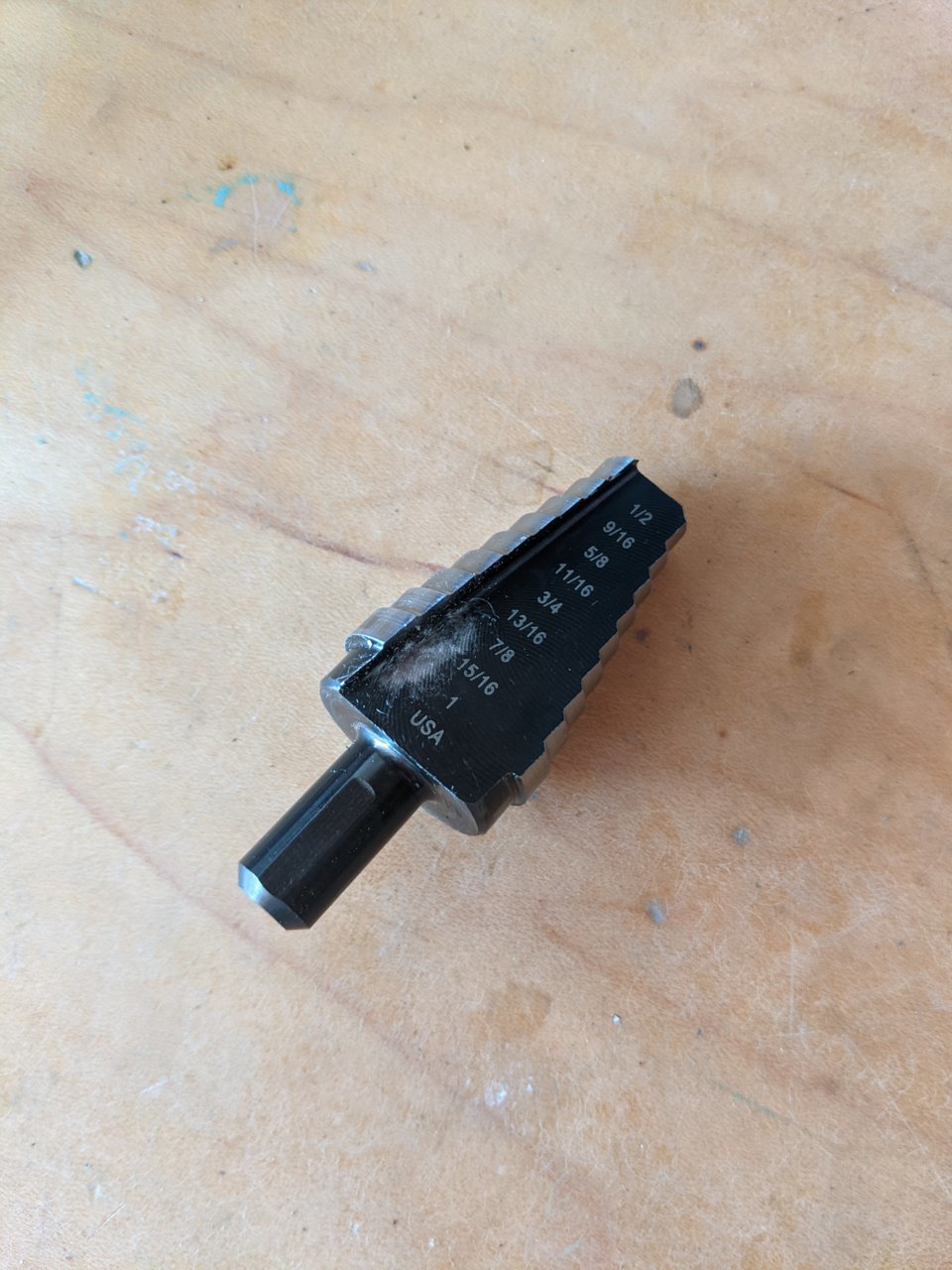

    Whipped out the short stubby and bored out some holes.
    Hit these with a giant countersink bit to deburr the holes.PXL_20210811_001707522.jpg
    Then I marked the small mounting holes to see how far off they were on the template.
    Off by a lot but not more than a fender washer so we're good. My guess is the template is ideal and the reality of the sheet metal production process is why these are so far off. Or in process changes to the design that were never captured for the template.
    Quick hit with the round file and we're good to go!
    Now I just need to bolt it in place! I need to buy some high heat sealant first. Need to seal up around the inlet and exhaust that poke through the box floor. Goop some on the pipes, drop it into place, bolt it down then finish gooping the exterior where the pipes protrude through. Then a ton of other work to make it actually run.
