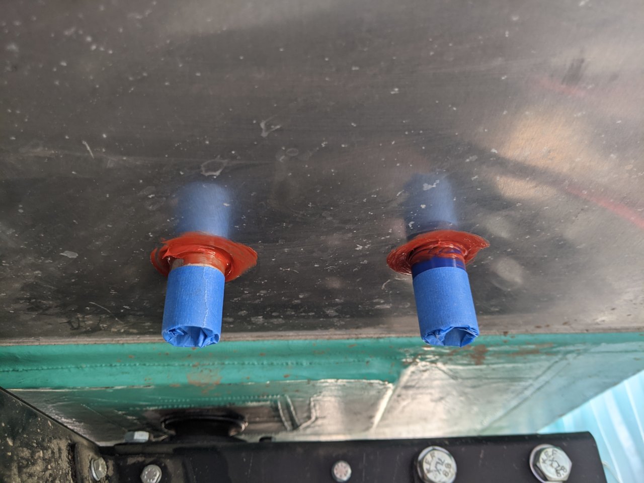

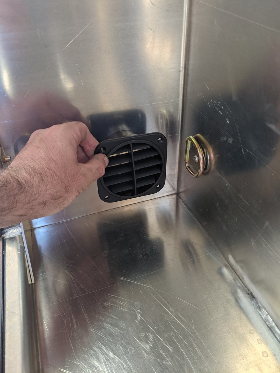

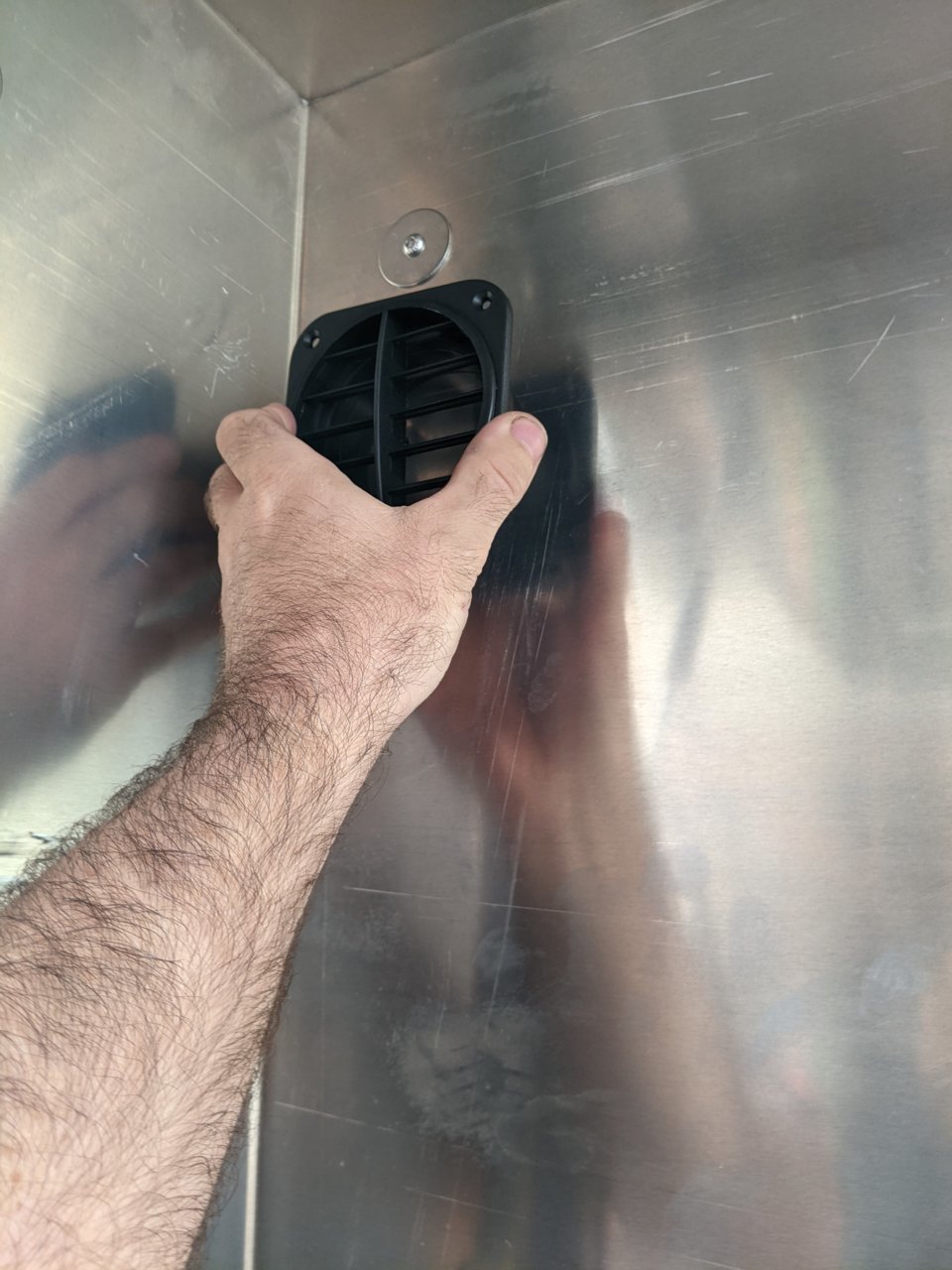

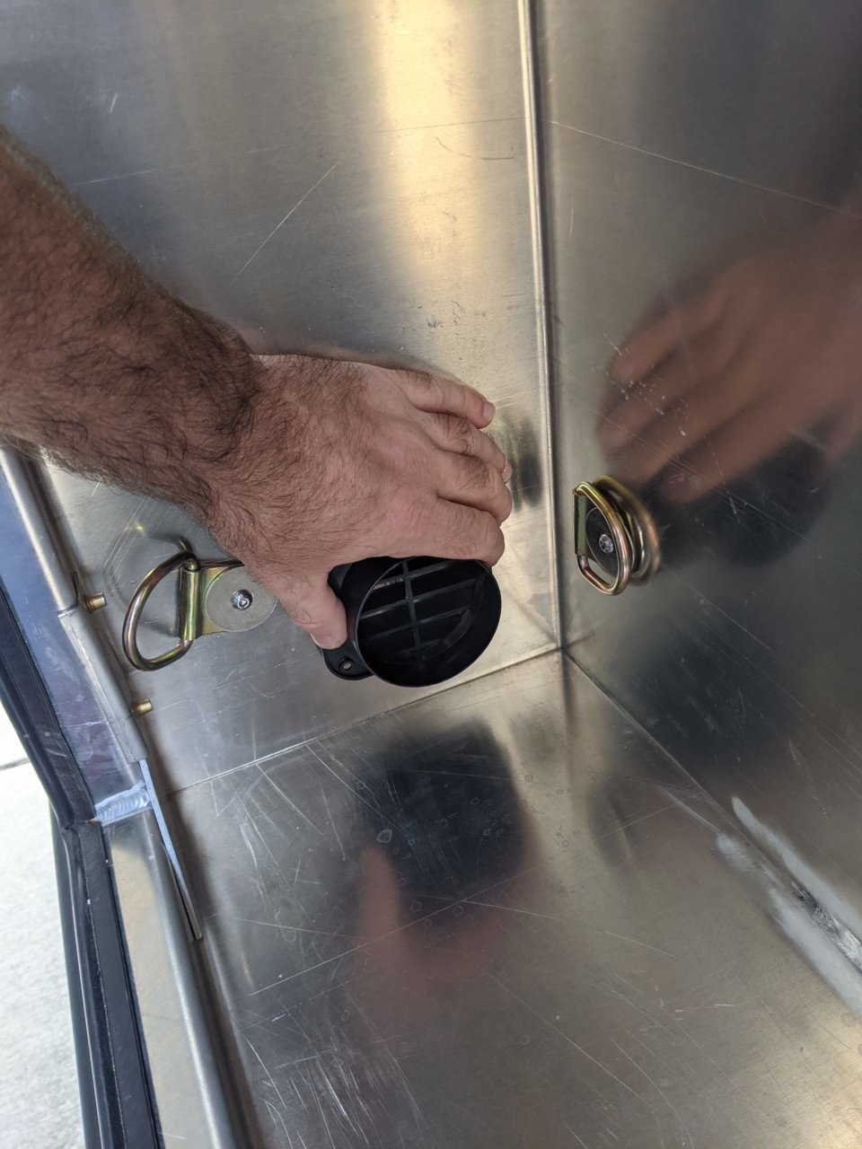

    I also need to sack up and drill some big ass holes in the camper.
    One down here so I can mount this inlet. This will be mounted the other way around in the camper. This is just showing the size and approximate location. This will pull cooler air from the floor of the camper by the door.

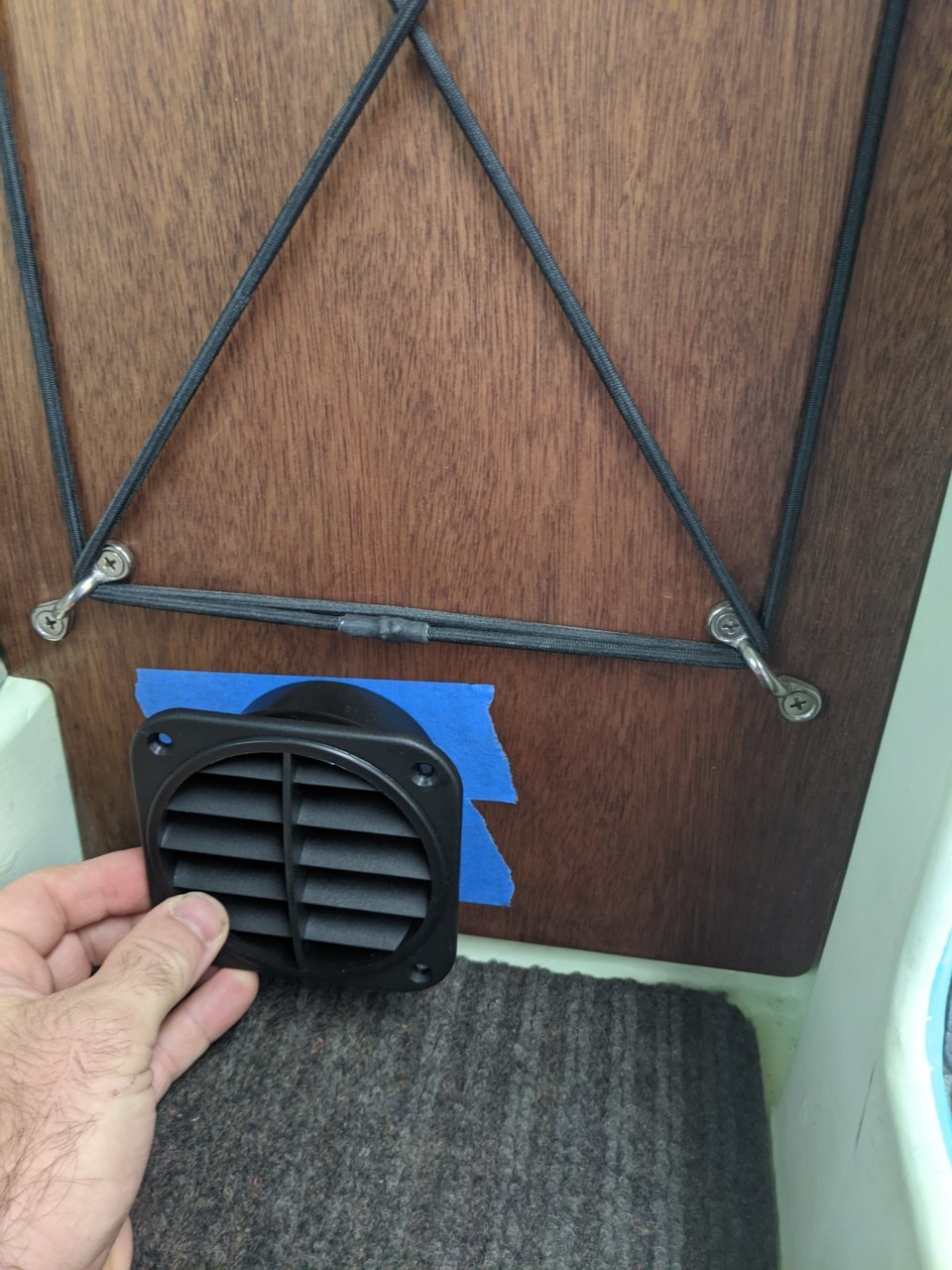

    This vent will mount up higher on the wall of the camper pointing toward the bed. I understand that hot air rises and that this should be mounted lower but I don't want to be up against it with a sleeping bag or whatever.
    This should create a nice circular flow of air. Recycling the air should also reduce the amount of energy needed to heat the air since I'm not pulling from outside.

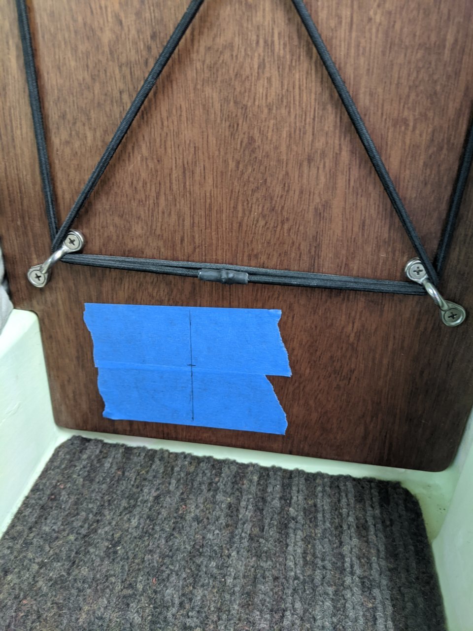

    I will likely mount the thermostat below the hot air outlet by several inches. Not a lot of good places for it.

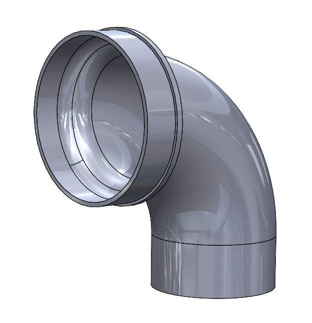

    I wanted a 90 degree elbow that mated the ProPex 60mm ducting to the wall vent outlet which is 77mm. Couldn't find what I wanted so I'm going to have one printed. A quick 5 minutes in CAD and here we are.

    I've always heard the cad printed stuff doesn't hold up to heat to well.

    FDM parts especially. Some of the nylon parts aren't bad. But I'll be using heat treated (bake in oven after printing) carbon fiber PLA. Which will have a heat resistance up to about 100 C (212 F). Plus, this elbow will be about 2.5' away from the metal heater body outlet. I'm hoping it works well. I found a note on Expedition Portal where someone measured an air temp of 104 F from the vent. So this should stand up to that with a decent margin. I have seen small engine intake manifolds printed out of a similar material that have held up well to a lot of use so I'm hopeful this cheaper material will work for me.

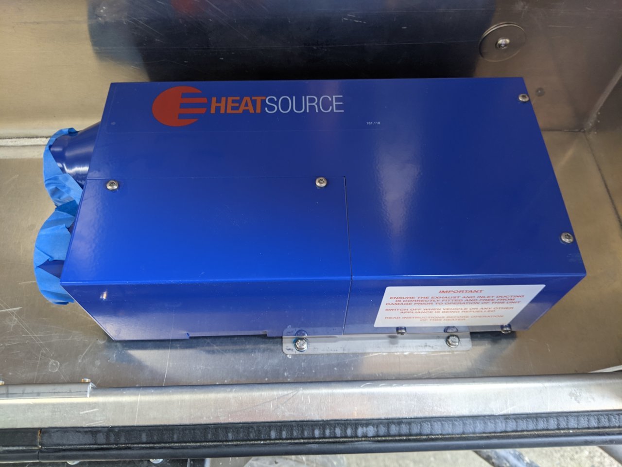

    Messed around a bit today.
    Bolted in the heater for good (hopefully).
    Sealed up the openings with some red rtv sealant. I can always revisit this if necessary. It's easy to get to. The hoses that attach to these have silicone boots that you slide all the way up so that helps seal a bit too.
    Figured out the location for the air return vent too. I'm going to wait to cut these holes until I can hook up the heater and verify everything works properly. Just in case.
    I also ordered another length of "stealth" ducting so I can place the hot air port where I want. I'll need a straight connector between them. Maybe I can find one I like or I'll just have one printed. Speaking of which, I may have my printed elbow back tomorrow.

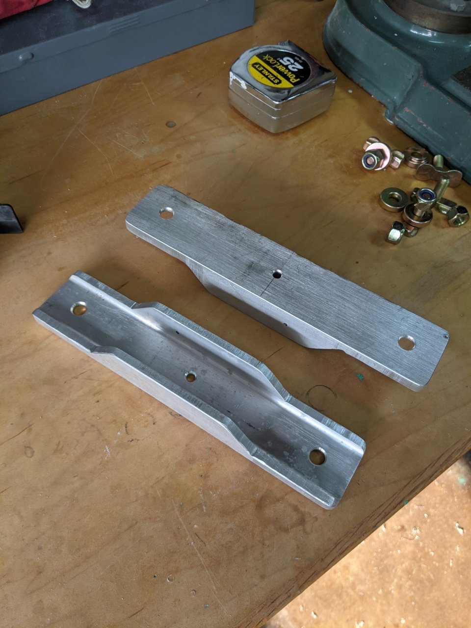

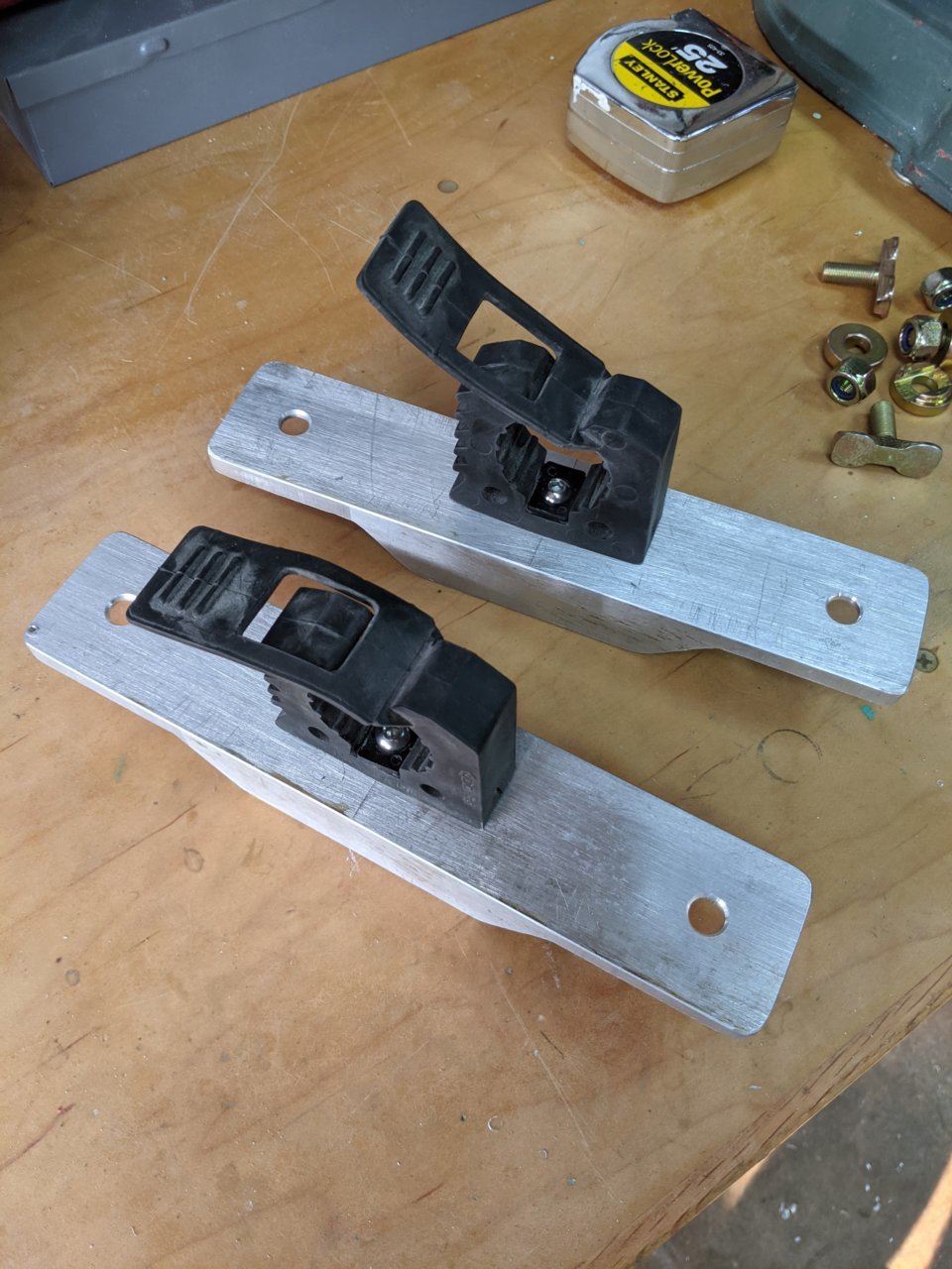

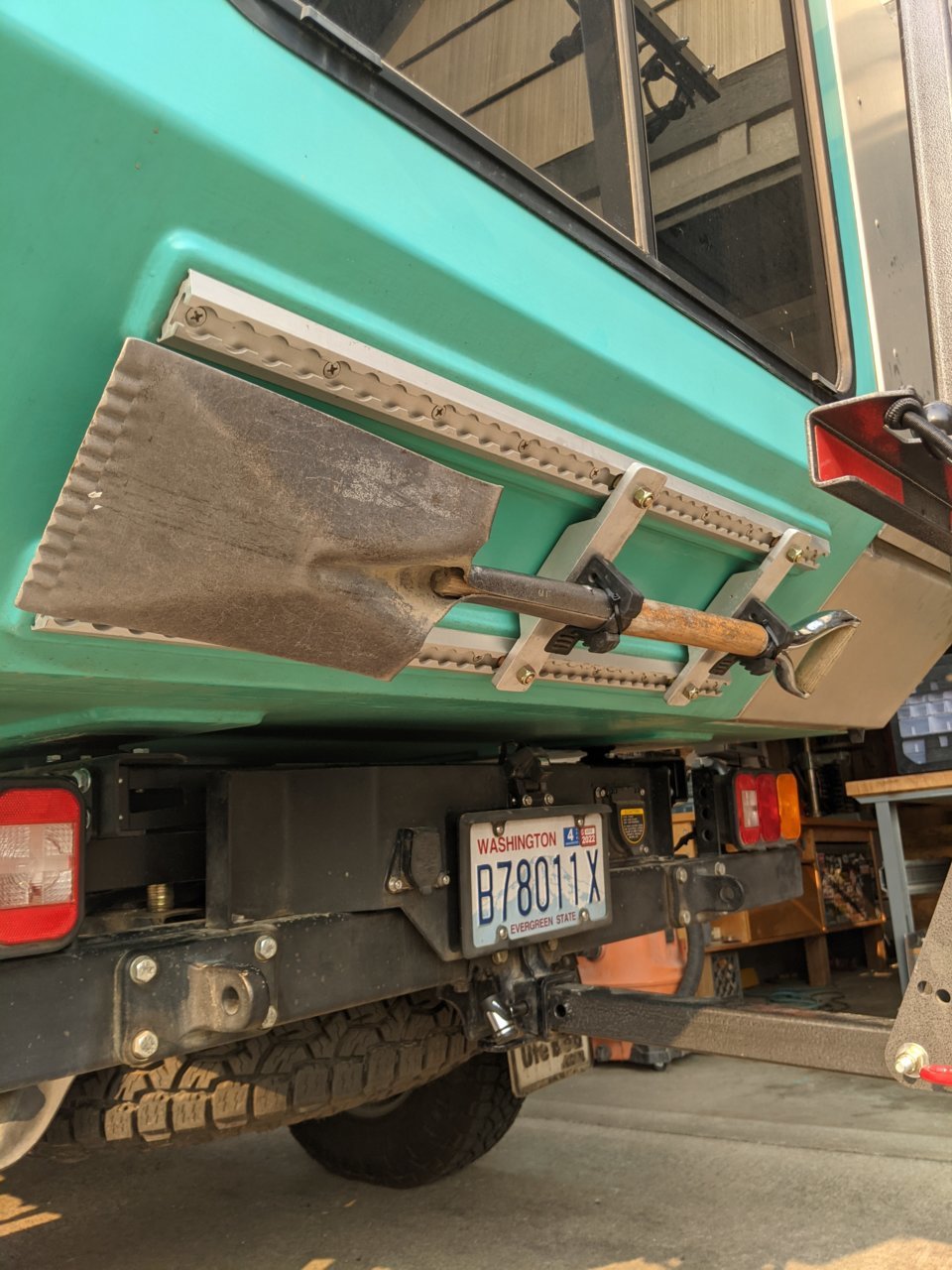

    AND I got a little Wiley and just wanted to knock out something quick and simple.
    I cut up some aluminum channel I've had laying around for about 20 years.
    Slapped on some quick fists I've had for a while.
    And bolted it all up to the camper. I'm not sure how I feel about these quick fists. I don't have any real experience with them...they seem sketchy. I threw some zip ties around the shovel as insurance for now. Not sure how I feel about this in general but this is why I put these rails here so I might as well use them. The brackets aren't my best work so let's just not look too closely at those. I could add a second tool if I wanted but not sure I need to. If I end up liking this, I'll get the brackets powdercoated at the same time I take other parts in.
  15. Aug 14, 2021 at 11:37 PM

    For lighter things like that shovel they should be fine for a number of years, especially in a shaded location. For something heavier like a high lift I'd personally want the strap on top rather than carrying the weight that mount position entails.

    Thanks for the feedback. I see them in use on all kinds of rigs around town. They must be somewhat reasonable. I'm going to roll as is for a bit and see if I like this setup at all...and if there's anything else I'd like to add to this space before I finalize it.

    I used quick fists for yeeeaarrrrs to hold a shovel to the side of the bed rack on my Tundra. Even with all the rough forest roads, 80 mph freeway speeds, beach trips etc, they never failed and the shovel was always handy for emergency digging.
