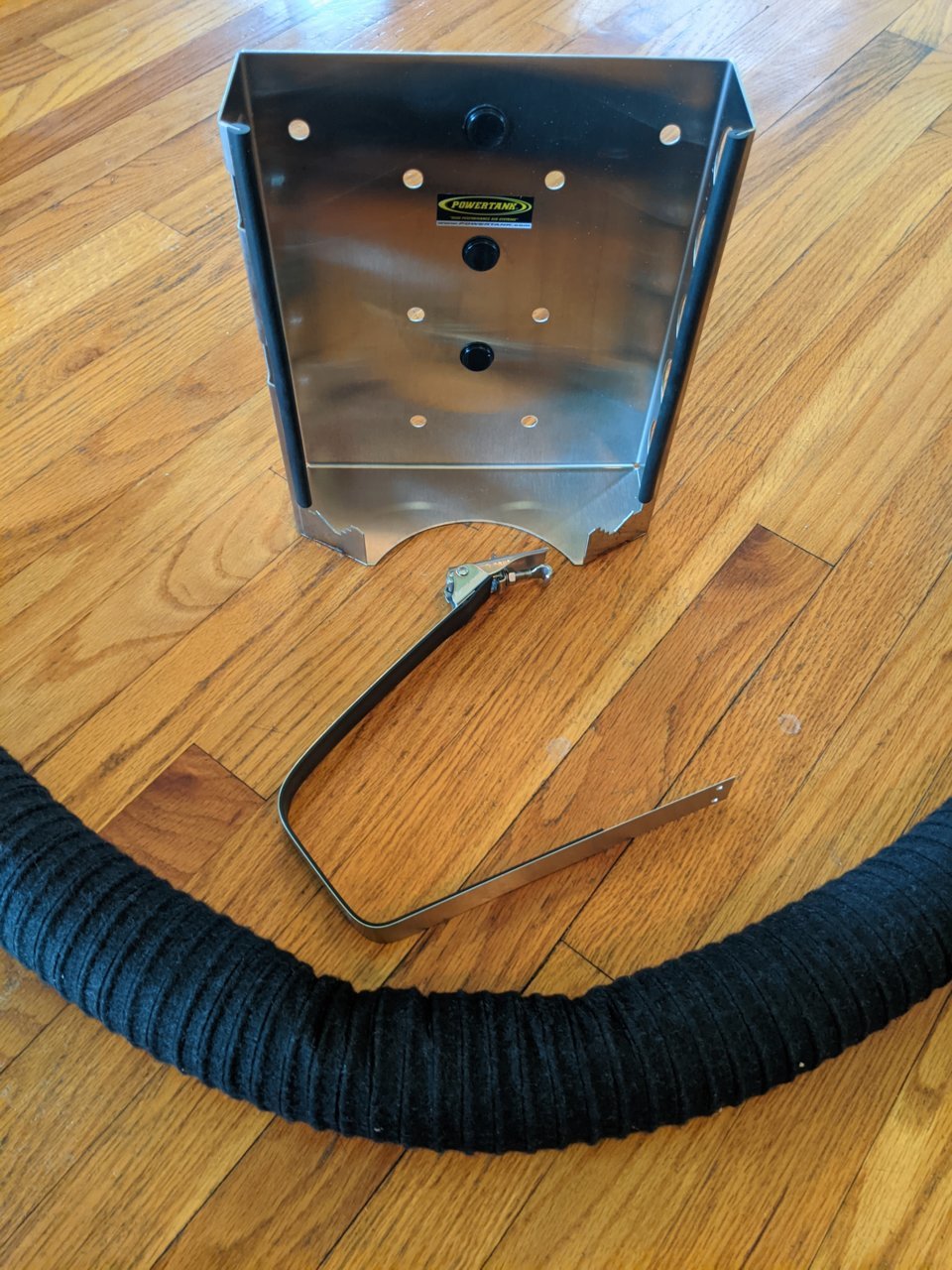

    Powertank mount for my 11 pound propane tank and some extra "stealth" ducting for my heater.
    I'm still waiting on my propane tank, printed duct elbow, and a heater mat for my water tank.

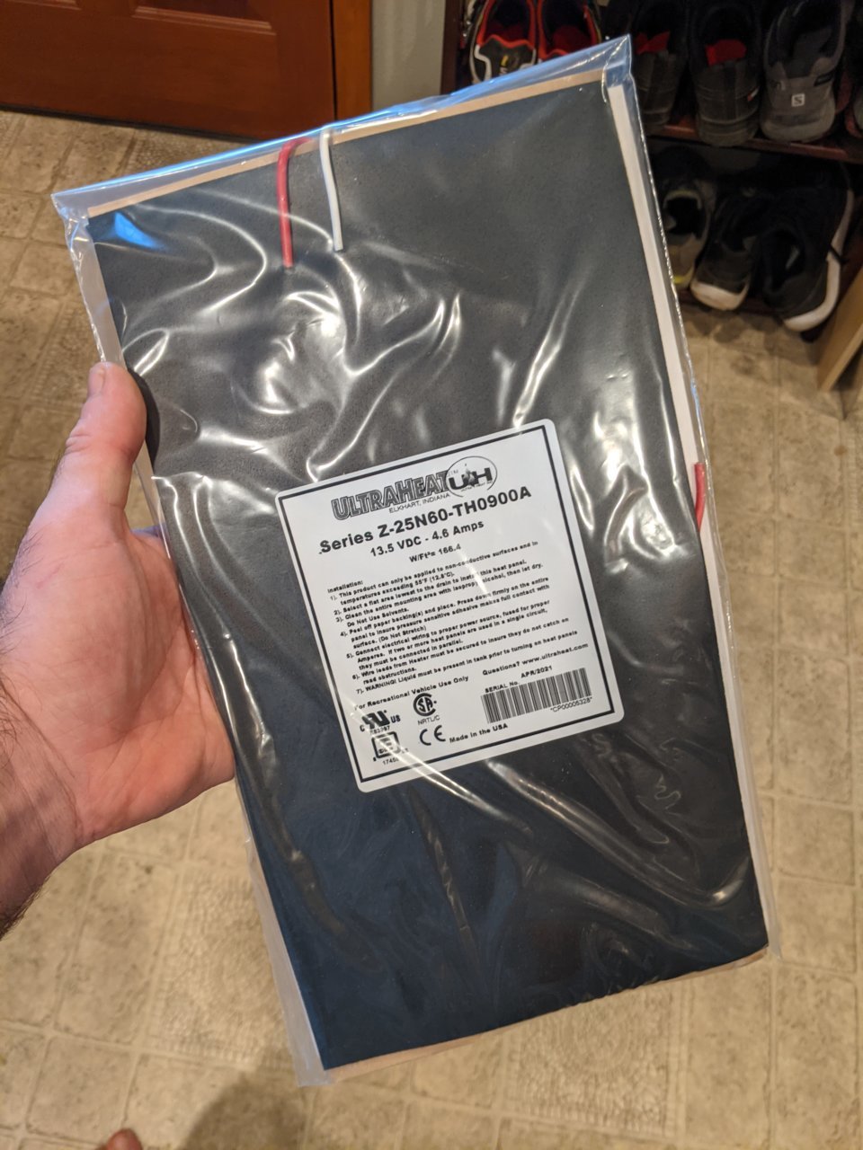

    Stuff keeps trickling in.
    12V heating mat for my water tank. This size is rated for up to 25 gallons. It's automatic on/off based on temp. I will have to put a switch on it to turn it off when there is not enough water. Water needs to come up high enough to cover the area where the mat is to work properly. So I'll place this low and centered on the tank. I'll just have to be mindful about my water level (no way to see the level at this point) in the winter when I use the mat. And also remember to shut it off in the warm seasons.

    That's a really good idea!
    It sounds like you will be mounting the pad on the side of the water tank. Can you mount it on any side of the tank?

    Typically you would mount it on the bottom of a tank. But my tank doesn't have a usable bottom because it's so skinny. From what I've read, you don't want to sandwich this heater between the tank and any other surface. So mine will be facing the cab and my tank mounting bracket will have an opening cut in it to fully expose the heater.

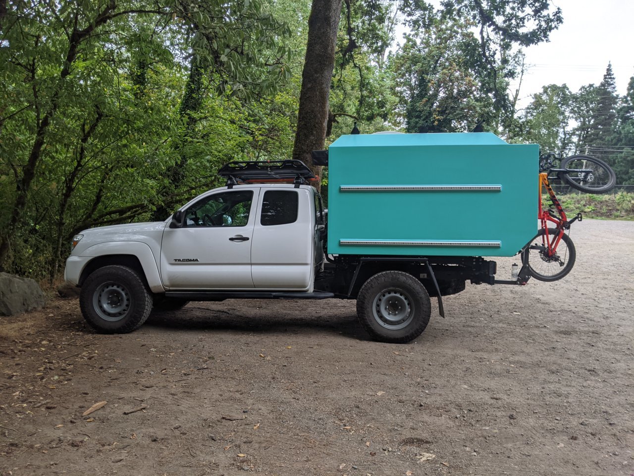

    Quick pic from the trailhead.

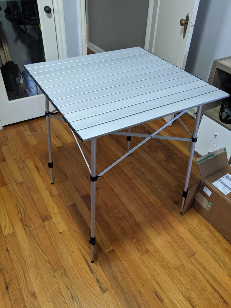

    I've been trying to figure out a table solution. I was going to have the stove fold out of the kitchen box but it just wastes too much space in the box for too little surface. So I turned to looking for a table that was standing height for the stove and quick to deploy. I have a Roll-a-Table that I've had for years. Works fine enough. But I don't like that you have to lay the top of the table face down on a surface (the ground in my case) to screw the legs on. Not a lot of options for a standing height table with free standing frame that packs small. Except this one!
    Crazy creek Crazy Legs table. It's just about perfect. Lots of plastic clip features that will make me nervous when it's cold out but I'm going to give it a shot.
    What I like about it (having not actually used it yet):
    1. Packs small
    2. Base frame can be set up then table top next -stays clean.
    3. Adjustable height legs - 5ish inches of adjustment.
    Things I don't like:
    1. Plastic clips
    2. Adjustable legs are spring loaded to retract when clamp is released. Whoever decided this was a good idea was lame. I'm planning to set the legs at the height I like then leave them there. I'll do slight adjustments for uneven ground as necessary. I'm not storing it in it's bag and I have the height to store the legs long so it'll be fine. I may look into disabling the springs but that may be a terrible idea.

    None of these types of tables are "excellent". They all have compromises and they all come off feeling flimsy. But I'm okay with that as long as it holds up like my way more flimsy feeling roll a table has. This one has the features that feel critical to me. I just really hope it holds up. I'm pretty nice to my stuff and practice a good degree of mechanical empathy so I've got my fingers crossed.
