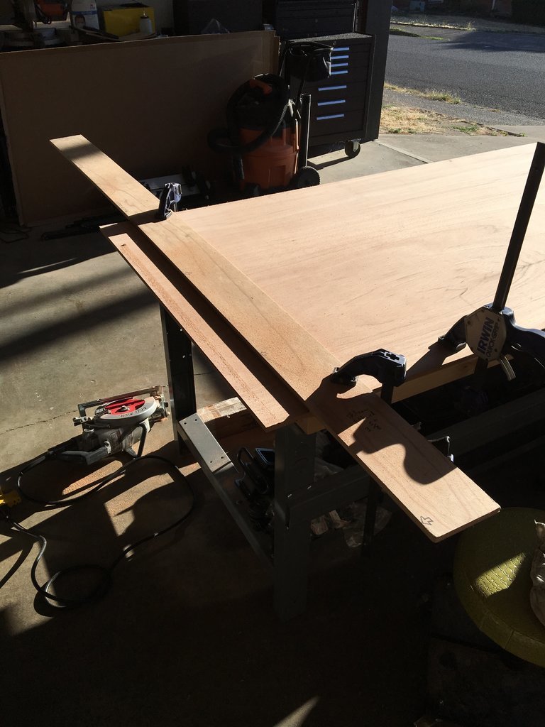

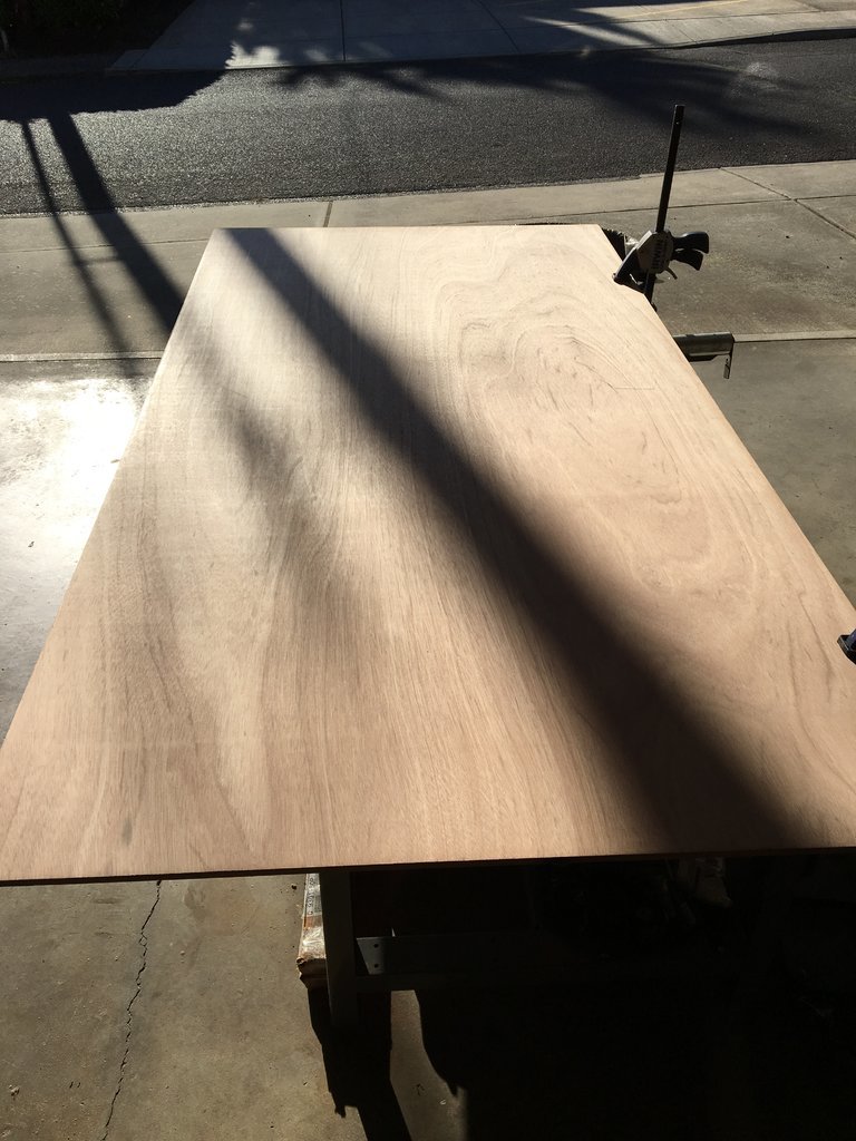

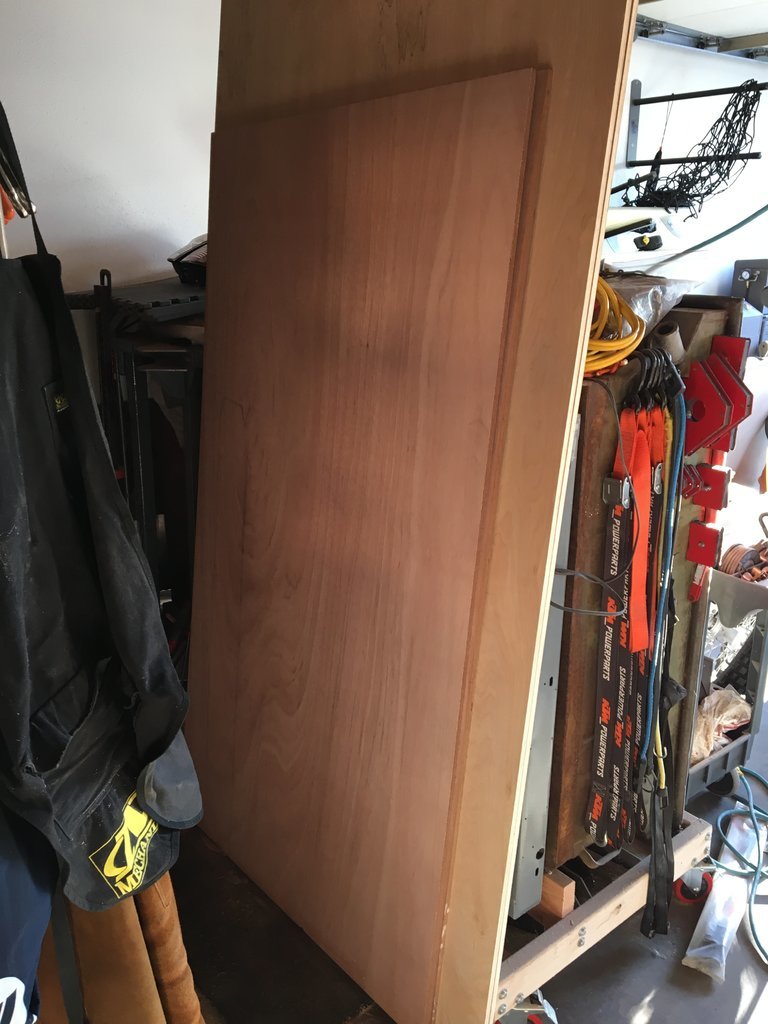

    A piece of virgin marine grade going to meet its maker! :devil:
    Zip-zap...
    Two camper floor pieces!
    Now I just need to route the half lap and epoxy them together! Maybe tonight? Maybe tomorrow night.

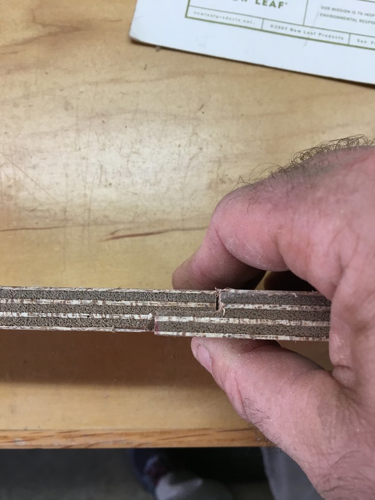

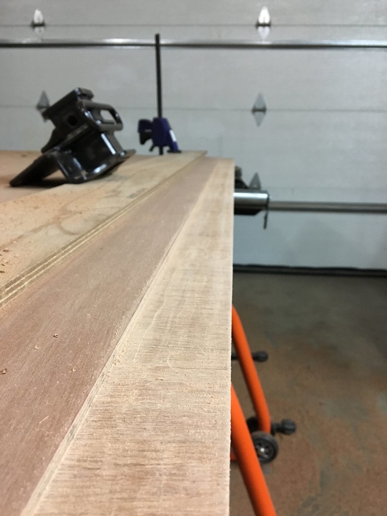

    Decided to get back after the camper...after I knocked out some home made chicken soup!
    Not everything you make should be in the garage.

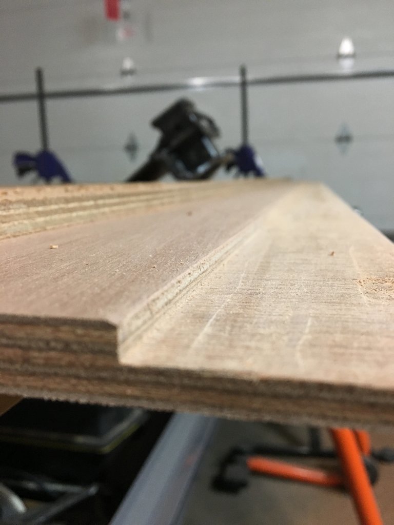

    Set the router to do a nice half lap. Nailed it on the first try.
    Yup. Lots of wood removed here.
    All the way down!
    The other piece.
    It's amazing how much sawdust a router can make in short order!
    That's it for tonight. I'll get the two main floor pieces epoxied together tomorrow night!

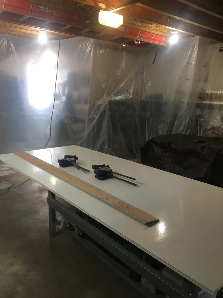

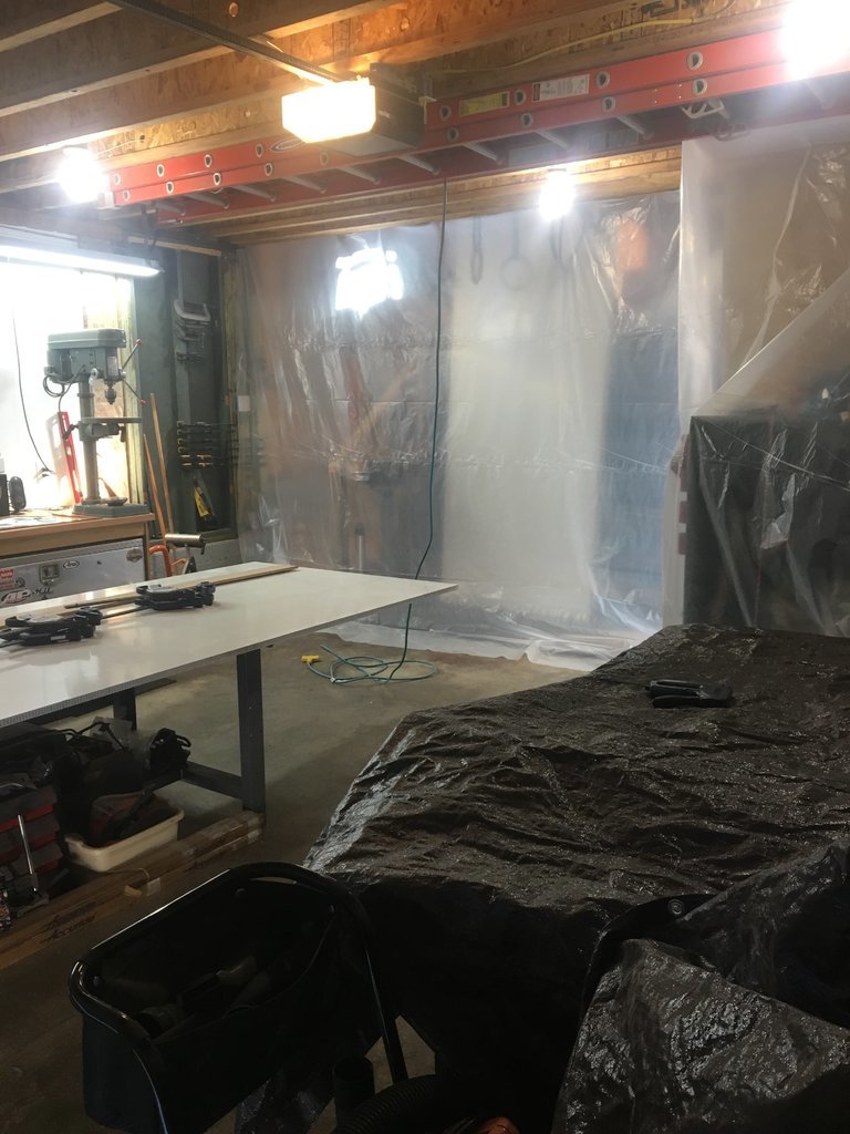

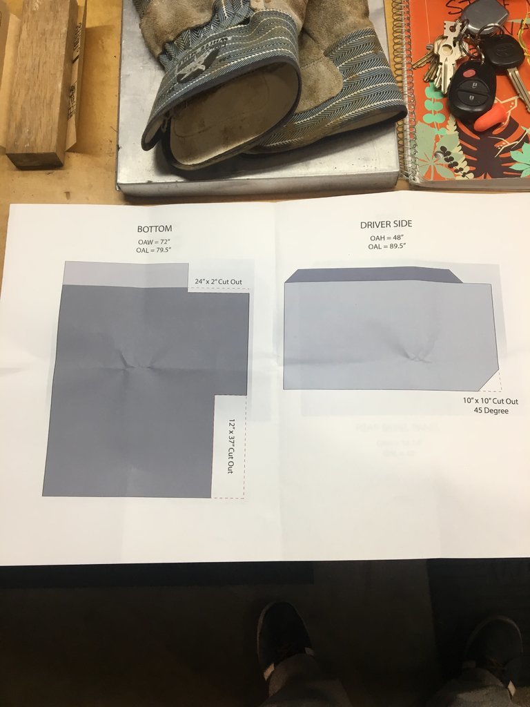

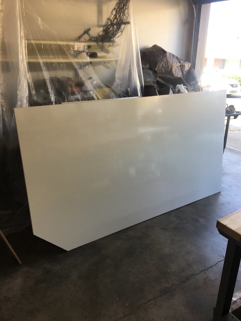

    Got a bit of a slow start this morning but I'm picking up speed.
    Got the garage prepped for capturing as much fiberglass dust as possible...within reason. This is how it will look until the camper is done, probably.
    Got my general cut sheets out. There's an industry correct way to do this but I don't care about that. I do it how it makes sense to me!
    Drivers side wall panel. Done! I've decided to go ahead and build the floor out of the composite panel as well. I have enough material and it cuts just like plywood so it's easy to work with at this stage. Besides, the composite panels feel way lighter than 1/2" marine grade plywood. I'll save weight where I can. I rough cut the floor panels already but I need to decide how I'm going to splice them together with the tools I have or with readily available tools. Stay tuned!
