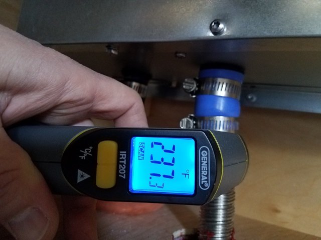

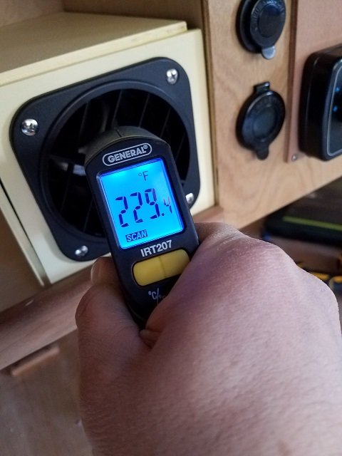

    Didja finish installing the furnace yet?
    If not, a couple of recommendations:
    You *may* have issues with the 3d printed elbow. I was curious how hot the furnace would get if for some reason it got stuck "on" for any reason.
    You might melt your plastic :)
    Also, here's what the exhaust pipe measured when the above temp was taken:
    I drilled a hole much larger than the exhaust, passed the exhaust through, then sealed with foam. You probably won't have an issue with yours. Propex also recommends running the exhaust and intake out the same side of the vehicle. I ran mine out two sides (passenger and back) and haven't had any issues yet. I've got the 2211, which is the 2200 with some internal changes that allow it to be mounted on edge or outside of the vehicle.
    Another thing that I recommend looking at is the quiet ducting. The furnace isn't loud, but most of the noise seems to be from the air passing through the duct before coming out the vent. The stock duct is aluminum on the inside and it imparted a sort of whistling metallic sound when the furnace ran. You can get acoustical ducting which I feel makes a big difference in the sound: https://www.vancafe.com/2986112-p/2986112.htm
    The other place that the furnace makes noise is outside. This may or may not be an issue for you. I recall seeing somewhere that a certain moped exhaust muffler will fit on the stainless exhaust line and cut down on the noise outside of the vehicle. I just realized that vancafe also sells it as part of a silencing kit: https://www.vancafe.com/2986113-p/2986113.htm
    Abject4x4 and 1 Bored Clerk[OP] like this.

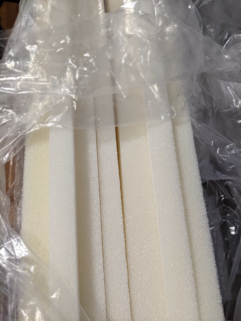

    Picked up new foam panels for my camper walls. Will be covering the front wall and both side walls (mostly).
    The machines to cut this stuff and the process used is not super consistent. But I have two thicker panels for the front and three thinner panels for the sides so it'll look good. I asked for 5 panels at 1"thick. I knew this going in so Im good with it. I'm just sharing it so you know!
    I also picked up 6 yards of this sunbrella fabric. I think the mellow green color goes well with the green/yellow interior paint. If I was smart, I would have ordered enough to do insulated window covers. But I'm going to consider this an opportunity to have some fun with contrast for those. Now I just need to pick up a few sheets of 1/4" plywood for the backer.
    I'm still waiting for my new slider frame plates to be ready (should be any day), and my propane tank (next week), and my steel for new sliders (only takes a day, usually during these covid times) before I can really get my heater dealt with. Maybe my water tank too. I want all of that done before I make my padded wall panels because modifying them after they're made is much harder than making them correctly the first time.
