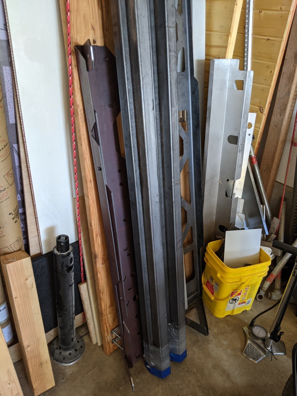

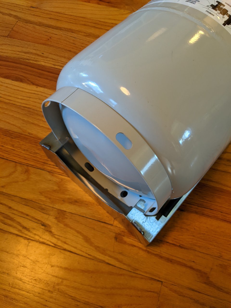

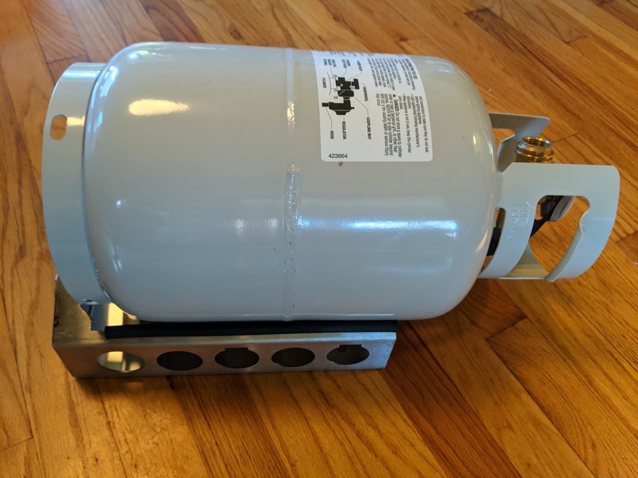

    There's my slider steel and new slider prime plates. Sitting there...ready for me to do something.

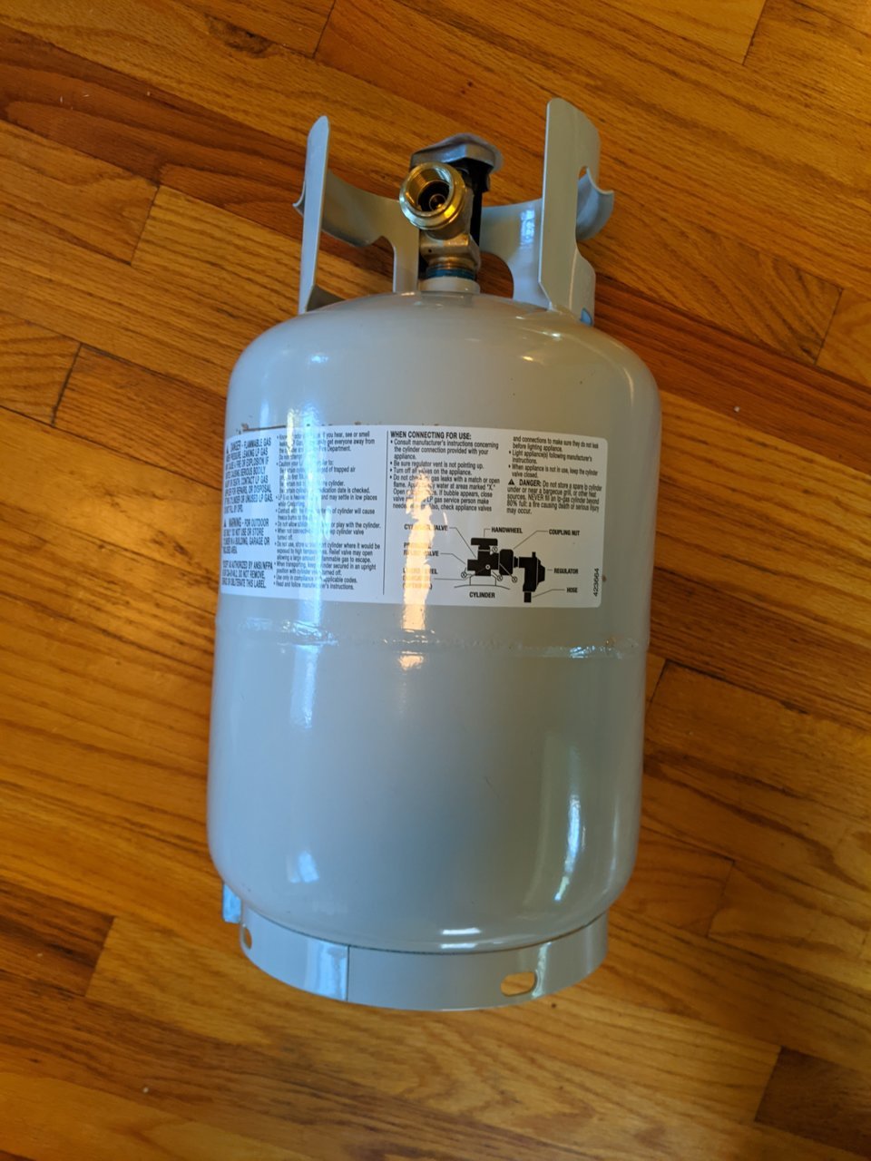

    Tank sits up off the bottom of the bracket a bit. I'll likely cut some of this off and add a feature to the floor of the recess in the slider where the tank will sit. There is some tight clearance so getting the tank as low as possible is necessary.

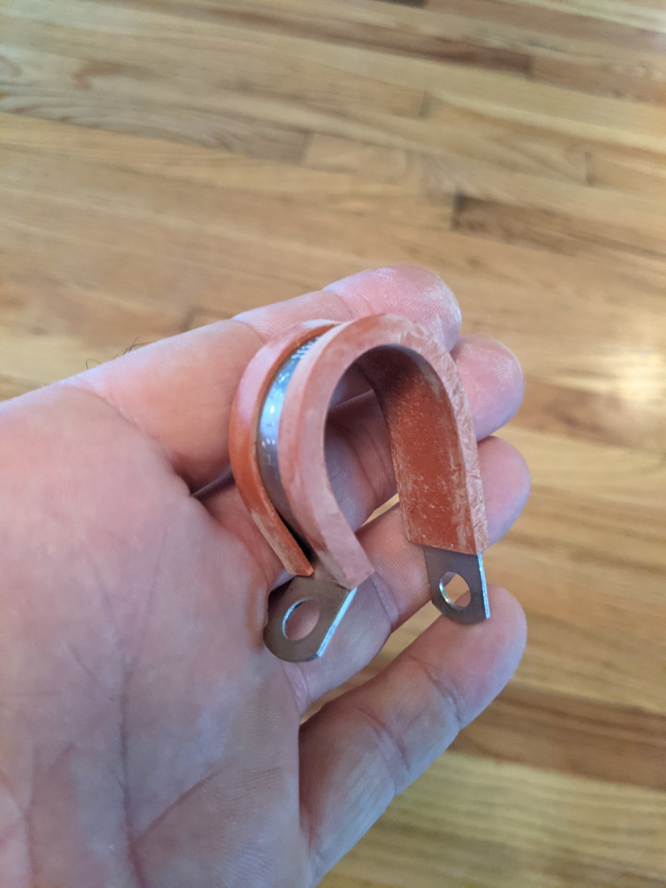

    I also ordered these high heat P clamps to help route the heater exhaust under the camper. I believe these are capable of 425 degrees? Something like that.

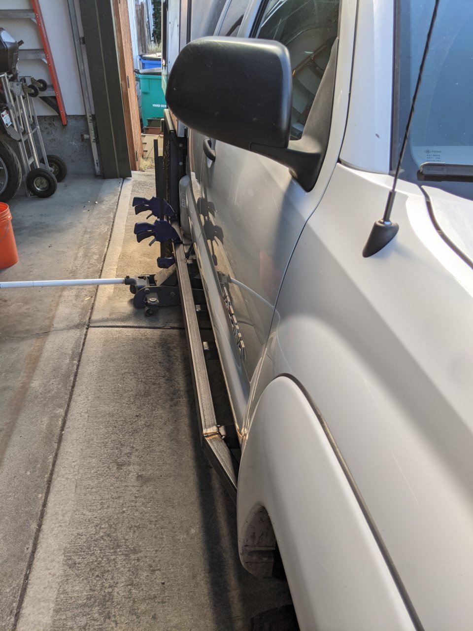

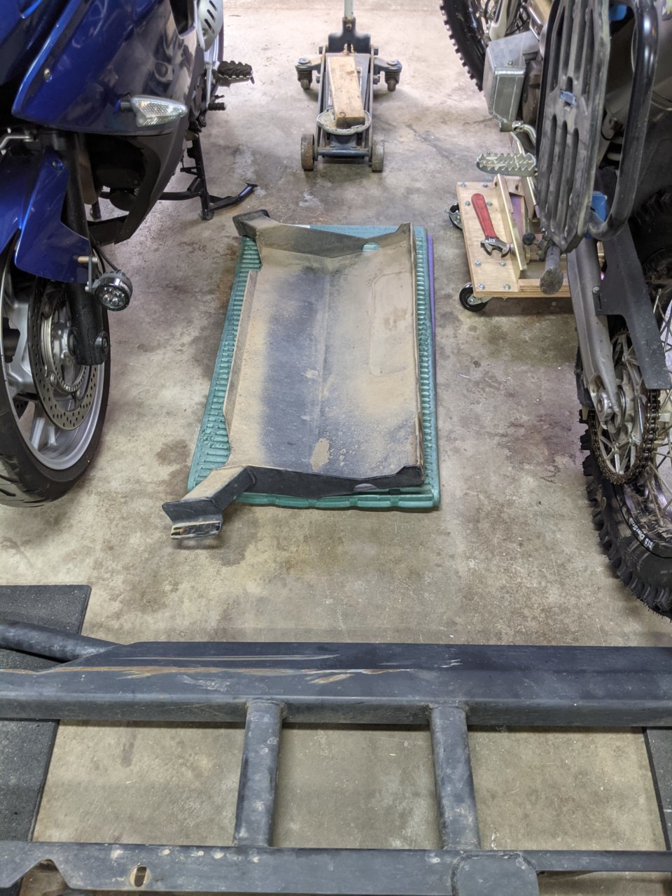

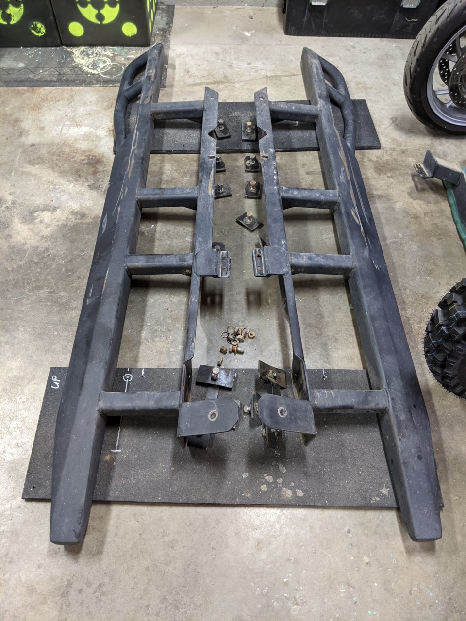

    Pulled the sliders and transfer case skid plate. The sliders haven't been off since I built them YEARS ago. Frame still looks great and so do the sliders. I may have the backing plates re powdercoated but I'm not sure yet.
    The truck looks both naked and clean without the sliders. Walking up to it is strange.
    I'll take it to the car wash and get a good spray on the chassis to clean it up then test fit the new frame plates to make sure they fit. I'm not worried about my file but you never know how accurate the bend is and I didn't measure it yet.
    I'm glad to have gotten this done...suppose to rain the next several days.

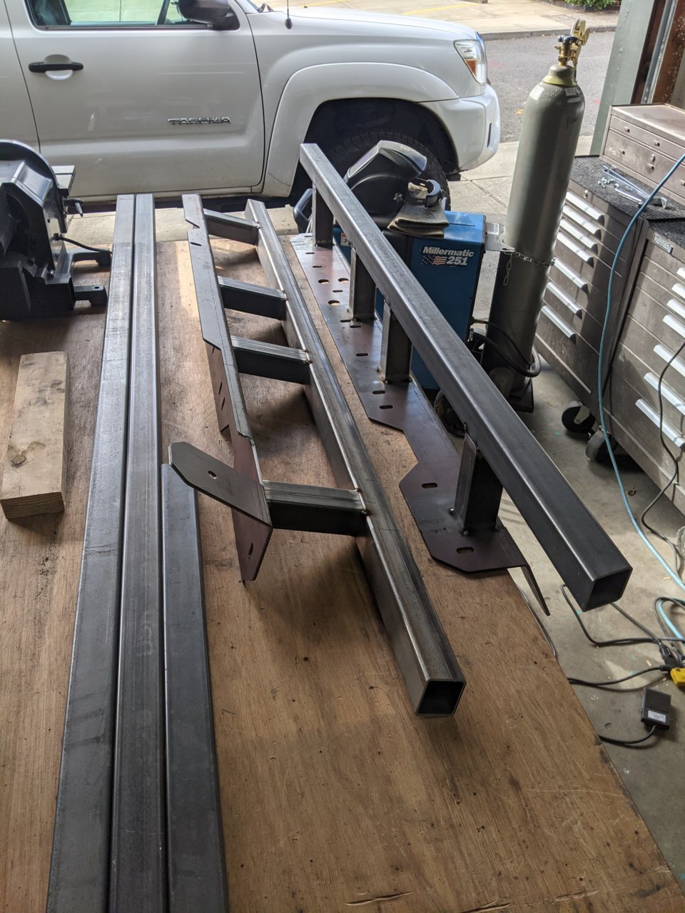

    I'm only going to post big milestones on my new slider build here. The detailed build is in the DIY Bolt On Frame Plate thread.

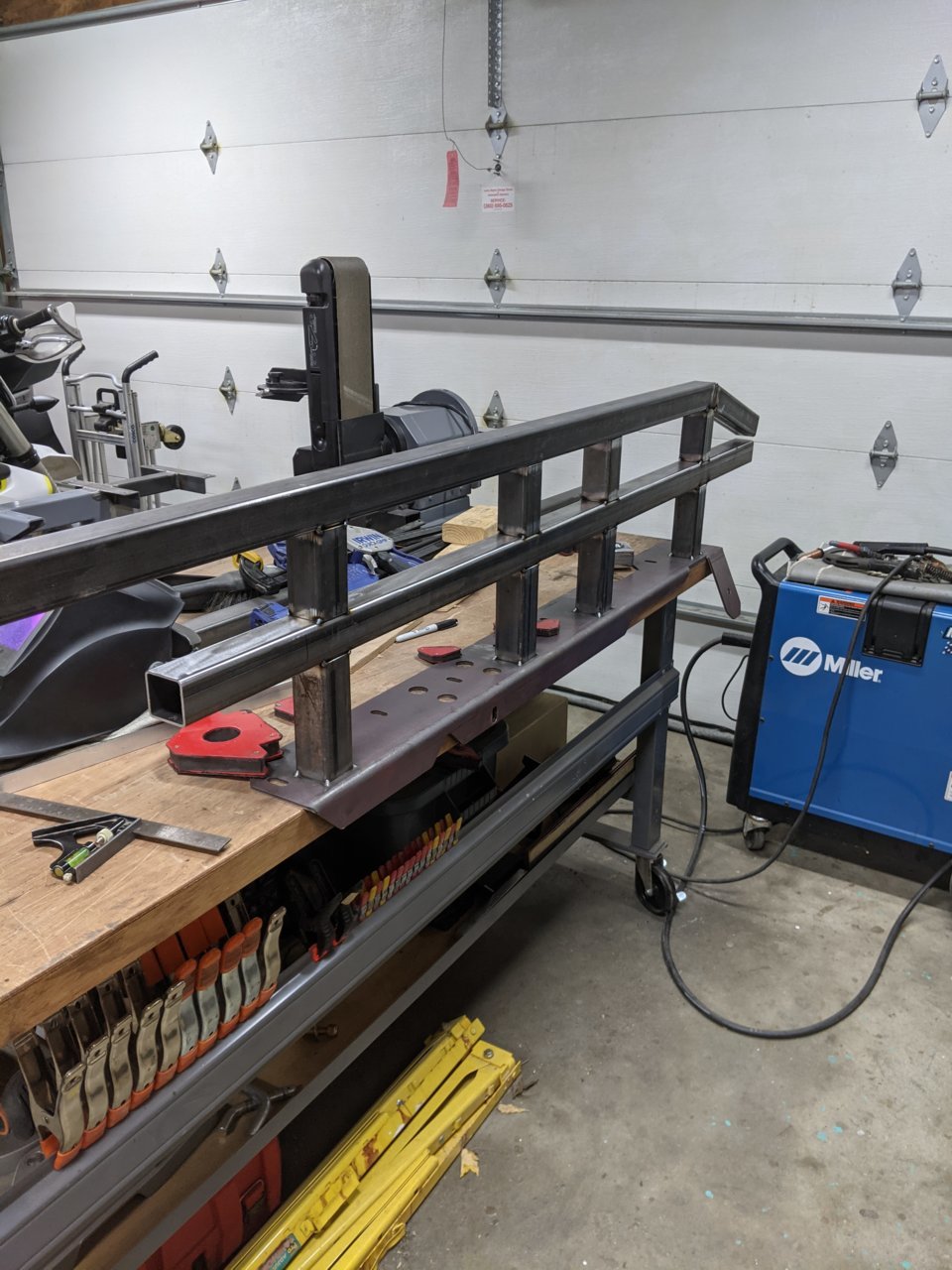

    Today, I cut, cleaned, mocked up and tack welded the main slider structures. Outer rails are next!

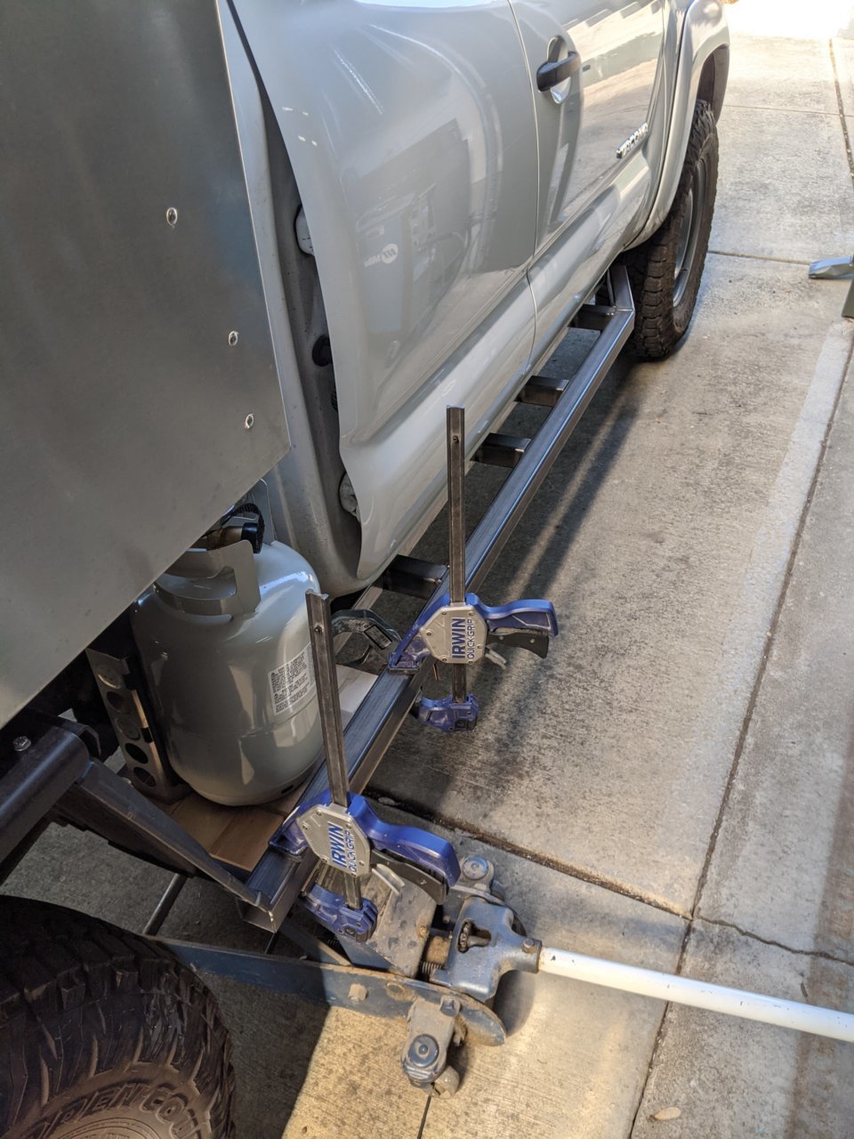

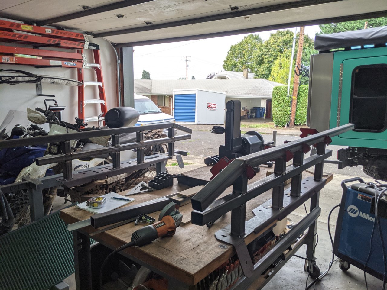

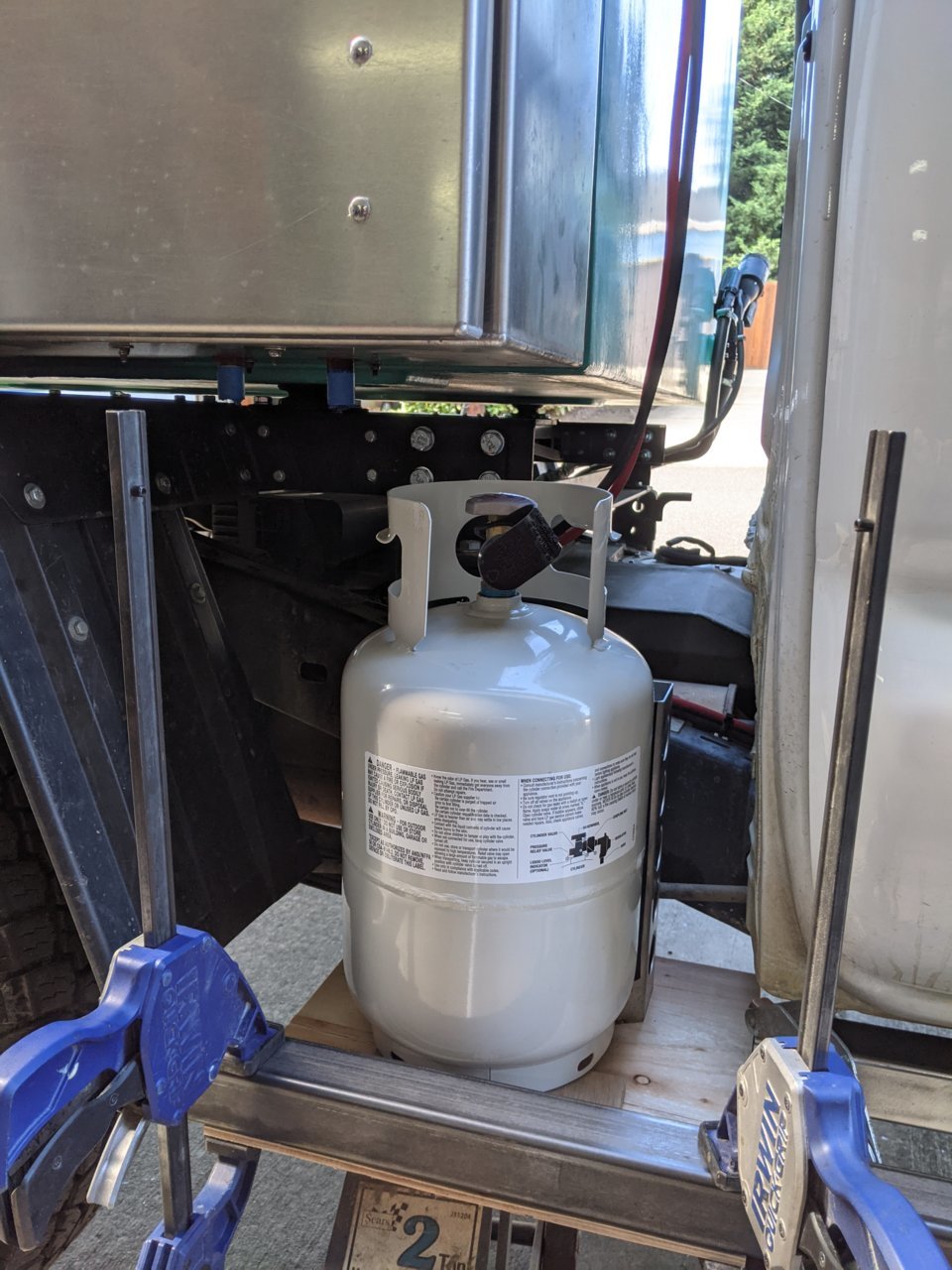

    Slider update:
    Test fit on the truck to make sure everything fits the way I want and that they look cool...because that's very important. :D
    Then I test fit the propane to make sure it fits and is accessible for refill/replacement. It works!
    Then make a mirror image version for the driver's side. Lots of stuff left to do but the bones are there and they are good.
    Planning to add filler plates to the open areas to keep mud/rocks off the truck and create a nicer place to stand. Will probably add grip tape up top as well so they aren't so slippery if I need to access the roof rack.

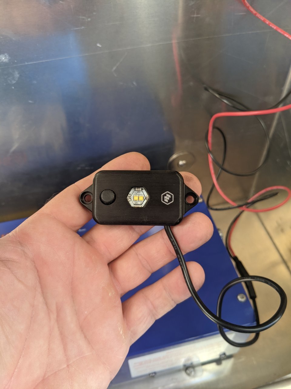

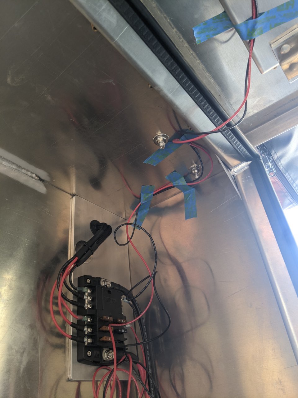

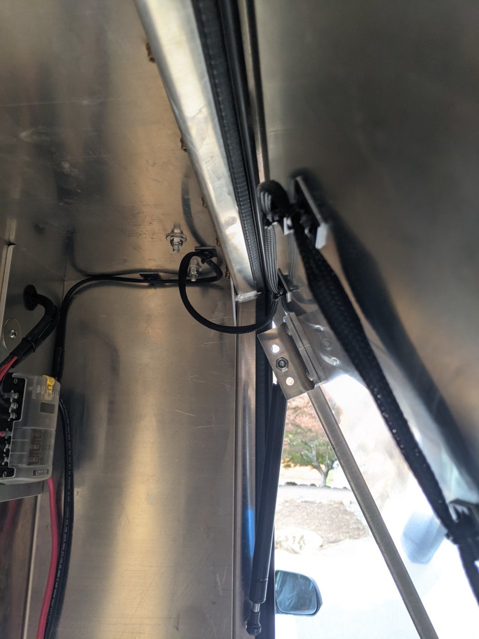

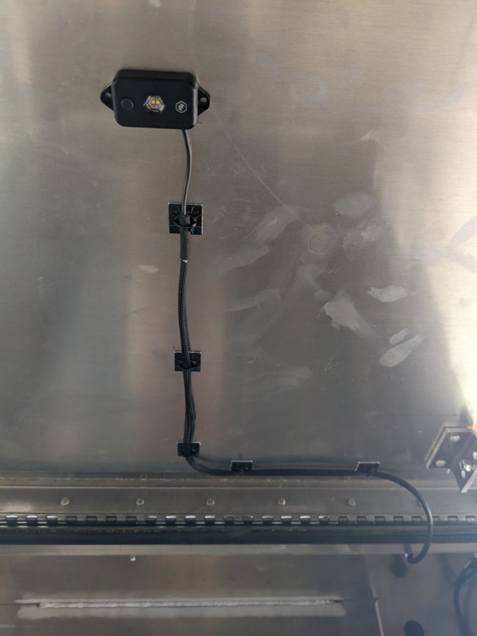

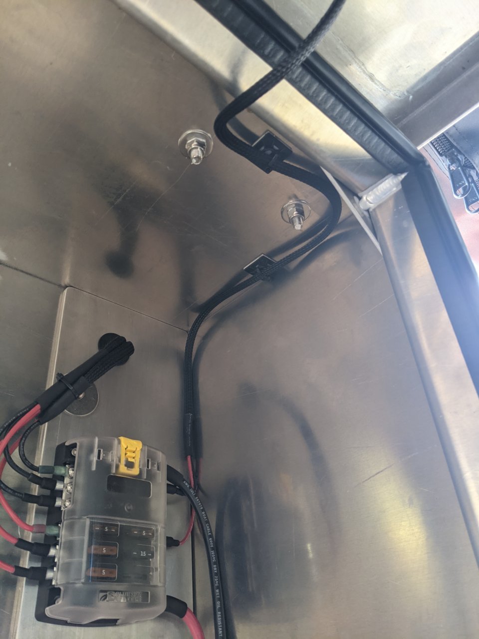

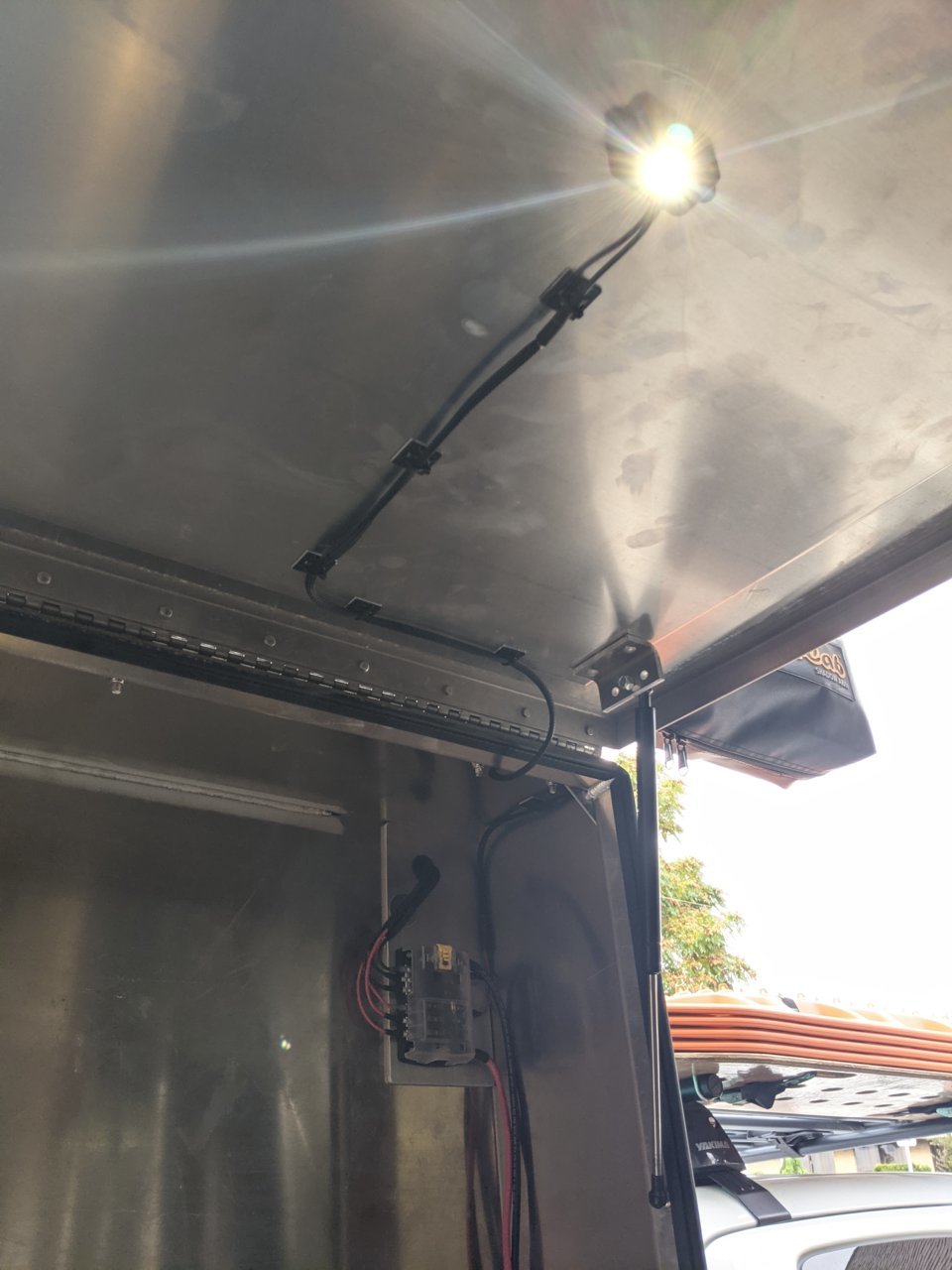

    I've been working on getting my last bit of slider and water tank mount files finished for release to cut/fab. It's taken me a while...like usual. Those should be done today I think.

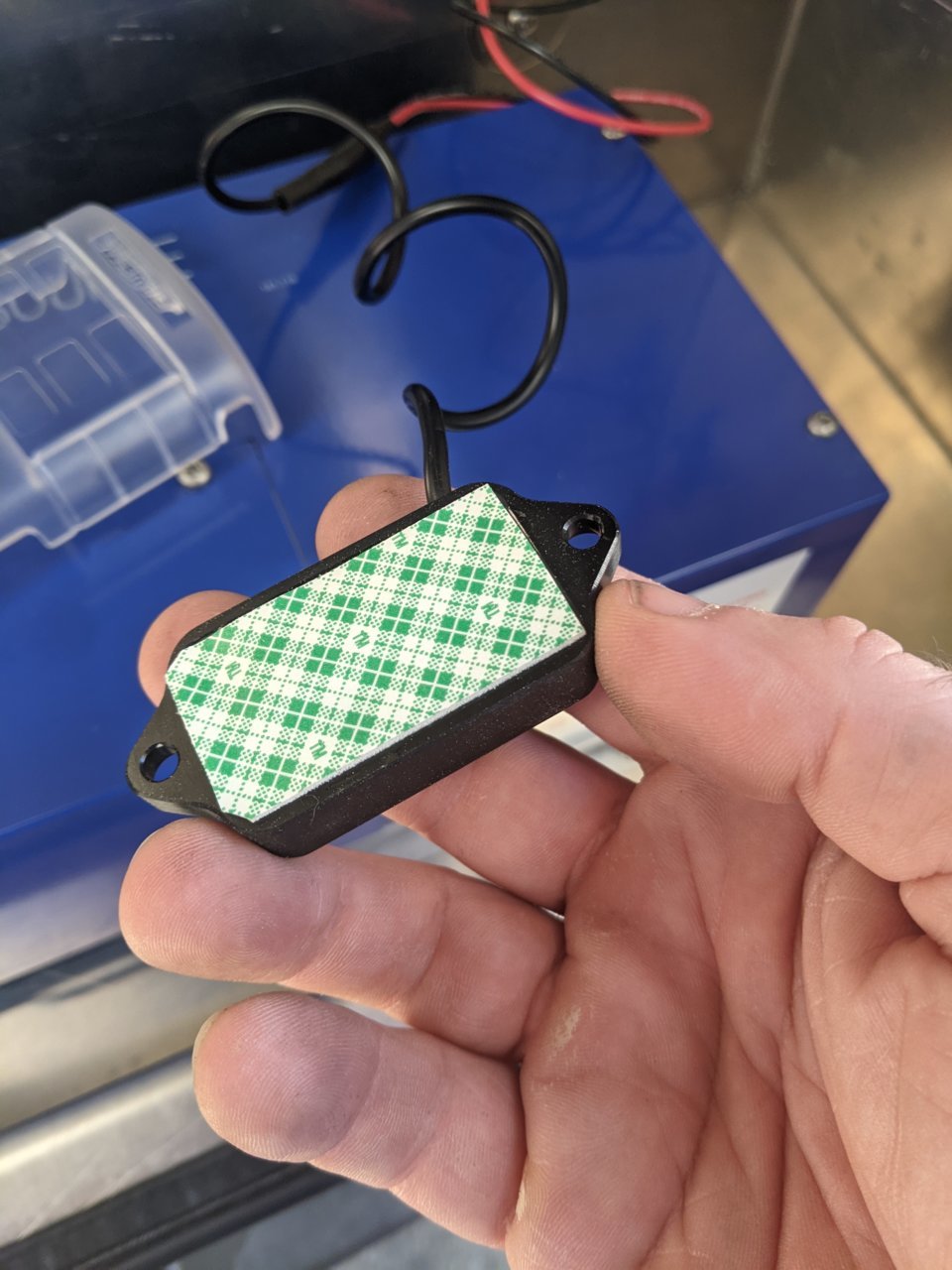

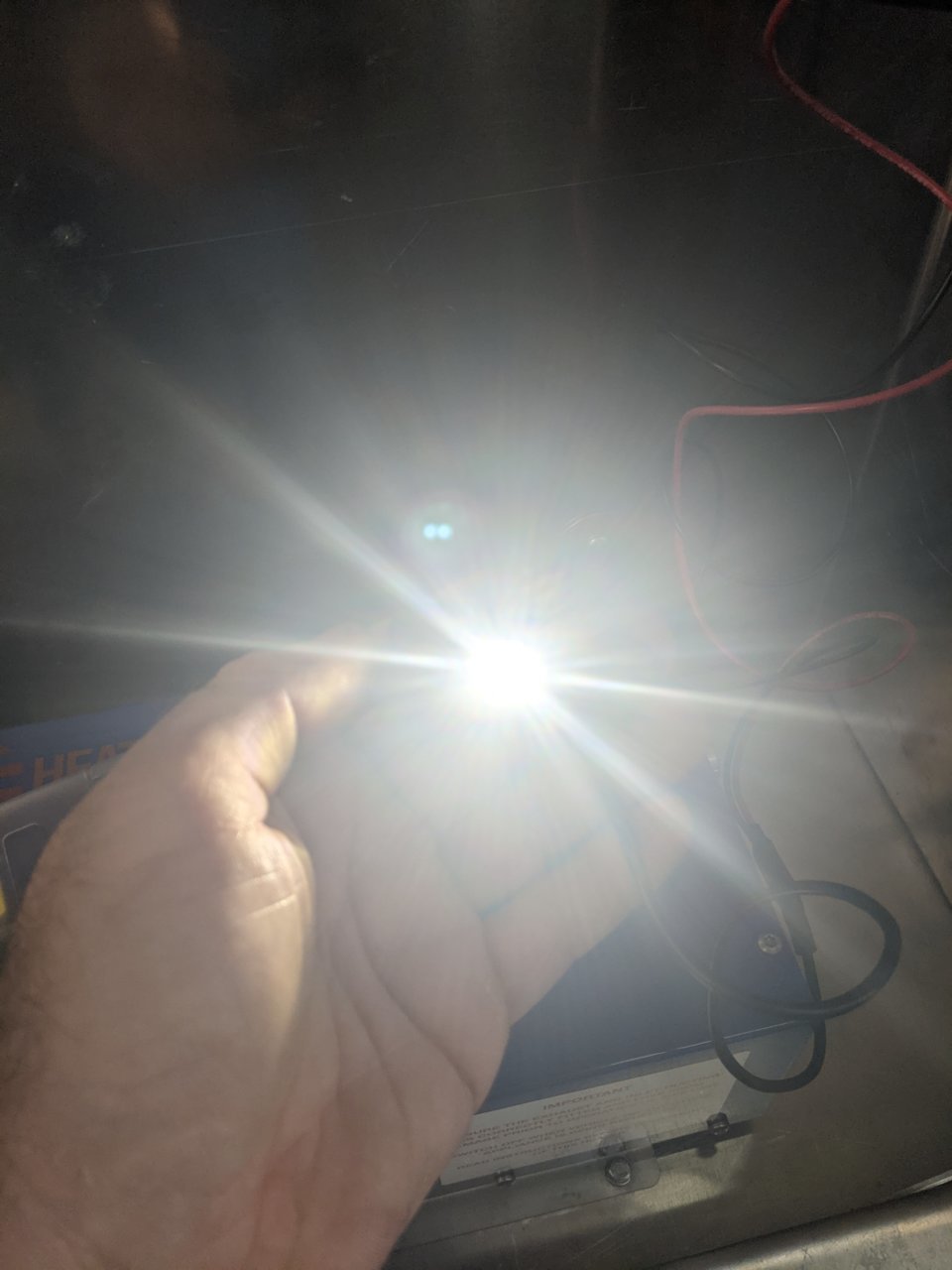

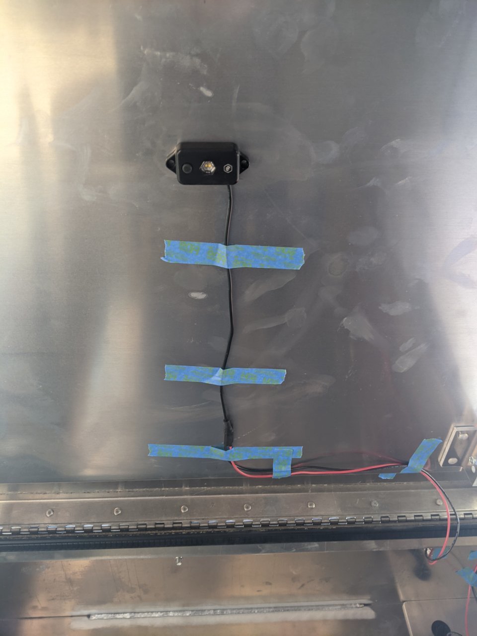

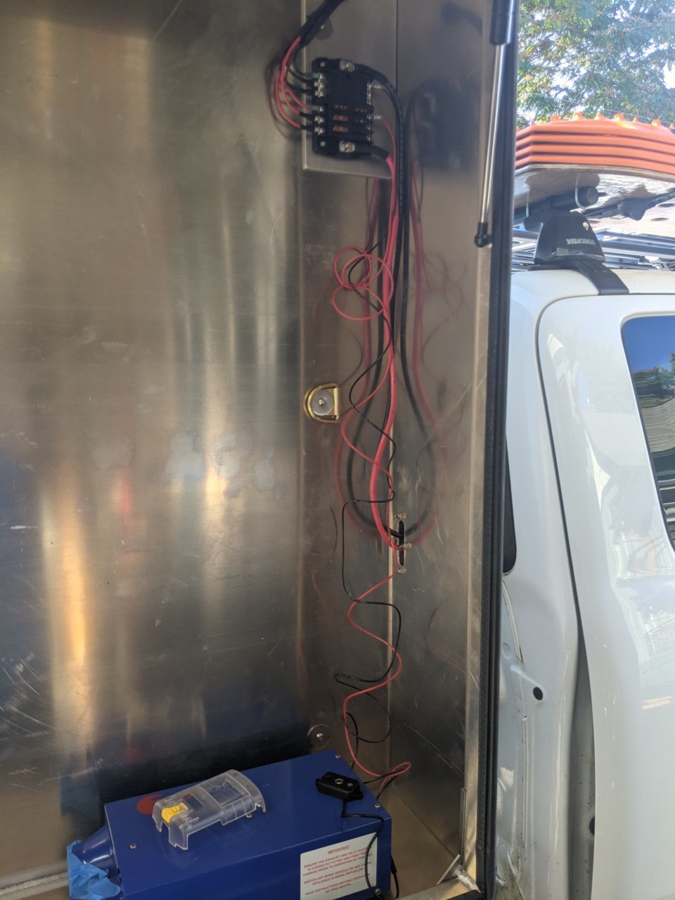

    But I felt like actually getting something DONE so I tackled a tiny project that's been sitting around for months: kitchen box light.
    Baja designs dome light.
    Quick wire mockup for length, routing and to make sure the light does it's thing.
    Just using VHB tape to mount the light for now. It may be the permanent solution. I could add some sheet metal screws through the mount holes if necessary.
    Finished up the wiring with wire sheath and heat shrink tubing. Then used some adhesive backed wire retainers with zip ties to manage the wiring.
    Gotta make sure there's enough service loop for the wiring and that it doesn't get chafed, cut, kinked or otherwise messed up. Good to go!
    I'll get a pic of the lighting in the dark, you know, when it's dark.

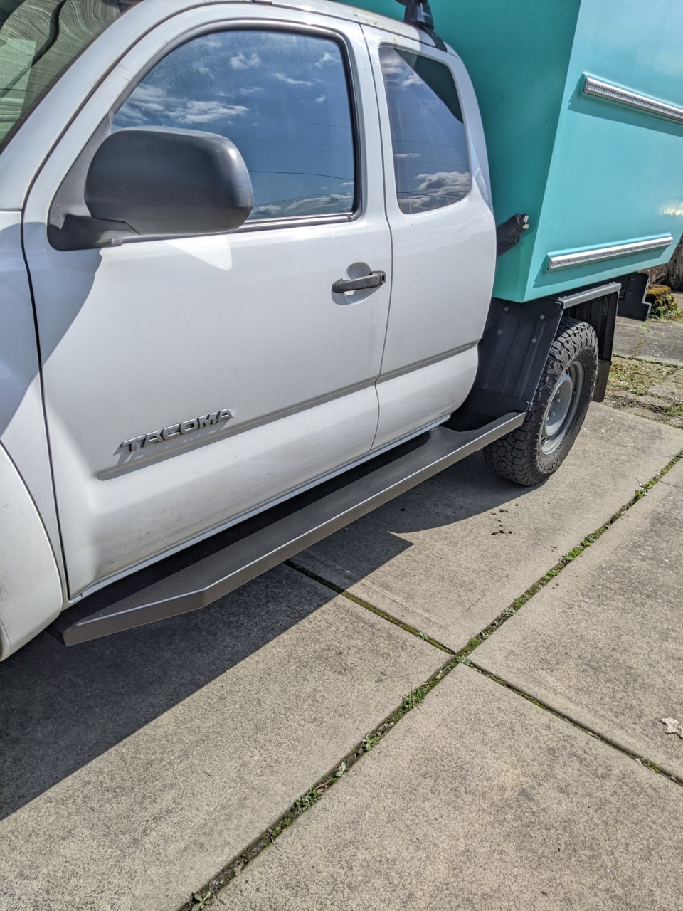

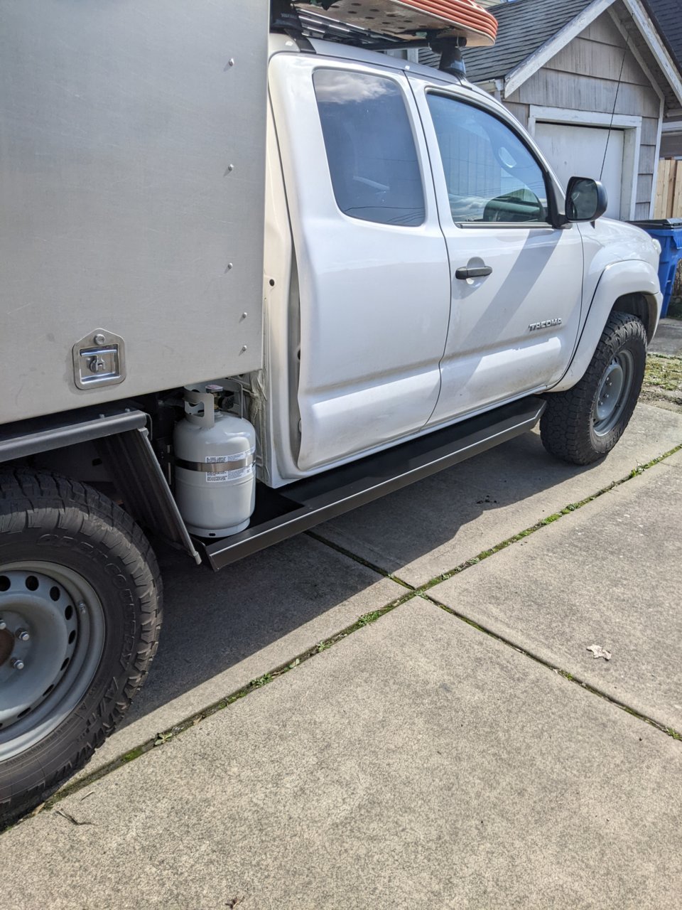

    New sliders and propane tank installed today. One more thing checked off the list. Only like a dozen left! I like the look of my old sliders but these are way more functional for what I use my truck for. I can comfortably stand on them and use them to carry stuff in the dead space in front of the rear wheels. I may add some grip tape to the outer edge to make standing in wet conditions easier. But it will catch on pant legs and tear up clothes.

    '02 Xtra Cab, '15 DCSB
    What about non-skid paint or spray on bed-liner for the slide tops? It isn't as aggressive as tape but better than smooth paint.
    1 Bored Clerk[OP] likes this.
