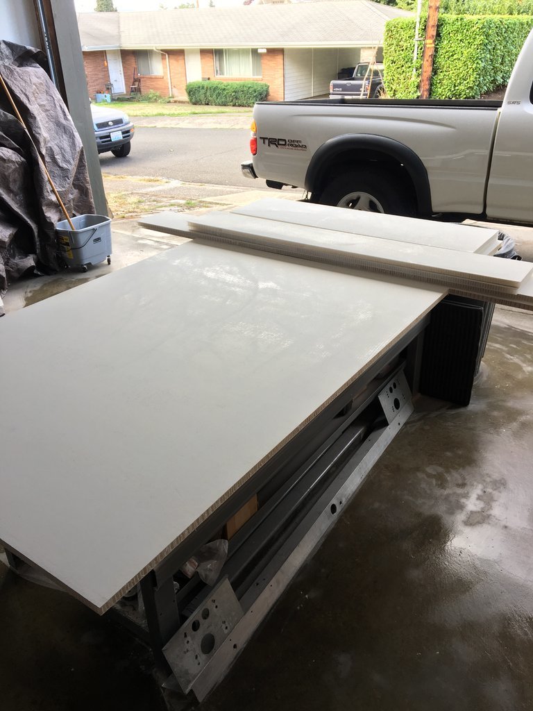

    What grit are you going with? Is this just to "roughen" up the surface?

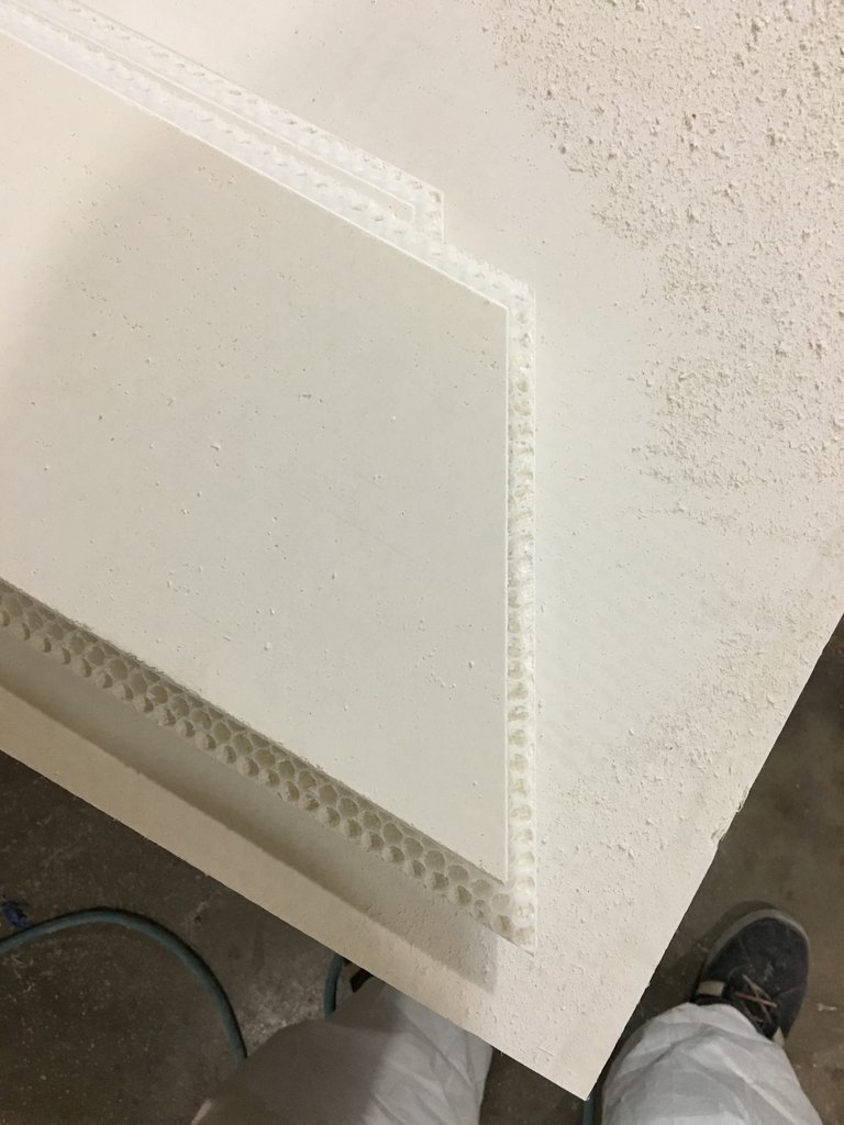

    I'm using 60 grit because I have like 40 discs and that's what's on my belt sander. The panels are gelcoated...poorly, so I'm getting through that. Gotta take all the shine off and leave a rough surface.

    I've sanded all of the roof panels.
    This is time consuming! Even using a belt sander, it takes time and effort.

    I'm wearing a tyvek suit, respirator, goggles, gloves. What you see on the floor is post sanding mopping to clean up the dust. It makes a lot of dust (like wood) so you shouldn't breathe it in.

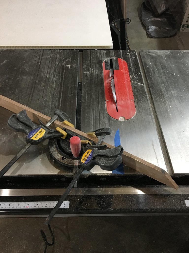

    Did some good work tonight!

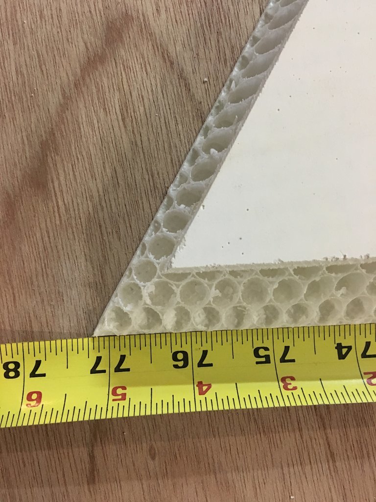

    Crafted up a real hillbilly compound miter setup and went to work on getting the raised portion of the roof done.
    Made some sweet cuts. Everything fits together nice...but...
    All four panels are exactly 2.125" too long. :confused: :rolleyes: :rofl: I'm checking my CAD right now to see what happened. It's quite odd but at least they're too long and not too short! I got a lot of practice in so now I'll be ready to do it correctly! Later. Because that was enough disappointment for one night. Haha.

    Hillbilly or whatever you want to call it doesn't matter 'cause it worked! :thumbsup:

    Worked really well actually. I found out what the problem was. One miter was supposed to be just short of 35 degrees and I cut it at 30. I won't have a chance to correct it again until Friday but at least I know! And it wasn't a tragic error. Change the angle, trim, should be good to go.

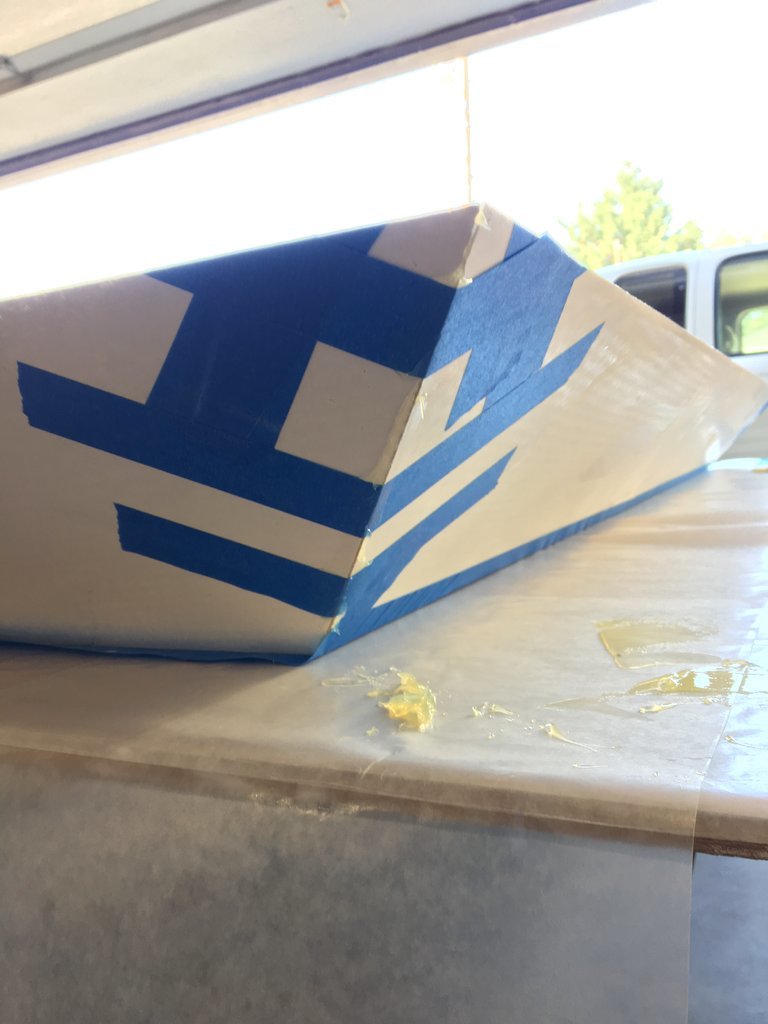

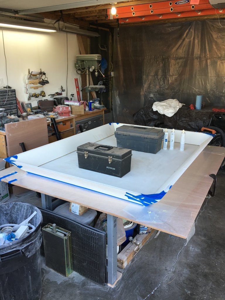

    Knocked out the raised portion of the roof this morning!
    After I trimmed the corners to the correct angles, it fit together really well. I used tape to do all of the work holding. I didn't get full photos of that but I can explain further or demonstrate with scraps if anyone is curious.
    Here's one of the corners taped up to cure. It went together really well, I think. I put two toolboxes in the middle of the main panel to assist in keeping it flat. Then I just made sure the edges lined up. I'm sure it'll be flat enough!
    Next up once this cures is to put epoxy fillets on the inside corners and radius/fill the outside corners. Then it'll be ready to be put on the camper when that box is ready.
