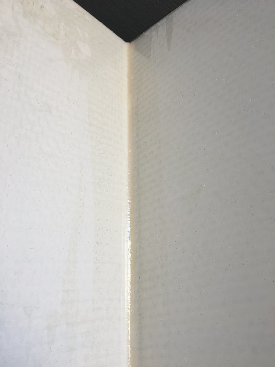

    So, I wasn’t completely happy with some of the edges after sanding/routing so I filled in some gaps and sanded and routed again. Then I put epoxy fillets on all of the inside corners (only 4 on the outside of the camper).
    That’ll do it for today unless I get motivated this evening. I have an appointment coming up and it’s not enough time to dive into laying glass. At very least, I’ll be laying glass on all the seams tomorrow!

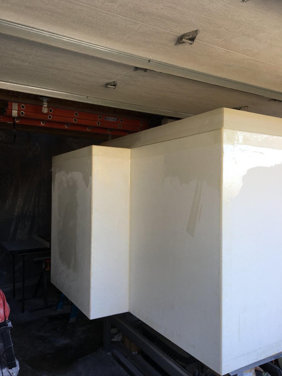

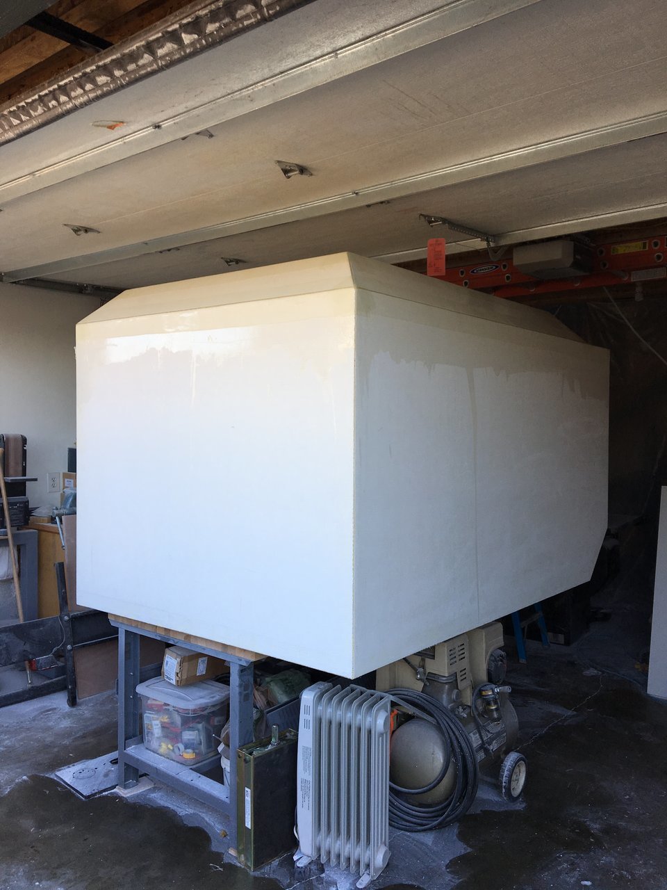

    Glass taped all of the upper edges.
    It was very difficult to control the resin as evidenced by all the resin smeared down the sides. Haha! This is all I could muster today. I’ll do the vertical edges tomorrow...and maybe the bottom edges. We’ll see.

    How hard is it to work with the glass?

    Not hard at all, if you don't care how it looks.
    It helps if you're anal about how it looks. Not meant to be a slam on the OP, he has done an excellent job on both of the projects and obviously has skills that wasn't available in the hand-out line I was in.

    I certainly don’t fall in the extreme anal category but I care more that some, less than others. I don’t mind some sanding and fairing to get her looking better. It’s all an experiment!
    And, I would fully recommend diving in with both feet with epoxy and fiberglass. It’s pretty fun. Especially if you’re gentle with yourself about the process and end product with regard to looks and strength. West systems and their pump system are excellent for making epoxy that will cure every time.

    Oh, and using a brush or roller would make the job much cleaner. I’m lazy about the most stupid things. But I’m old enough to have made peace with that. :der:

    Are you still going to leave it sitting as is or try and rotate it? I imagine from what I've read that laying glass is much harder from underneath.

    Well, using thickened epoxy as the first coat before laying the glass on seems to be working for the tabs that I’ve folded underneath. I think it’ll be fine. Wetting our the glass while it’s upside down may be a problem. I may have to wet it out on the bench then lay it in place.

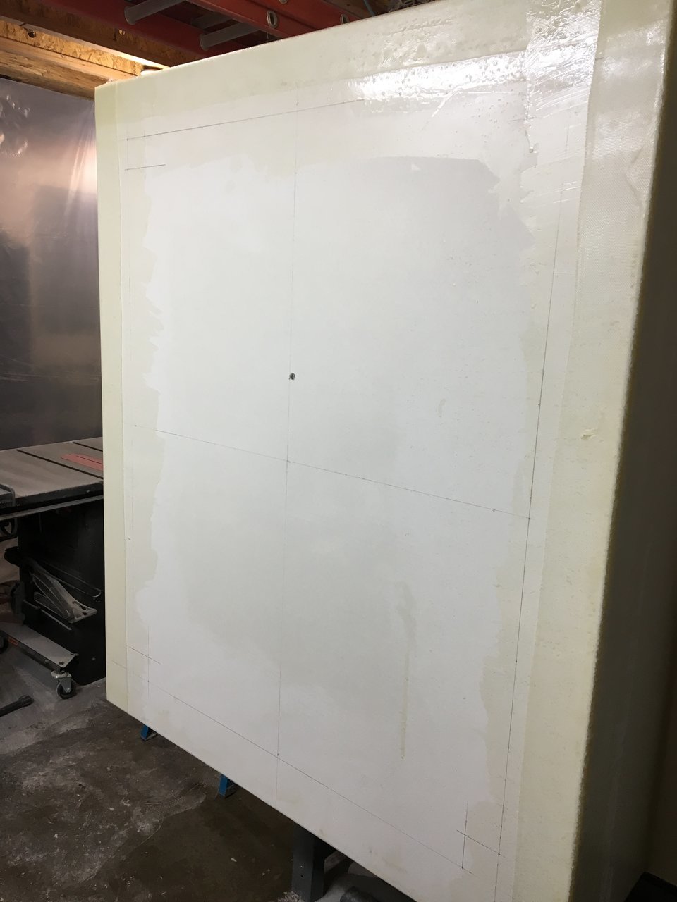

    Well, I didn’t feel like doing more glassing tonight so I laid out the door opening instead. It was on the list to do this week so it’s all good.
    It’s a decent sized door to crawl through. I’m cutting to within 4” of the panel edge. I assume that’s still enough panel left to do it’s job holding the camper together. It will be backed up by 1/2” plywood epoxied in place as the surface on which the seals will...seal. All of that together should be stout. I’ll be cutting this hole this week. Will be nice to see inside!
