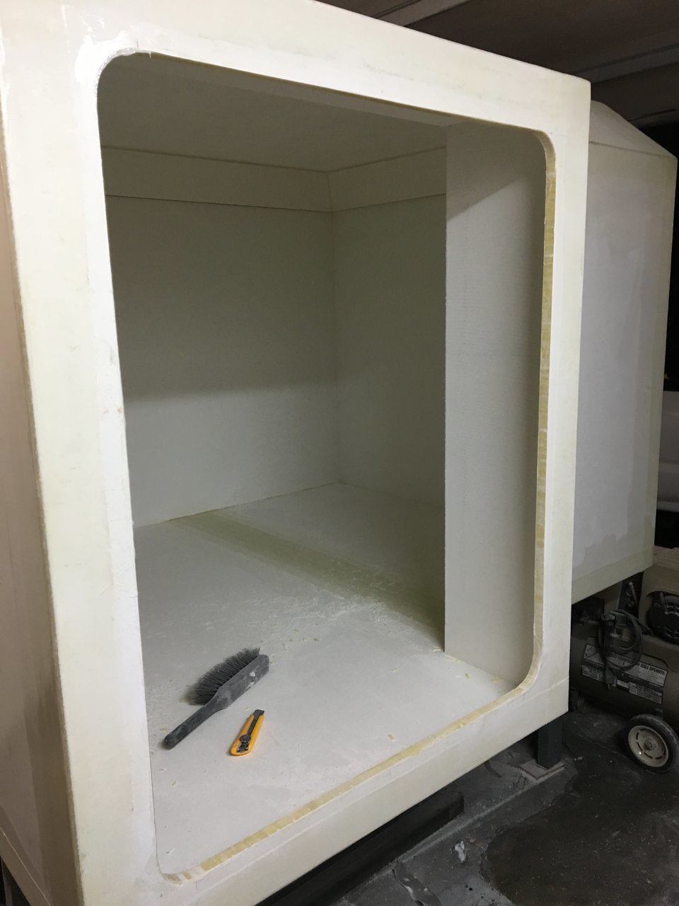

    Well, I used a router to clean up the straight edges on the door opening on Monday night. It didn’t go perfectly. But it went okay. I’m going to finish it off by hand, with a block. It’ll be easier and more controllable. This is one of those situations where a power tool did not make life easier.
    I also got my quote for the two aluminum boxes. They ended up about $200 (total) under my ‘it COULDN’T POSSIBLY cost more than this’ guess. So, that’s cool. Still expensive but I knew that going in. They build the best boxes around. Mostly due to the seals. Anyway, probably around two weeks to get those.

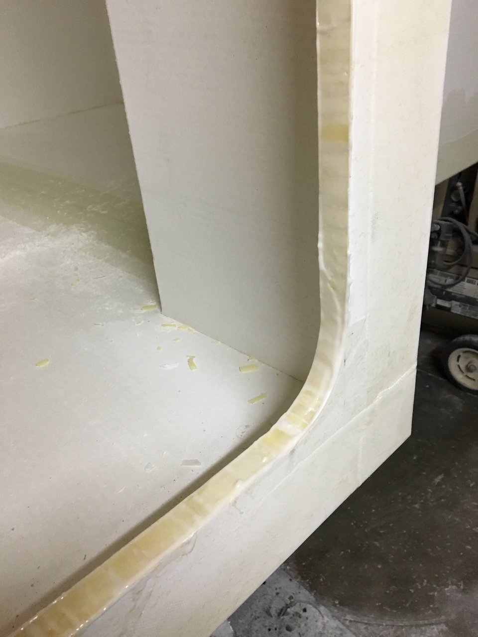

    Did some hand sanding and epoxy filling. I’ll likely keep at this for several rounds until I’m happy with it because it will be the most scrutinized thing on the camper because it will be where I go in and out. Having it look funky would be like having a dent on your drivers side door. Passenger door you can deal with a little easier but not the drivers side!
    Fresh resin to fill in voids and low spots.
    It’s okay but I want it as nice as my patience and ignorance will allow. I also messed up and epoxied this before I wanted to. I wanted to get the door hinge plate epoxied into the left side before I filled it all in. So, now my job there is much bigger than it would have been otherwise. Ugh. I knew the door would be the trickiest part. Also, filling in the exposed core material is a real pain! It doesn’t want to stick and there are all these little flaps of plastic to try to deal with...it doesn’t like to sand. It kinda sucks bad. Oh well, I’m in it now! Just gotta trudge forward and get it done.
    Oh, and all of this will be glassed over for strength and sealing.
