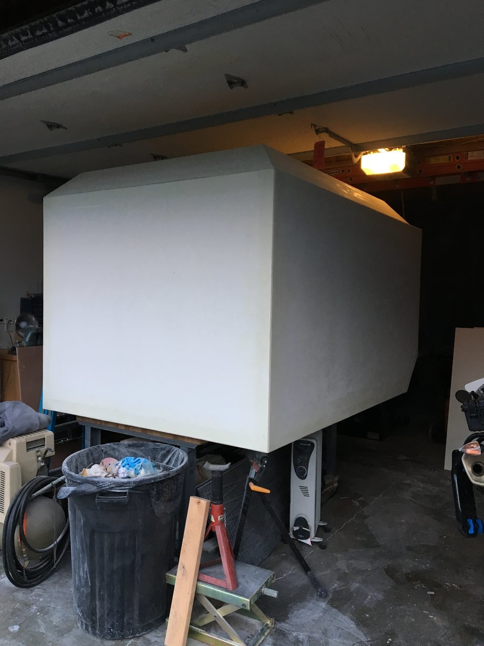

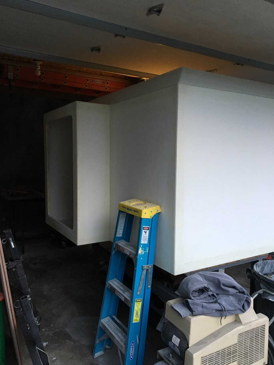

    Did four separate stints in the garage today. Ended up getting the entire exterior sanded! Not that you can tell from these photos...
    Sanded every edge, seam and surface to get rid of all the shiny spots, ridges and lumps. A good cleaning and it’ll be ready for fairing goo!

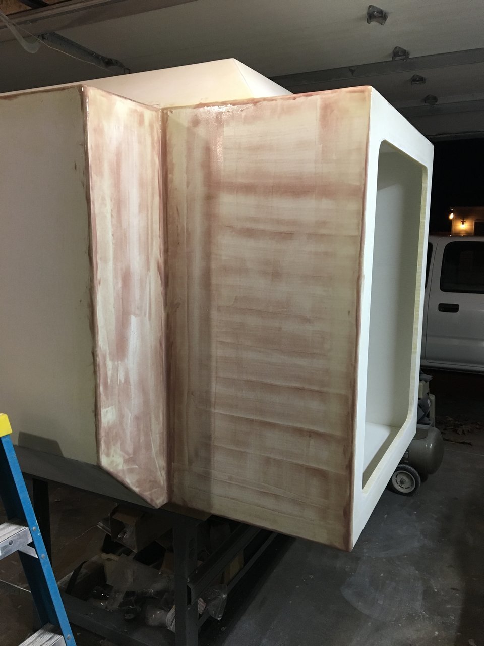

    I started with the fairing compound tonight. I took it easy since I have no experience with this stuff. It’s like Bondo: put on the LEAST amount possible as you will be sanding most of it off. We’re not frosting a cake here!
    I did these two surfaces and the two flat surfaces above. The microballoons are red so you can see what’s going on with the fairing compound. That’s handy! Like I said, I took it easy here. I put on a very light coat and worked it around to see what happens. I’ll sand it smooth in a day or three and see where we end up. I may see about getting a much wider spreader than the 6” wide one i have. Should average out the surface better.

    Look for a good mud spreader for sheetrock. That should do you just fine.
