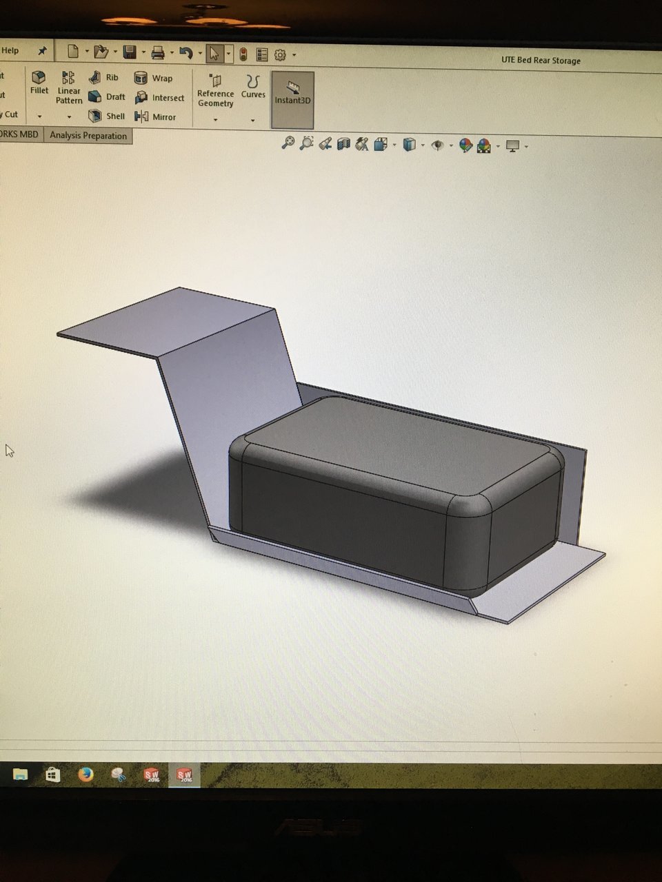

    What CAD program are you using?

    Solidworks.

    I've been using TinkerCad as it is free, but am limited by it's simplicity. Is there any other free programs you can suggest that would allow me a little more creativity?

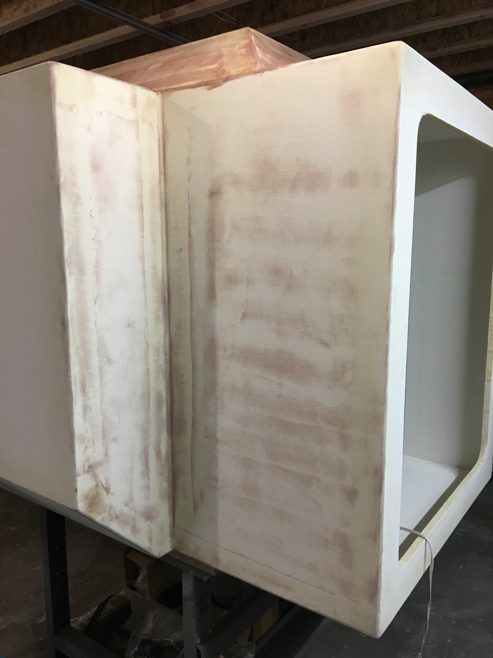

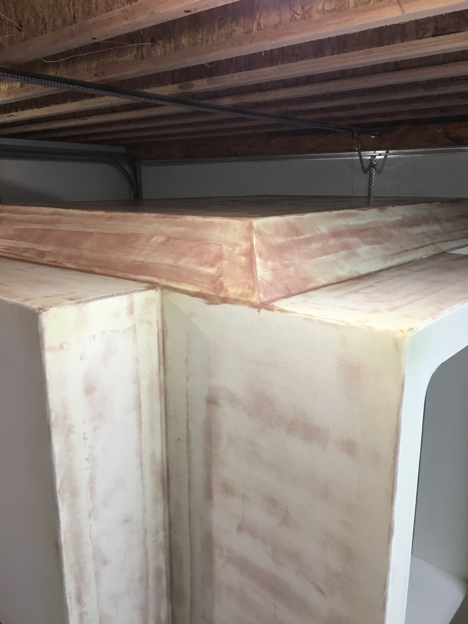

    Just to remind everyone what this thread is all about... (I’m looking at you Overkill07) :boink:
    I sanded the previously gooped parts of the camper. Came out pretty smooth! Doesn’t look like it here but it’s smooth to a bare hand and that’s smooth enough for me.
    Then I coated almost all of the rest of the camper. Still need to sand it.
    This process smooths out imperfections, and while doing so, also fills in voids. I noticed, when glassing, that I’d get small bubbles in some areas where, I’m assuming, there is a tiny void (pinhole) that goes all the way through the glass to the core. Now that I’m covering the entire surface, I’m seeing tons of these bubbles. Because I’d like to avoid as many issues as possible when painting, I’ll likely have to go over the camper two or three times with this fairing compound in an effort to seal all of these pinholes. I think that’s the right way to do it, anyway. Make it as sealed as possible before any paint at all. We’ll see.

    So are the pinholes something that is common this this material that you are using?

    I think it’s common but I’m not sure

    Pin holes in resin are usually cased by air while it dries out. Very common, get your glass work done 100% and then go over the entire surface with a liquid type polyester putty, super thin skim coat, and lightly sand it off.
