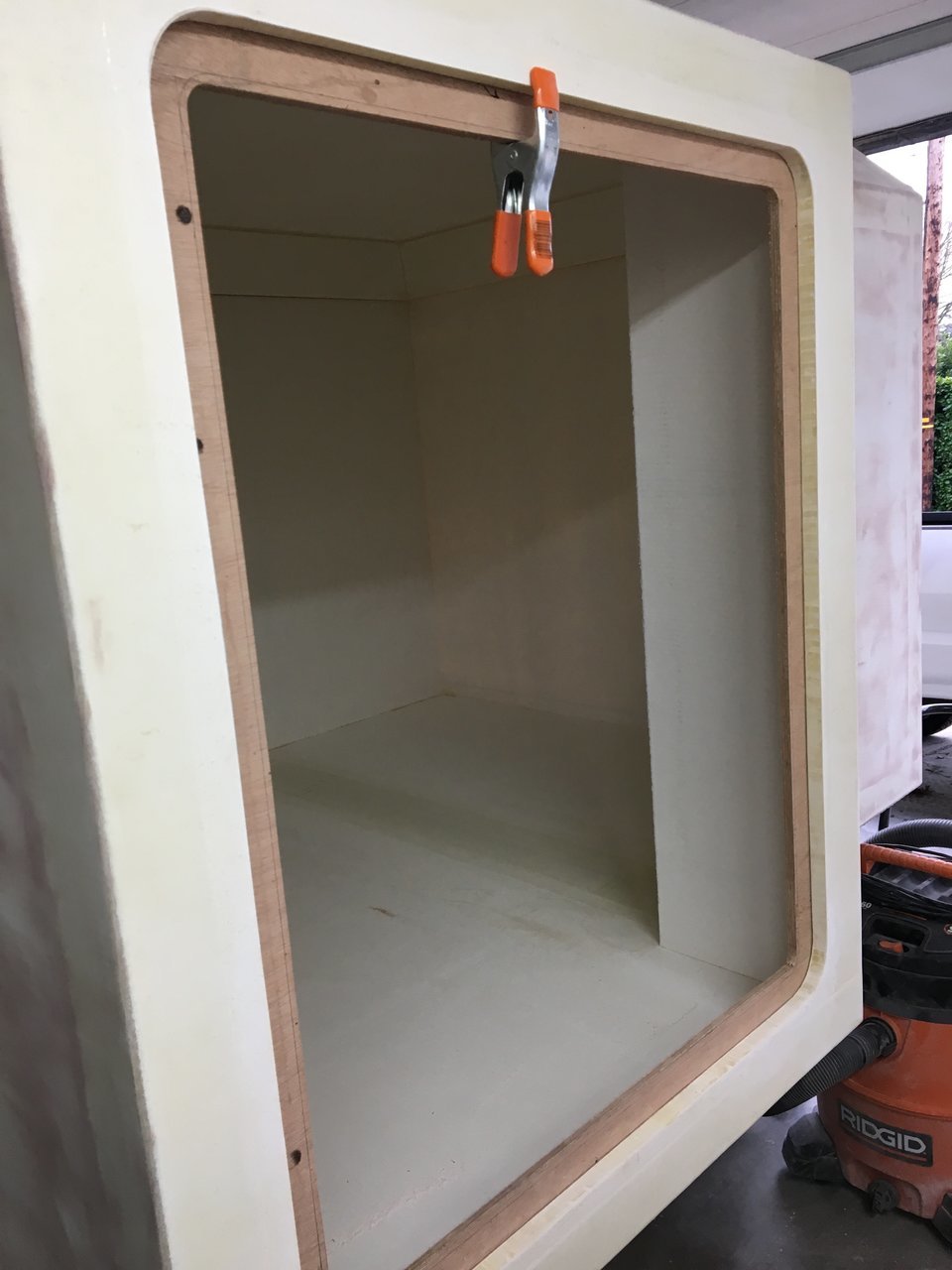

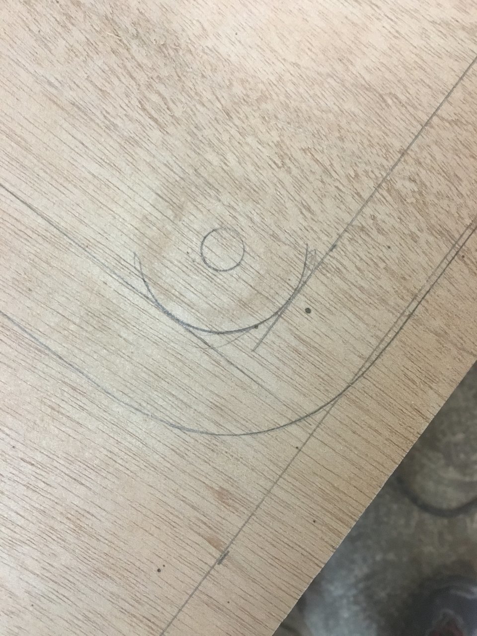

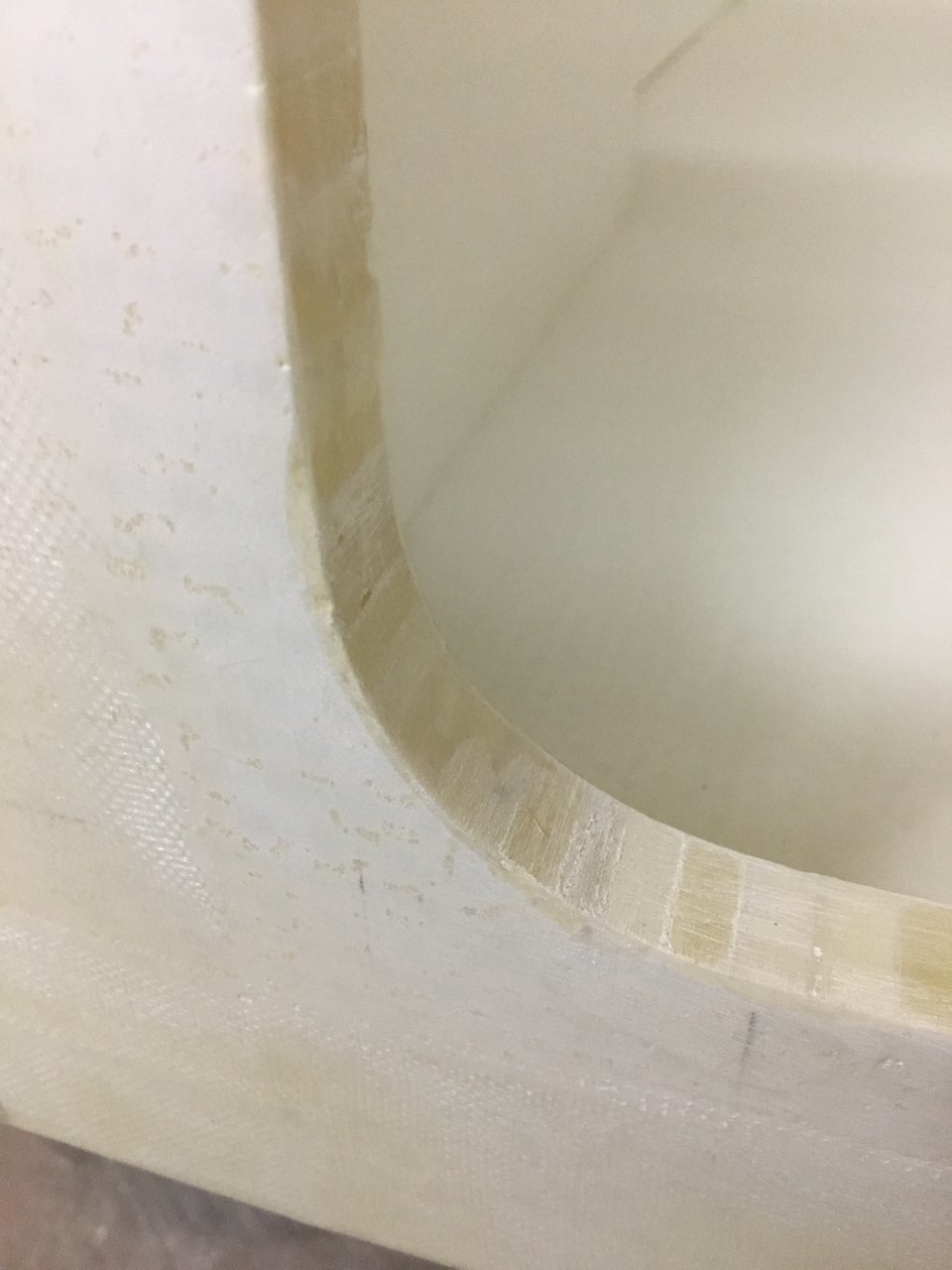

    Made some progress this weekend. I worked on the door opening: sanded/filled edges and started cutting the ledge for the seal to close against.
    Working on making these corners round and tangent to the runs adjacent to them.
    Cutting the seal plate
    First test fit! I need a quarter inch spacer so there’s room between the door and the seal plate for the actual seal. I could make a recess in the door for that but that’s way more work to finish then putting a spacer of 1/4” marine plywood between this seal plate and the door opening. Now I just need to go buy more plywood. Would be lovely if I could get a half sheet.

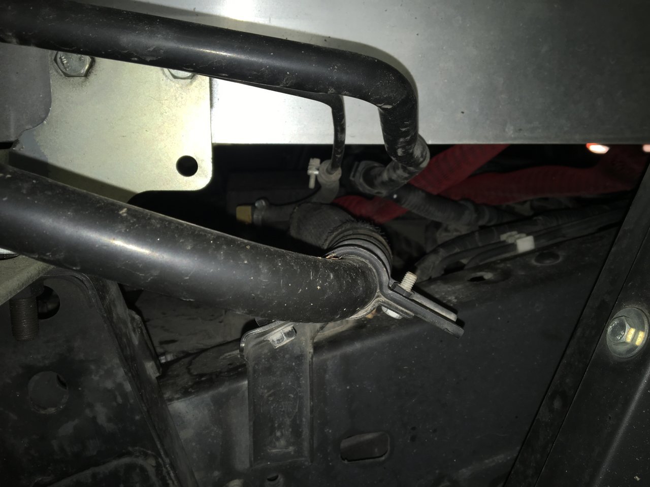

    Here are a couple of photos to help shed some light on what’s going on with the fuel filler.
    Normally the two vent hoses are attached to a piece of plastic along with the fill tube. That doesn’t work. Separate them. It should roll forward easily at that point. I used the clamp for the fill tube to hold everything in place...temporarily. It’s still like this but I have plans that will better support the whole system. I did slightly tweak the bolt-on clamp in the photo to get the fill tube in a better position.
    I think that’s the best photo I have that shows what to do. Let me know if that works. If you have more specific views you’d like to see, just ask

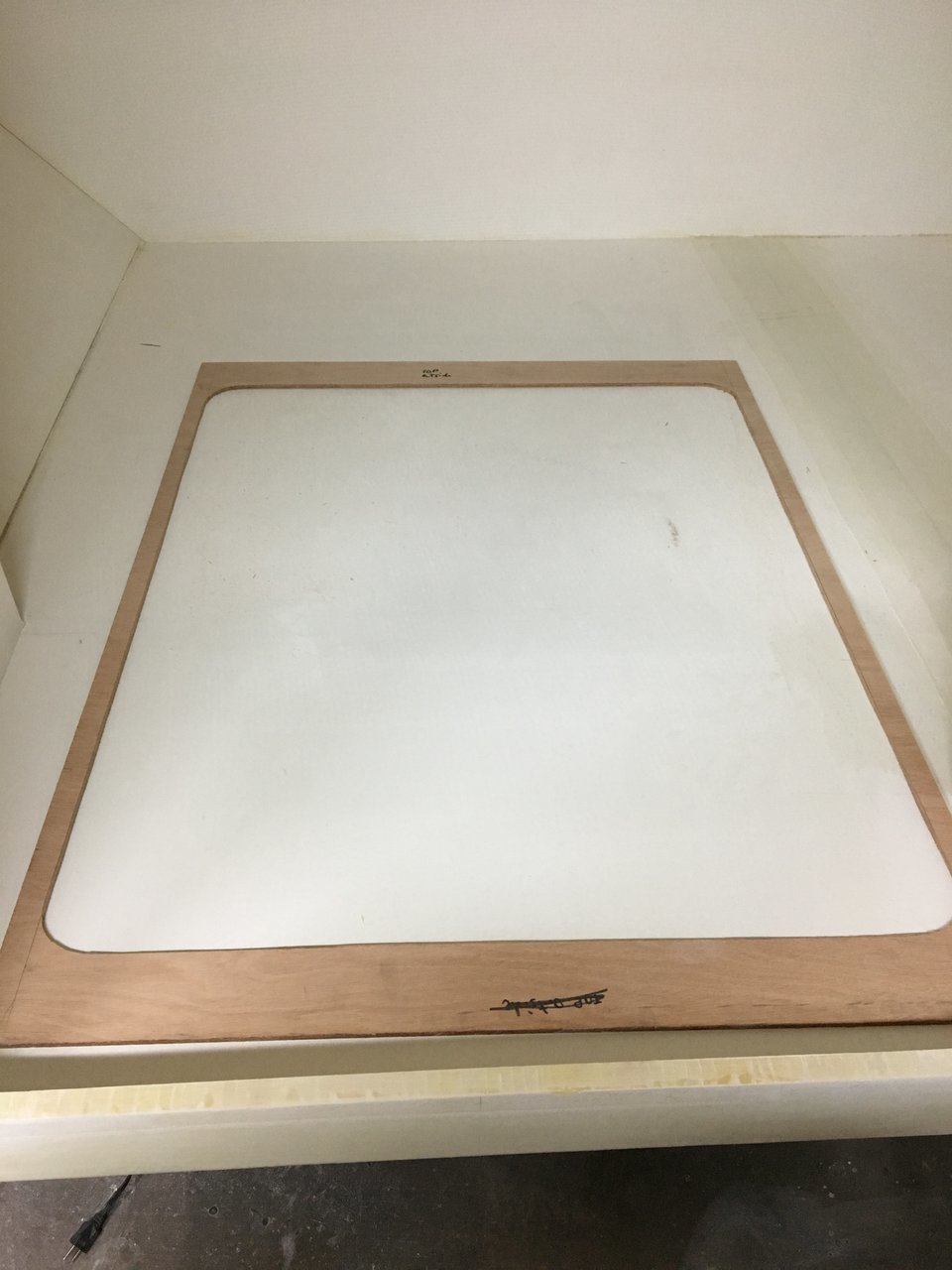

    My dad was real cool today a picked up a half sheet of 1/4” marine grade plywood for me. Hooray for retired dads!
    And here’s what I did with it. This is the spacer that will create room for the fully compressed bulb seal when the door is closed. Hopefully I have it all figured out and I don’t compress the seal so much I can’t close the door.

    Thank you. I’ll take another look to see what I’m doing wrong. My one tube is kinking a rubber hose. Can’t imagine different filler necks between dclb and a ess cabs. The pic helps a bunch.
    The spacer looks awesome by the way. Lots of work to cut that out and make it look that good.

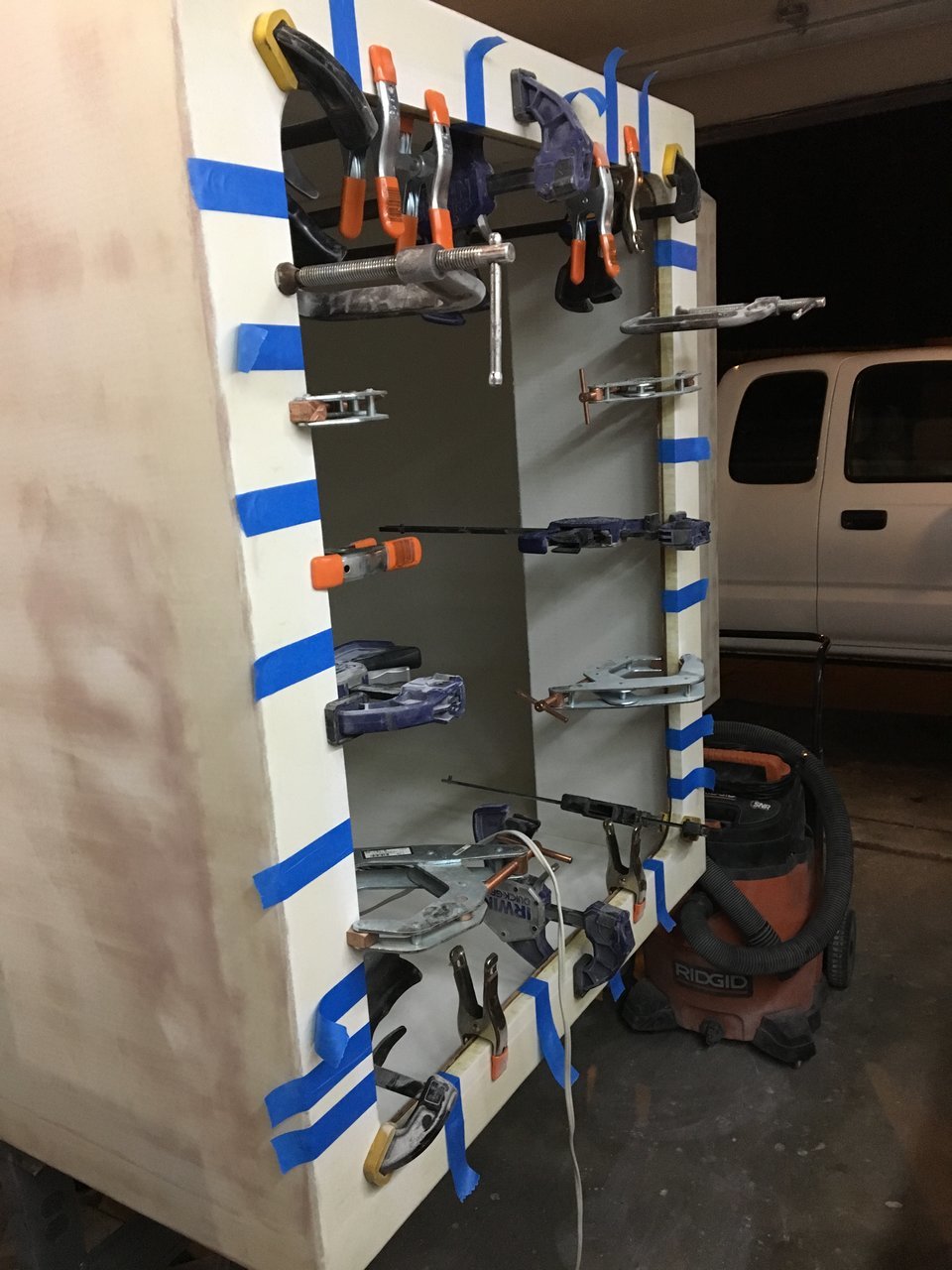

    Look, you all know how I feel about clamps and blue tape so we’ll just look at the picture and not say anything.

    you own ALOT of clamps...

    Pfft...three of them were still on the wall! I’d probably be happy with twice as many. I’m always clamping the hell out of something.

    The best part is that the same type of clamps are being used in the same position all the way around....Can we use a blue quickgrip in the corner??....no, that's where the yellow ones go.
    It makes me laugh, because I do the same thing.
