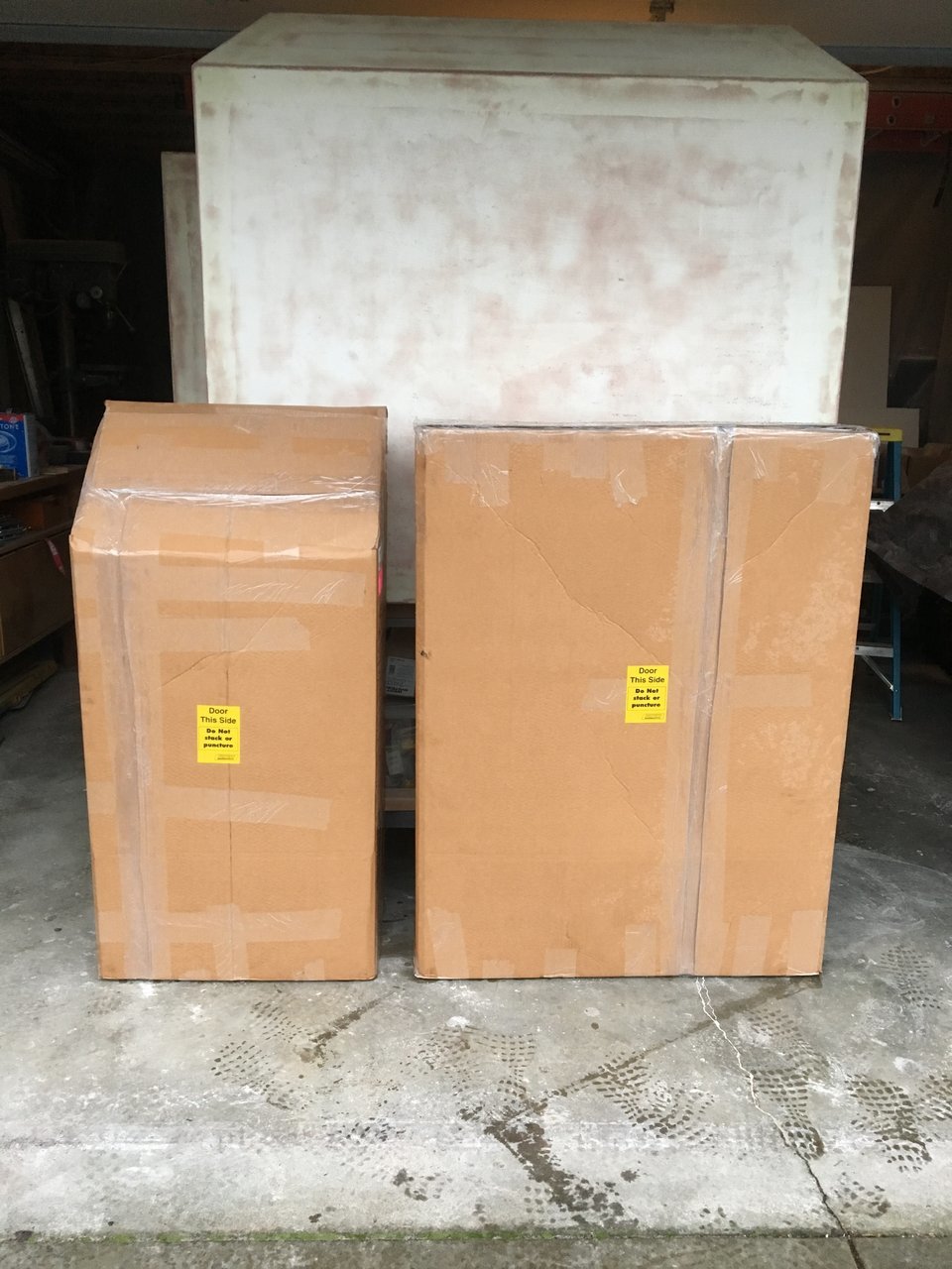

    Going to pick up my aluminum boxes today! I hope they fit well. I think I’ll have to sharpen the two inside corners of the camper where the box edges will meet but I’m sure I can deal with that.

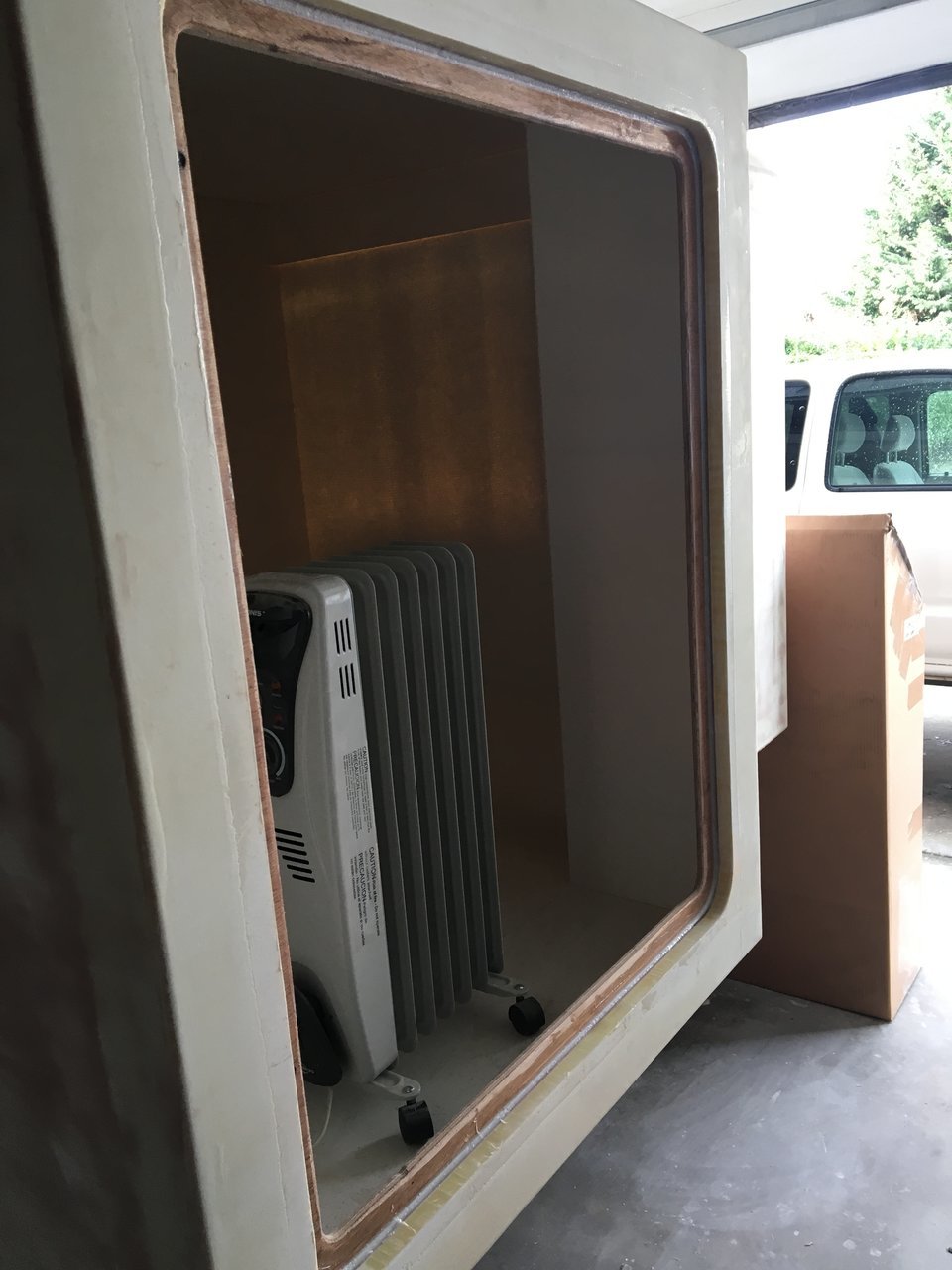

    They are .125” thick with a roughly .25” radius corner. I wouldn’t feel comfortable grinding that down. On the camper side of things, I may have to reduce the 3/8” radius on the 90 degree inside corner. Fiberglass doesn’t like to conform to tight radius corners but I bet I could fudge it just enough to work on an inside corner. Outside corners seem more intolerant of tight radius than inside corners. We’ll see.

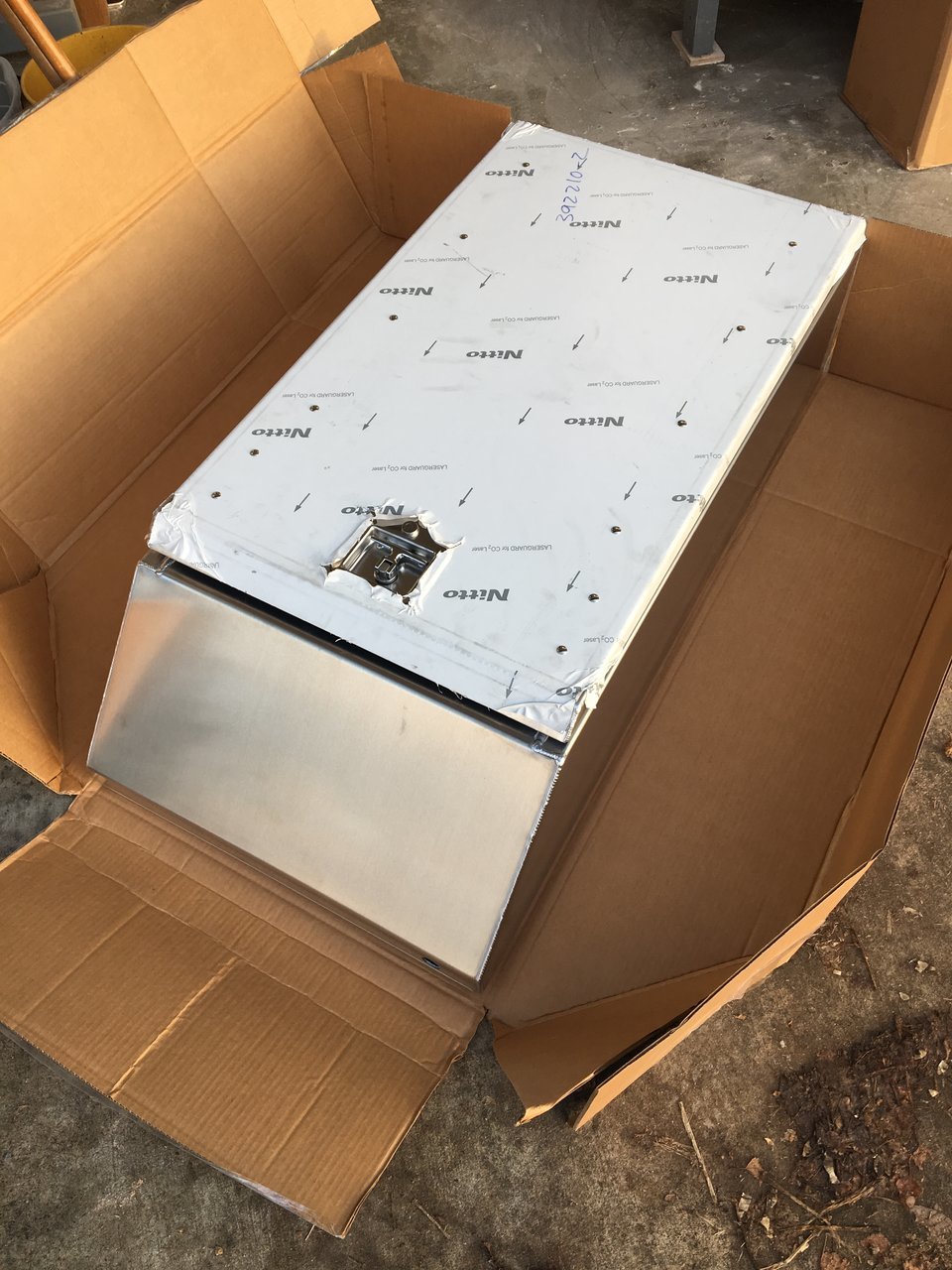

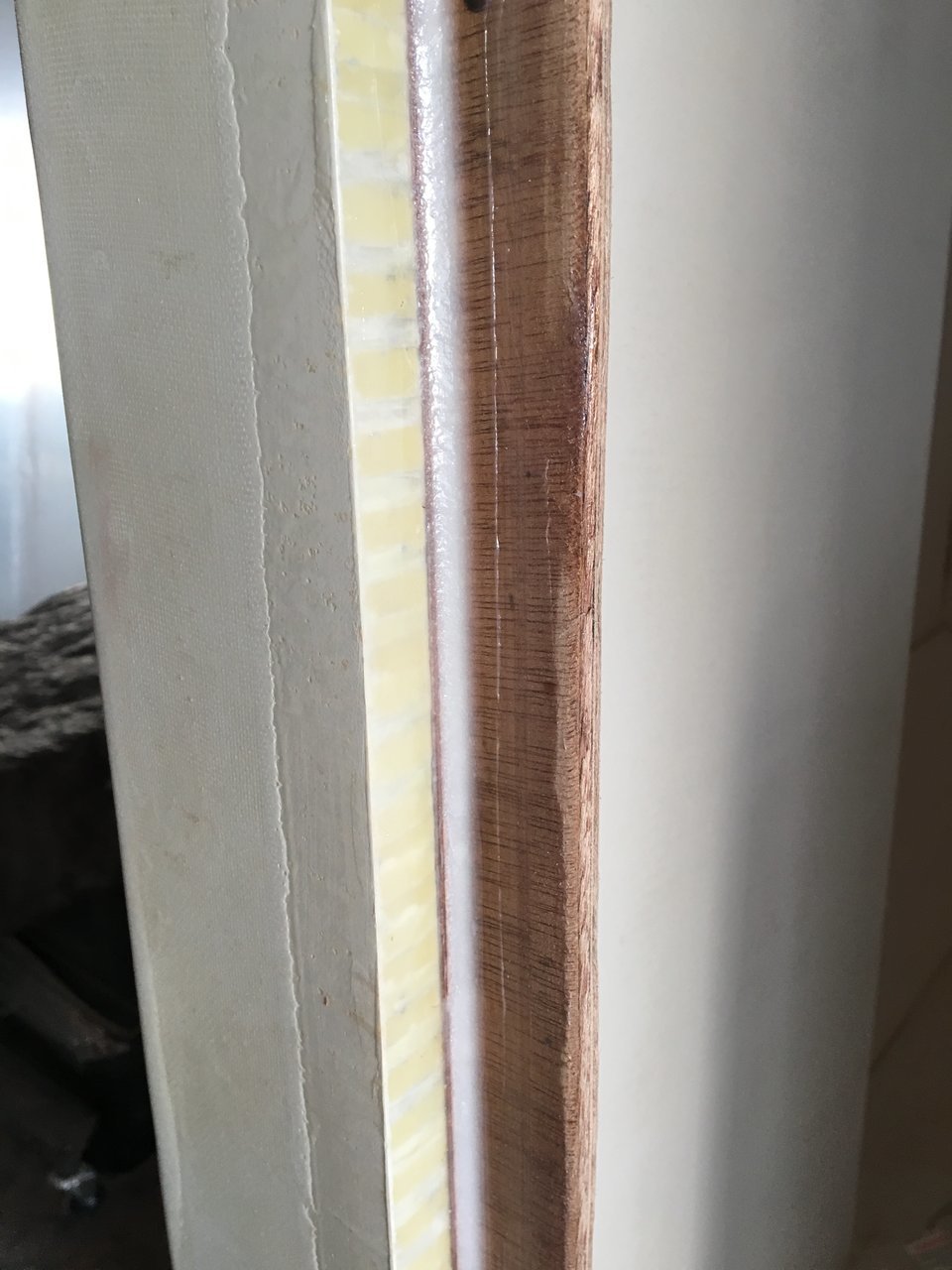

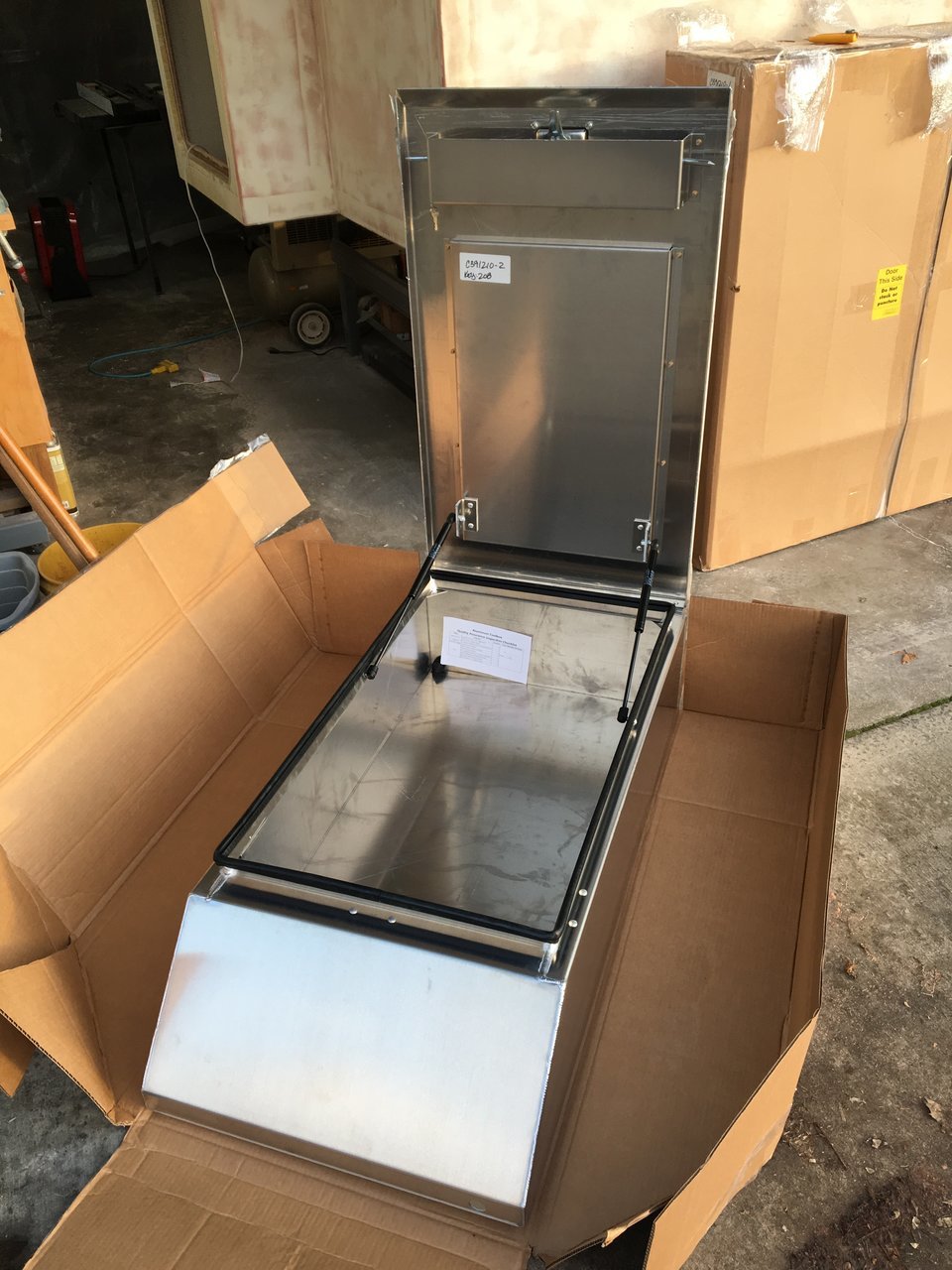

    Got the seal lip on the camper and later in the epoxy fillet.
    Opened one of my new boxes to check measurements and whatnot.
    This thing is ridiculous! It’s so nice! Pretty hefty so I’ll need a second set of hands to lift it into place.
