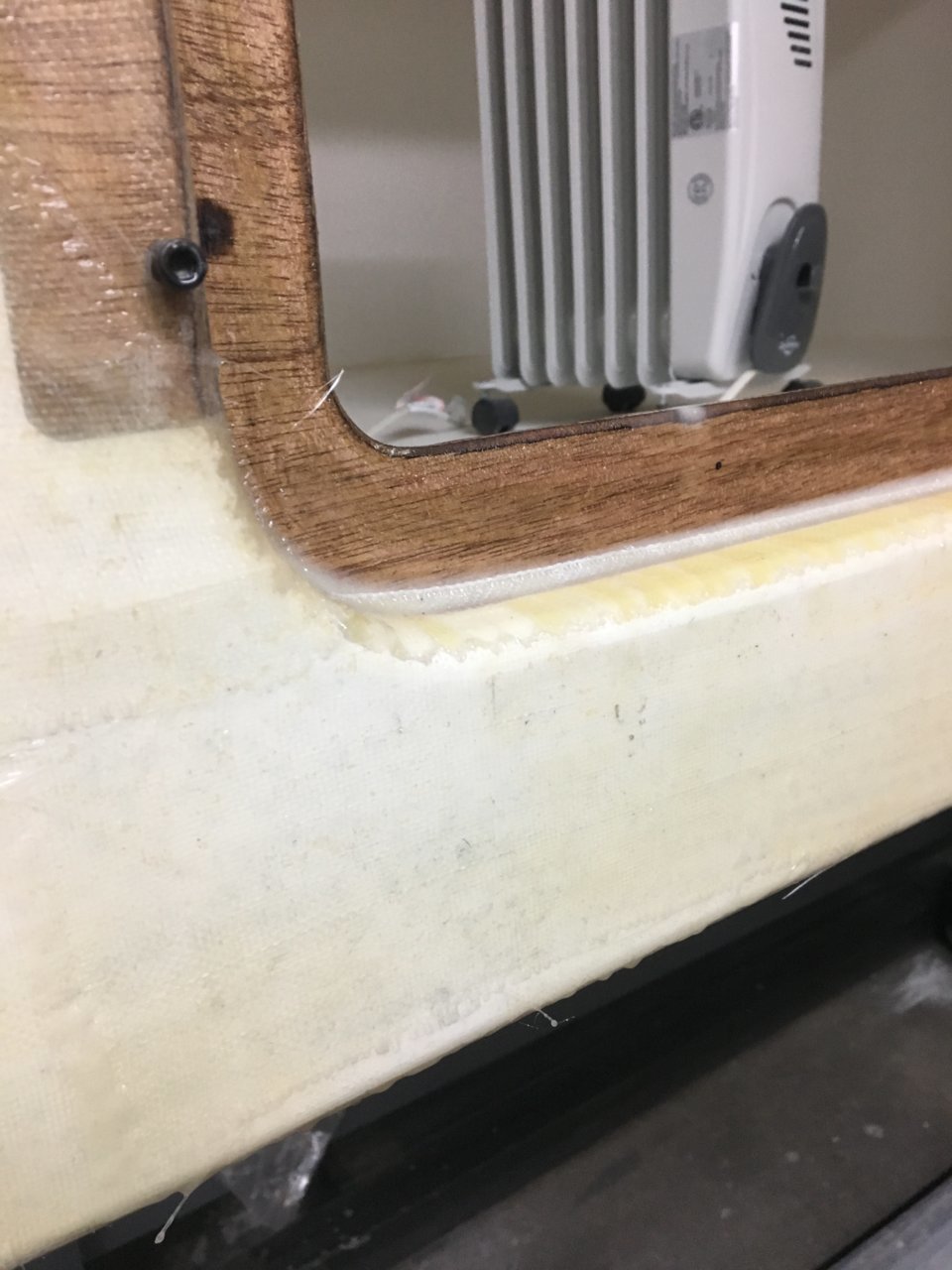

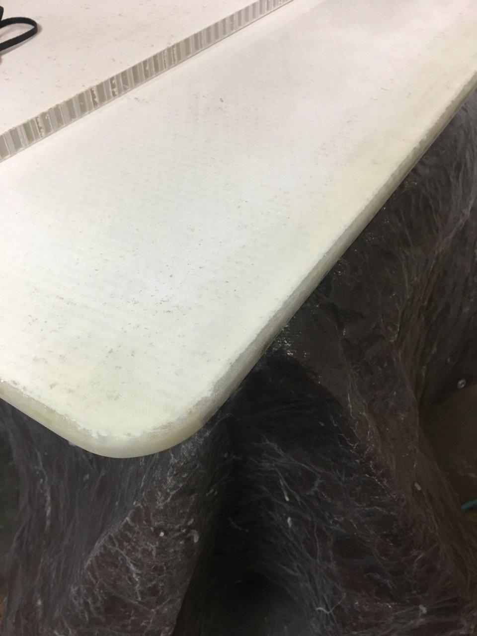

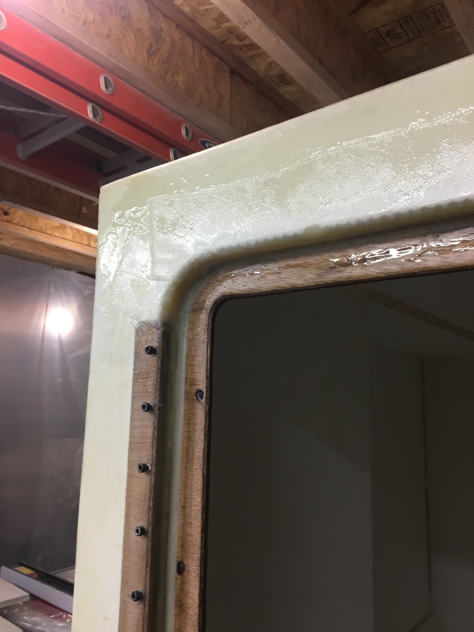

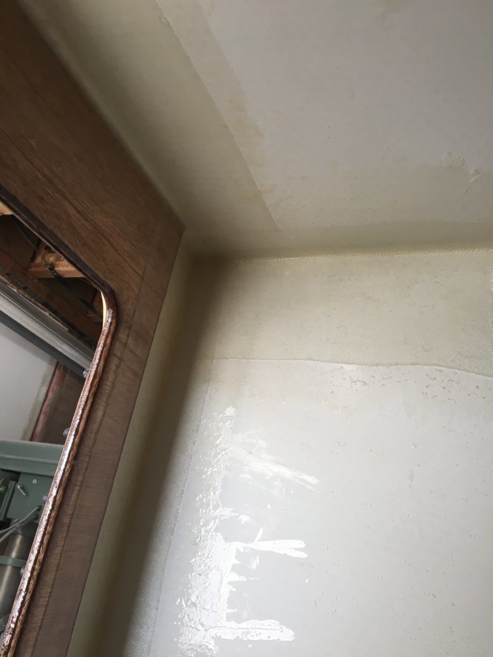

    I finished glassing the edges of the door opening with 6oz glass. Wanted to make sure the edges were protected from use.
    Another shot of that.
    Got the door edges all sanded up nice and smooth. Next step here is to work on the door handle mount and then using fairing compound to clean everything up for paint.

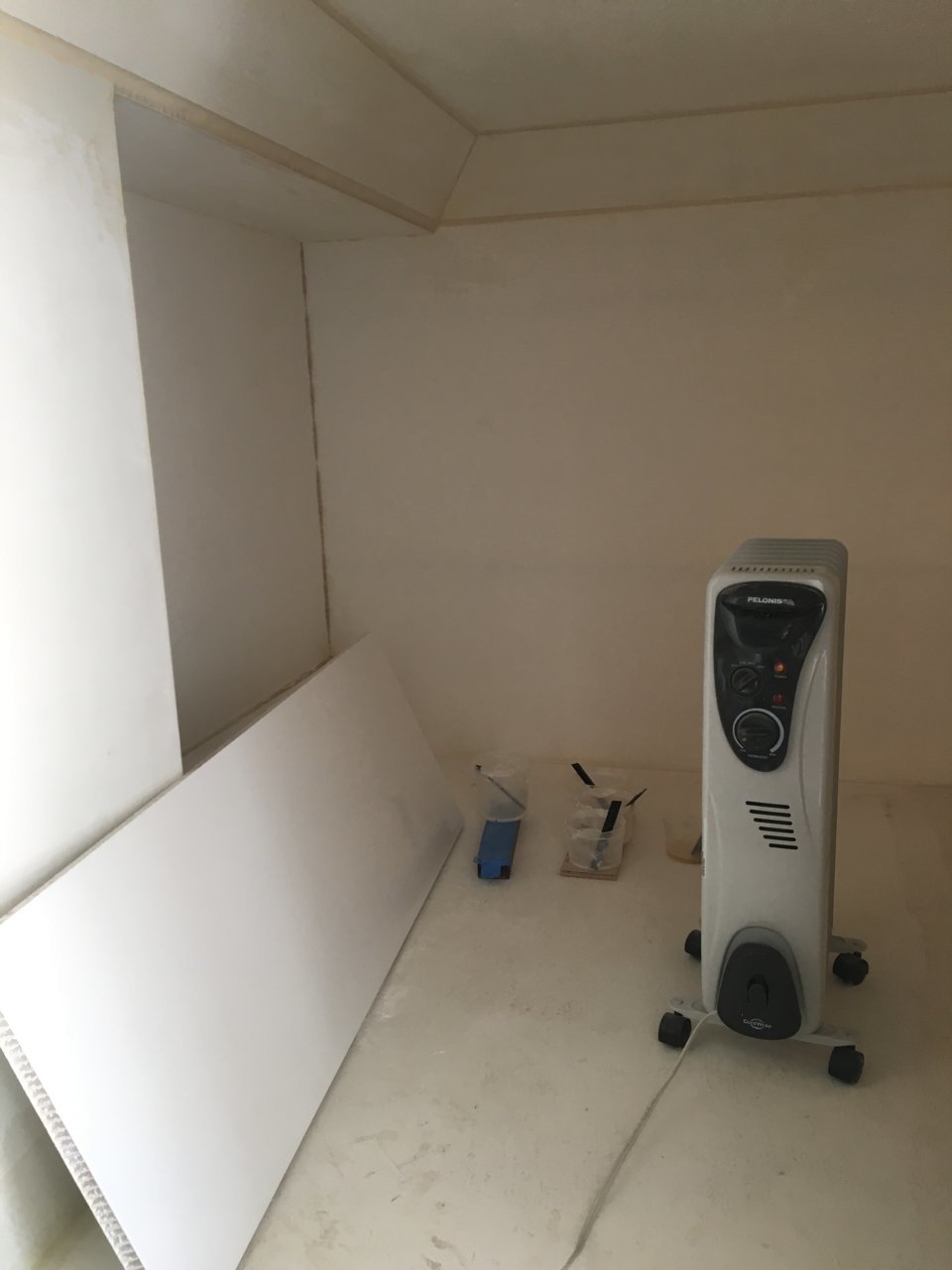

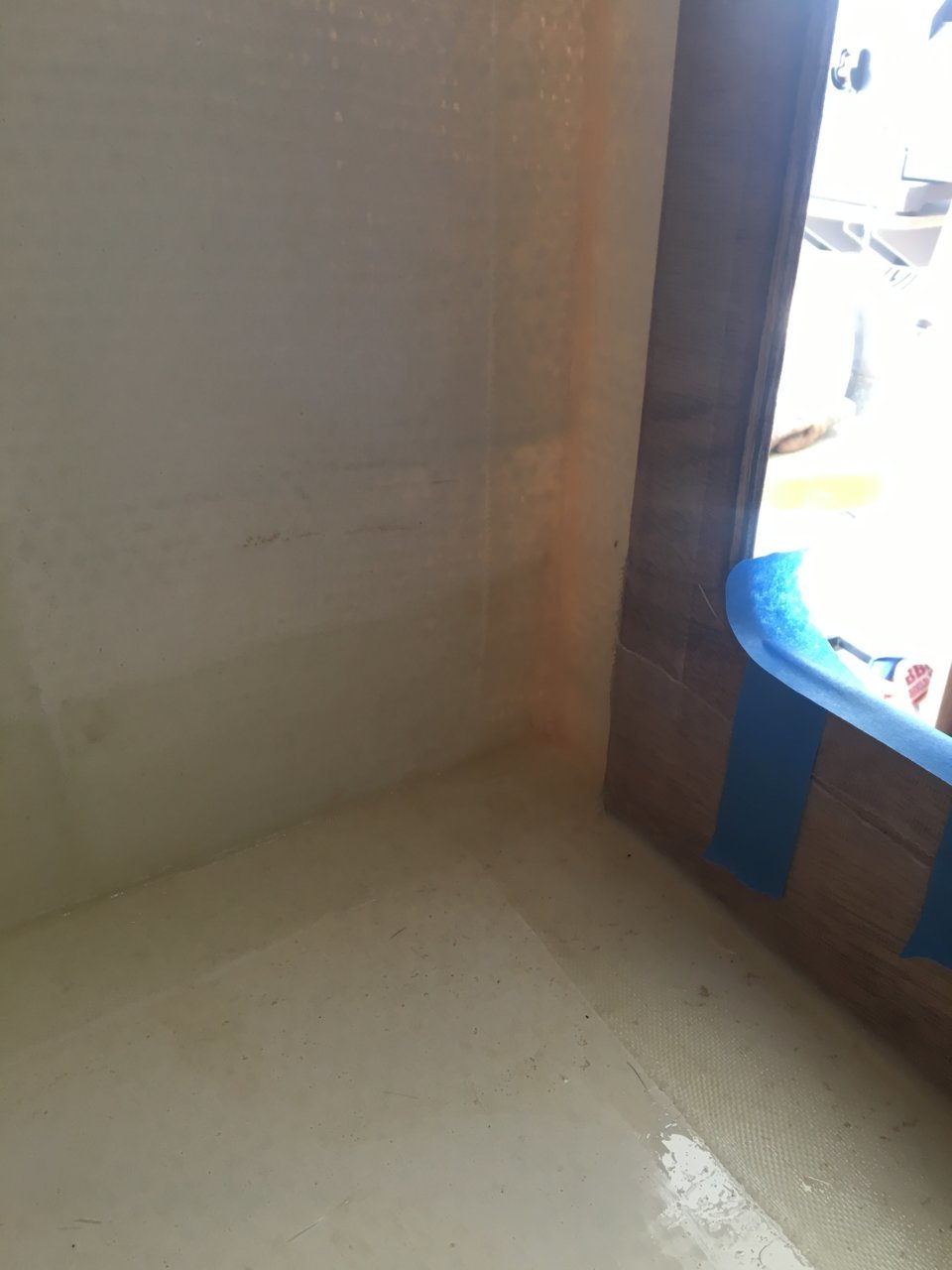

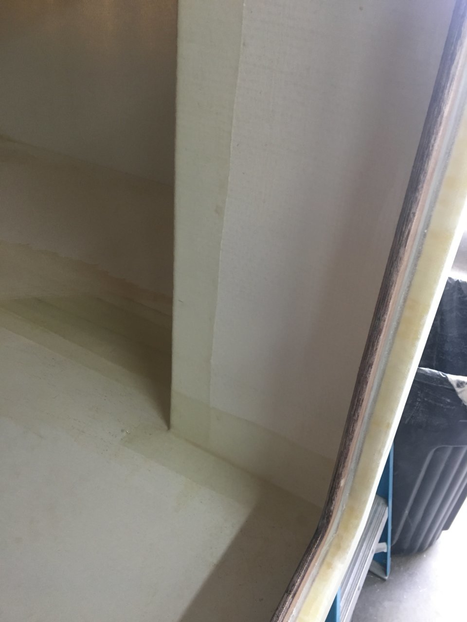

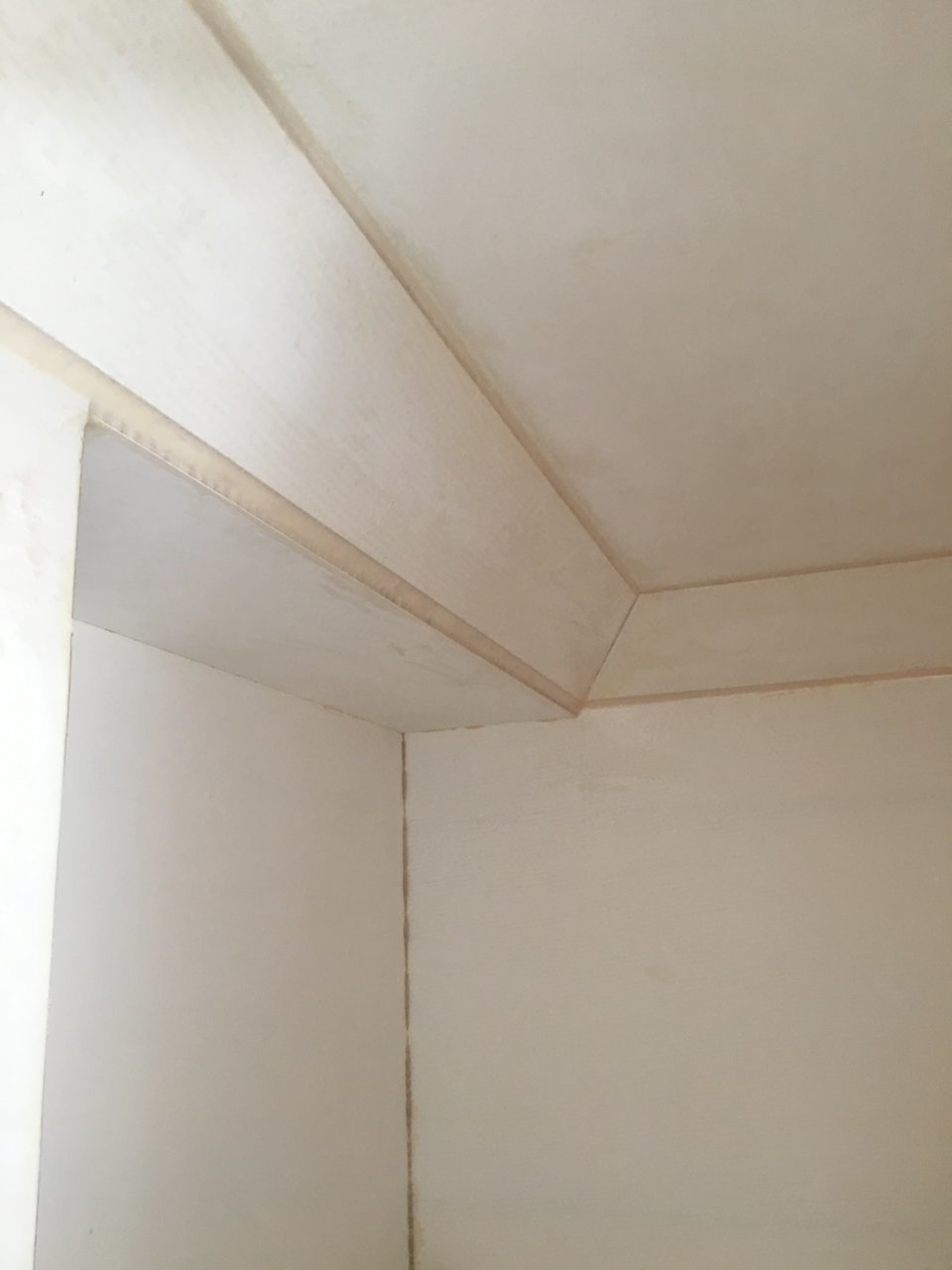

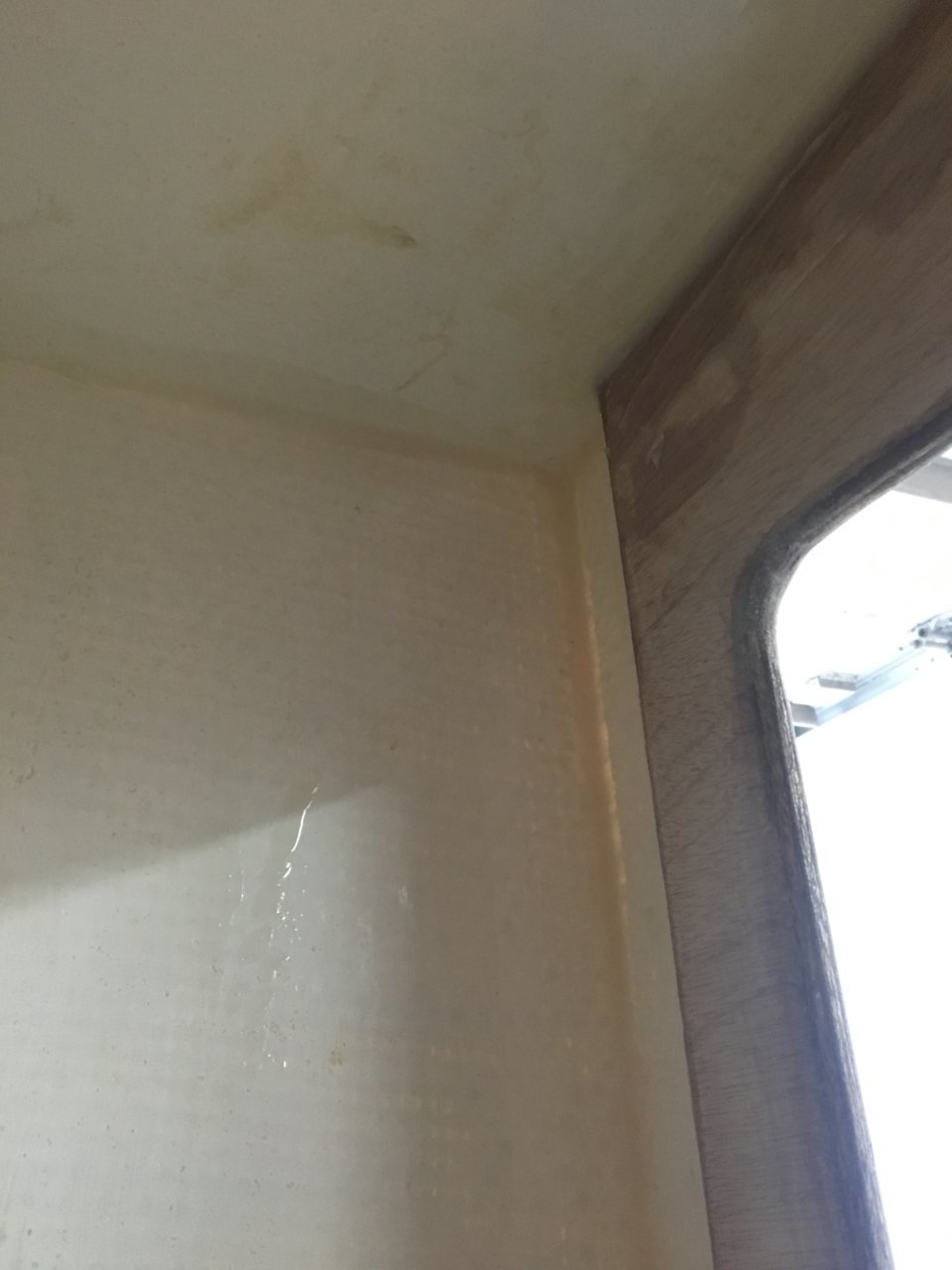

    Started laying fillets around the inside of the camper. Nice to be starting to work inside...feels like progress.
    Got some glass laid in on some seams too.
    This is where I left it. Ran out of epoxy or I would have done more glassing. I may be able to pick up more today. If not, definitely tomorrow. Usually West Marine has this stuff in stock so I shouldn’t have to wait. I think this next batch of epoxy will be the last if I play my cards right! I’m excited about that.

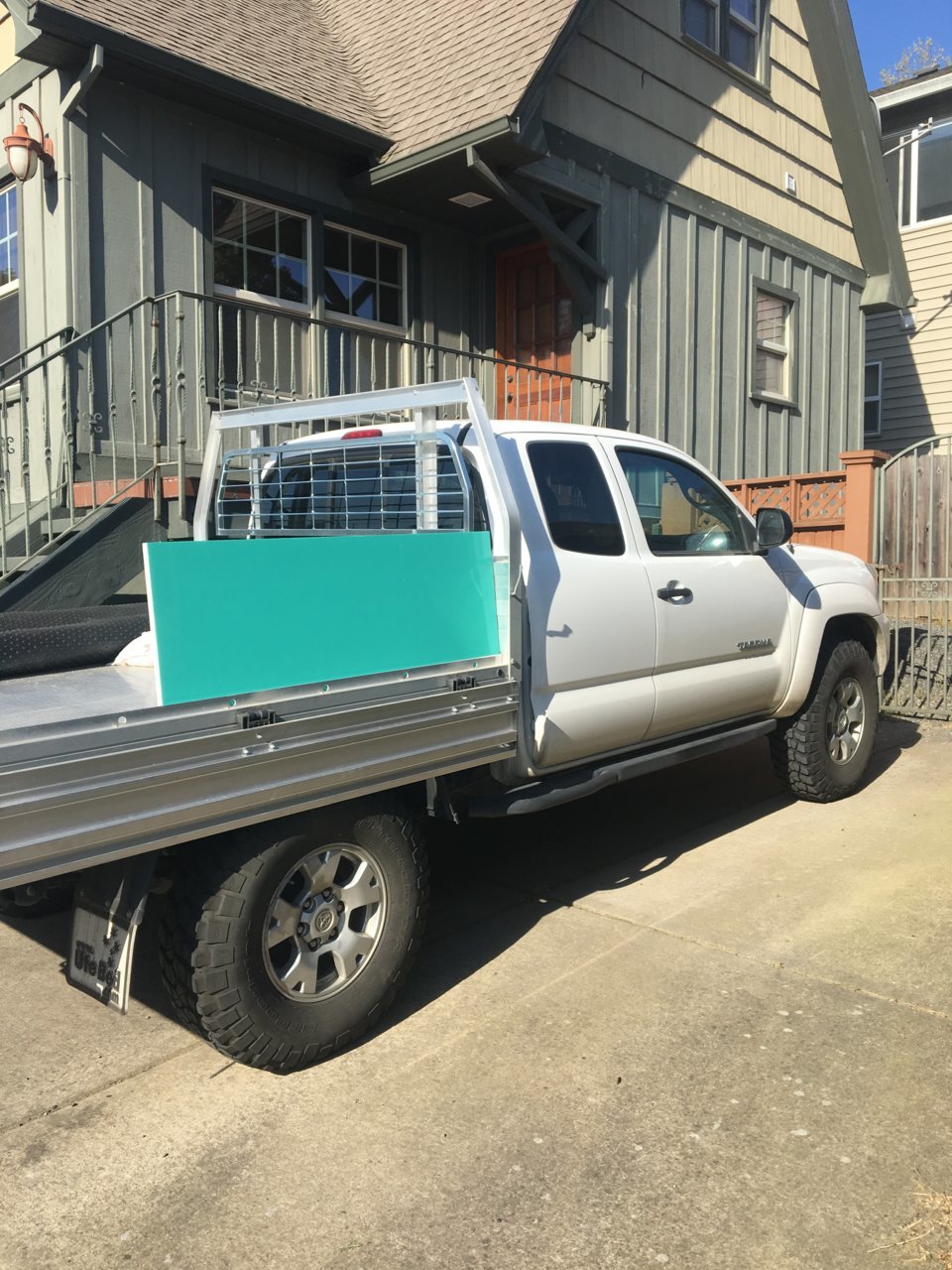

    Still waiting for reasonable enough weather to paint my test panel. And, still need to order windows! That’s killing me. I want to paint the test panel first so I KNOW how thick my finished walls will be. A +\- 1/16” tolerance is pretty tight. So I want to be sure. Maybe I’m overthinking it and should just give myself the panel thickness plus 1/32” for paint inside and out and call it good. Let the +\- 1/16” tolerance on the window take up the slack.

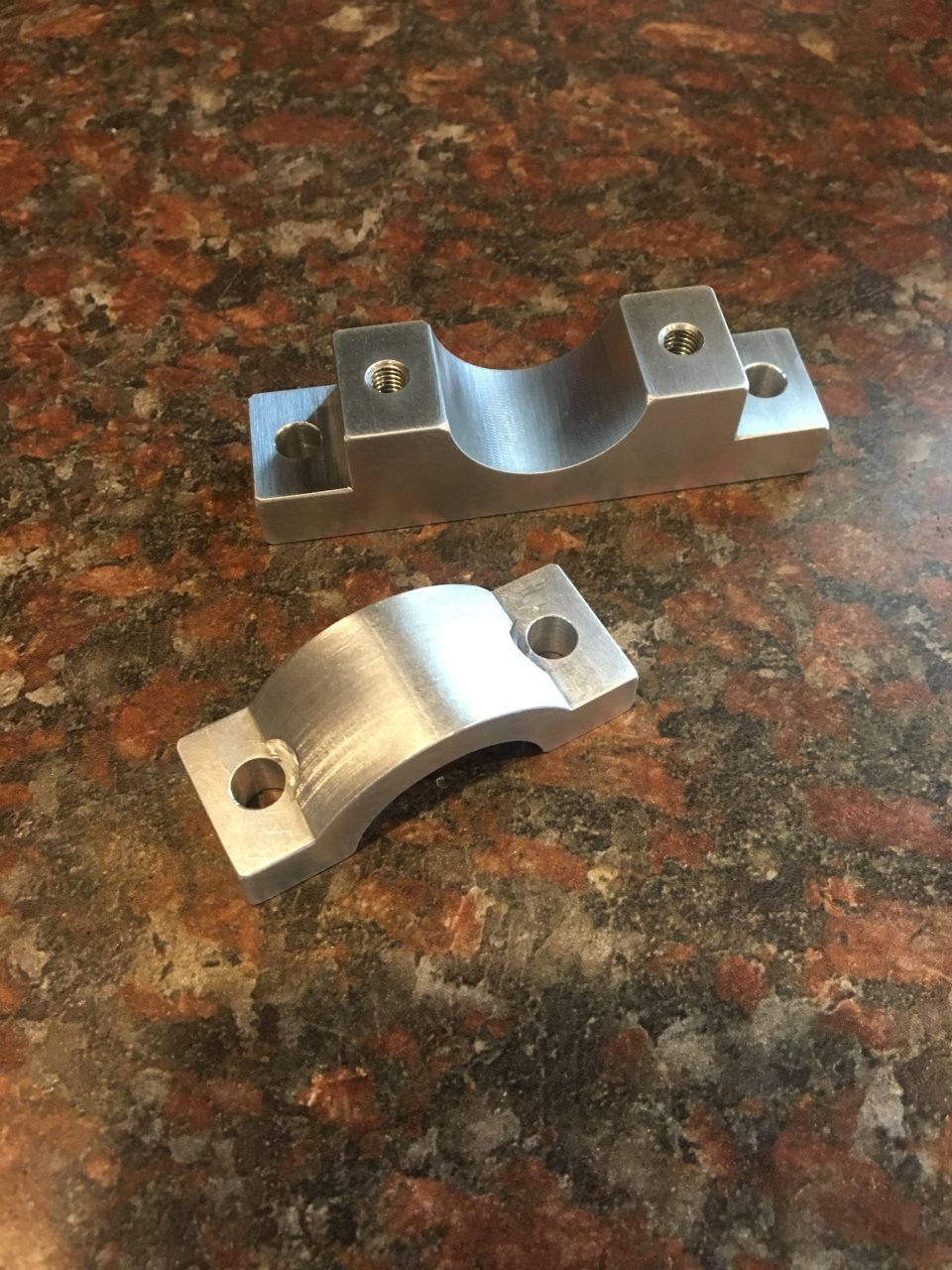

    The conduit clamp holding my fuel filler neck is working okay but it has a lot of flex. It will fatigue and break eventually. So, I designed a nice, stout aluminum clamp to replace it. I have a buddy that owns a machine shop so he cut me a bit of a break and machined these parts for me. When it stops raining, I’ll install this. I’ll have to slide the bed back again to drill the mounting holes so I’ll do a bunch of other stuff that needs doing at the same time: replace all the bumper hardware with stainless steel, try to figure out the overfill on my gas tank...again, mount my fuel filler brackets and maybe lay out where my camper mounts will go.

    Epoxy fillets...that you can’t really see...
    More epoxy fillets...that you can’t really see. I also fiberglass taped all of the seams around the entry door!
    I’m really happy with the progress today. If I had more epoxy cups, I would have done more but I’m happy with the solid forward steps today. I’m planning to spend a bit more time in there tomorrow. Hopefully, I can finish up all the interior seams in the next couple of days!

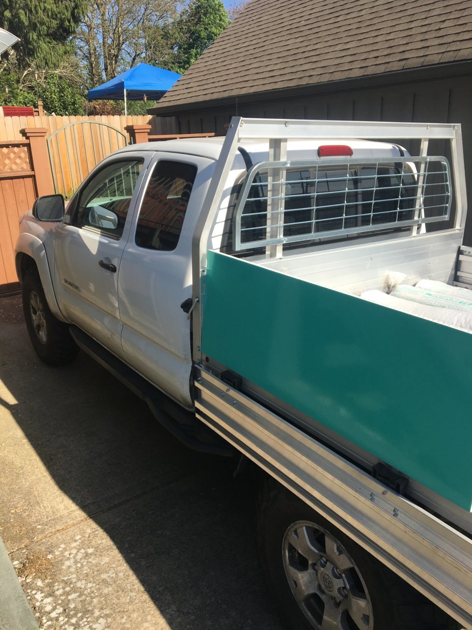

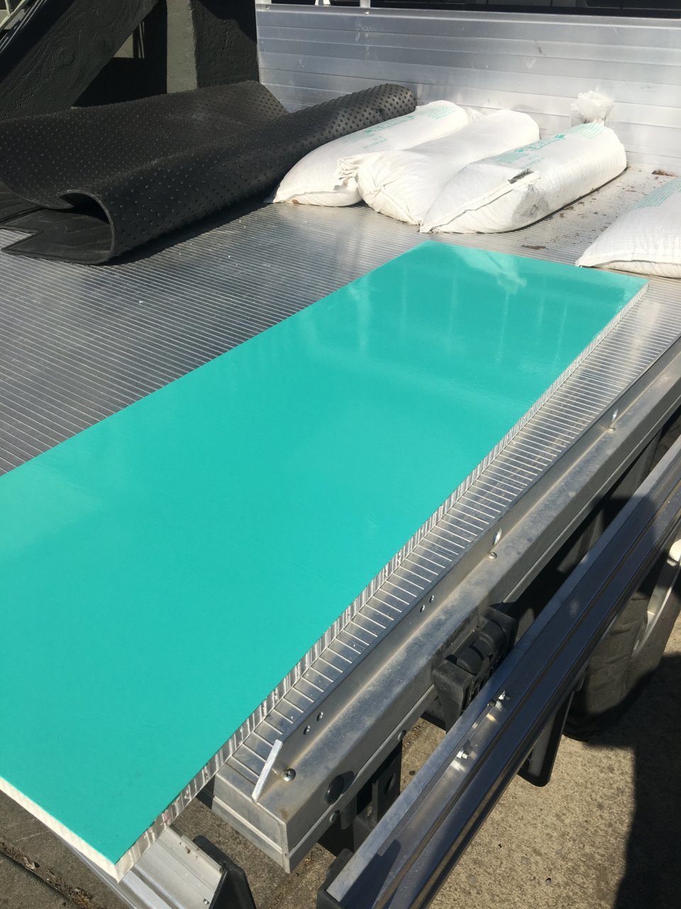

    Big update!
    Paint color chosen! My wife and I looked over a bunch of color chips and decided that this is the one we wanted to test first. Prepped and painted the panel the same way I intend to paint the camper. Learned a few things...like this will be a 50/50 paint job (looks good from 50 feet or at 50mph) and I don’t have the patience to make it much better than that. Haha. Though a 20/20 paint job may be possible.
    We wanted something bright that felt lighthearted and fun. This color with the bare aluminum boxes, black windows and bare aluminum L track is gonna be sweet. Plus, we’ll fit right in with the forestry and BLM rigs.
