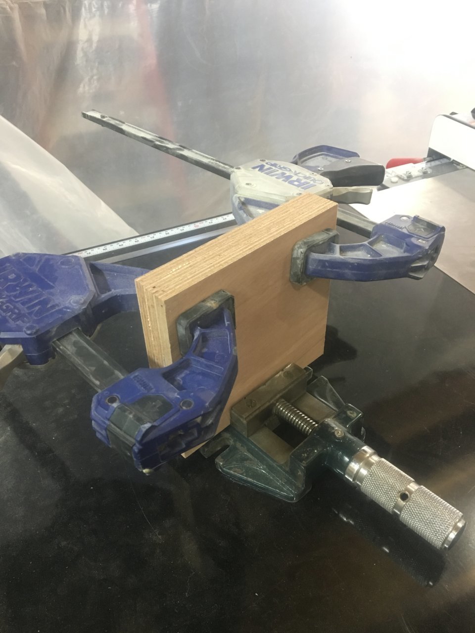

    Getting to work on the mock-up camper mount.
    Cut and glued some of my leftover 1/2” marine grade plywood. This is the base plate for the body mount. Due to the geometry under the bed and the flange that runs the length of the top of the bed (which I don’t want to cut off), the camper will sit up off the floor of the flatbed by a decent amount. No big deal, i’ll Cut down my Toyota bed mat to fit between these mounts and keep it under the camper. It’ll be handy for putting on the ground if it’s muddy or whatever. Lemons to lemonade, son!
    Ta-da! Done! :D

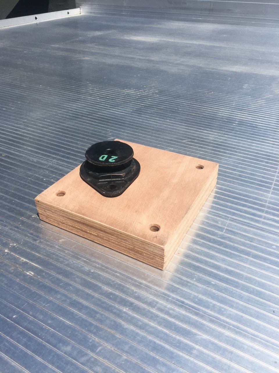

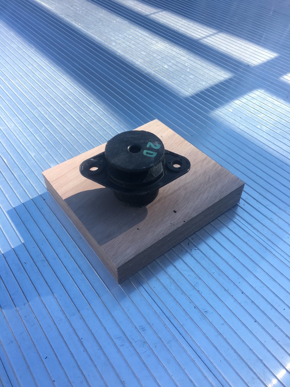

    Here’s the final idea.
    The plywood block is 1.375” thick. I need that height. The footprint is 7” x 7.5” I want the big footprint to spread the load out a bit. I’m not worried about the weight pushing down, I’m worried about pulling up on it. The bed is made of thin wall aluminum extrusions with a ton of ribs underneath. I need to sneak between all of the ribs. I figure I’ll either put big heavy washers under each corner bolt under the bed or put a 1/4” thick strip of aluminum that bridges the front bolts and another to bridge the rear bolts. That should give me plenty of strength and avoid the need for a complicated bracket underneath.
    The big wood block will be machines out of aluminum. I’ll be carrying extra weight with a block that big but it’ll be negligible. Plus, pocketing it out will get expensive with machine time in a hurry. I’m going to take the weight penalty instead of the money penalty. I could potentially just use half of this mount: the body mount then just the bolt in front of and behind. With all four mounts tied together with a camper, it should be pretty solid. I’ll talk it over with my dad. He’s got a good sense for these things.

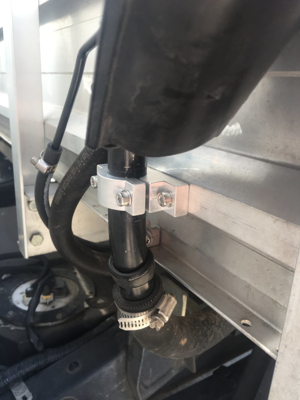

    Got some camper-adjacent work done today. Something that’s been sitting, ready for install for months!
    Finally replaced the flimsy P clamp that was holding my fuel filler with this lovely machined aluminum piece. Fit perfectly...because I’m totally awesome. :cool: :rofl:
    On a side note: I’m about ready to throw this LRA gas tank in the freakin’ trash. I CANNOT get it to stop overfilling. I have more theories but how much more effort do I dump into it before I just put back in my factory tank? I think maybe it needs better/more venting. And more vending in a different place than where they currently vent it. But, doing that pretty much means draining and pulling the tank. :censored: Why is this so hard!? It’s a very simple system. Put fluid in, vent air out.
