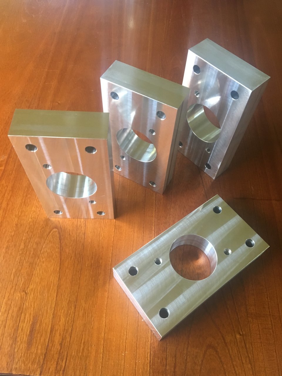

    No worries, I think the Alum spacers will be more than durable enough.

    Those look beefy as hell. Doubt you will have anything to worry about :thumbsup:

    The bed will rip apart before these fail, I think.

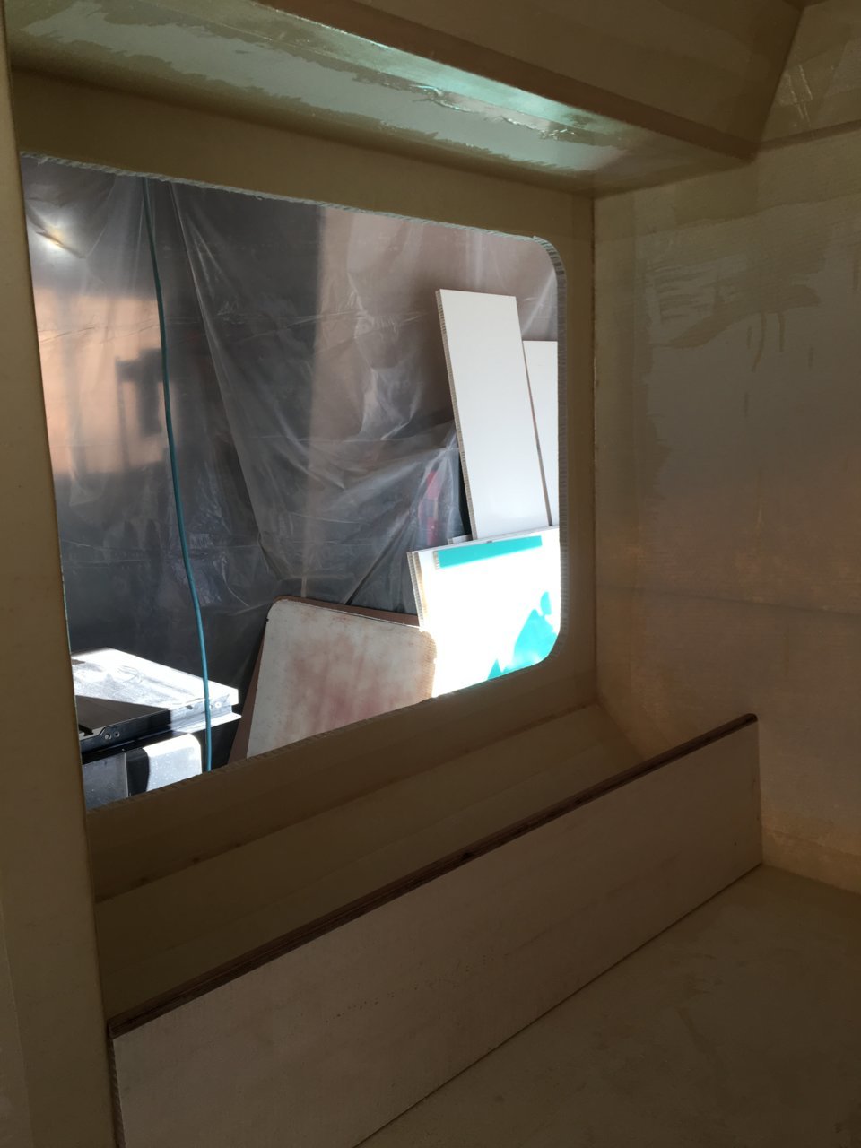

    Getting bits of work on the camper done...little itty bits.
    Started laying out the back window cut. No matter how many times I measure, level, square corners, cross measure...it still doesn’t add up! I’m going to have to come back to this fresh.

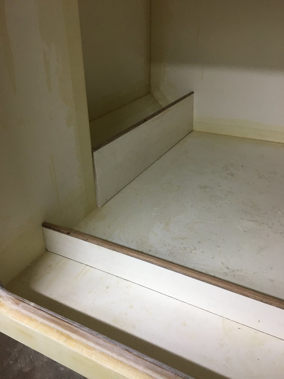

    Also cleaning up the interior stub walls for install.

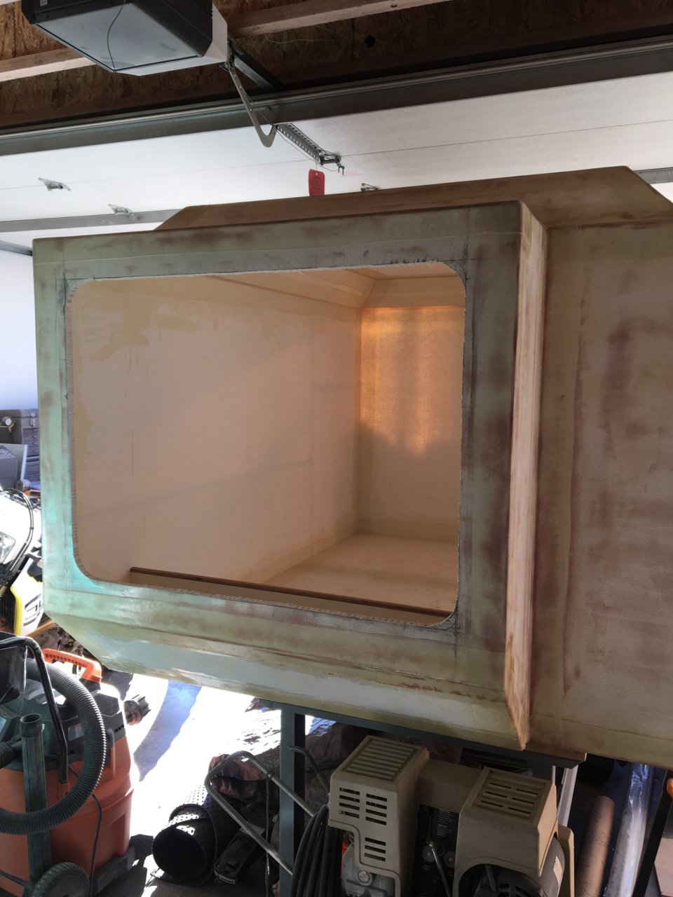

    Well, I gathered up what was left of my pride after not being able to make a simple rectangle and I came back stronger than ever! I think...
    I got that window hole cut! Who knows if the window actually fits in there but I’ll wait to try until the camper is finished and on the truck to find out. :rolleyes: No, no. I’ll smooth out the opening then test fit the window.
    I think that huge window in the back is going to be sweet!

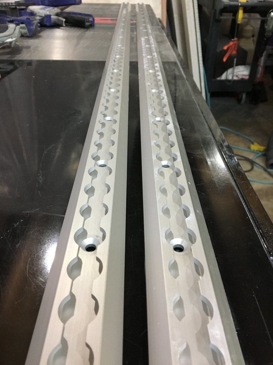

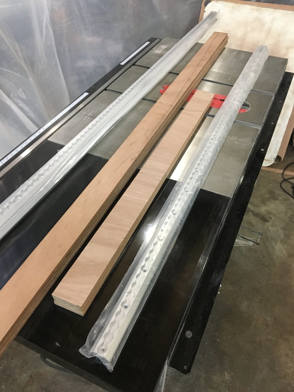

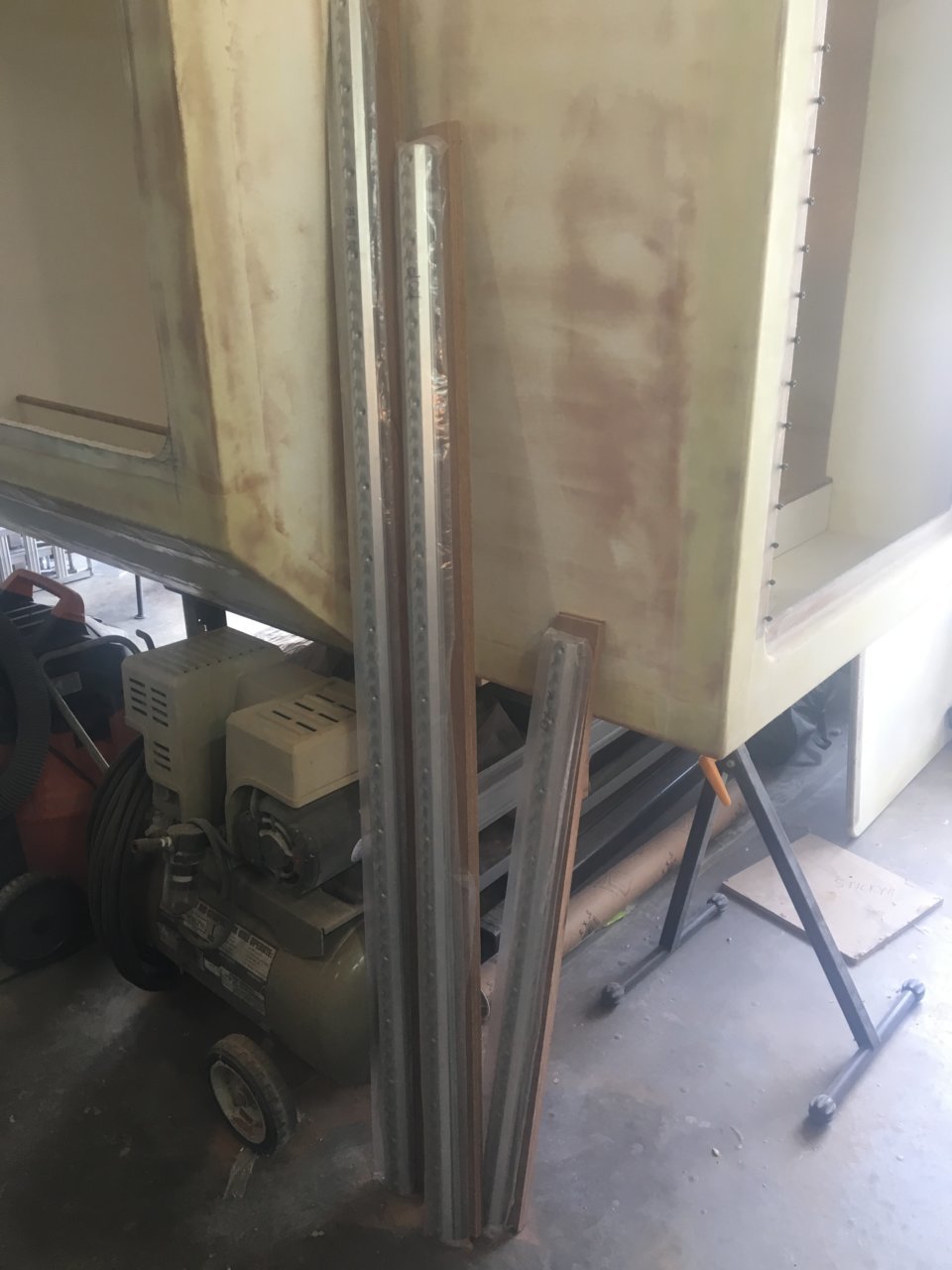

    A bit more work done today.
    Cut all of the mounting strips of plywood and two of the L track lengths for the camper. Stainless T nuts will go in the back of the plywood then it’ll all be epoxy sealed and glassed onto the side/back/top of the camper. L track will bolt to that. Four more lengths of L track need to be cut.
    Mmmmmm...L track
    I have all of the 1/4-20 316 stainless t nuts already so I can just carry on as I feel motivated to do so.

    Finished cutting the L track and plywood backers for the track today. Two for the side, two for the top and two for the back.
    Slowly making progress. Then I went and rode my dirtbike. :D
