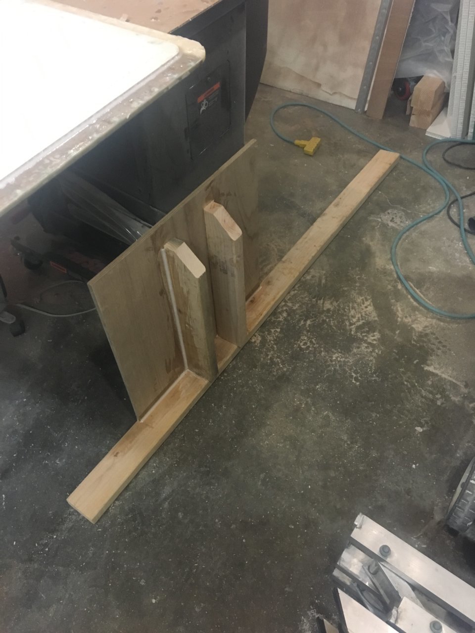

    Finished up the fillets around the back of the door tonight. Lots of sanding to do before glassing this all in. I did order a ton of 6” wide 6oz glass tape today. Should be here next week. That will help get a lot of things wrapped up.
    Also threw together this super quick and dirty wheel chock for my dirtbike in the flatbed. The long 2x4 spans between the side rails in the flat bed and the wheel rolls in between the other 2x4s. It’s sitting on its back in this shot. The plywood square will rest on the floor of the flatbed. It’s going to be interesting loading the bike up that high. It may be steep enough that I have to start the bike and idle it up there. This is all temporary until I can get my rear bumper reinforced. I’ve been bumper hauling my bike but it’s tweaking the bumper mounts. I have a plan to beef it up but it’ll take some time and I want to ride now! Once the camper is on the truck, I’ll have to have a trailer. It’s never ending.

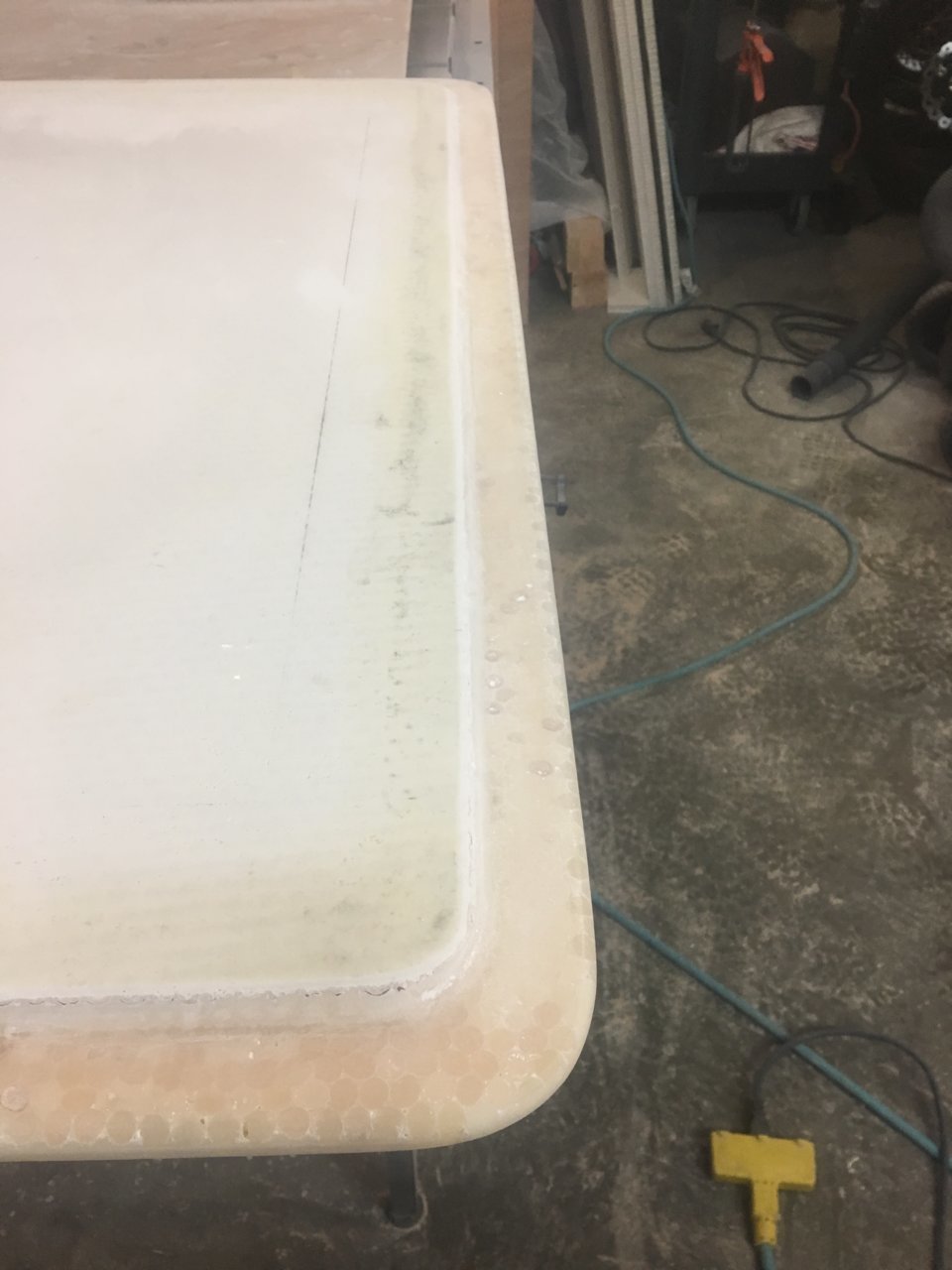

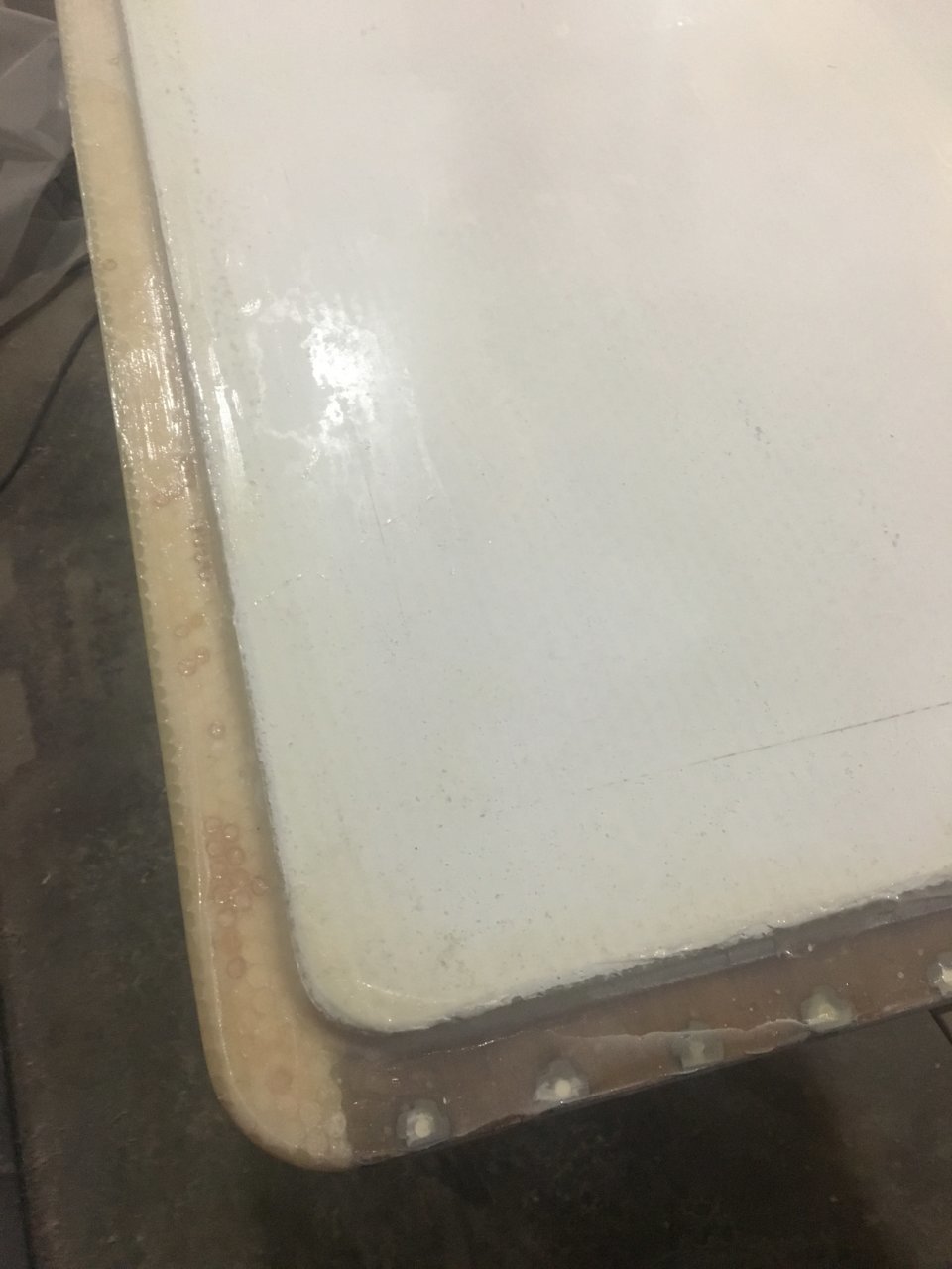

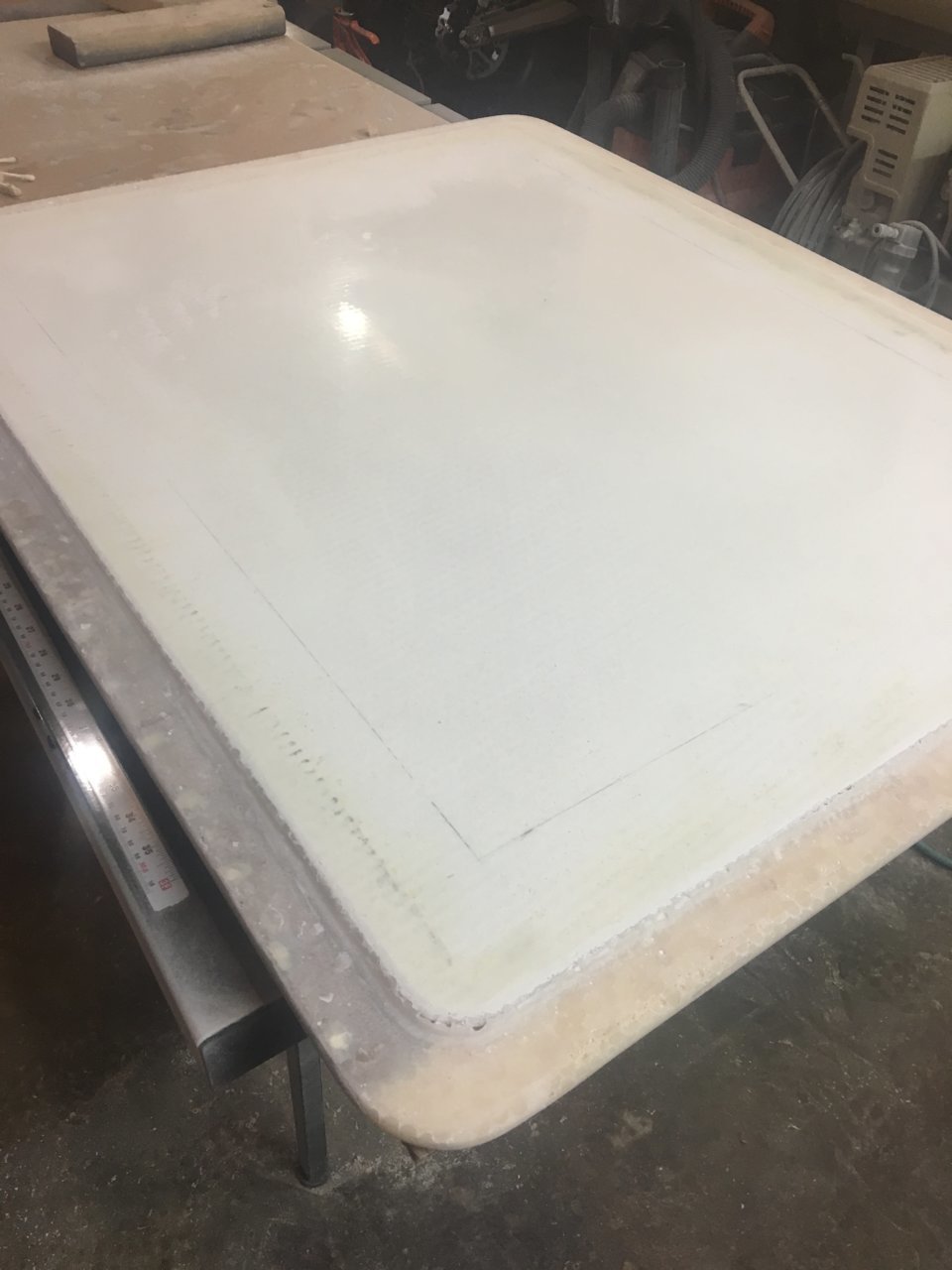

    It was a decent sanding evening.
    Sanded the door! It’s ready for glass. That should be the last edge reinforcement that’s needed. Then I can get to the handle/latch.
    Not that you can tell here...but I also sanded all around the stub walls inside. And some other sanding cuz I was in there.

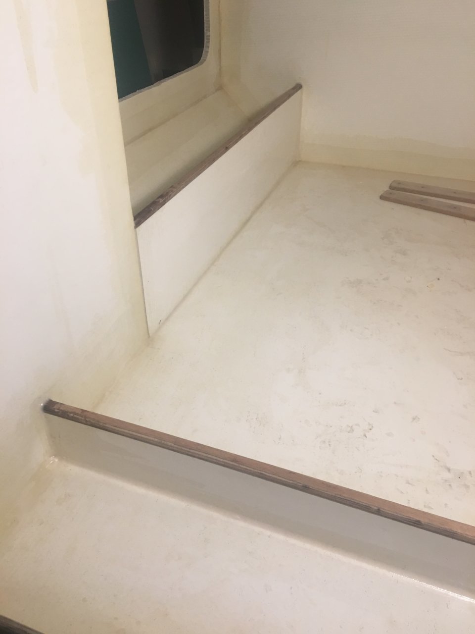

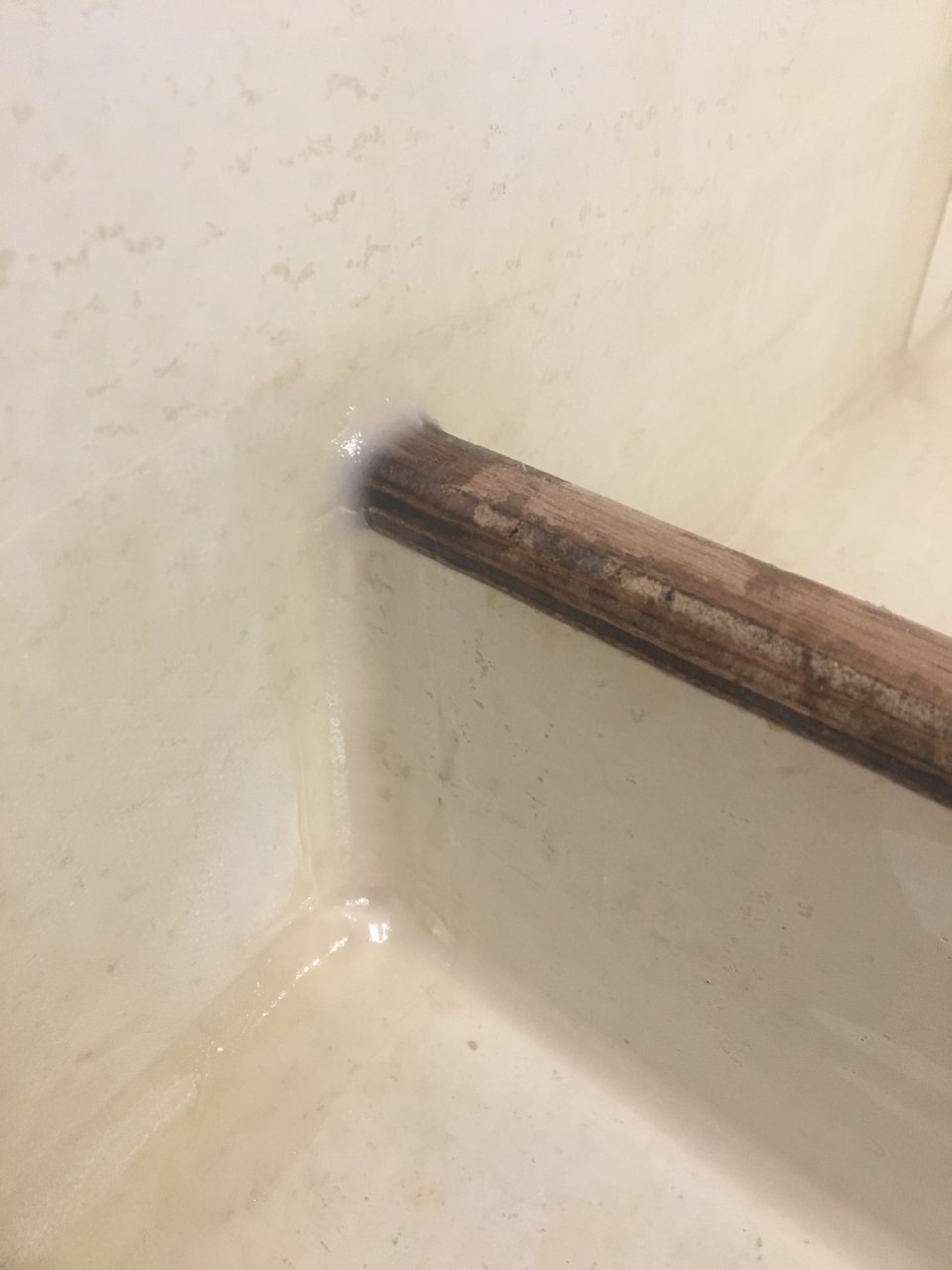

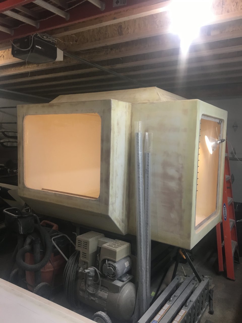

    Finished the epoxy fillets on the interior stub walls tonight. They’ll be ready to sand and glass over tomorrow night!
    Did some more work on the door in preparation for glassing these new edges.

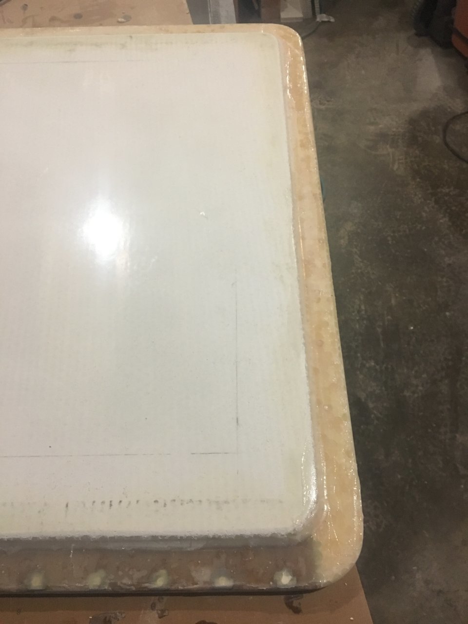

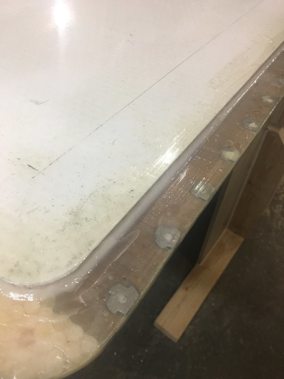

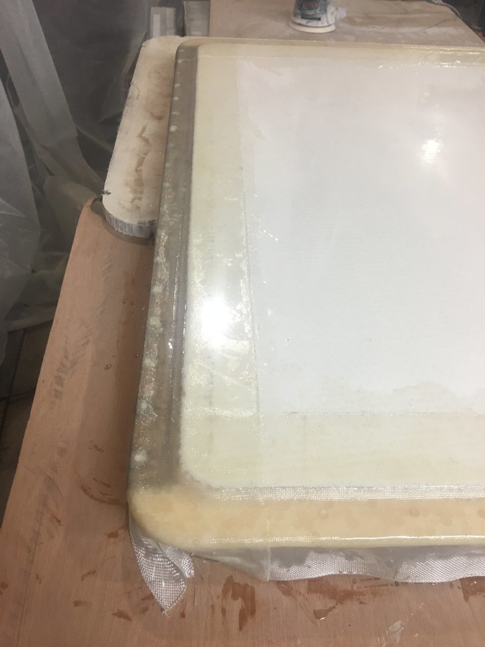

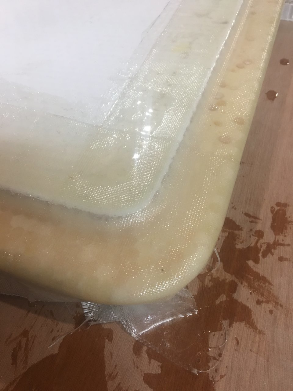

    Glasses the recessed lip on the back of the door. Felt good to get that done tonight.
