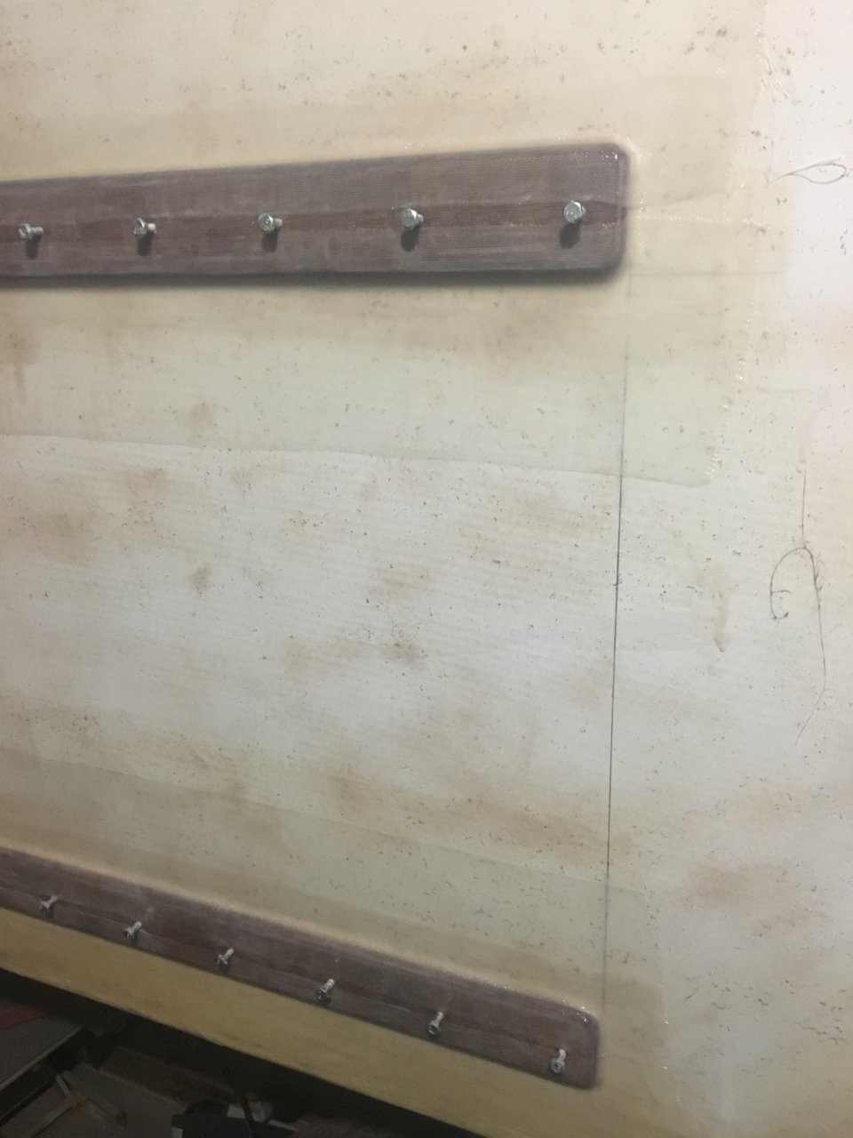

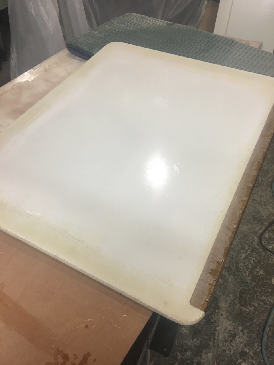

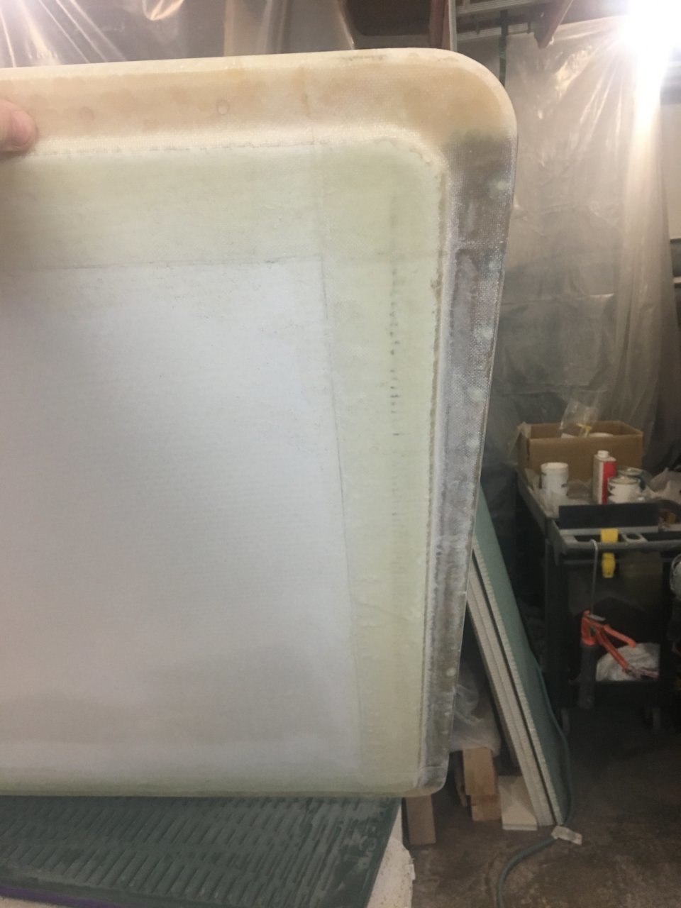

    Got the door trimmed and sanded. A little touch up work then some fairing. Then I’ll mount it with the hinge and start figuring out the handle. Can’t wait to get that done. That’s a huge block for me right now. Nice to be making solid progress.

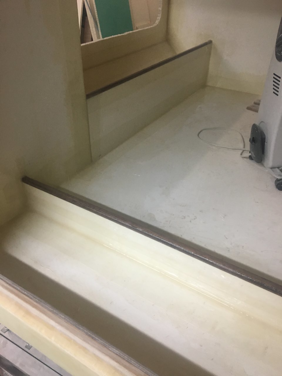

    Glassed in the stub walls too! The glass and resin is a little sloppy in some places but it should hold fine. It was just kind of hard to work in some of these spots from outside the camper. We’ll see tomorrow. It’s easy enough to glass over any area that may be really terrible. That’s why fiberglass is cool! I’m not building the space shuttle here so perfection in all areas is not critical. Thank god!

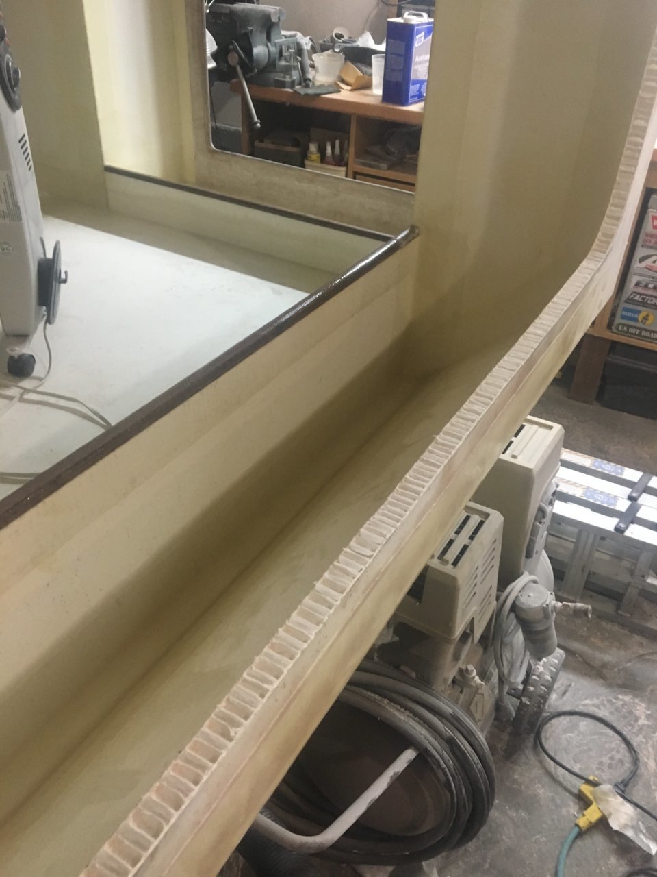

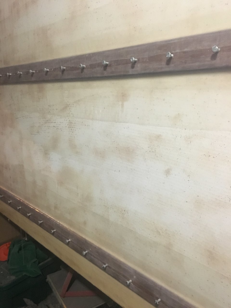

    Glassed over the side rails. One 6” wide 6oz strip of glass over the whole thing then one offset to each side. Want to make sure these are stout.
    I also sanded up a bunch of the new interior glass edges. Overall, a good day.

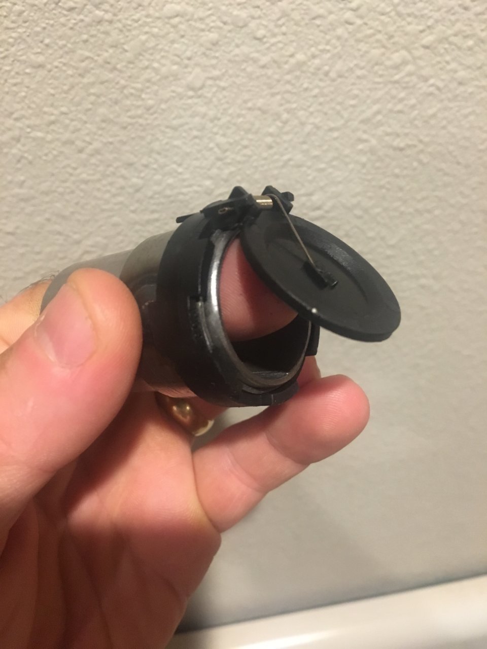

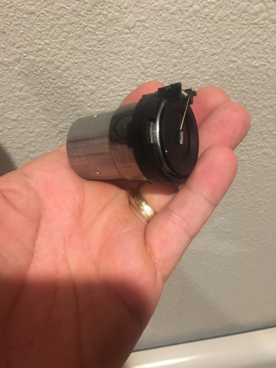

    Not camper related but I’m excited none the less! I got the new backflow valve design from LRA for my gas tank. You all know that overfilling/backflow has been a huge issue for me since I got this tank. Well, LRA has been getting a lot of blowback and engineered a solution specifically because of the issues with the Tacoma’s. Apparently our tanks are the only ones with consistent issues. Weird. Anyway, I can’t wait to install and try it out. Fingers crossed it works.
    Install is definitely more involved than one would prefer but if it works, I’m all for it. If you have a stock bed on your truck, you will have to remove it. I’ll have to slide my flatbed back A foot or two to have good access to everything. This little doohickey is press fit into the fill tube on the tank...from the inside.

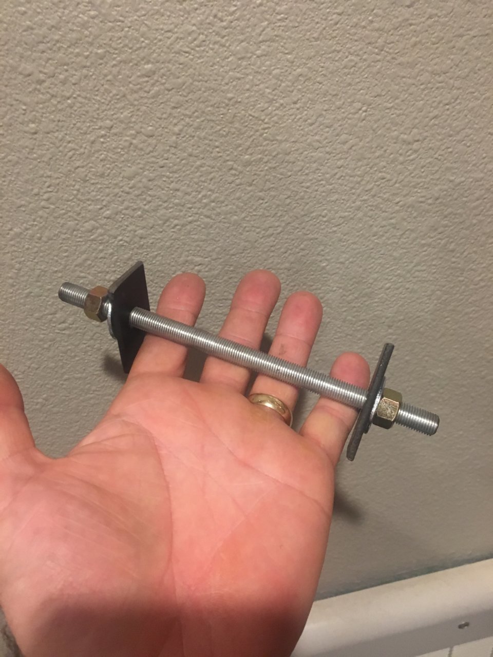

    Here’s the install tool. Simple. This is designed to pull the doohickey valve up into the bottom of the fill tube. My understand from talking with Cruiser Brothers is that the press fit is very tight and secure and that this tool works well.
    I’ve been working long hours the last few days so that I can take, potentially, Thursday off to go riding but I may tackle this install first and see if I have time to ride after. If I don’t get it done this week, it’ll have to wait until next week. This weekend is not an option. Now, I just need to get my tank as close to empty as possible without running out of gas. Haha. I’m not excited to work inside a metal box with several gallons of gas in it. Would hate to make a spark somehow! There is a drain for the tank but it’s never 100% and the fumes are present.

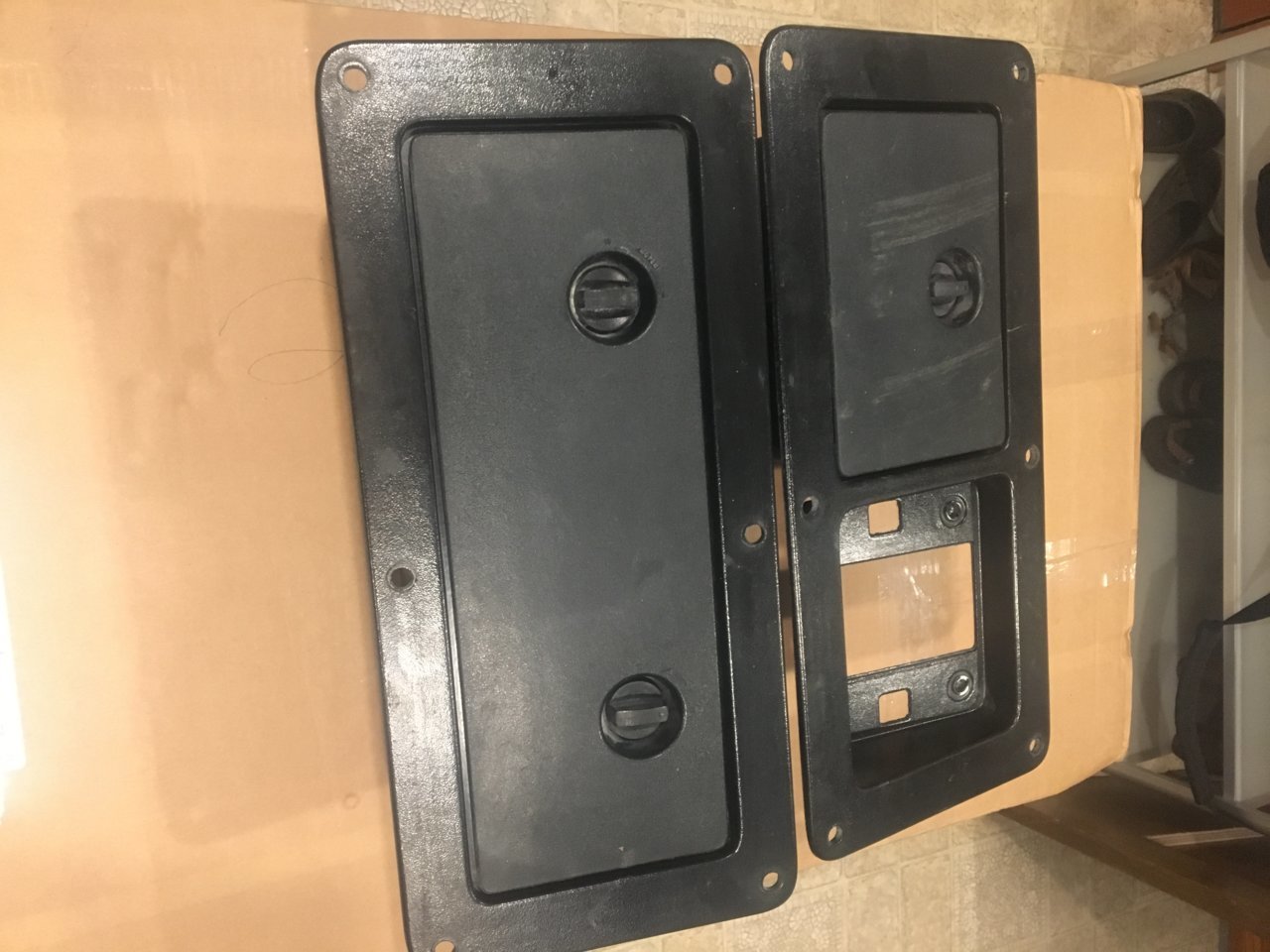

    During my garage clean/purge project this week, I came across these bedside cubbies from my truck. I remember talking to someone about these (they wanted them) but I can’t remember who that was and I don’t see a PM in my history about it. If you’re that person, PM me and our deal still stands. If anyone else wants these, please PM me. Thanks!
    I’ll also have my original gas tank up for grabs soon as well if my new overfill valve still proved to be awesome!
