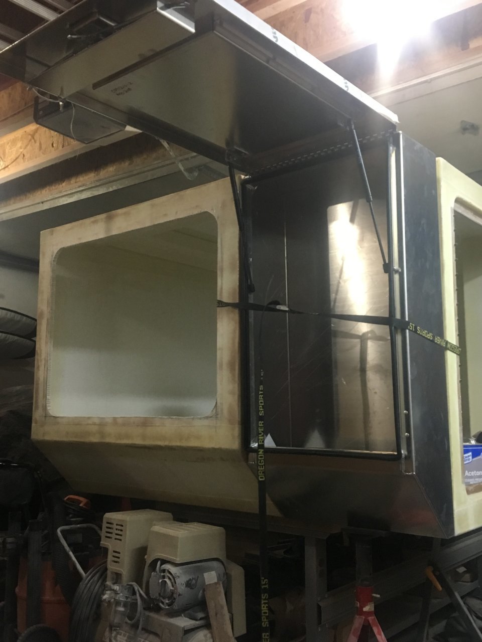

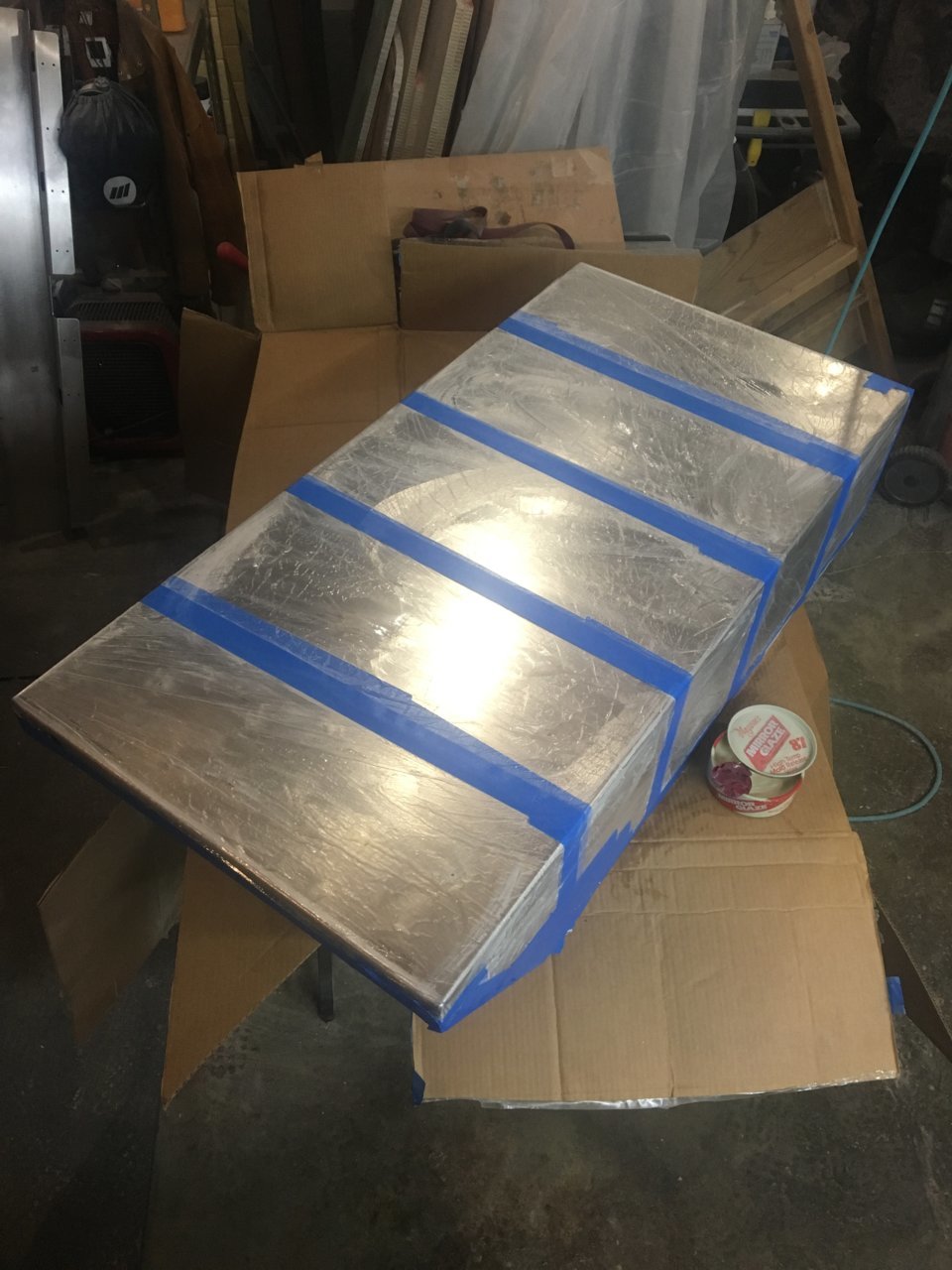

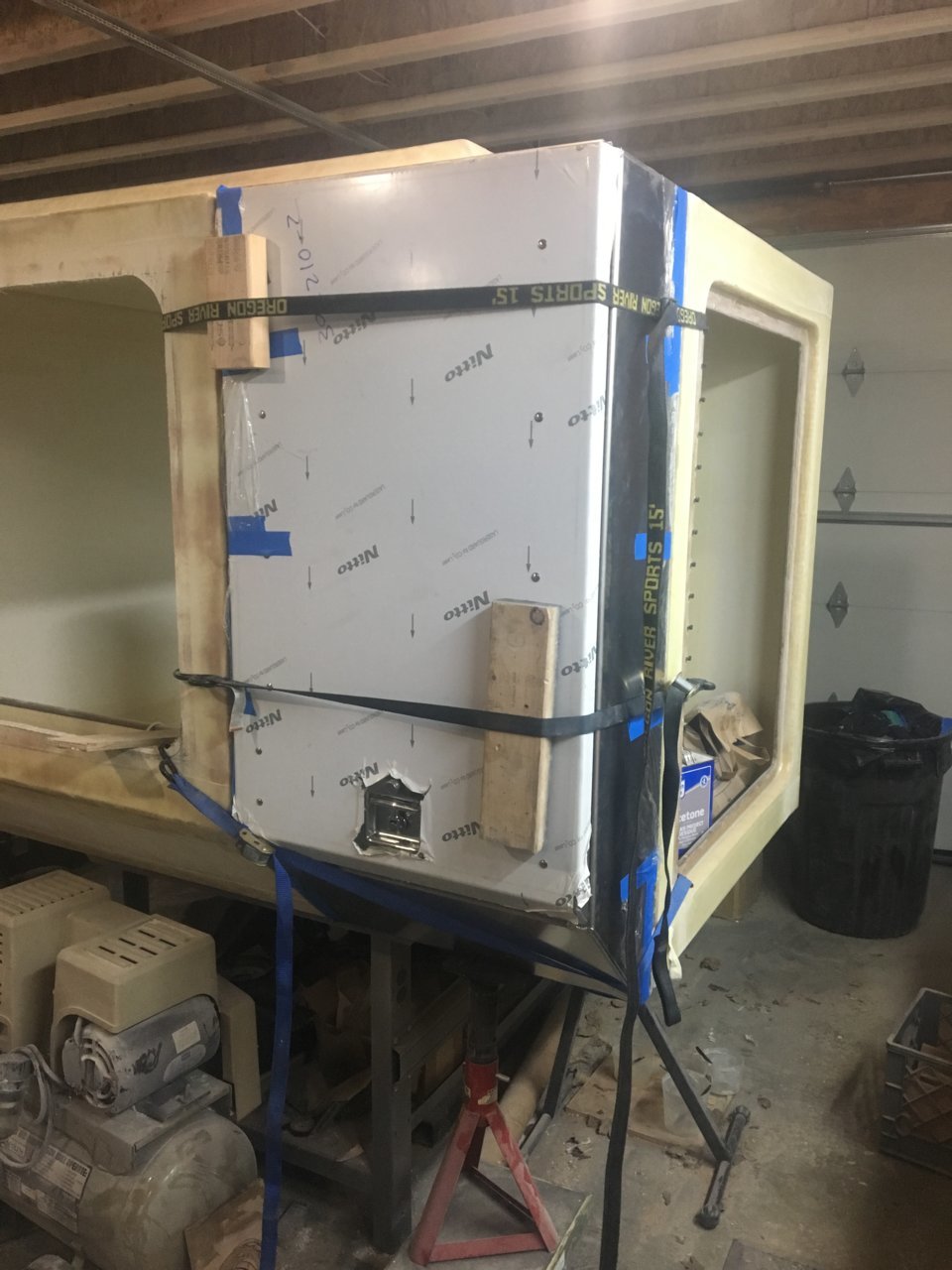

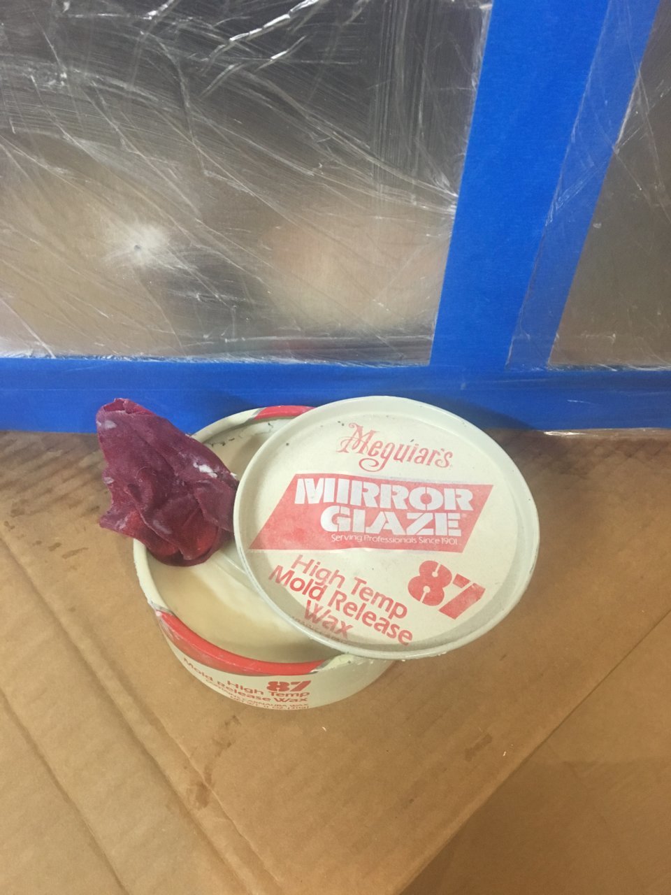

    Tonight was all about getting the rear aluminum box ‘bed’ to the camper. The camper walls are not square...let’s just accept that. :thumbsup: So, there are gaps in various places between the box and the camper. Those need to be filled. I decided that I would fill that space with too much thickened epoxy and squish the box into it thereby forming a perfect mounting surface. I did this by wrapping the box in plastic wrap which I then coated with mold release wax. Then I put a giant glop of thickened epoxy over each hole location for mounting the box. Then squished her into place and strapped her solid to cure. Hopefully this actually works! I’m actually a little skeptical if we’re being honest. The theory is sound but my execution is completely unproven. I’ll know tomorrow!
    Here’s the same mold wax tin that I’ve had for over a decade.
    Here are the epoxy exposed surfaces of the box coated in plastic wrap, edge sealed with my favorite blue tape then liberally waxed.
    And here’s the box strapped in place for the big cure! The 2x4s are there to help apply force in the areas that I needed to seat the box just how I wanted it. I’ll double check the straps later this evening to make sure they’re tight then let it cure over night. I’m excited to see how this works. It was actually pretty easy. If it doesn’t work, it’s going to be an unholy mess to clean up. :welder::sawzall::stirthepot::laser::frusty: That’s my general concept of what cleaning that mess up would be like communicated completely by emoji.

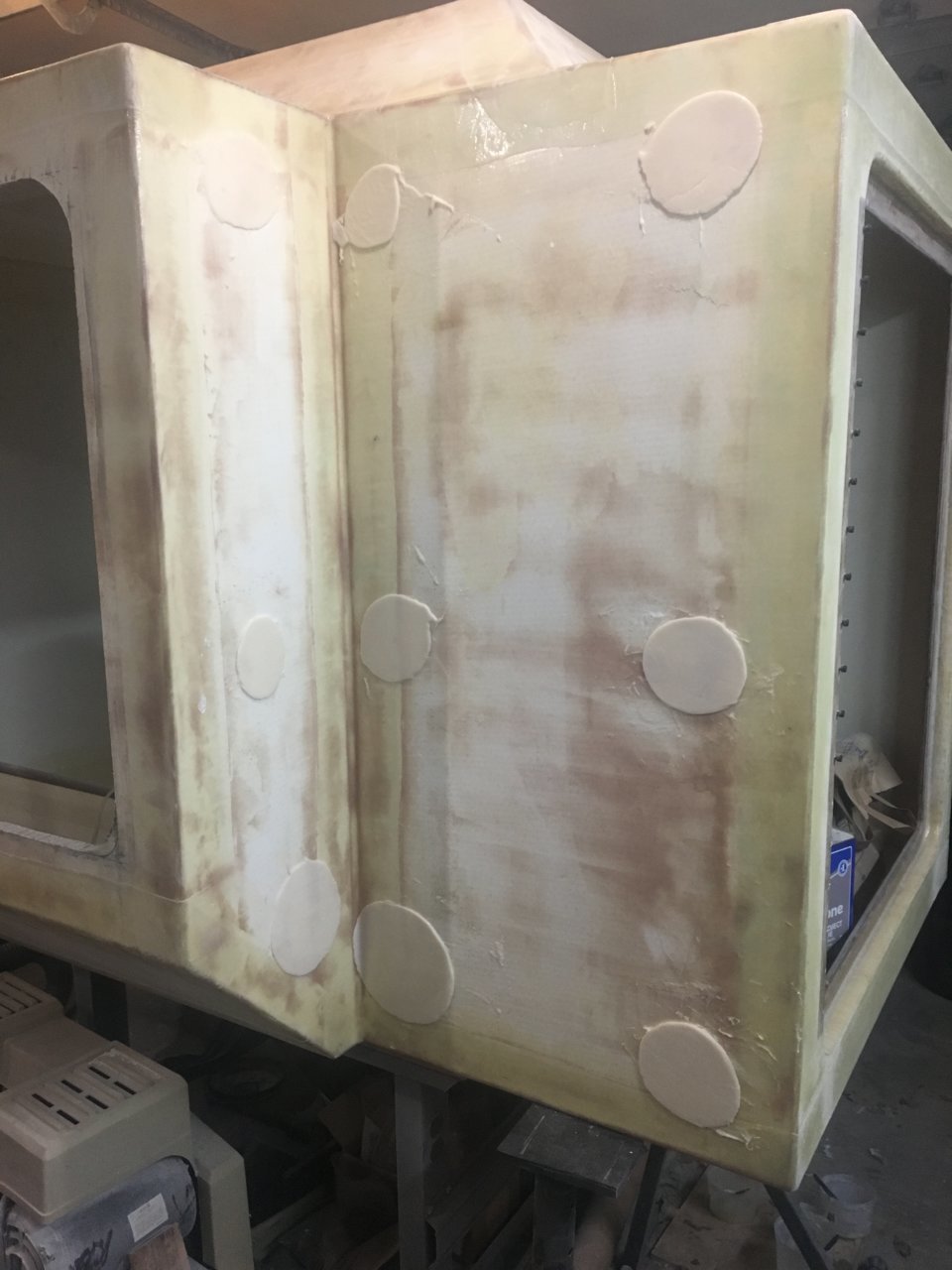

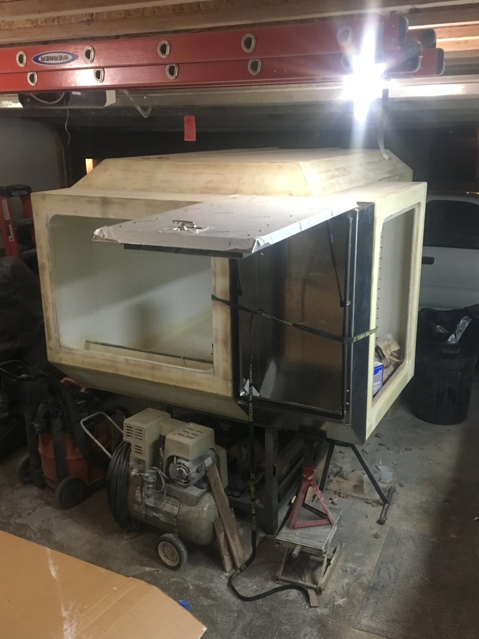

    Pulled the box off tonight. The epoxy blobs worked great! Not perfect but, honestly, better than I though. I’m pumped!
    F19B95E2-B7DB-4D75-BC86-F864B746FC78.jpg 4303C83F-10ED-462E-A835-574EF1B2BB56.jpg

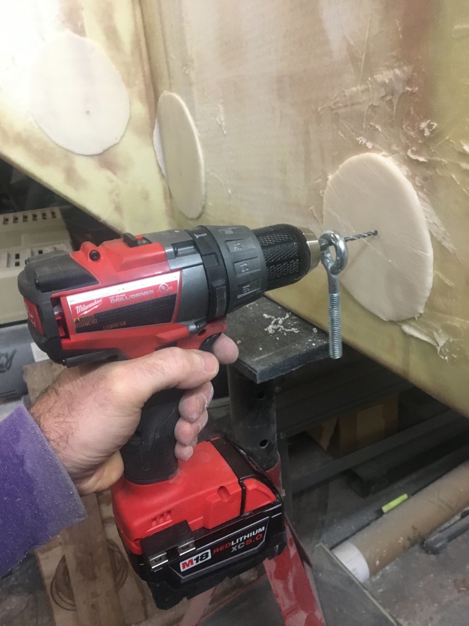

    Put the box back in place once I removed all the plastic wrap and tape. It’s gonna be so frickin sweet! I did this to mark the holes to drill. Used a pencil trough the holes I already drilled in the box a few steps ago.
    This is a good trick for drilling holes in a vertical surface: put an eye bolt over the drill bit...as you drive the drill motor, the eye bolt will walk back and forth giving you a good idea of up/dn angle then all you have to do is watch the left/right. Works really well but be sure to keep your eye bolt off of the chuck and the cutting area of the bit. It needs to ride on the smooth part of the bit.

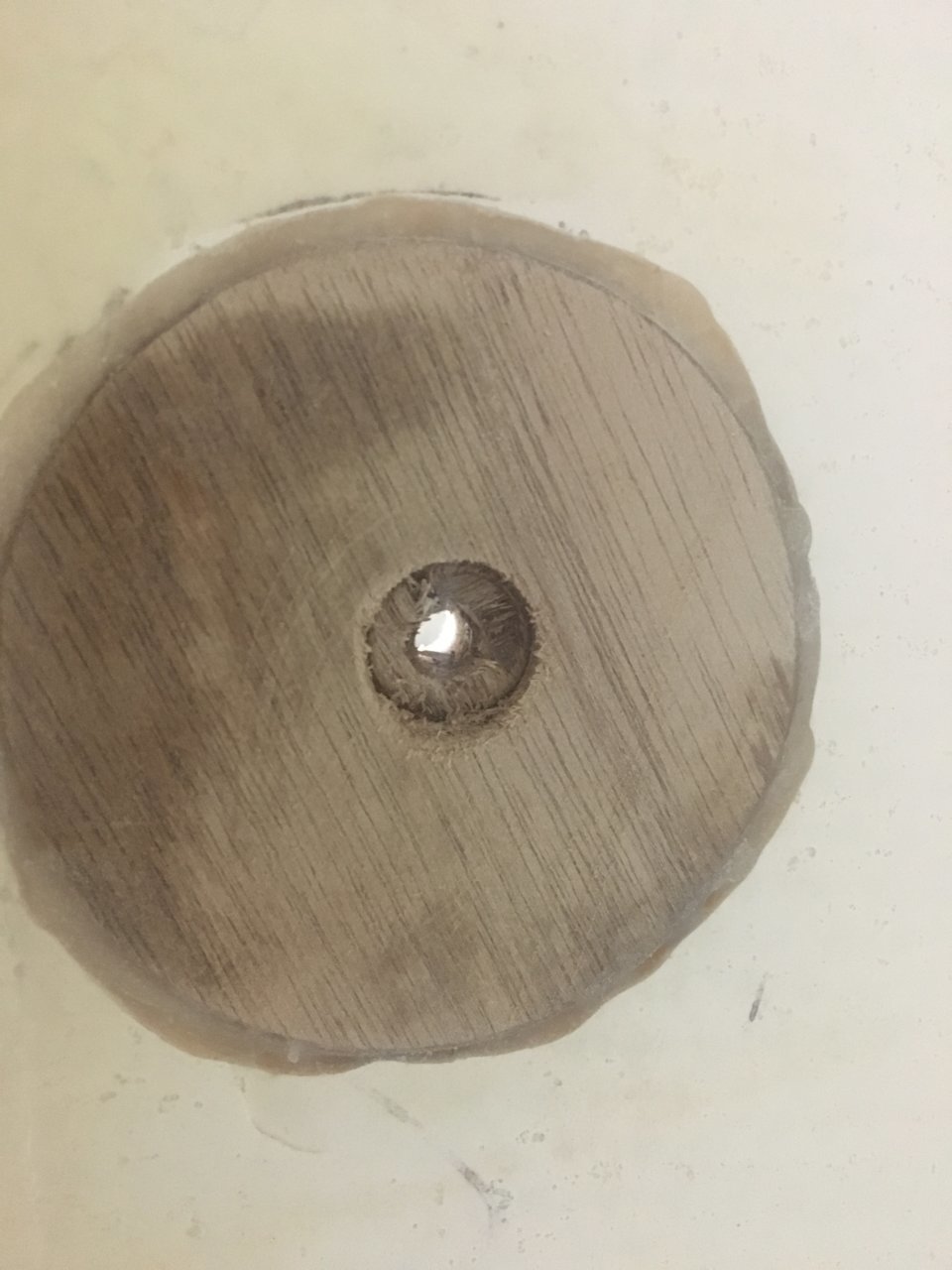

    Then I recessed the back side of the wood discs to set the T Nuts into and have them be flush so I can glass over them later.
    Going well!

    So what are you putting in the box? Camp shower? General Storage?
  19. Jan 4, 2019 at 7:02 PM
    #839
    1 Bored Clerk
    1 Bored Clerk [OP] Well-Known Member
    Sep 18, 2013
    #112786
    1,999
    Vancouver, WA
    '13 4x4 AC TRD OR
    General storage at this point. The initial idea was wet/dirty stuff that we didn’t want in the camper or truck cab until we found a spot to clean and dry it. That’s why this box has a sealable drain hole in the bottom. The plan was to include a way to hang stuff (wetsuits and jackets) in the box. It may turn into something else...who knows!
