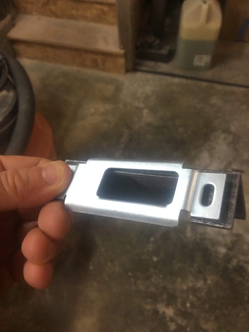

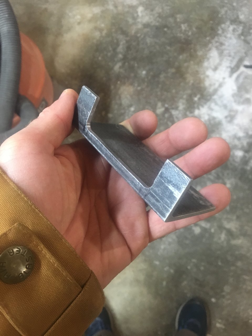

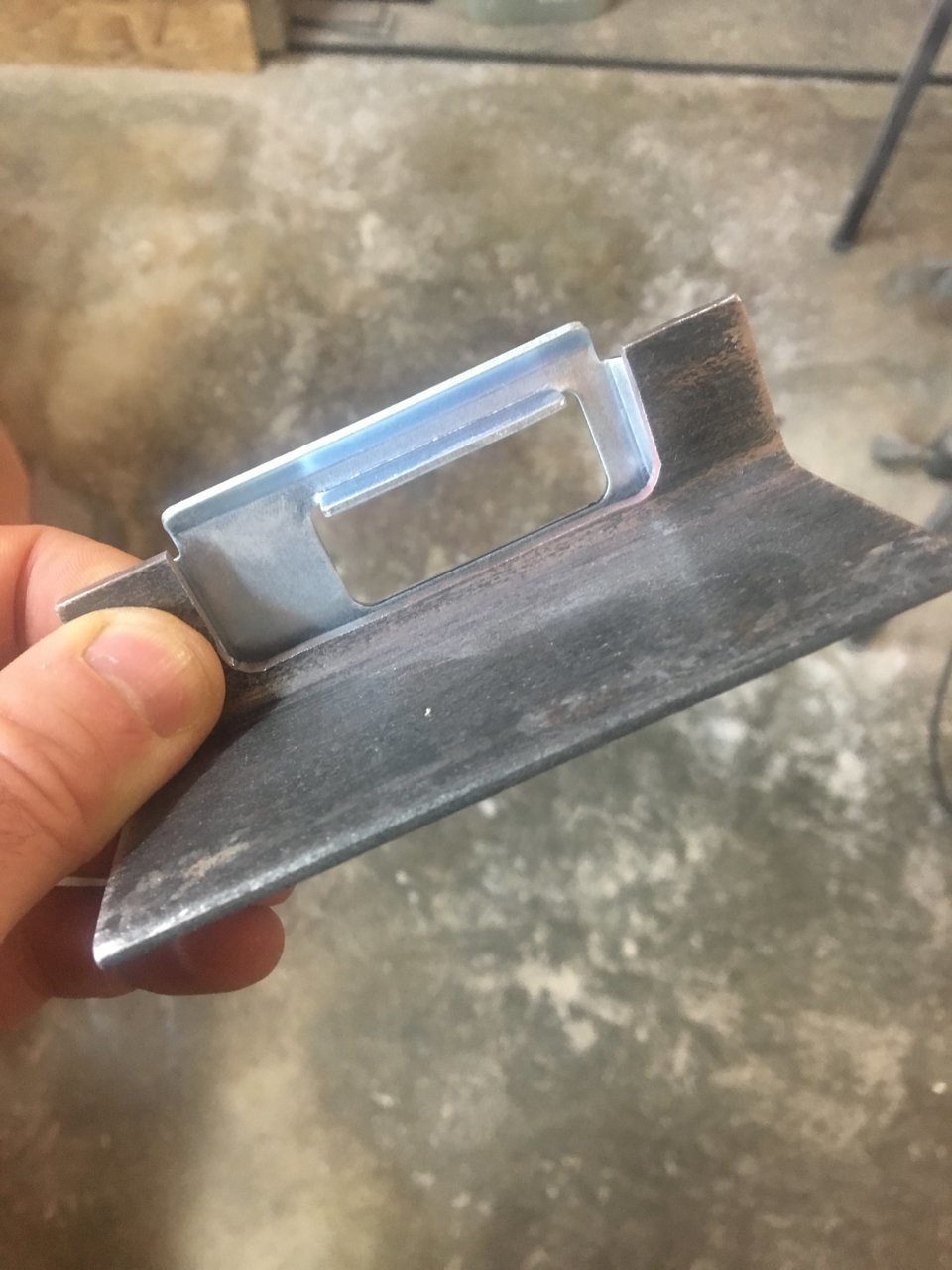

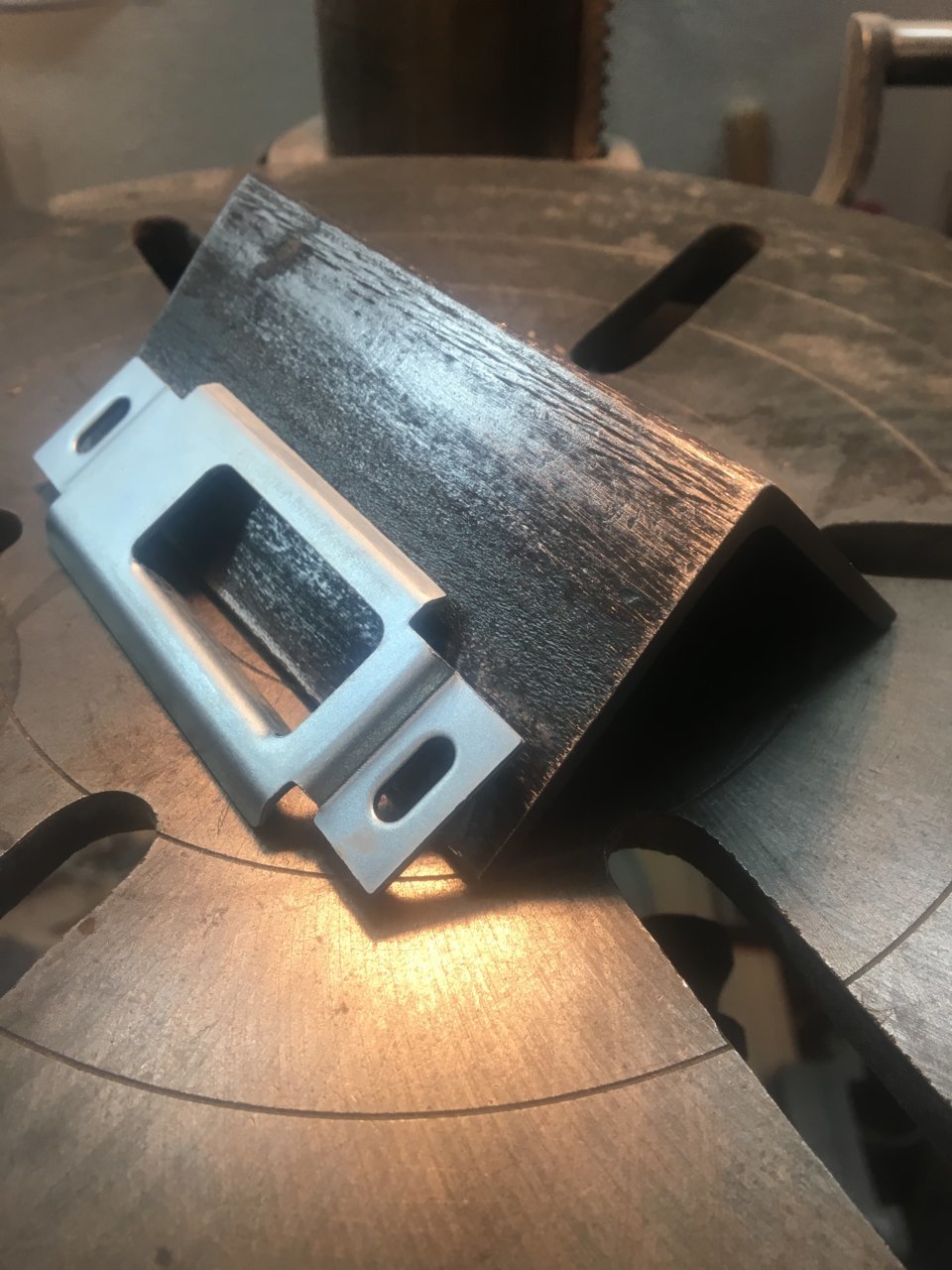

    One last thing for the night. I couldn’t just sit around and NOT do something else for the camper so I cut a piece of angle steel. This will become the mount for the strike plate for the door latch. I went back and forth between 1/4” aluminum and 1/8” steel...because that’s what I have on hand. 1/8” steel won. Is that the right choice? Discuss.

    Yes to both, I like solidworks, but being a small business and a hobbiest, I like the price of 360 :rofl:

    I like the steel idea as long as its either stainless or anodized. I would worry about rust. Not so much as a failure aspect of rust but as a bleeding aspect where it will run down the side of the camper.

    The striker plate is plated. The steel striker plate mount will be powdercoated. I have a few other things to powdercoat...I’m saving them all up.

    Looks stout. I'd say go for it.
    I do the same - I'm always trowing little parts in with my P/C batches to get coated. I almost always just get a single color so its inexpensive.

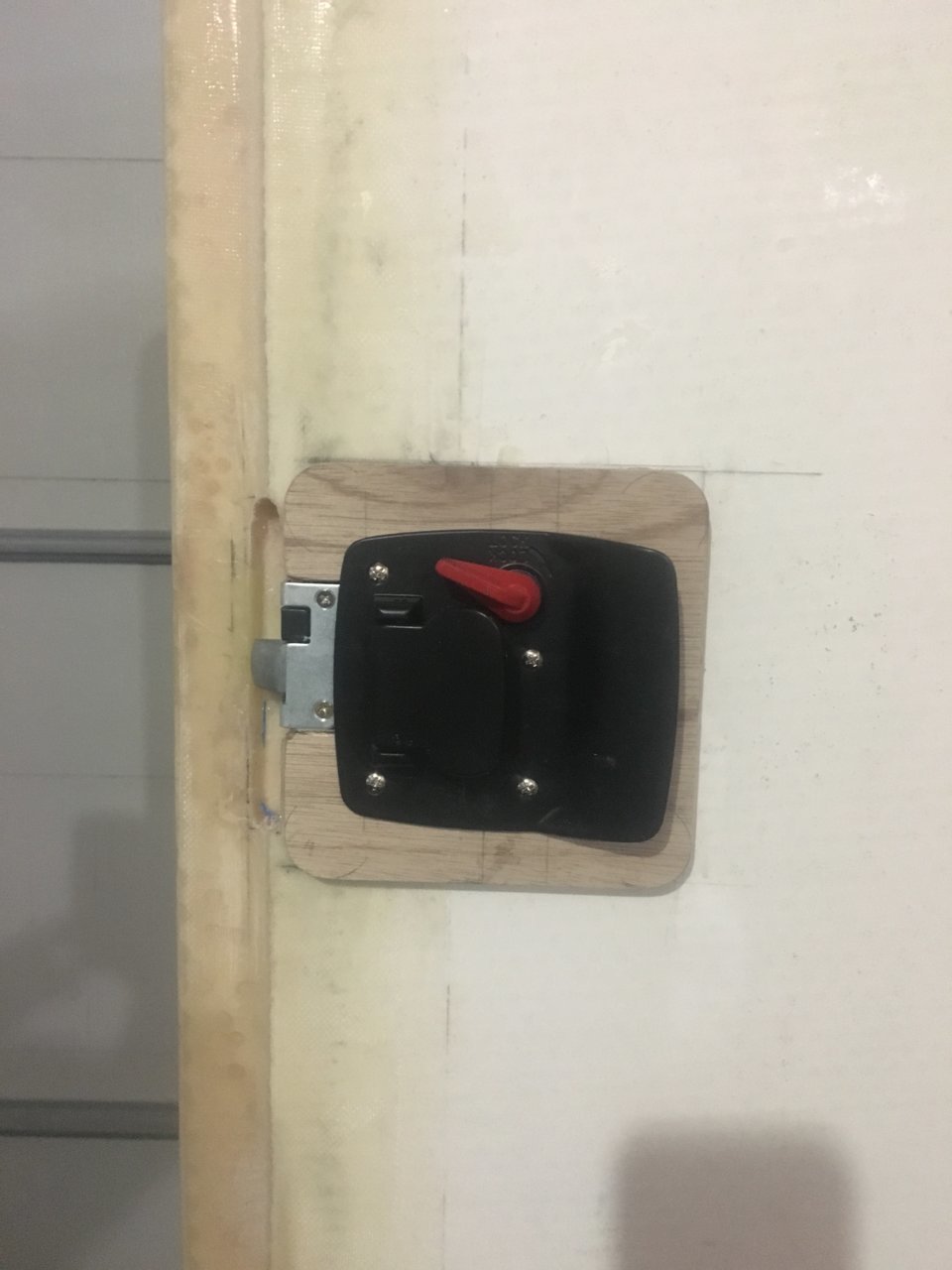

    Got some work done...a little work...
    Mounted the door handle. Just a mock up for getting the strike plate figured out. I’ll be cleaning up the mounting area and epoxy coating it later.
    I’d rather not have this stick out like this but that’s where I’m at. Hopefully it works and we don’t constantly shred ourselves getting in and out of the camper. The more I get into finishing the door, the more I want to just buy a door.
