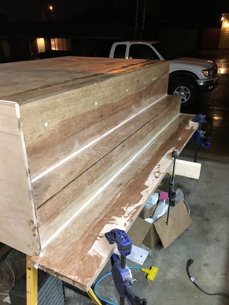

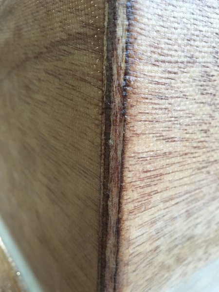

    Got back on the camper today! Finally!

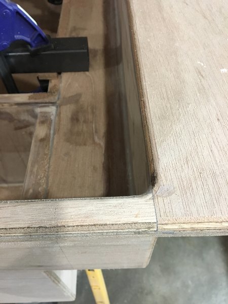

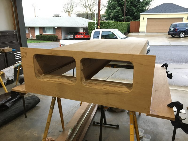

    Routed the drawer openings.
    Routes more stuff that needed the rounding treatment.

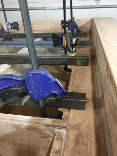

    Here's where I've made a change in design: the edge seen here is where a hinge was going to go for the access hatches from inside the camper. It dawned on me that a hinge is unnecessary. It's more complication, more time, more money, and every screw hole is another place for moisture to get into the wood. So, not doing that. The hatches will sit, fully supported, on a perimeter and will be held in place by two southco round push to close latches. Much easier and serves the purpose just as well...maybe even better.
    So, I glued in another rail on each side.
    I've been finding that I'm steadily moving toward simple. More simple everywhere. I had this thing complicated up one side and down the other. I just want to go camping comfortably in all weather and be prepared for most possible 'circumstances'. Don't need more complication!

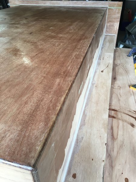

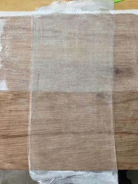

    Did a test layup today. Good to test the process and get a feel for everything. I did two layers and then laid a third layer across the top so I could see how the step down works.
    It should be all cured up tomorrow morning. I'll get after some actual glassing on the camper tomorrow!

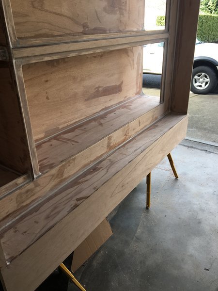

    Been working on the camper a bit.
    Laid some glass. With the input and help from some forum members I think I'm doing better work.
    Picked up a roll of 4oz cloth.
    Then I flipped the camper over and prepped it for glass tomorrow!

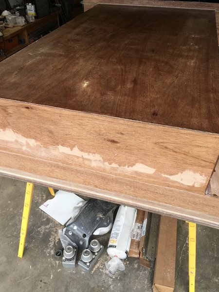

    Glassin'
    The entire bottom and wrapping the sides and ends a few inches s all one piece. That's a big piece of fabric for a noob like me to handle. Hard to get it in place and then flattened out. I got it though...after much wrestling and smoothing. Hoping to get the end and one or both sides tomorrow. That would be all of the big glassing done in one weekend. We'll see!

    Did this whole stair step side in one piece of glass. That sucked! It took me a good while to work it flat, into position, and into all of the corners. I got it done but I'll probably do the other side in 2-3 pieces for my sanity. We'll see.

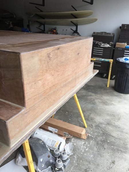

    Finished all of the big glassing on the bottom of the camper. Some clean up to do but I'm excited to be past this part!

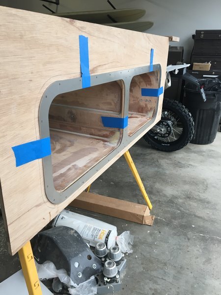

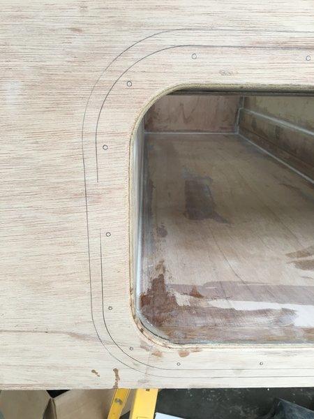

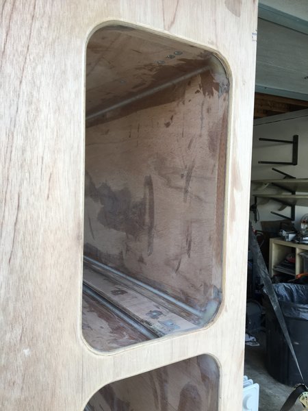

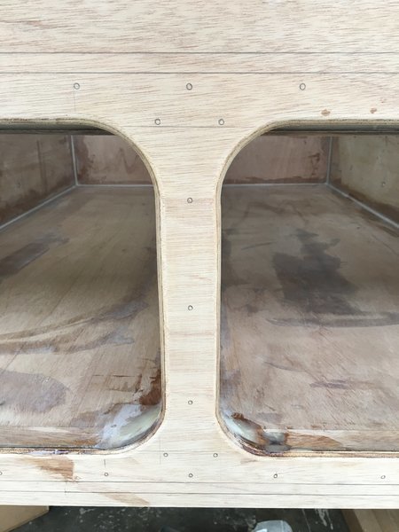

    Worked on the camper this evening. Started figuring out the drawer seal plate.
    Taped it in place.

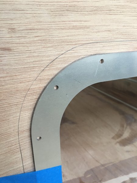

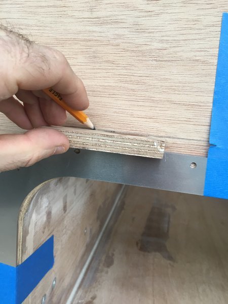

    Traced everything and marked all the mounting holes so that it's easy to put back later. I also traced an offset line 1/2" bigger than the overall shape. This is where I want a second piece of plywood to stop. This will help make the drawer faces flush with the back of the camper. Hopefully. Haha
    All traced and ready for drilling and other work. The clamp on bulb seal I bought is meant for 1/8" thick material but it sure doesn't seem happy on this 1/8" thick aluminum. I'll probably have this plate redone in slightly thinner material. It wasn't too expensive but it's still a bummer. This is the time to do it right though! I might open up the drawer openings in the aluminum a tiny bit too...just to make sure the drawer slides will make it past the bulb seals.
