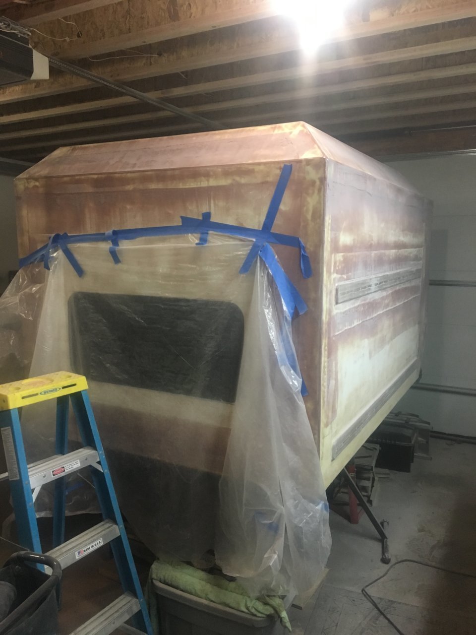

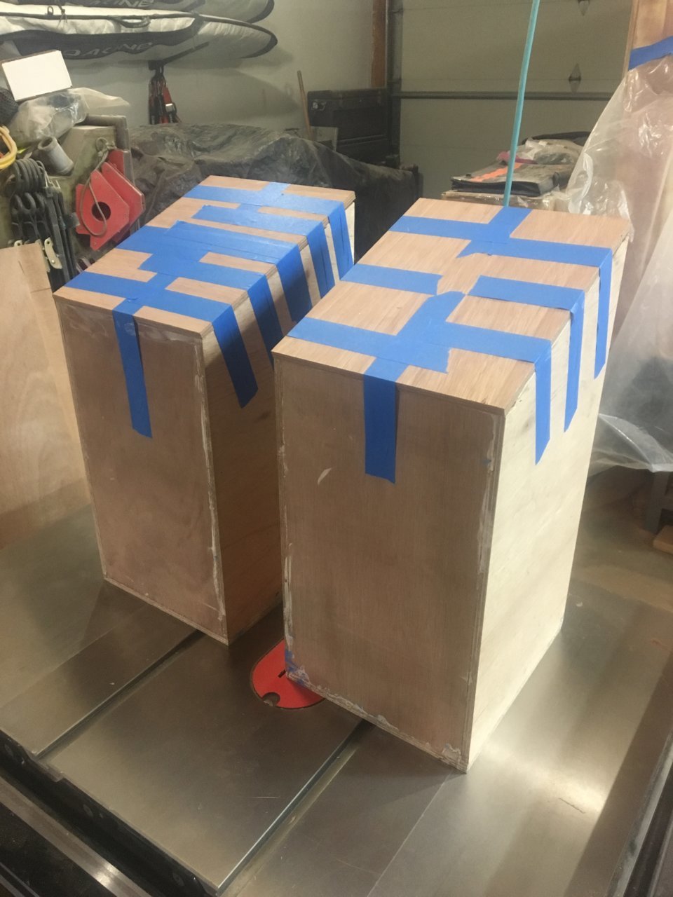

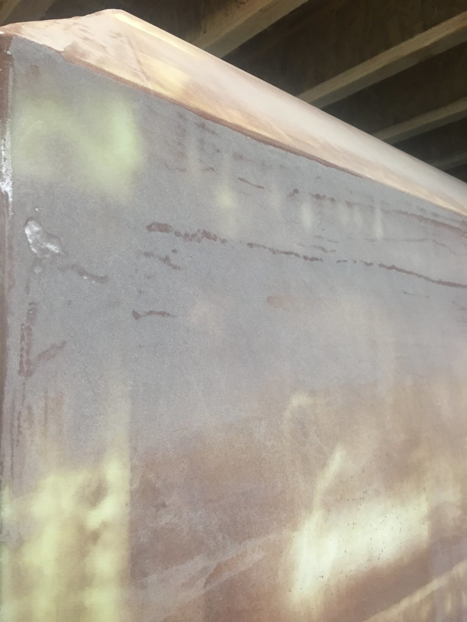

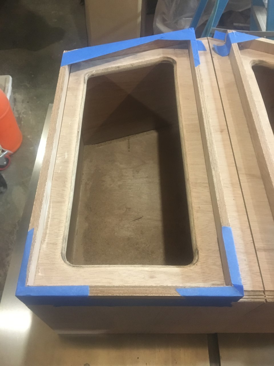

  11. Feb 26, 2019 at 8:56 PM
    #1031
    1 Bored Clerk
    1 Bored Clerk [OP] Well-Known Member
    Sep 18, 2013
    #112786
    1,999
    Vancouver, WA
    '13 4x4 AC TRD OR
    A little glueing and a lot of sanding.
    Glued the ends on these bad boys. Tomorrow Or Thursday I’ll get these all sanded up and start getting the doors dialed in. Then epoxy fillets and glass...you know the drill.
    Then I sanded the second layer of fairing compound on the exterior. I can see how this is going to go. Lots of layers and lots of sanding. It’s actually pretty quick though.
    It’s VERY easy to see the big low spots...they’re still shiny. I’ll scrub this down with acetone then put another layer on. We’ll get there...eventually.
    I’m not going to go so crazy on fairing out the roof. Can’t see it. Lazy? Or smart? Hmmm... As long as all the little divots and pinholes are sealed, it’s all good.
    I’m planning to spend all weekend on this thing. Ideally, I’d have every surface that needs fairing covered with, at least, it’s first layer by the end of the weekend. Would be great to have sanded most of the first layer and started second or third layers of fairing but that feels greedy. Haha.

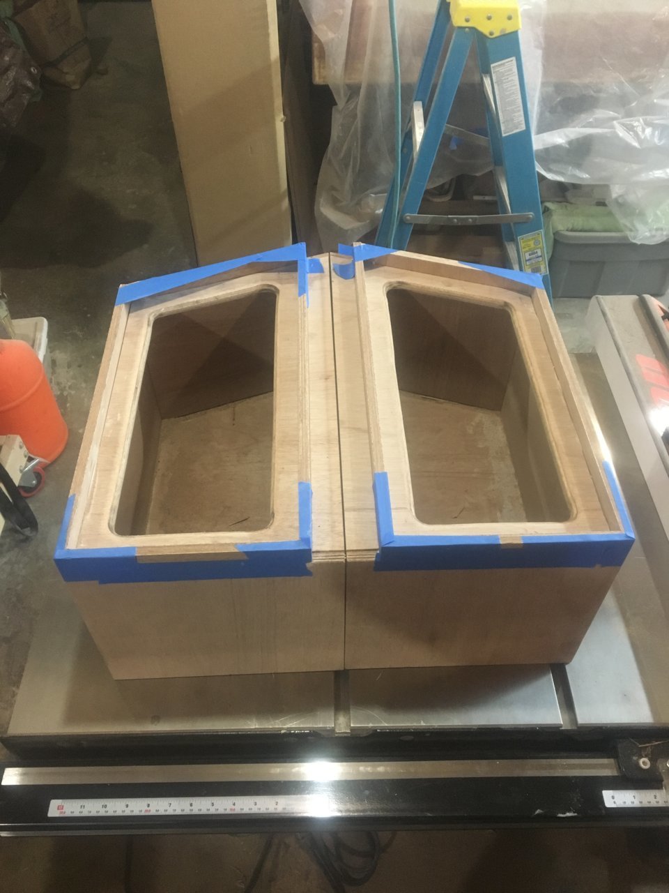

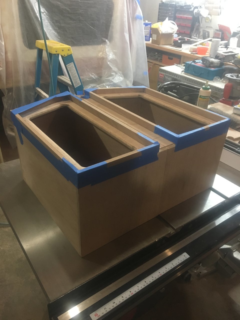

  12. Feb 28, 2019 at 6:27 PM
    #1032
    1 Bored Clerk
    Sep 18, 2013
    #112786
    1,999
    Vancouver, WA
    '13 4x4 AC TRD OR
    Box work.
    These seem to be coming along nicely. Still need to get hinges, various fasteners, latches and fiberglass. Believe it or not, I don’t actually have any fiberglass on hand.
    I’m excited to get back on the camper but it takes time to get everything heated up and nice for working so I’ll save it for this weekend. Tomorrow night I’ll need to do a thorough cleaning! Put tools away, clean up sawdust, etc. The garage is trashed!

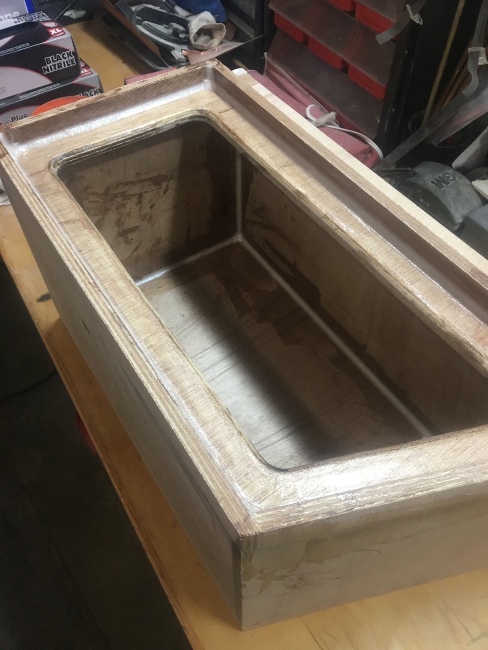

  16. Mar 2, 2019 at 1:37 PM
    #1036
    1 Bored Clerk
    Sep 18, 2013
    #112786
    1,999
    Vancouver, WA
    '13 4x4 AC TRD OR

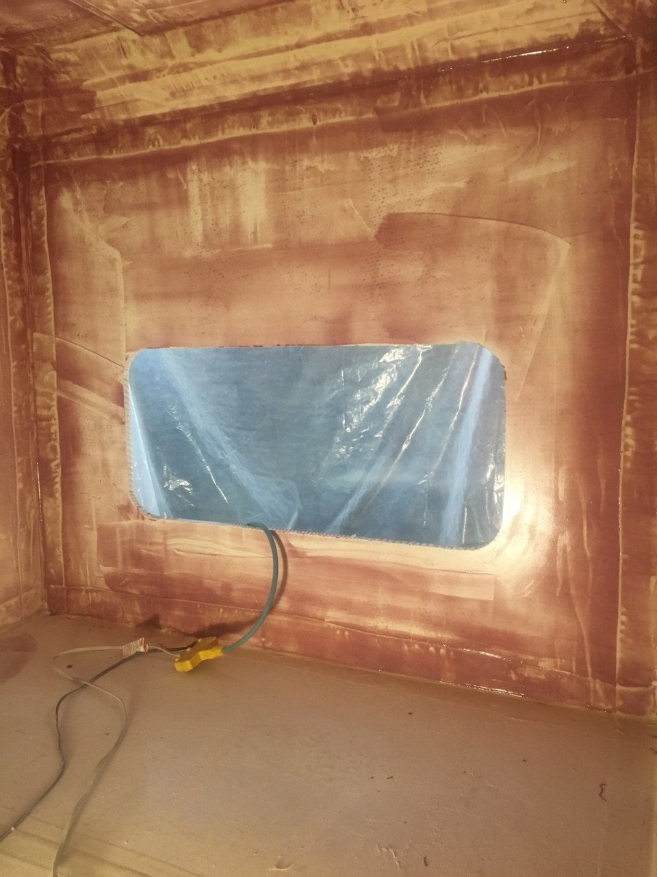

    Did some errand running and a bit of garage cleaning this morning. Then got after the boxes and camper.
    Did a bunch of epoxy fillet work and divot repair on one box. The other box will happen later this afternoon.
    And I got the first round of fairing done on the back wall area. Front wall and some exterior work will happen with work round two later this afternoon.
    I’m not super speeding through this but it feels like a decent pace tomorrow will be a lot of sanding and, hopefully, glassing the exterior of the boxes.

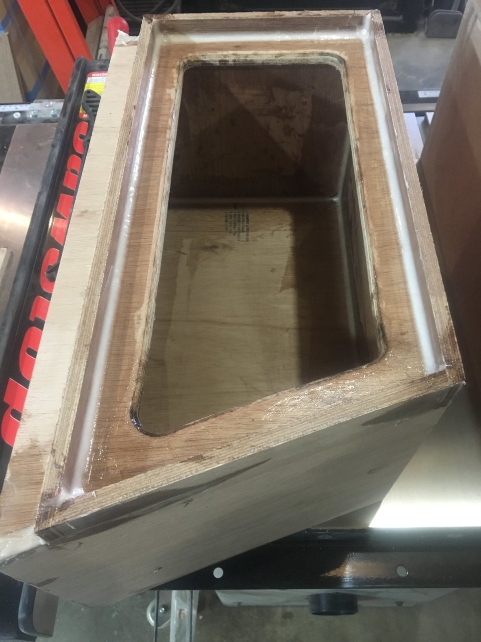

  17. Mar 2, 2019 at 4:47 PM
    #1037
    1 Bored Clerk
    Sep 18, 2013
    #112786
    1,999
    Vancouver, WA
    '13 4x4 AC TRD OR
    Another box. Another wall.
    Now I need to go do something active. A run around the neighborhood perhaps. Then I’ll reassess my evening plans.
