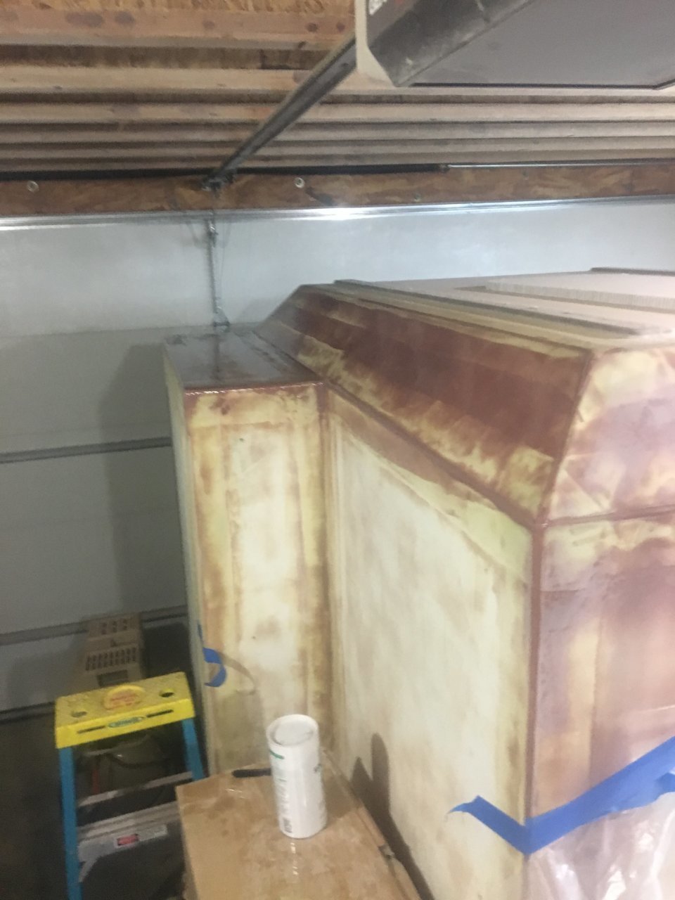

    That’s it for today. I got the panel above the door and the angled roof panel adjacent to it coated. Back at it tomorrow.

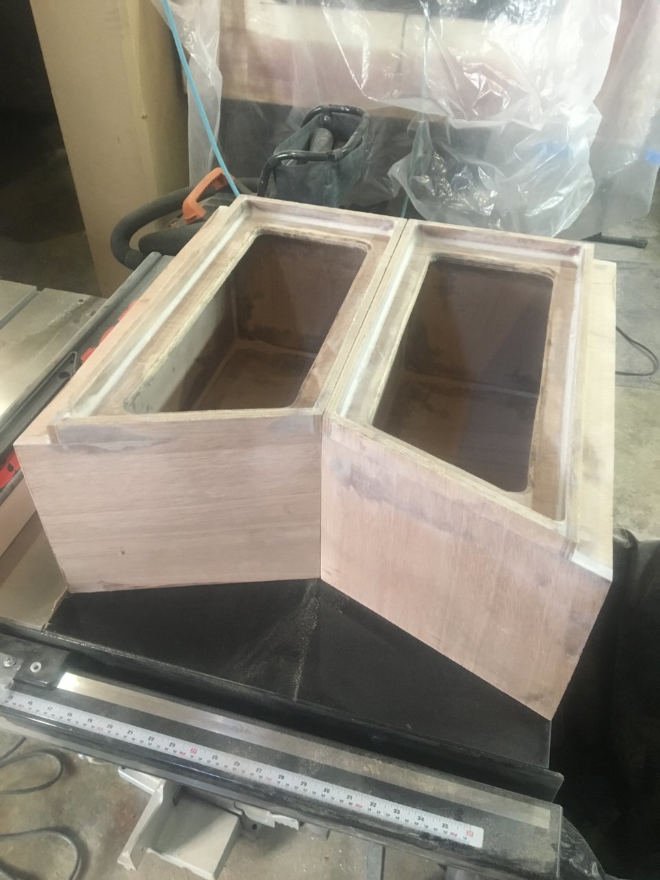

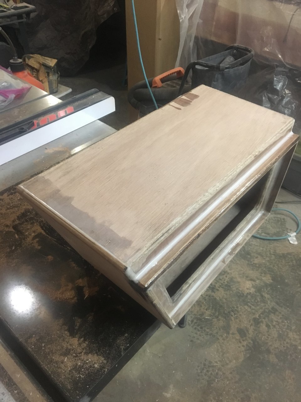

    Sanded the boxes up a bit. Ready for routing and detailed hand sanding of certain areas. Once that’s all done then it’ll be time for fiberglass.

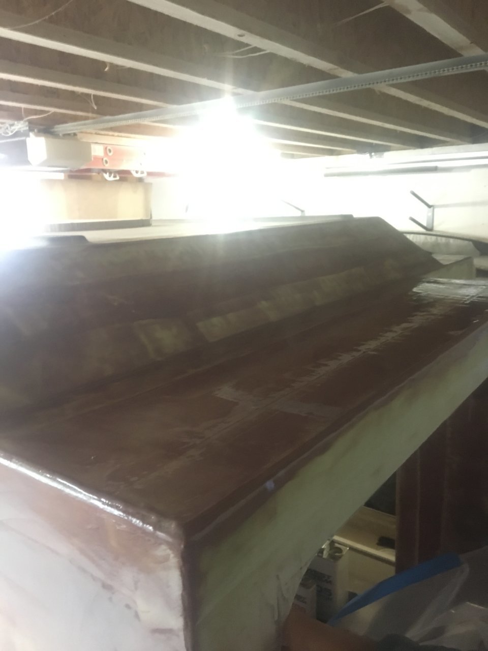

    Then there’s this terrible photo. Epoxy fairing on the roof over the back window and the back angled roof surface. Slowly making my way around the camper.
    The first round of epoxy fairing is actually really fast and easy. Keeping it warm enough to cure is the hard part.

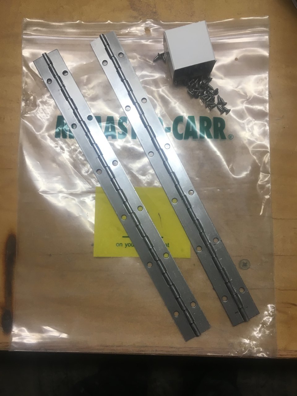

    Just ordered the hinges, fasteners and latches for the under bed boxes! But forgot to order the new bulb seal for the camper door. I realized I could order 1” bulb seal and it would compress the correct amount without modifying the door or jamb at all. Not sure how any of the bulb seal will really work around the corners but we’ll see. Then I’ll use the bulb seal that I originally bought for the camper door on the underbed box doors. Perfect! Everything will be sealed-ish.

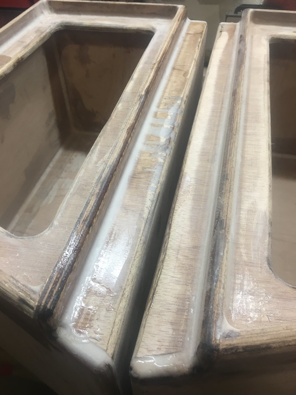

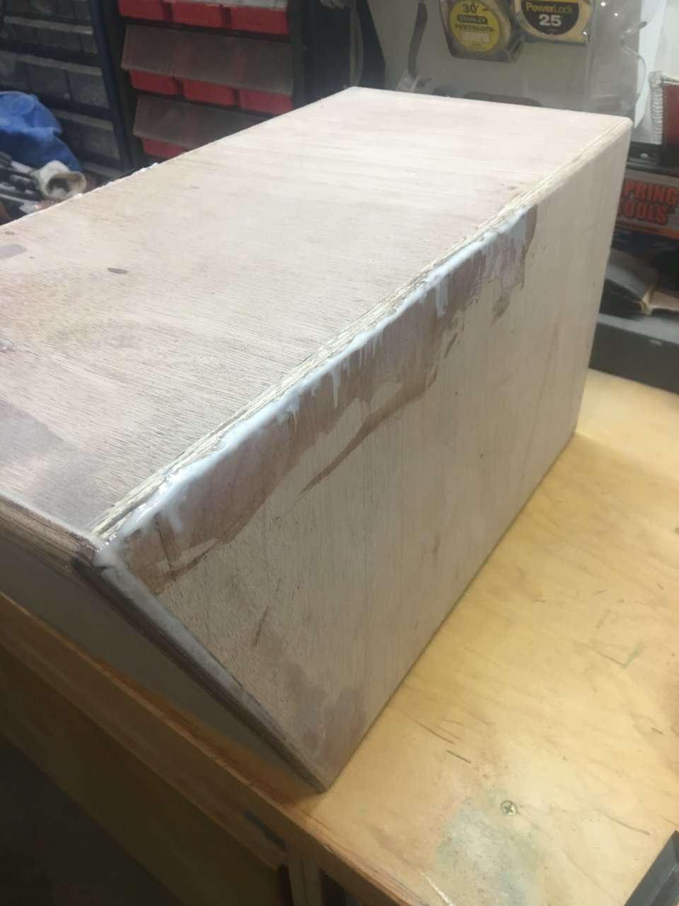

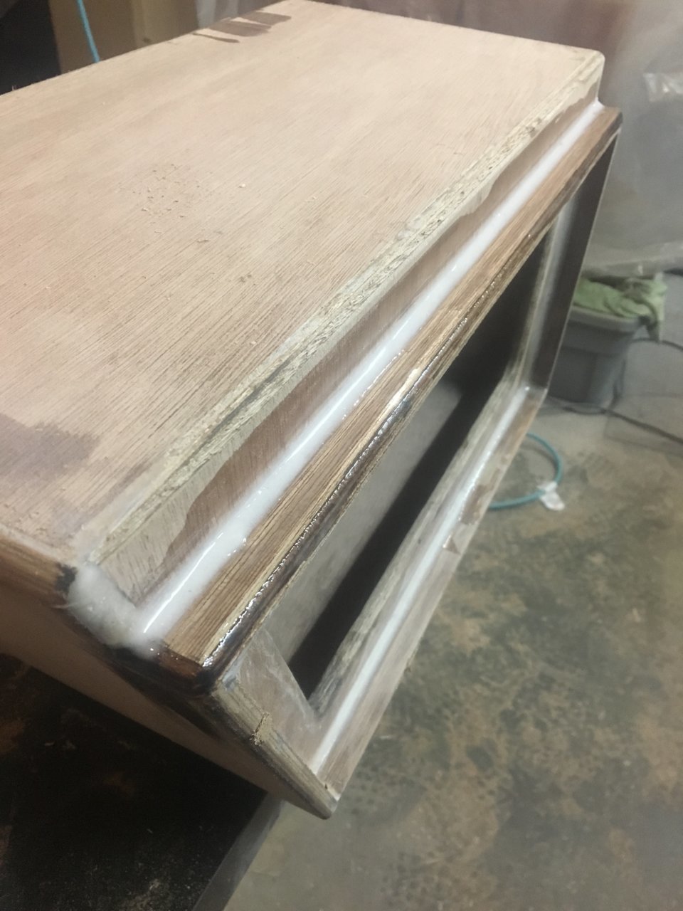

    Some routing...some epoxy.
    Some of the plywood blew out from routing. Knew it was going to happen...and it did. I was able to minimize it once I figured out which way to travel in the cut. Which I will forget immed...what was I talking about?

    I do the same thing.
    I always have to look at the bit, figure out its rotation direction, then how to move the router.
    You'd think it would be easy to remember.......

    Do you move it the way it naturally wants to move, or against that?
    If that makes sense..
  15. Mar 7, 2019 at 6:57 AM
    #1055
    Scott B.
    Scott B. Well-Known Member
    Nov 11, 2014
    #142118
    4,490
    Scott
    Georgia
    2015 ACLB SR5 4x4 Expo
    Yes, it makes sense.
    You want the bit to cut into the work. In other words, at the bit comes around, it should pass over the already cut area, and cut into the workpiece.
    Another way to say that is to pull the router along the workpiece against the rotation of the bit. To use what you said, against the way it wants to move.
    If I had a bit in front of me, and I knew which way they turned, it would be much easier to explain!

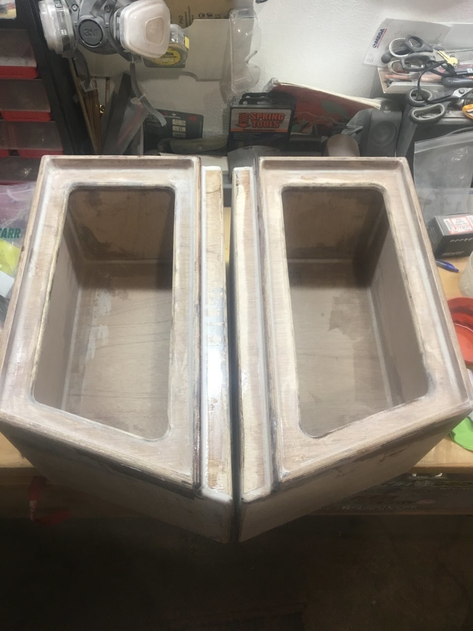

    More sanding and epoxy work on the boxes.
    These will be ready for fiberglass after I sand this down and clean them up.
    The hinges and screws arrived for the boxes. The latches should be here next week.

    A few audio upgrades, tinted windows, remote start because it f'n hot in Texas! 6in Fabtech DB lift, 17x9 Fuel Trophy wheels, 315/70/17 Duratracs,BAMF 80in sliders w/kickout, Prinsu cab rack w/30in Heretic light bar, custom bedside decals, custom hi-lift jack brackets, US Offroad front bumper w/winch, bed rack with RTT, CB, Short wave base station, Ultra gauge, color matched grille surround, an ungodly amount of recover gear, ARB fridge, hood struts, RotoPax, traction pads.
    Can't even tell where the edge split.
