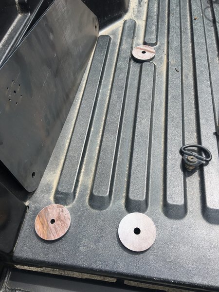

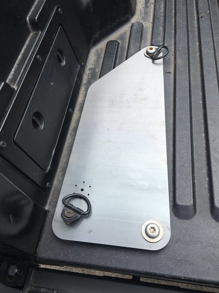

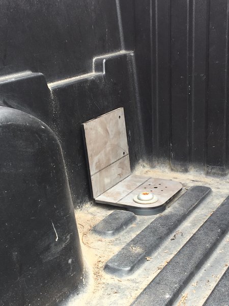

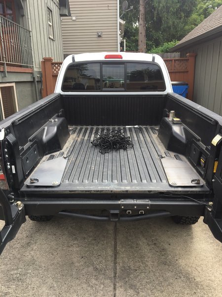

    Okay, got back on some camper work today. I think I hit project fatigue or something...I just didn't want to do anything on the camper for a while. Now I'm fighting my way back into it.
    I test fit all of the baseplates for my camper mount system. Apparently, I'm pretty good with a tape measure because the holes seem to line up perfectly!
    All of the base plates have these laser cut spacers under them. All of the bed bolts sit in the low parts of the bed so you have to space that up to be Level with the ribs of the bed.
    The front mounts tie together the single front bed mount and the tie down loop mounting points.
    The rear mounts tie together all three of the bed mounting locations.
    I'm not fully convinced I'm going about this the right way but I've got to start somewhere before I can get anywhere!
