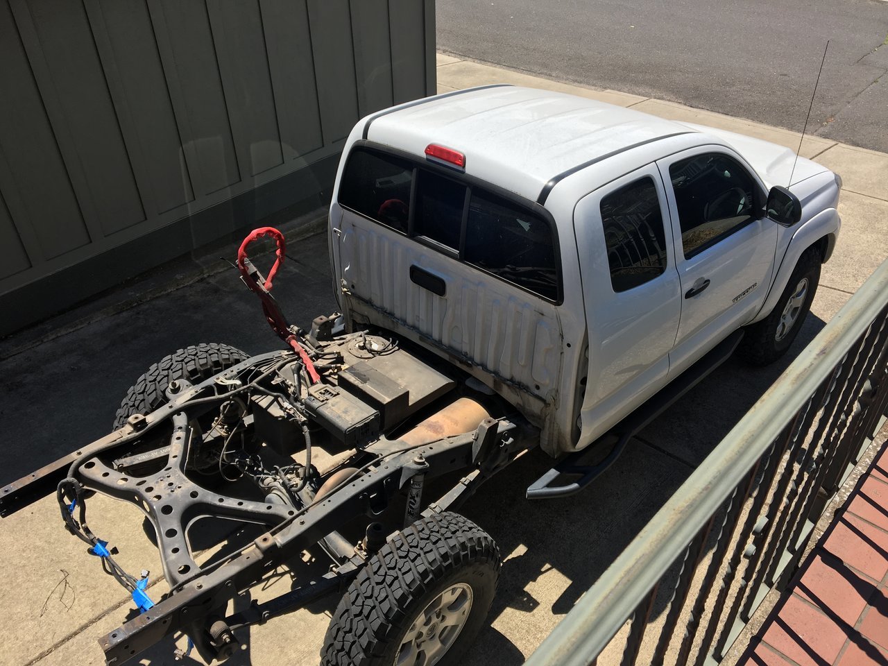

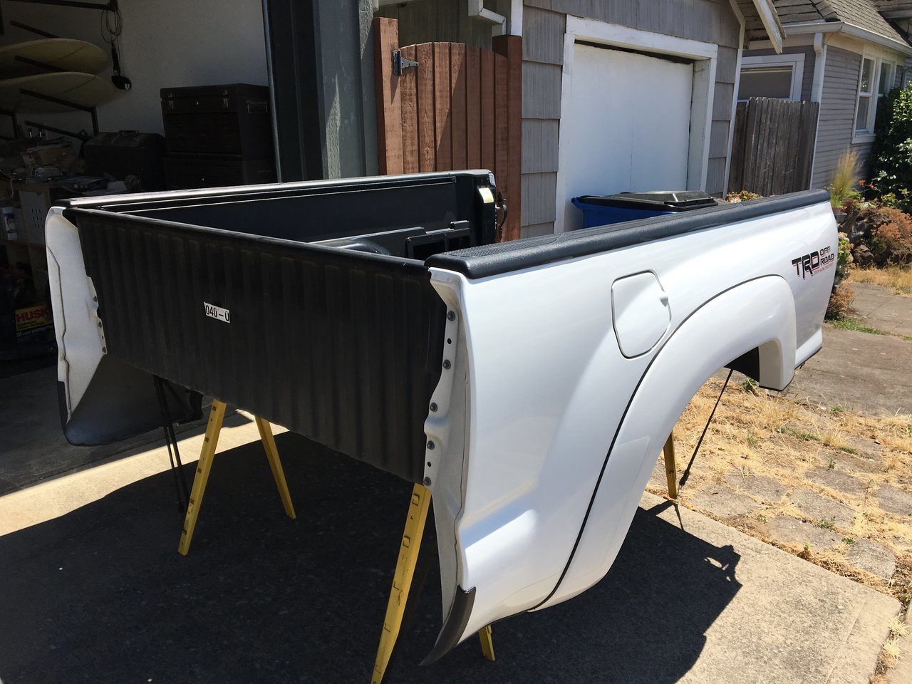

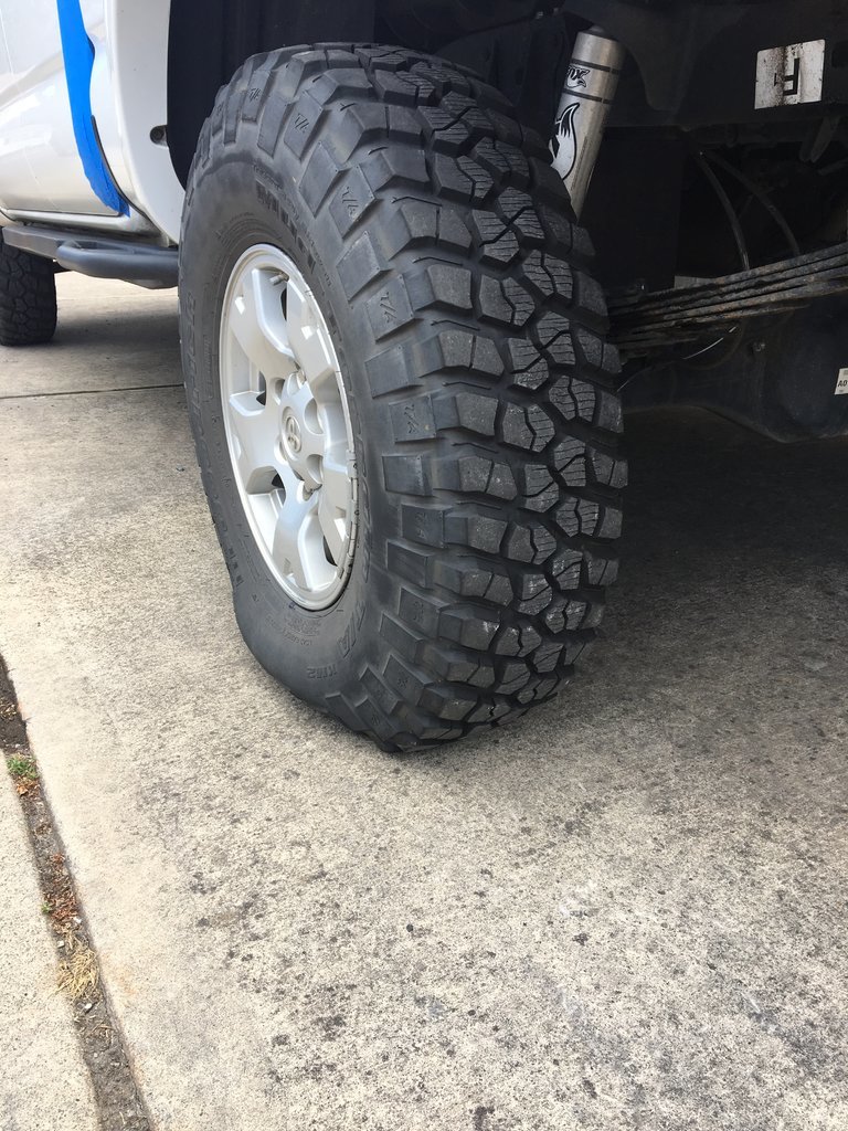

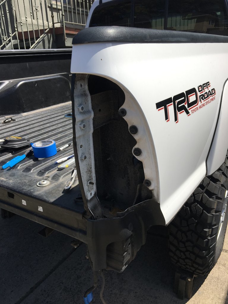

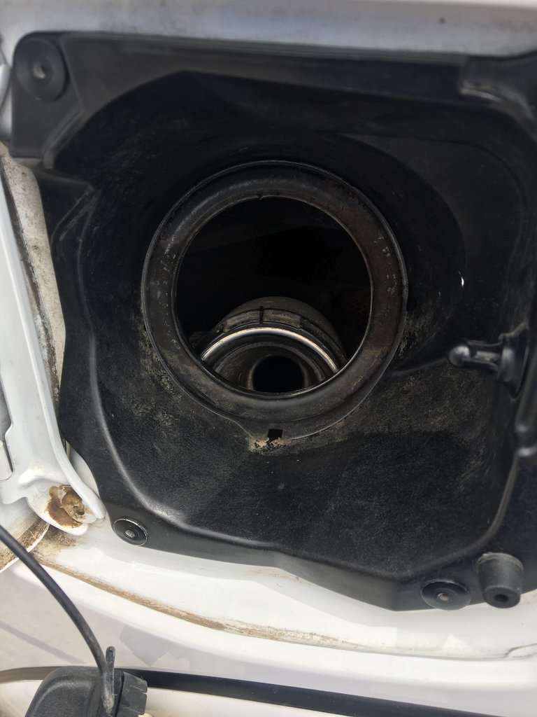

  19. Jul 16, 2017 at 6:14 PM
    #139
    1 Bored Clerk
    1 Bored Clerk [OP] Well-Known Member
    Sep 18, 2013
    #112786
    1,999
    Vancouver, WA
    '13 4x4 AC TRD OR

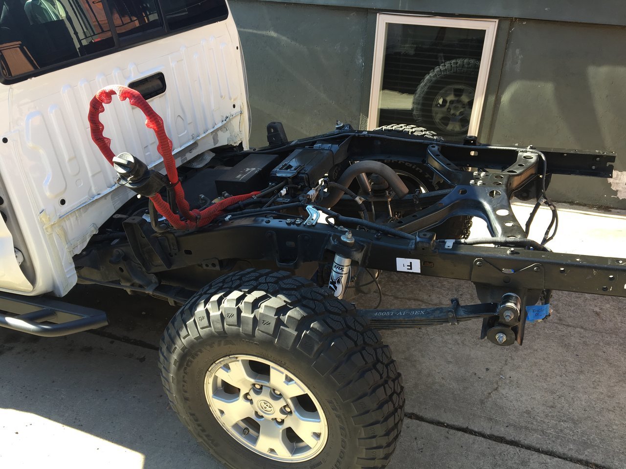

    The big lift!
    Prepping to pull the bed:
    All wiring attached to or snaking through the bed. Spaghettiville! Nicely labeled spaghetti since I found out that the backup camera and the license plate lights have the same plug and are interchangeable with negative effects.
    Taillights removed. Bolt, bolt, yank!
    A little tape to protect against accidental contact.
    Unbolt the filler from the frame and push the neck through the grommet in the filler door. It's really easy.
    Completely unloaded All Pro Expo springs means a tall truck! We aired down the tires a ton to gain back a few important inches. Made it easier to lift the bed off and over the back tires.
    Set the bed on some sawhorses. Wait for sale and annoy neighbors. Our hillbilly is showing in our nice neighborhood! At least I washed it!
    Then you're left with this unholy mess. Sigh.
    Kinda fun to drive like this! Would've enjoyed taking it for a cruise around town. But, alas, not going to happen because I'm illegal a dozen different ways here. Haha.
    Gave the tail end a bath. LOTS of dirt, rocks and 'gunk' there. Never mind that big red loop. It's part of my venting for my LRA 34 gallon tank. Will be revisiting this to try to get it to fill without burping. Also bolted up my new spare tire hoist. It will be living back under the truck again.
    That's it for today! I need to pick up a few things from the hardware store tomorrow to get after the actual flatbed mounting.
    Pumped to get this done!
