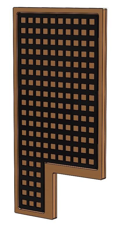

    Getting some molle panels designed for the unpainted wall sections just inside the door of the camper. Here's the rear panel.
    Construction will be three layers of .5" marine plywood stacked up with a (probably) CNC routed HDPE plastic panel. The panel will be flush with the surface of the wood but there will be empty space behind it to accommodate the bag straps. I'll use spacers to keep the molle panel supported off the wood backer. It'll add a little bit of wood to the interior as well as some contrast and depth...and storage. I'm a little worried that it may make the entrance feel too cramped. May only do this rear panel and do something decorative on the other panel.

    been thinking about something similar for my Flippac...

    If you aren't particular about the shape of the panel, Greyman Tactical has panels you can just buy. They aren't cheap but they would get your project done NOW which has a certain benefit that can't be quantified by money: time.

    I appreciate the heads up but I have a laser cutting company I work with that will make me them in any shape I want. :D
    Also, I'm not in a hurry. My setup works fine and something like this would just be added refinement. ;)

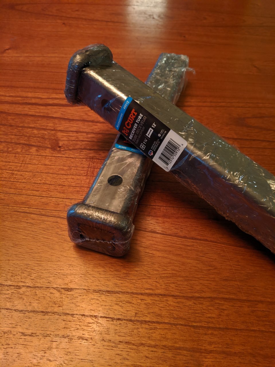

    These dudes showed up
    Two Curt weld-in 1-1/4" hitch receivers. I've got plans... :thumbsup:

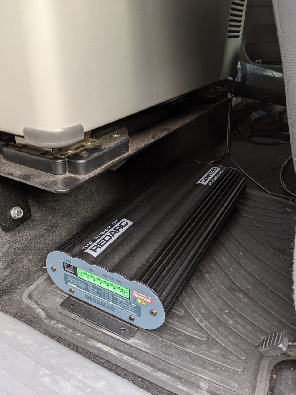

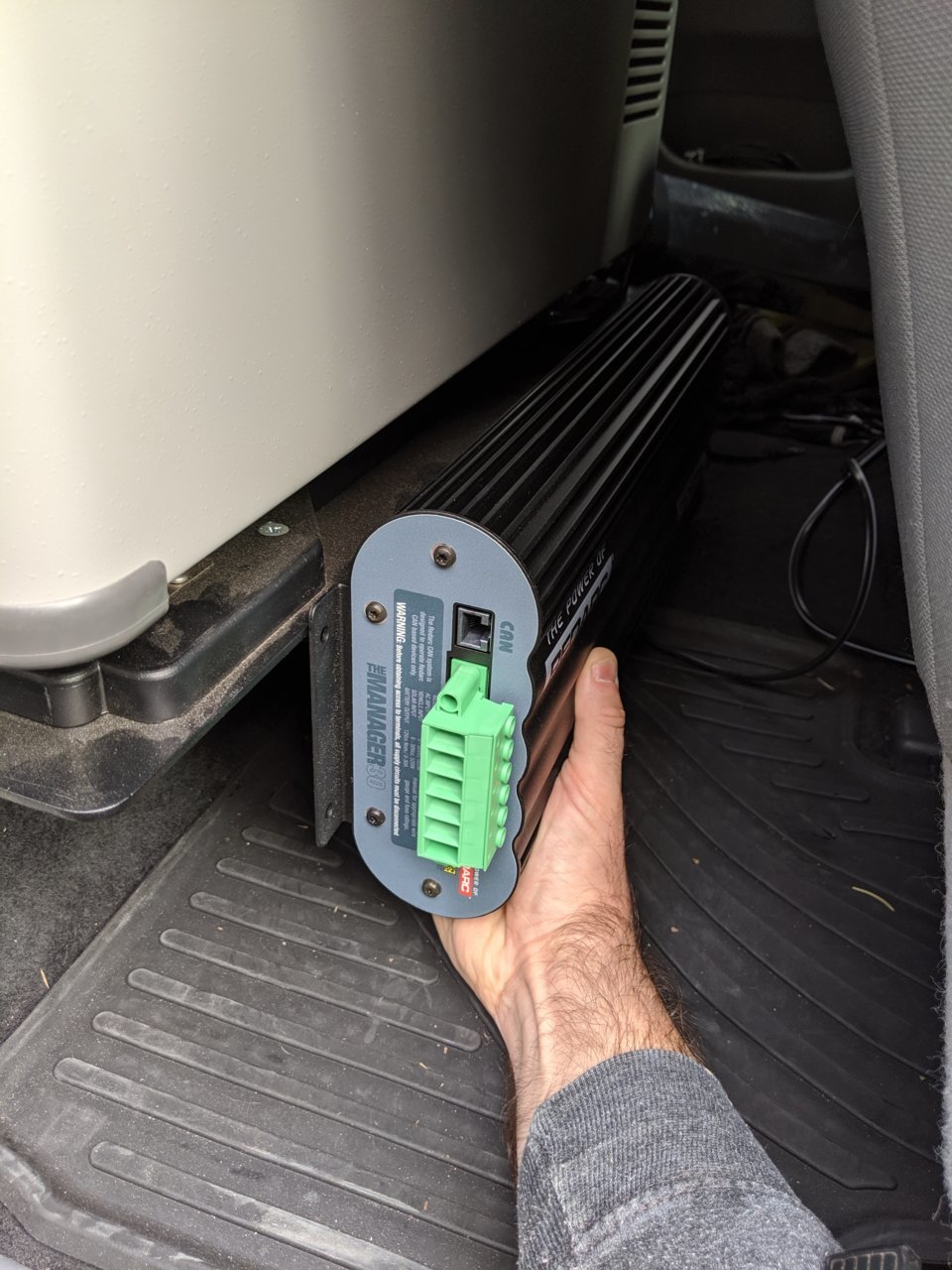

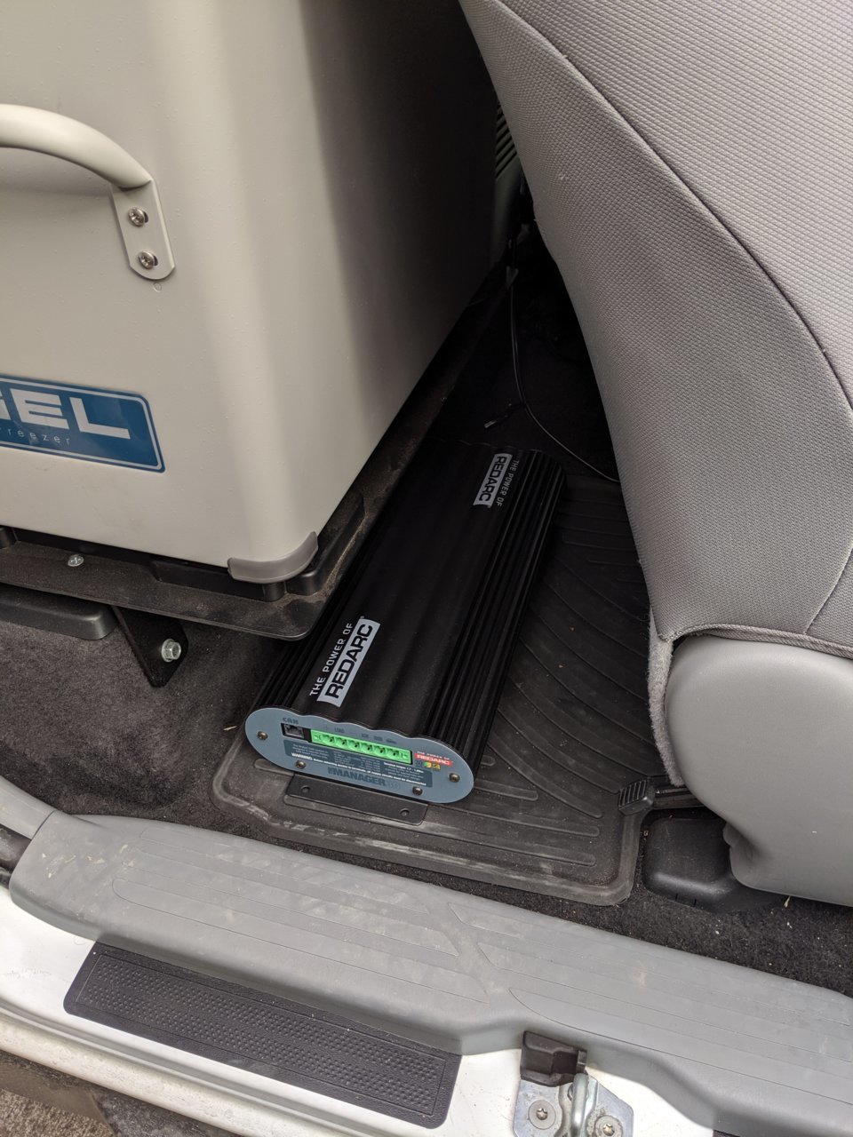

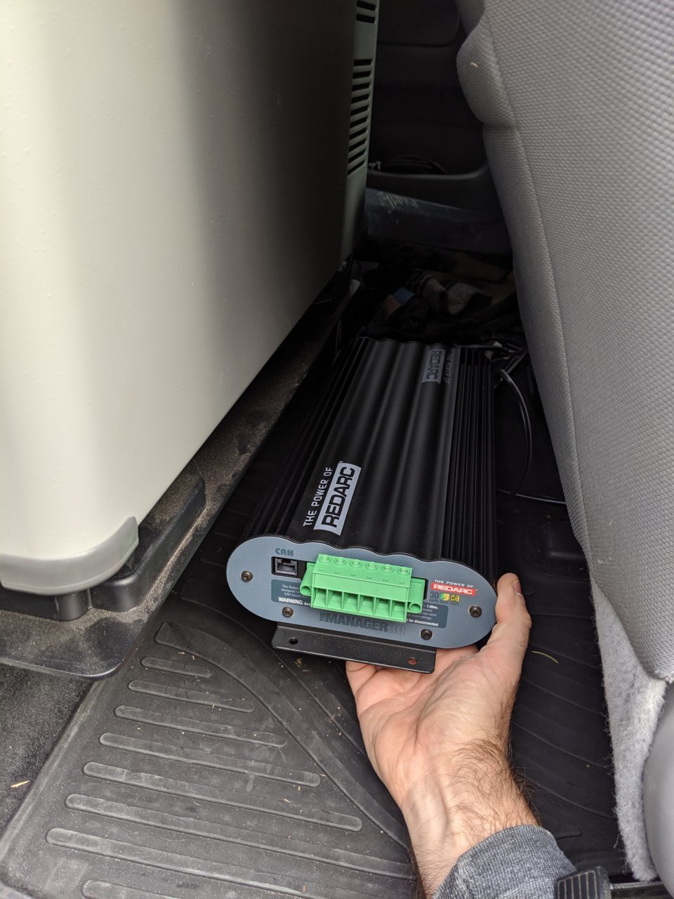

    Been busy with non-camper stuff. But I did some garage cleaning to start resetting after the deck project. Then I did some quick mockup work with the Redarc Manager 30 to see how I may want to mount it.
    This seems easy but it doesn't leave much room for bend radius on wires coming out (green connectors) there is a connector that plugs into this that takes more room as well. So...
    I could raise it up and have it overlap the transmission tunnel a bit. Seems space inefficient.
    This is feeling pretty good. Gives me enough room and flexibility for wire routing and seems relatively space efficient. Pretty easy to make mounting brackets too. You know how I HATE to drill holes in the truck. I can make brackets that bolt to the fridge mount. A little triangulation in the mount brackets should be plenty of support as the manager 30 is actually pretty light.
    Also, you need 4" of clearance above the unit for heat so I can't tuck it under the fridge mount. It wouldn't fit well anyway...would have to angle it a bit.
    Pretty tame first step but it feels good to be starting this phase of the project.

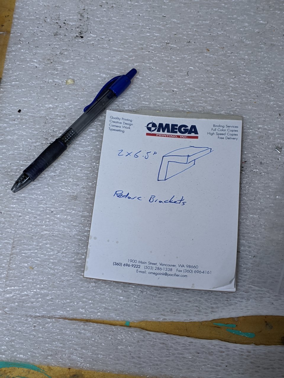

    I also measured what I would need to mount up the Redarc Manager 30. I have some 2.5" x 1/4" wall angle aluminum that I've been using up for years. Looks like it'll be 13" shorter tomorrow. :thumbsup:
