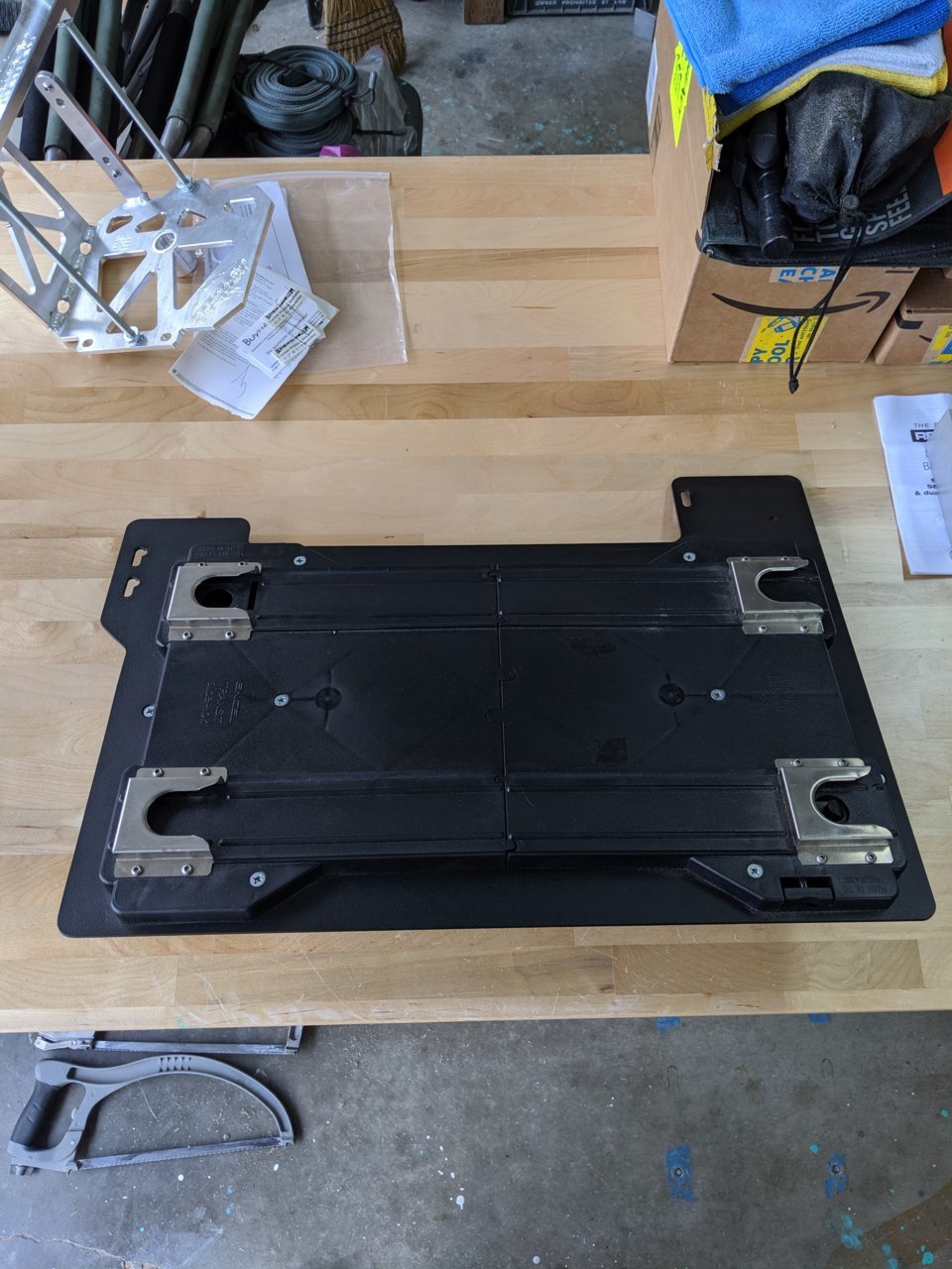

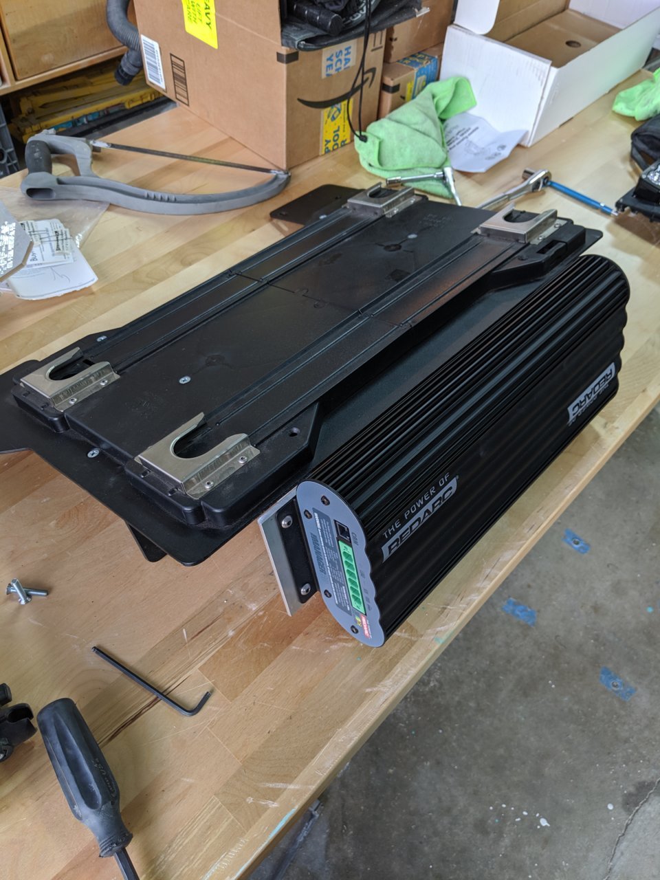

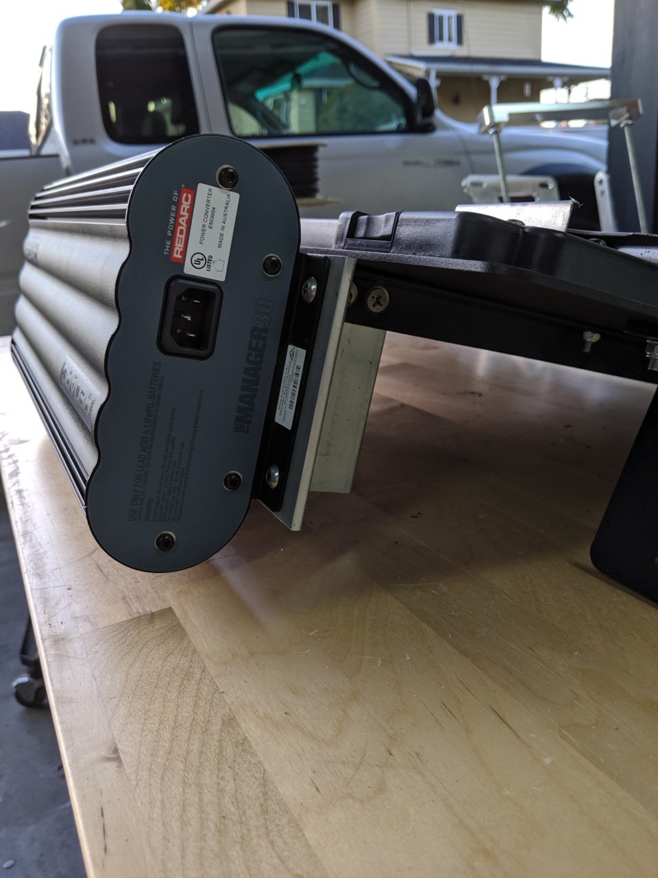

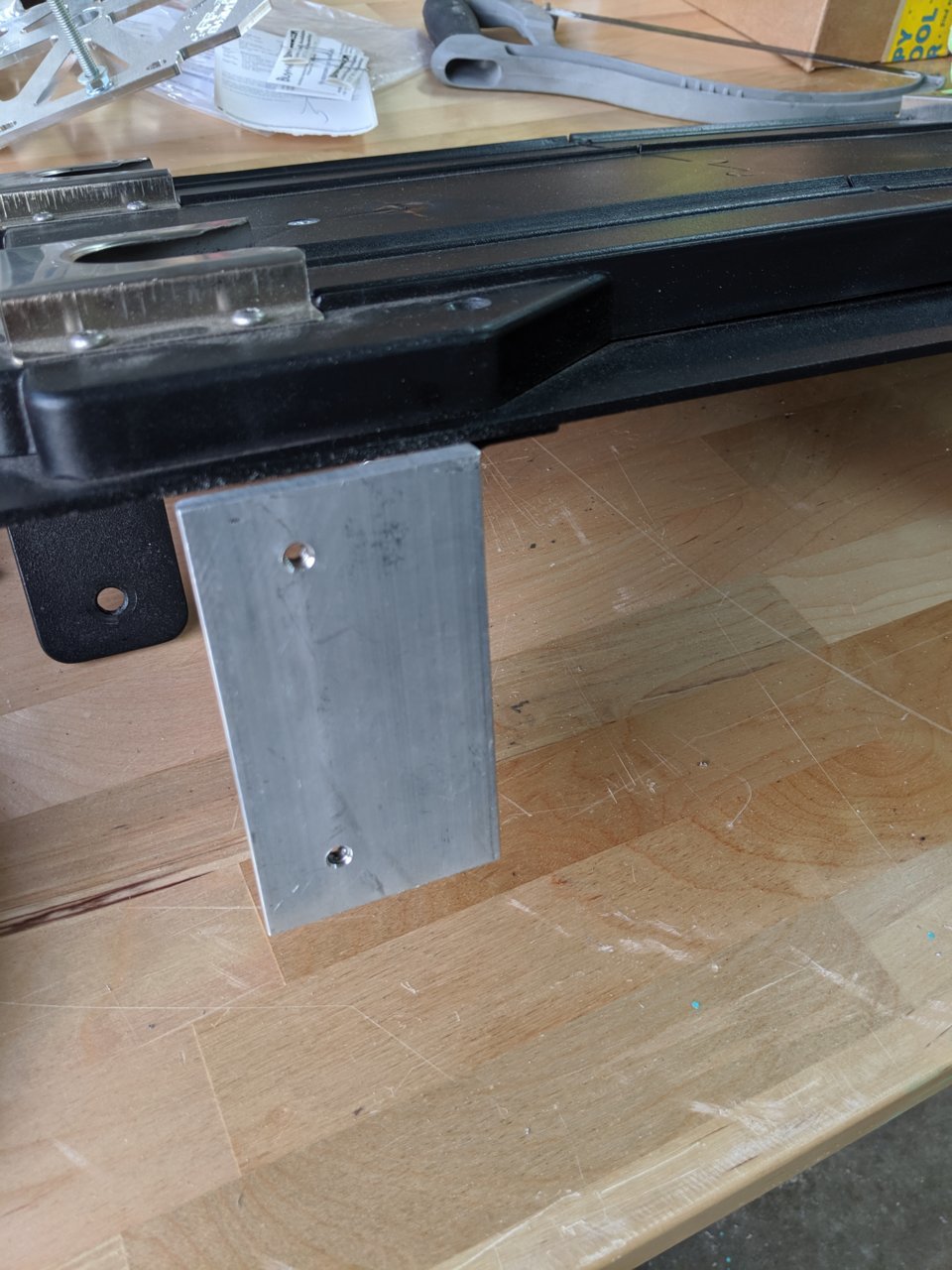

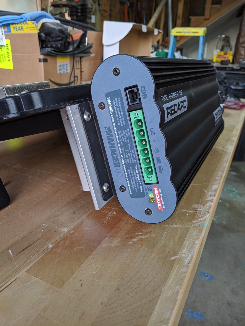

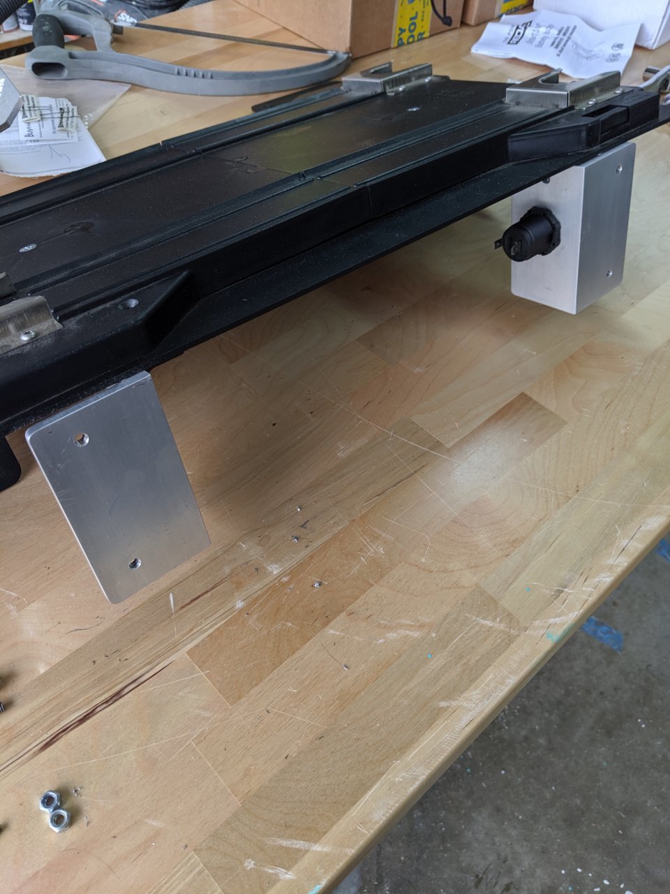

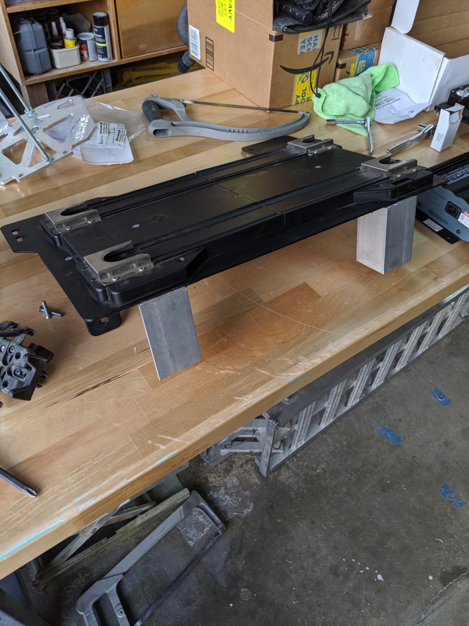

    Stuff got in the way for a bit but I got back to it tonight.
    Pulled the ol fridge mount out of the truck

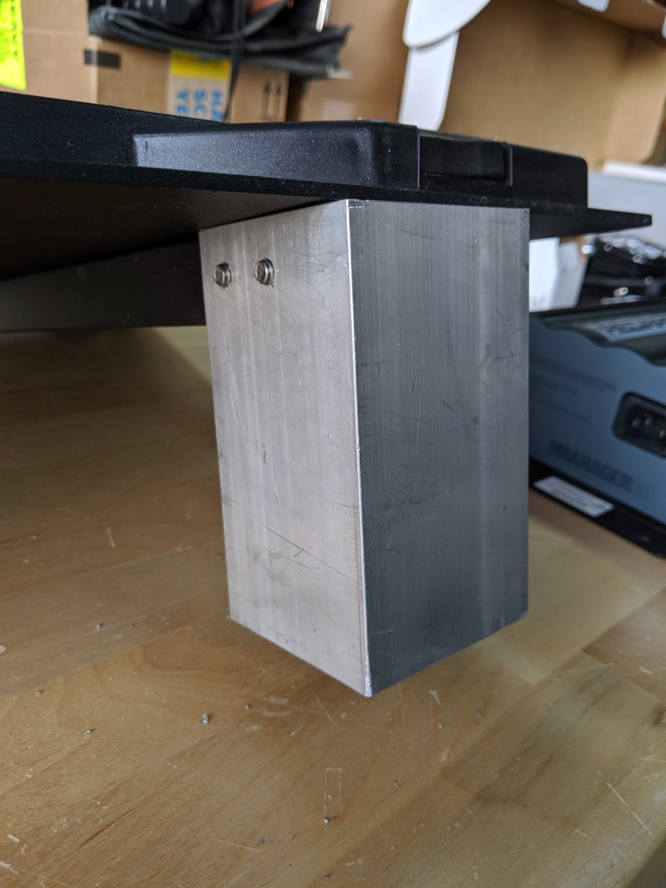

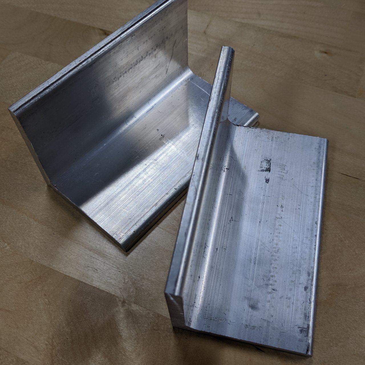

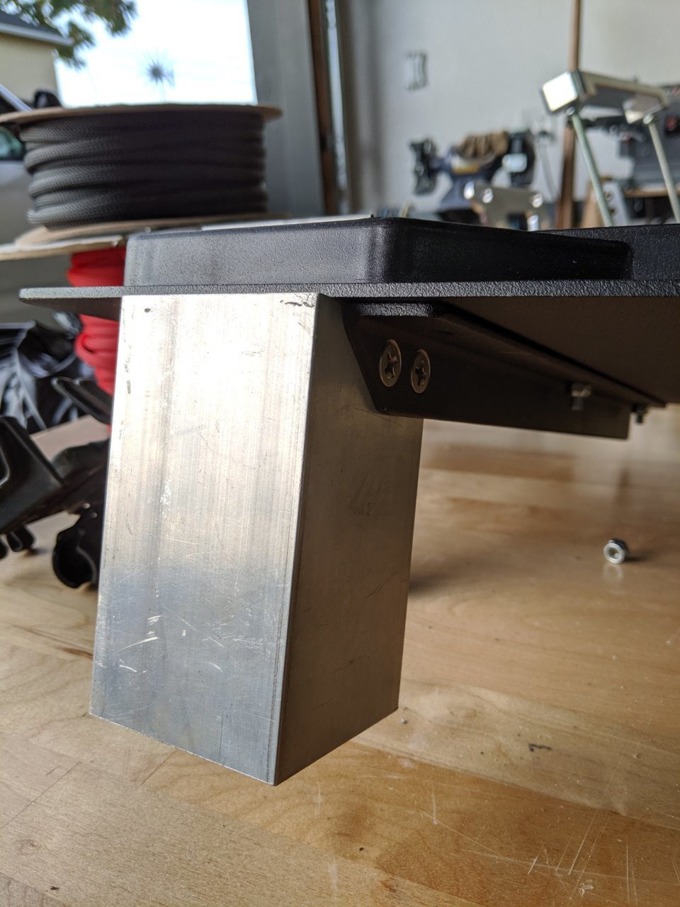

    Got to drilling and tapping
    Basic mounts...
    Transferred the holes from the Redarc Manager 30 to the mounts then did more drilling and tapping. I'm usually a nut and bolt guy but for some reason I felt like tapping a bunch of holes I guess.
    Not too shabby
    Yes, this should do nicely. I'll go back in and clean them all up: round corners, trim excess, stuff like that.

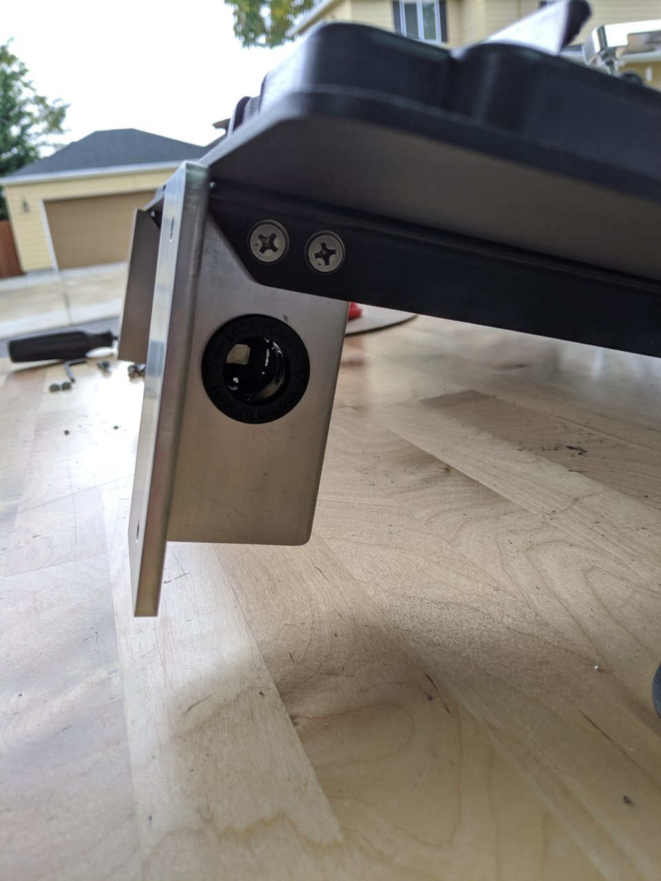

    I'm likely going to mount a 12v socket in one of the legs for the fridge. I could hardwire it but the 12v plug has a "special" thermal fuse in it. Plus, it's easy since I don't have to do any additional wiring or hacking up of the wiring I have or ordering a new wire.

    I would swap to an Anderson connector for your fridge. More reliable connection than the cigar plug.

    I had to look that up. Looks good. If I'm going to get into the wiring at all, I'd just hard mount it. There is a connector on the back of the fridge so it would still be easy to remove for cleaning

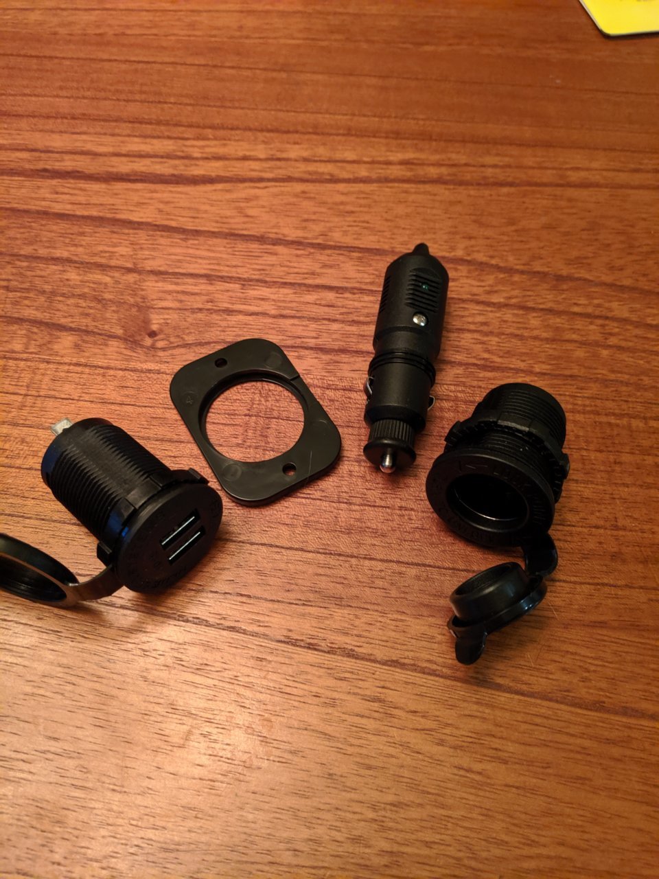

    A small collection of fun stuff arrived today:
    Left to right:
    4.8amp dual USB fast charger
    Panel mount flange (probably won't use)
    12V power plug (locks into 12v socket)
    12V power socket
    All from blue sea systems. I got the 12V outlet and plug for the fridge. I'm going to see if I can figure out a way to safely use the fuse from the Engle fridge plug with the locking portion of the blue sea plug. If not, no biggie. The blue sea 12V sockets seem to hold well with standard plugs too. Basically, this is for experimenting.
    Update: after examining both plugs, I'm going to keep the Engle plug as is. Testing it in the twist lock blue sea socket proved that it still locks in place pretty securely even though it's not optimized for it. I'm happy because that's the easiest this could have been!
    Oh, circuit breakers should be here in the next few days. I need to source a group 35 battery then I can start really laying out the electrical. My wife and I usually take a big road trip over Thanksgiving. Would be awesome to have fully functioning electrical to test out!

    Engel makes a locking connector for their fridge power.
    You need to get the female hard-mounted piece (similar to the Blue Sea socket) and wire it to +12. The front part of the Engel plug unscrews (you lose the fuse) and plugs into the socket. The lock ring on the plug then screws to the socket.
    On mine, I switched from a 12V socket to the Engel socket - it works great.
    I don' t have the part number with me, and I can't find it on their site. Let me know if you are interested, and I will find it.

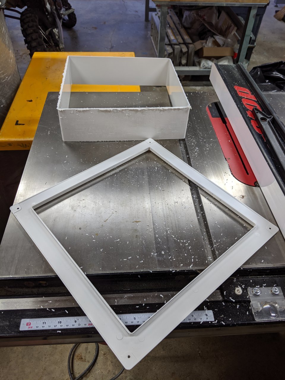

    Put the decorative fan trim ring on...finally! I knew this was a five minute job I just never took the time. Makes a big difference to me to see a finish piece in place.
