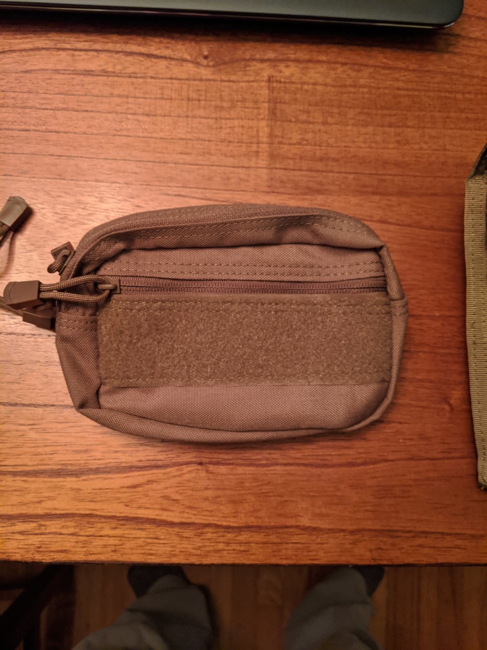

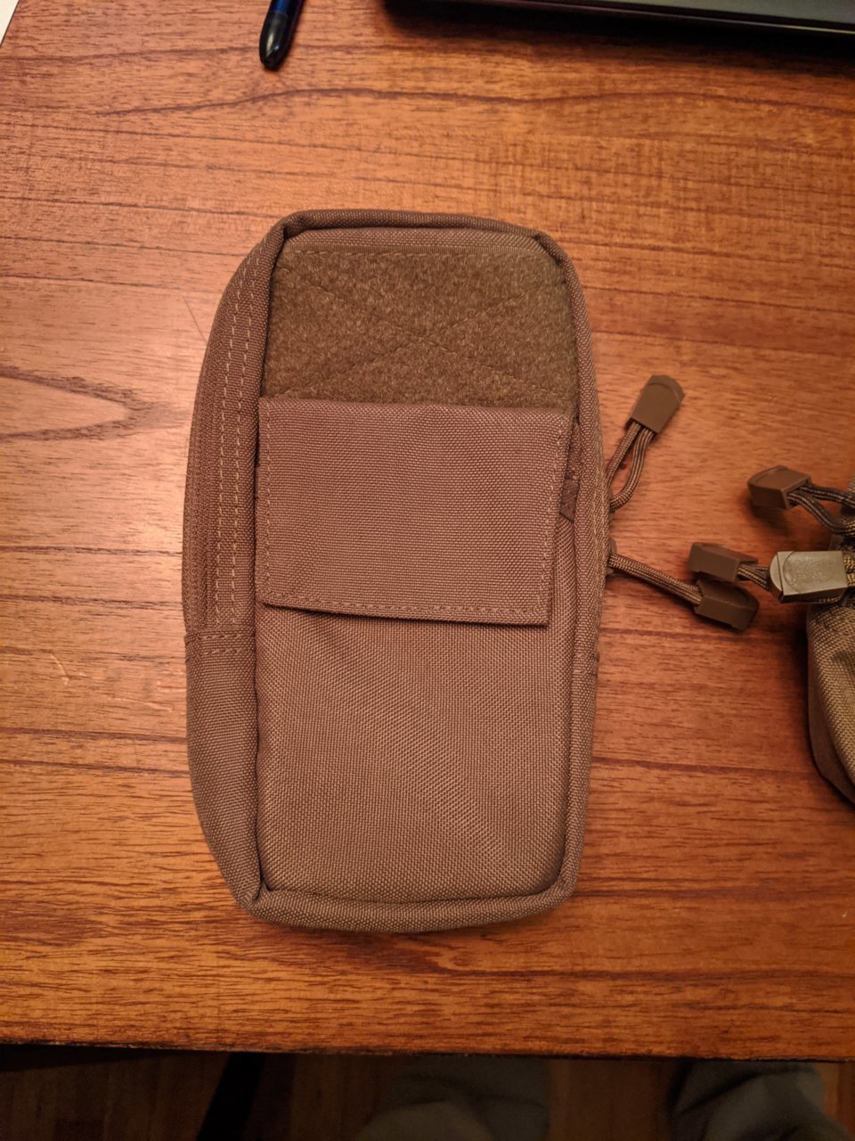

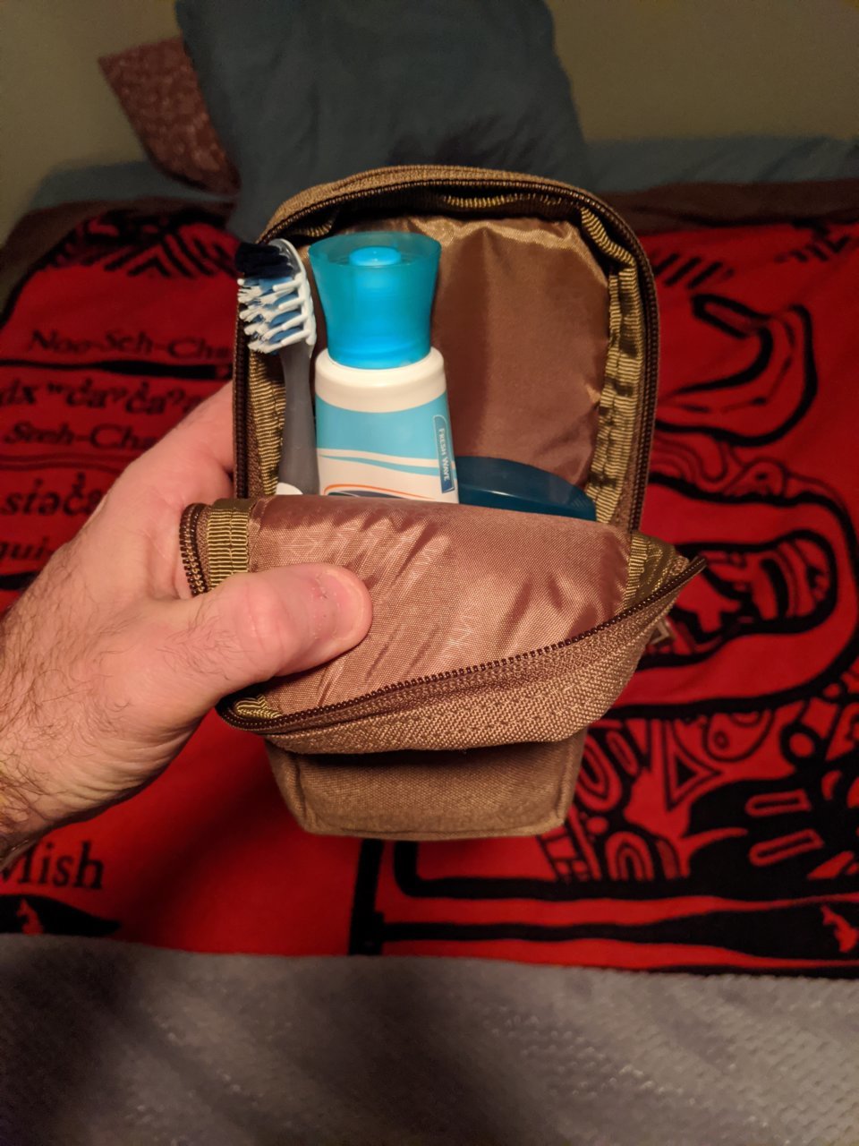

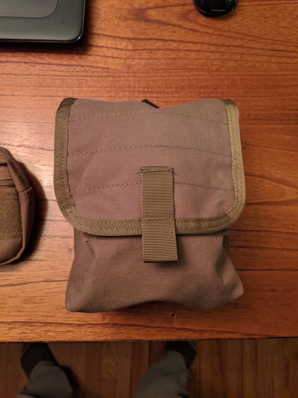

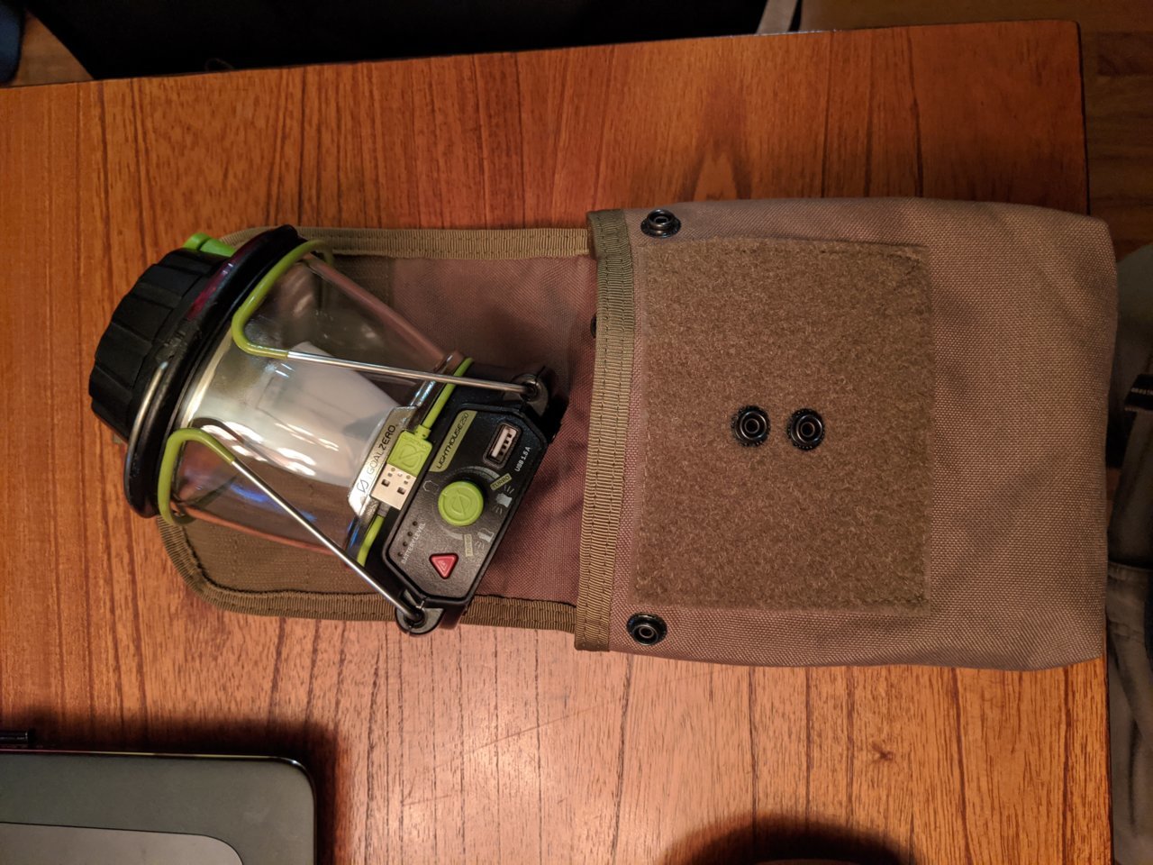

    Busy with paying work this weekend and the weather sucks so not a ton of camper stuff happening. I did pick up some bags for the upcoming molle panel build.
    This one is a quick stash spot for the holy Trinity of personal belongings: wallet, keys, phone.
    Toiletries: toothbrush, toothpaste, deodorant, floss, tweezwrs, q-tips.
    Lantern bag. Don't want to leave the lantern hanging, swinging around and smashing itself to bits. Luckily it fits in this bag perfectly. A smashed mega roll of toilet paper fits in one as well. A standard roll would fit even better.
    Will likely pick up another set just like this for my wife's stuff. I'll see how this all fits in the space I have.
    Considering making two Klean Kanteen holders out of leather for the front interior corners of the camper. Nice to have water at hand at night in case you get thirsty! Maybe I'll get an off-the-shelf pouch/cage too. Not sure...

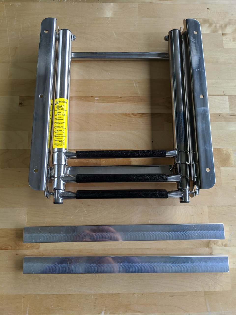

    I've got a buddy of mine machining a couple of simple aluminum bars to mount the ladder. I'm hoping those are done sometime this week. Would be awesome to get the ladder mounted this weekend...assuming it's not pouring down rain.

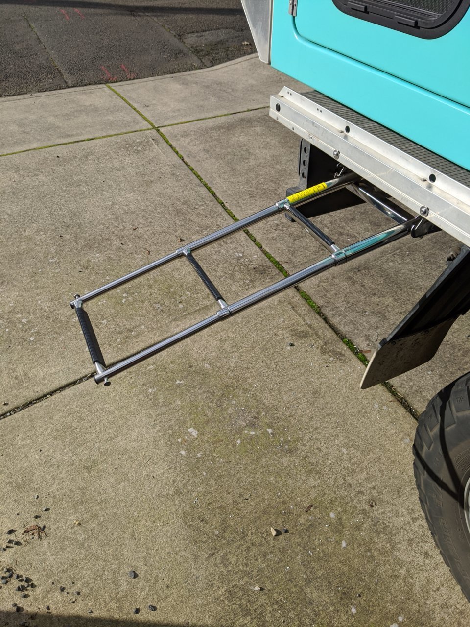

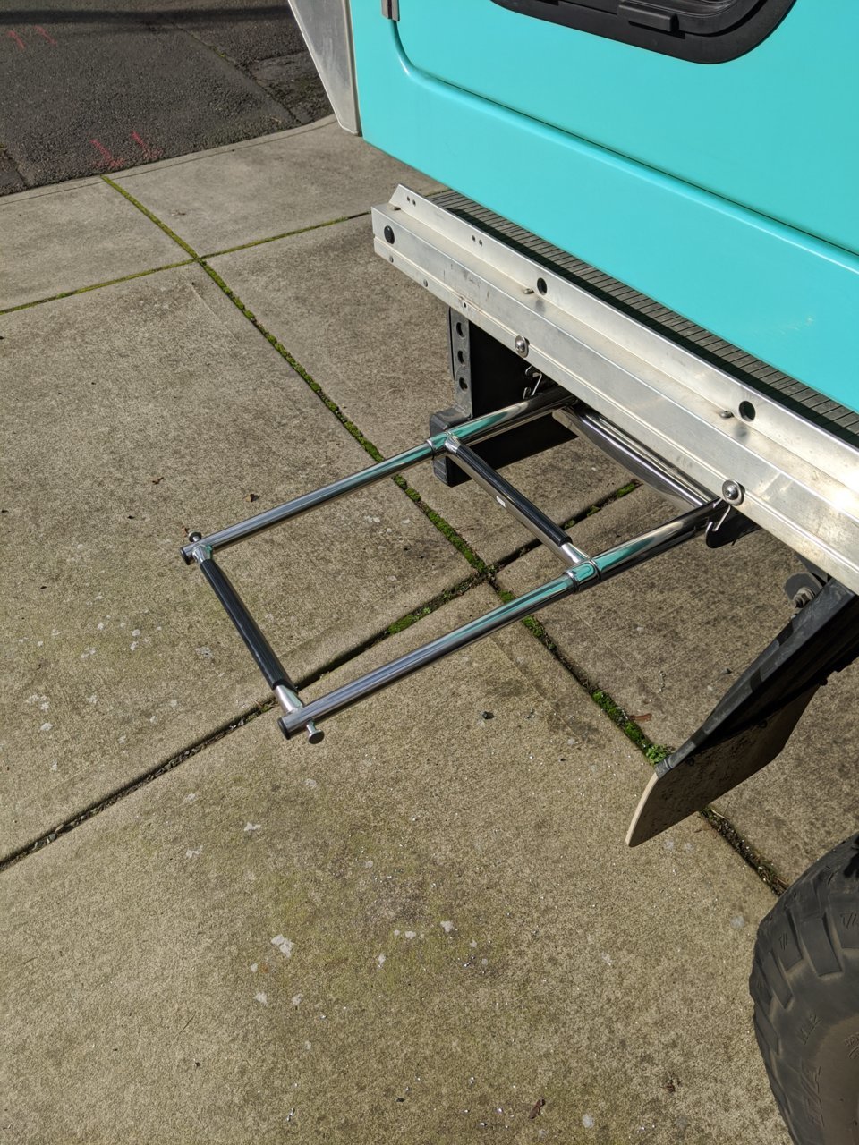

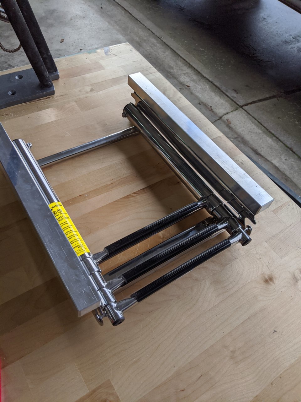

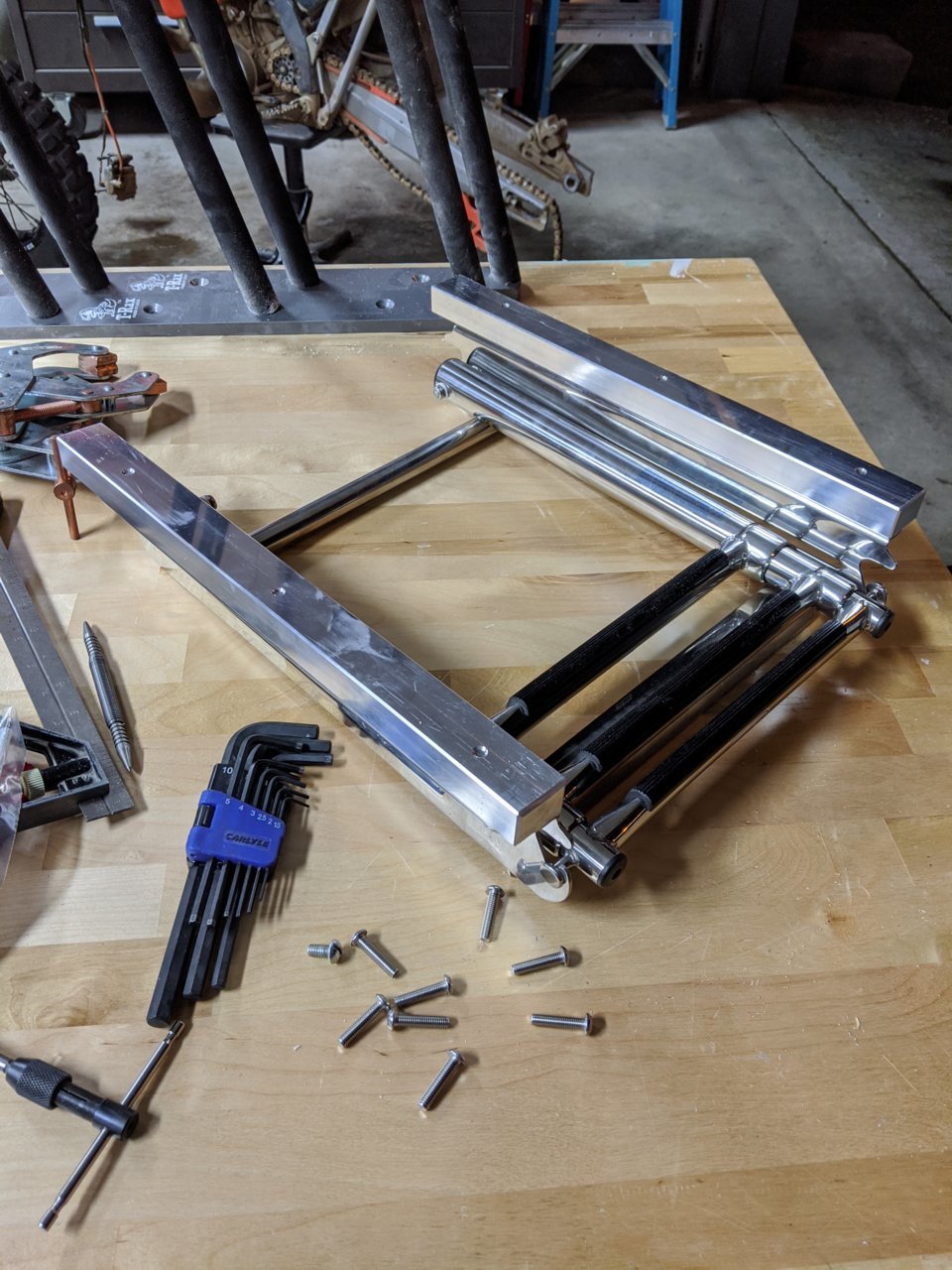

    Sloooowly working on the ladder mount.
    Aluminum bars machined to my specs.
    They go here. Mark some holes...

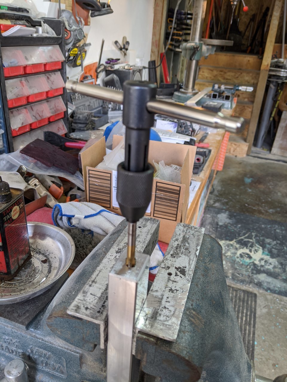

    Drill and tap...

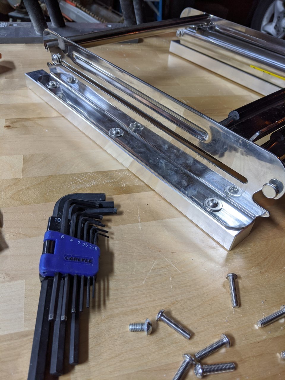

    Bolt into place with stainless bolts and washers, of course.
    These bars will slide right up under the flatbed and bottom out while exposing just enough ladder to get the job done. Next is the somewhat tricky part of drilling the holes in the end of the aluminum bars and matching those up with holes that need to be drilled in the side rail of the bed and the frame rail of the bed. Ive started making a little wooden jig for that. The idea is the bars will be held in place by bolts through the bed in to the end of the aluminum block. Not ideal for really heavy duty applications but I think it's plenty strong for my purposes. The shear strength of 6mm stainless bolts is plenty high for this. I could go to two 6mm bolts per end but then you don't have a lot of aluminum around each bolt. I could also go up to an 8mm bolt in each end. I may do that.

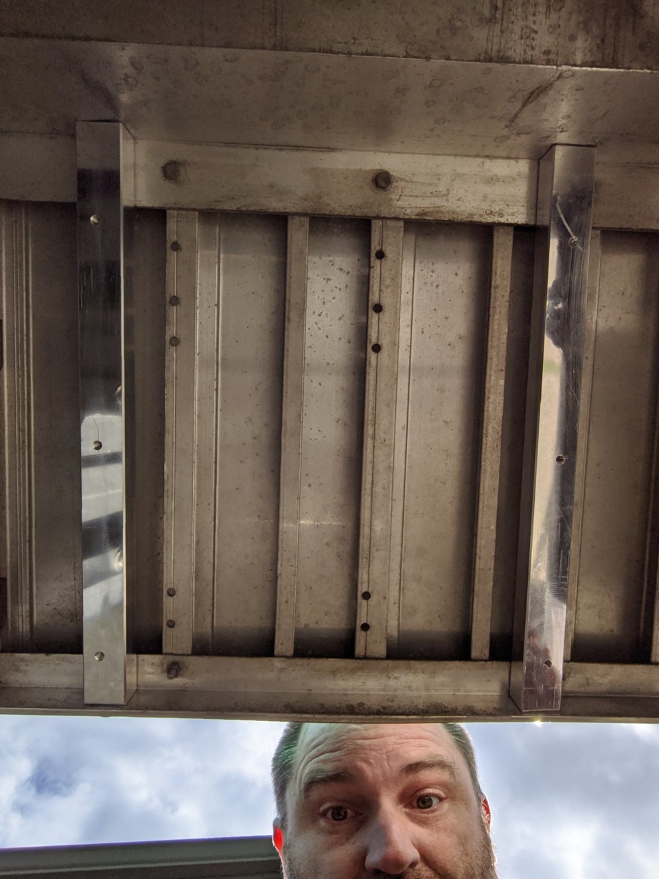

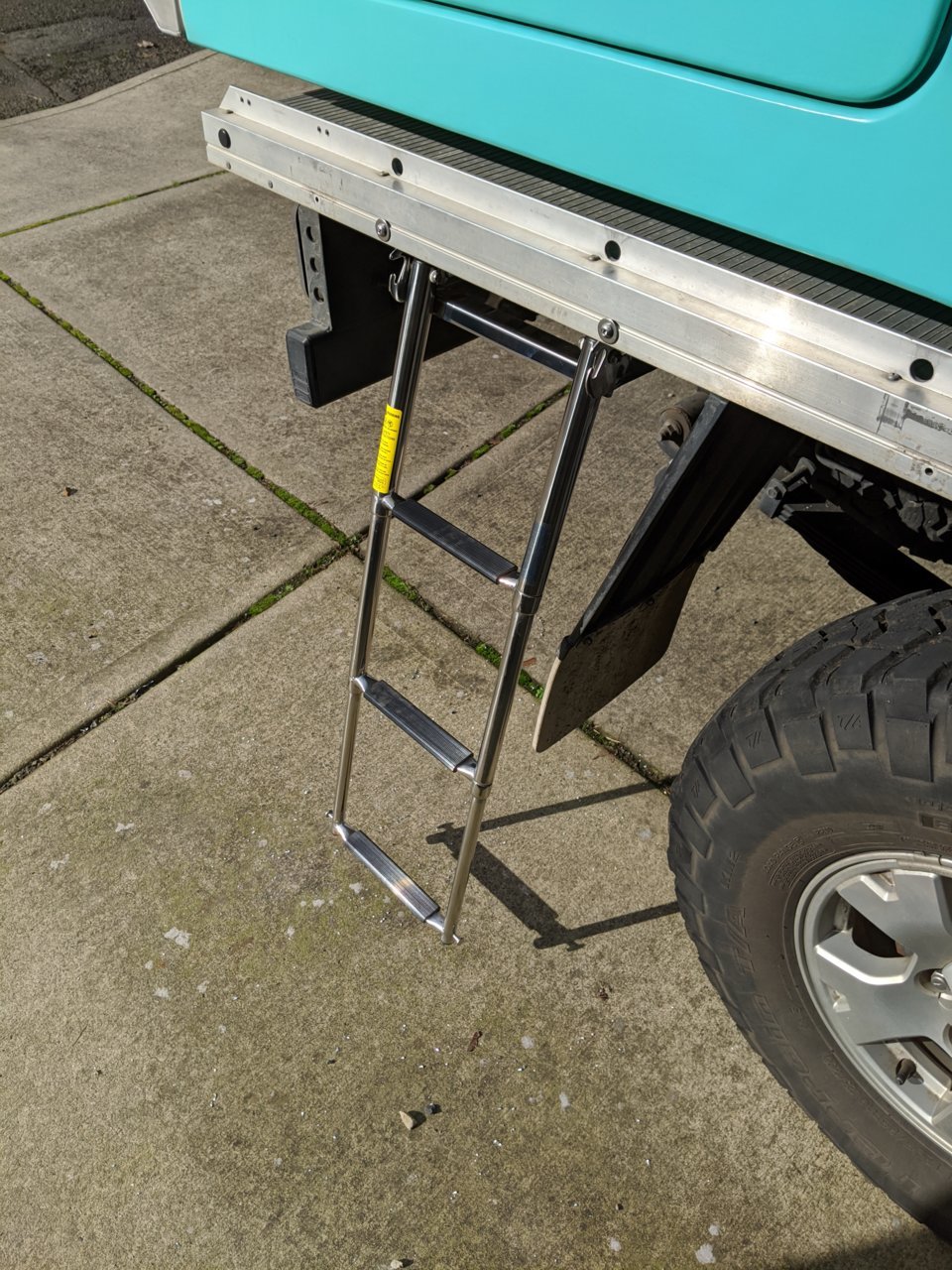

    Finally got the ladder installed!
    Started with some drilling and tapping...
    Then I bolted the shiny rails up under the bed.
    Then I bolted the ladder in place!
    There it is!
    It flexes quite a lot when I step on the lowest rung but I don't plan on jumping on it so I think it'll be okay. Could also be a hint to lose the 40-50 lbs I could stand to lose. :D :sadviolin:

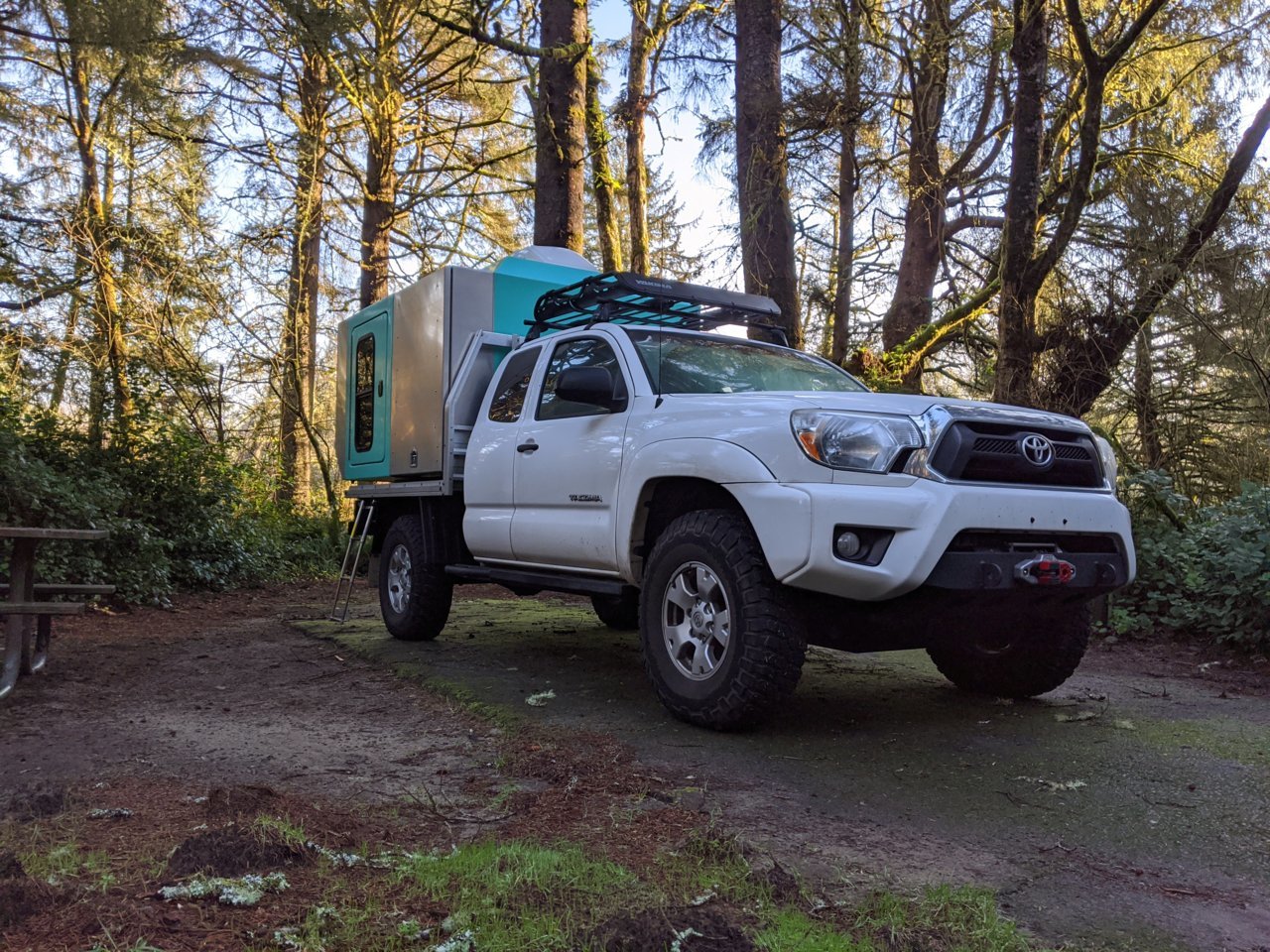

    Did a little impromptu overnighter out at the coast. It was awesome to see how easy it was to just toss and go rather than having to really think about what to bring and consider the weather and all that stuff.
    The new ladder works pretty well. I'm glad I made the switch!
