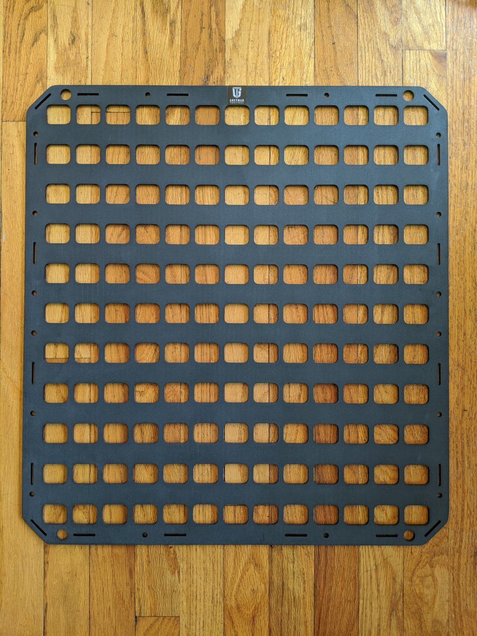

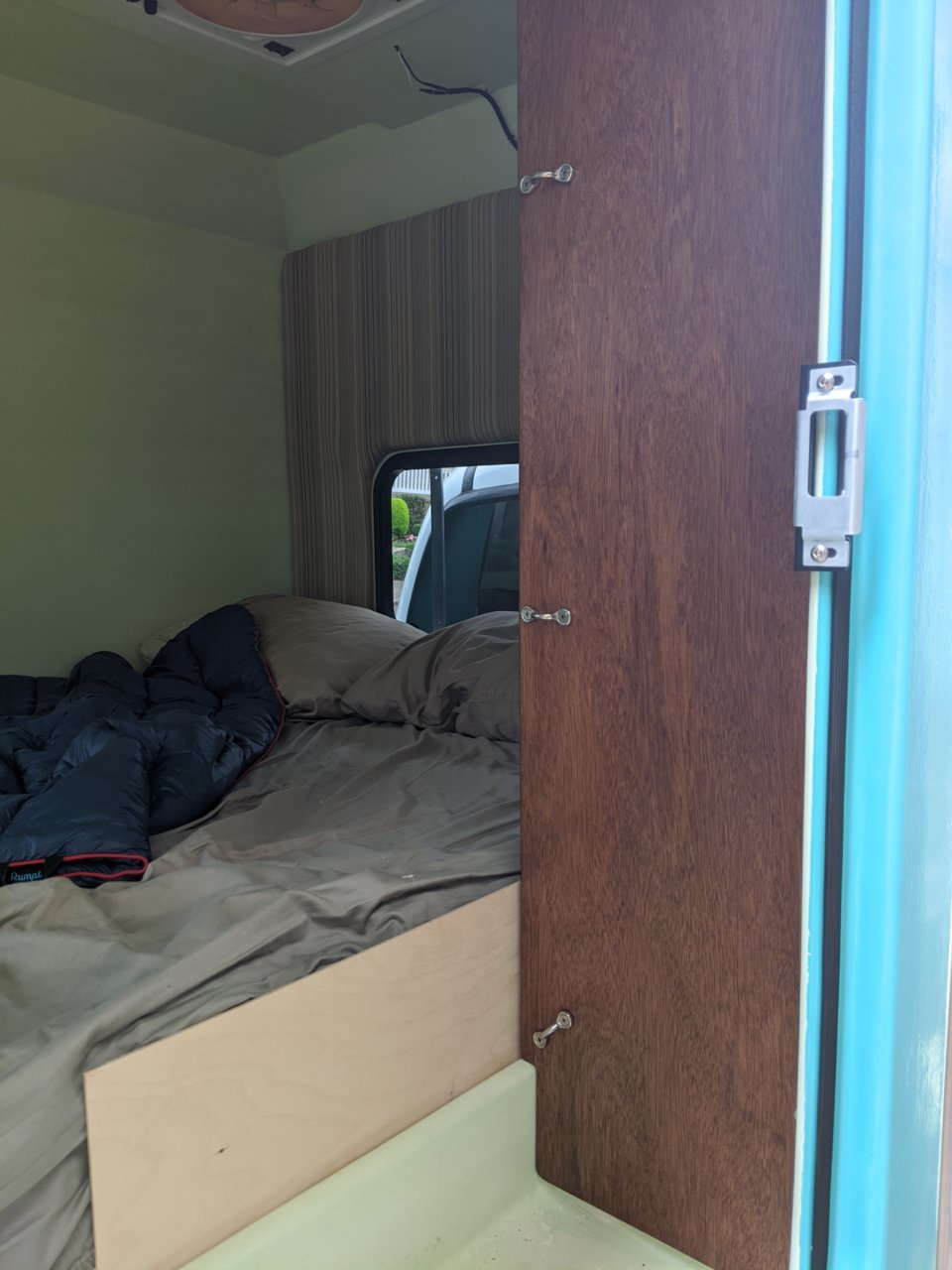

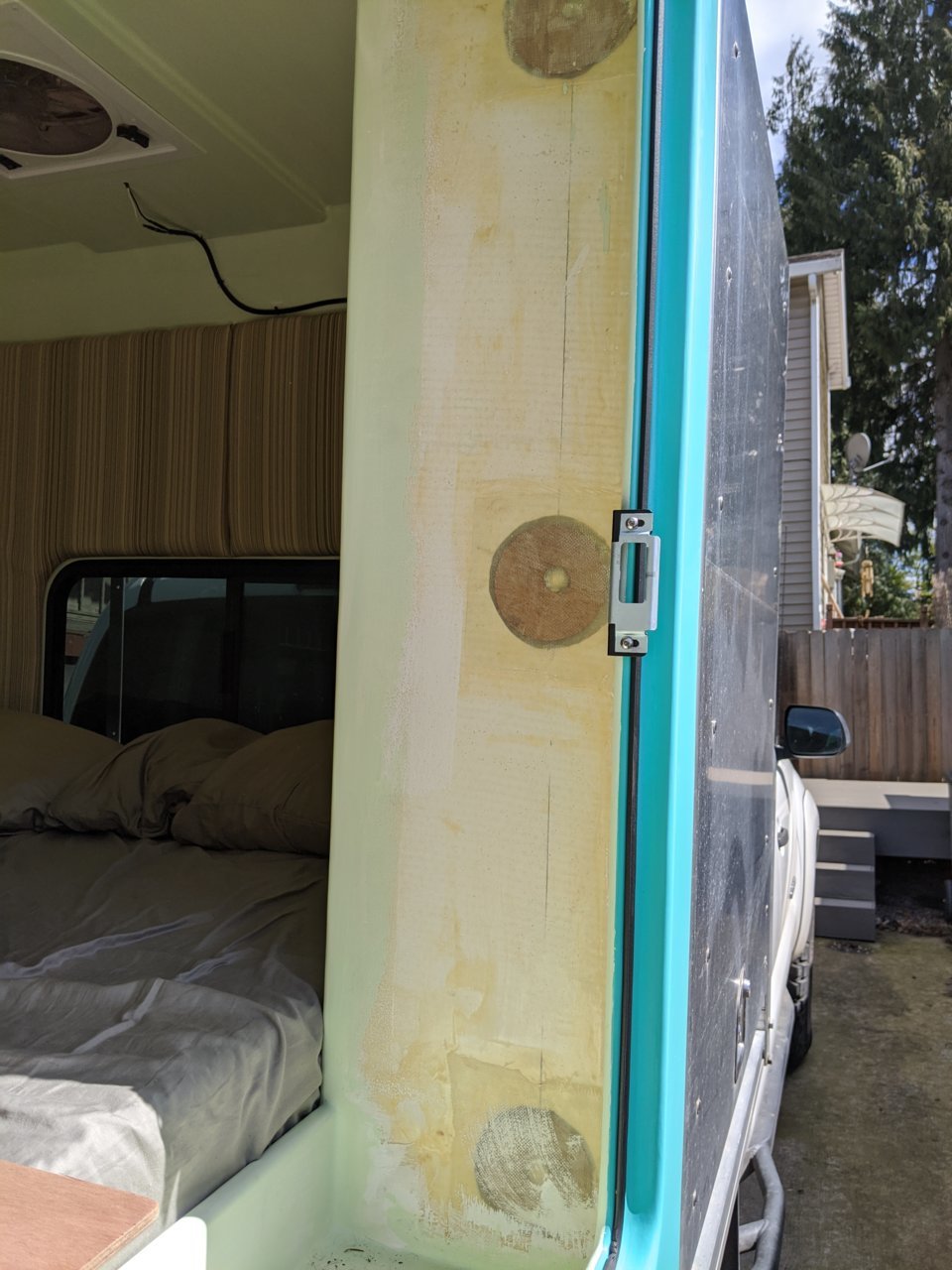

    So, I've been neglecting my forum buddies something fierce! Here's an update for you.

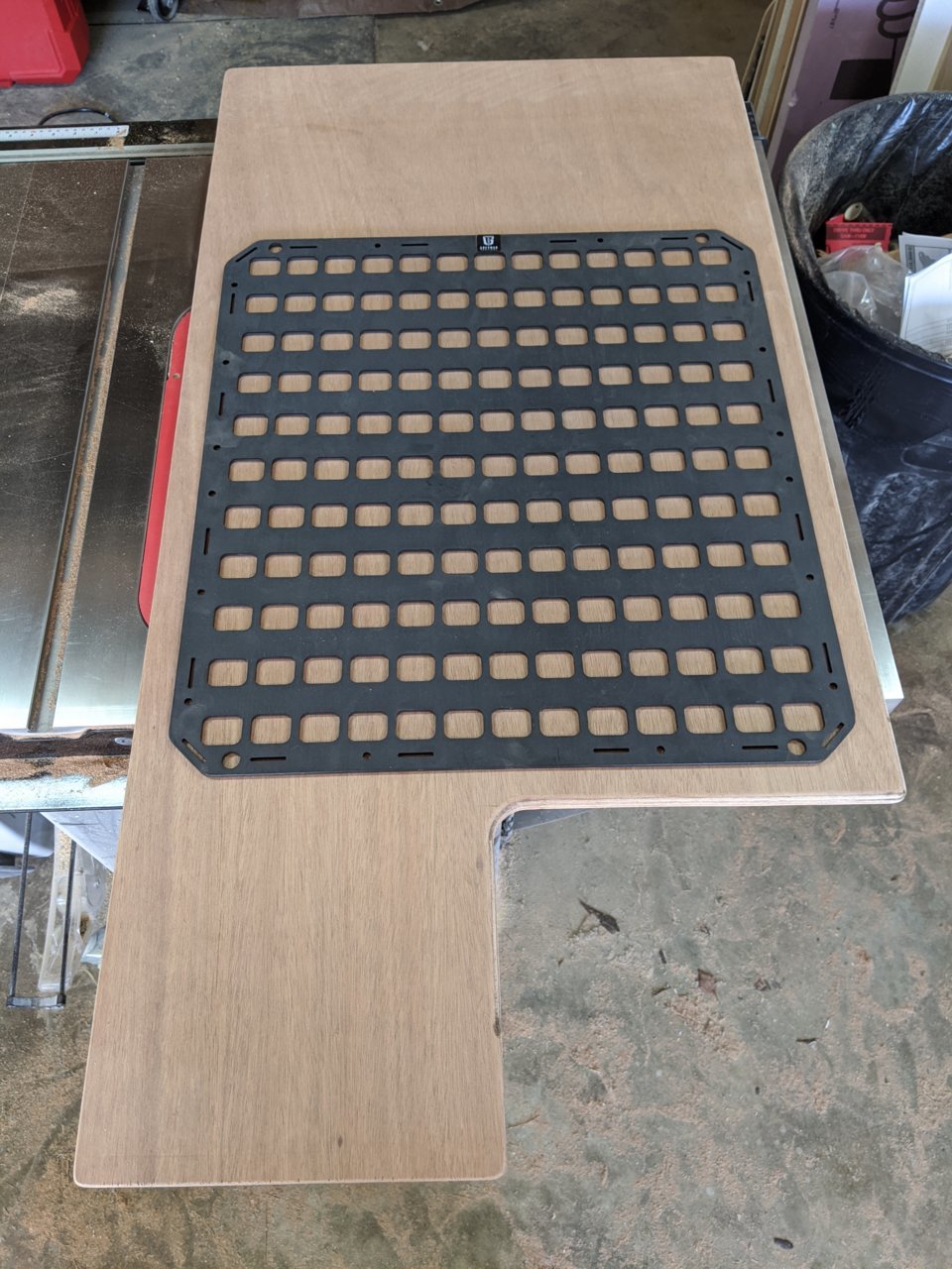

    Started cutting and fitting the wall panels inside the door of the camper. This is going to look so nice. Tired of seeing the unfinished wall sections here.

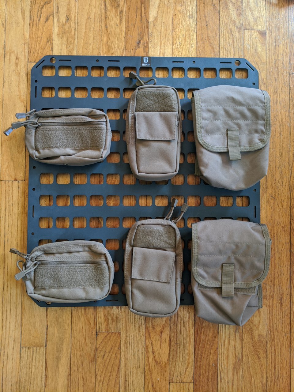

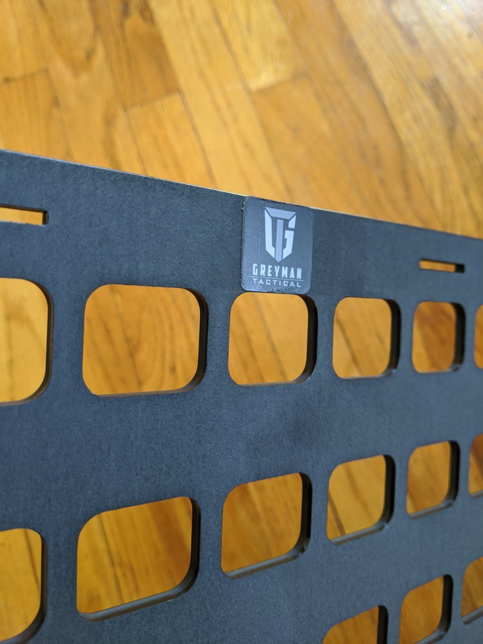

    I was going to design and have made my own custom MOLLE panel but decided the time wasn't worth it when this was ready made and available right now. Grey man tactical. Nice panel. I would order from him again. Picked up a few Molle pouches to store things and such.
    Here's the other wall panel and where the Molle panel will sit. I'm going to put bungee rigging above this like a sea kayak deck. Same with the other wall. It'll be quick easy storage for jackets and stuff like that.

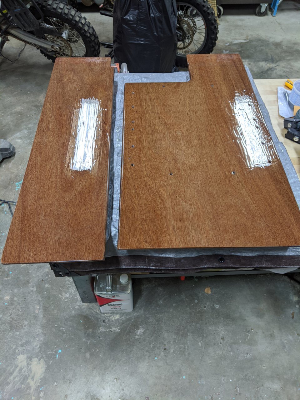

    First coat of epoxy on the back side of the panels. Gotta seal everything up! There are a lot of steps left to finish these up but every step done is a step closer to finished.

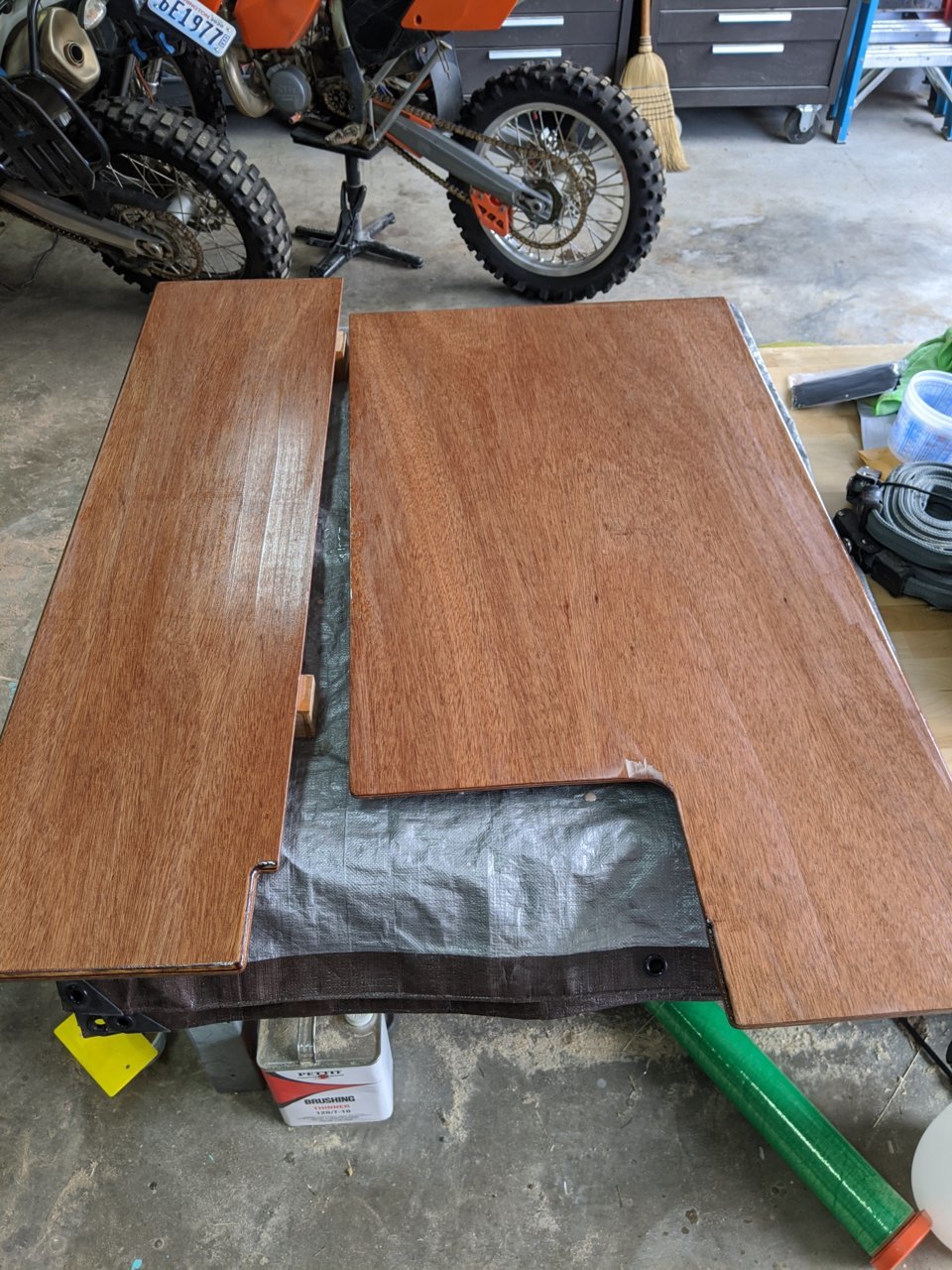

    Slowly working through the quarantine.
    A good thick second coat of epoxy on the front and back of the panels. I don't like shiny so I'm going to sand these with 220 grit then use a red scotchbrite pad with water, then a buffer. I've done this before and it comes out a nice, smooth satin finish.

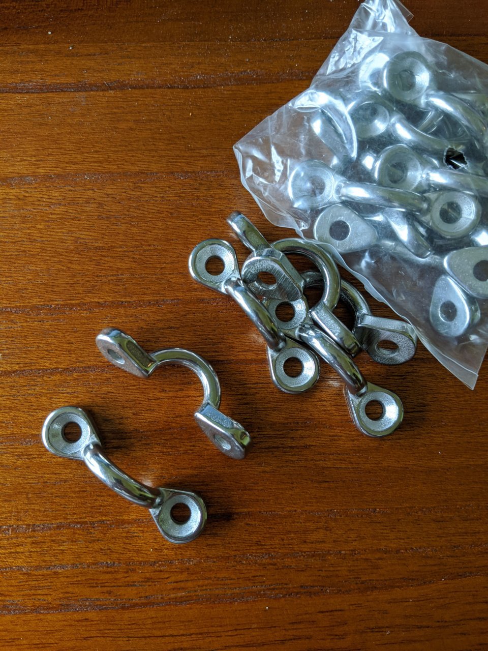

    Today I got my shipment of heavy duty stainless steel pad eyes. These will be attached to the two panels and I'll use 3/16" shock cord in a pattern through them to create some nice quick stash spots for jackets, towels, whatever. Still need to order the shock cord but it won't slow me down.

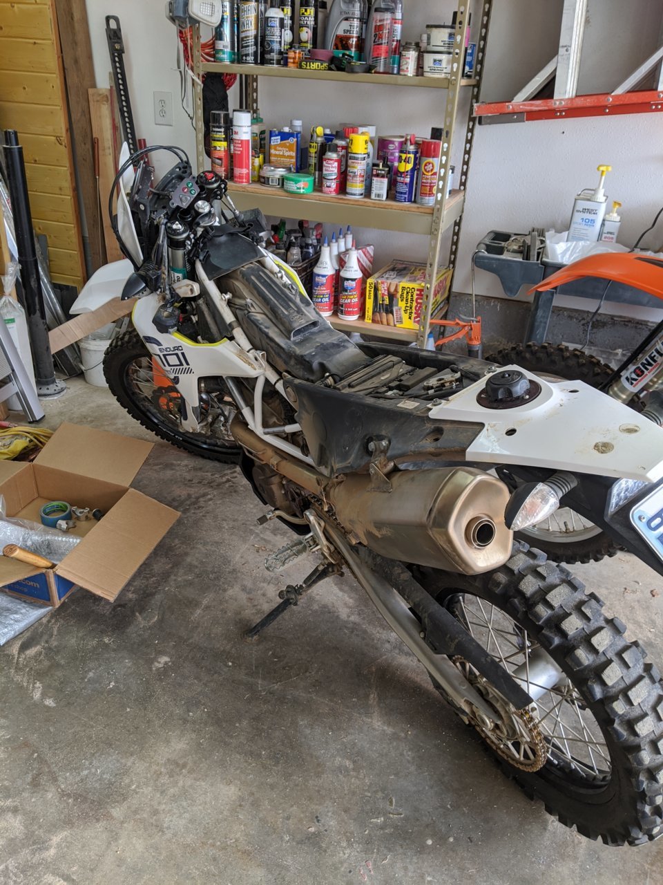

    I'm not currently working on the panels because I'm getting my Husky 701 in shape for a trip in July. Assuming the US isn't shut down in July.
    New bars, bar mounts, grips, exhaust, skid plate, tires, and a good clean..it's gonna take a minute. :D

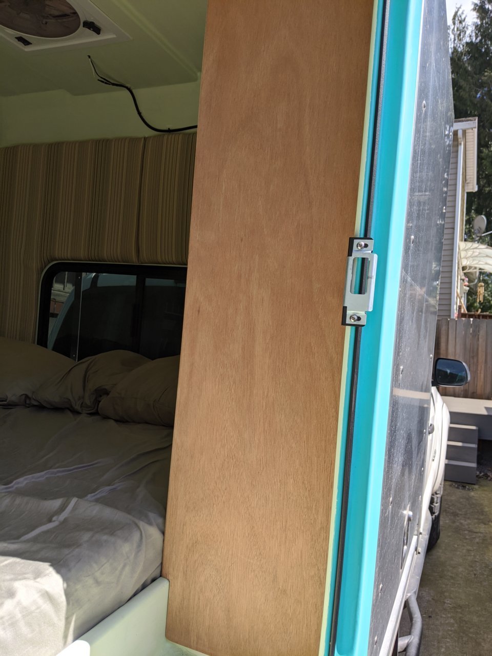

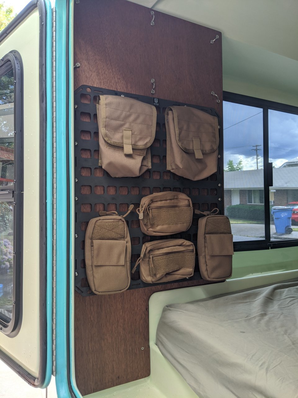

    Wow...it's been a long time! Progress is being made but in small bits over long periods of time. So, like usual then. :D

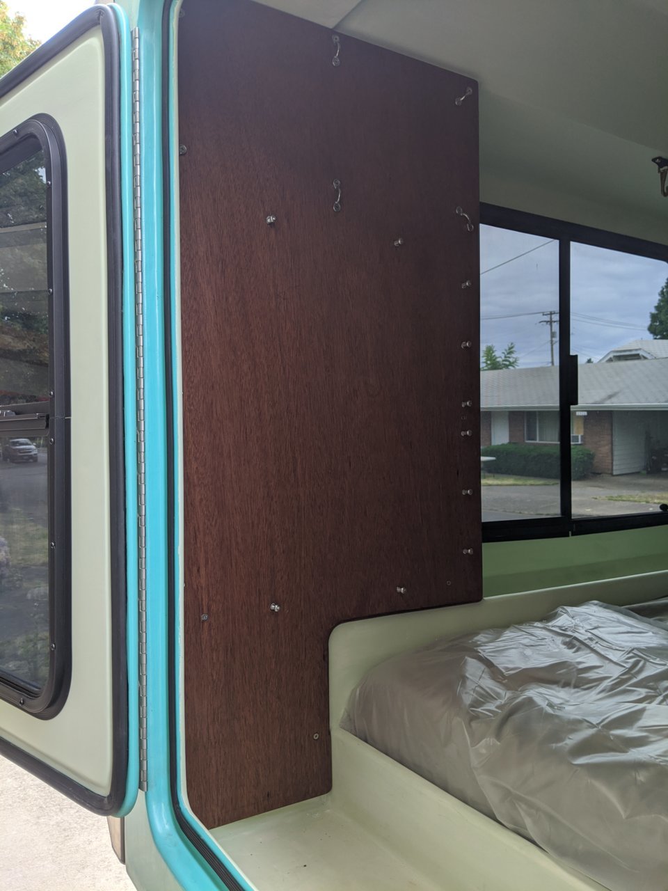

    Got the first panel epoxied in place.
    Second panel in place!
    Greyman tactical MOLLE panel and bags installed. So far I'm digging it. Nice to see some finish panels over these areas.
    Now I just need to order 3/16" bungee cord to finish them off. I'm debating: black, brown, or tan for the cord. I can get black and tan right now but brown is out of stock.
